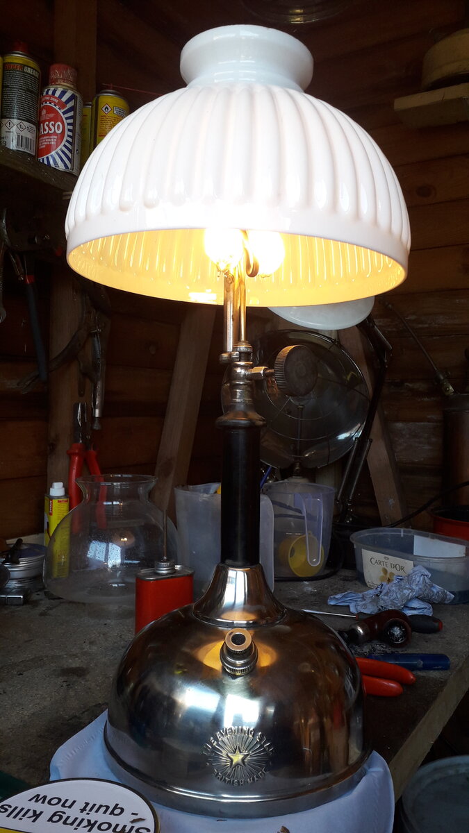

  6. col
    col United Kingdom Subscriber
    Mar 23, 2019
    55
    carlisle cumbria
    Thanks Chris I lit it today with unleaded fuel and two spare mantles it works well the mantles don't light up fully but it was just a test,I'm going to take your advice and use coleman fuel and buy the mantles you suggested many thanks.

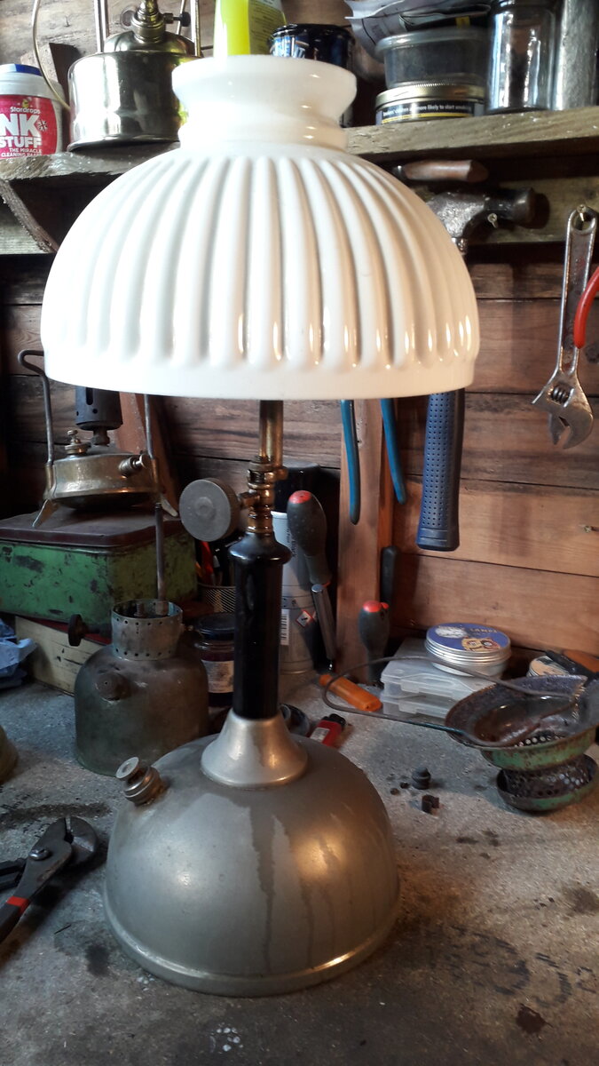

  9. col
    Mar 23, 2019
    55
    carlisle cumbria

  11. Fireexit1 United Kingdom
    3,536
    Looking damn fine ! you must be pleased with that one...8]
  12. Tony Press
    11,095
    Col
    That’s a very nice lamp.
    Did the shade come with the lamp?
    Mar 23, 2019
    55
    carlisle cumbria
    Hi tony yes the shade come with the lamp, do you think its original?.
  14. Henry Plews
    3,066
    Very nice :thumbup: :thumbup:
    Coleman fuel is seriously expensive, Aspen4 does the same job at around half the price. I suspect these chaps will be your nearest supplier, Kingstown Broadway Kingstown Industrial Estate, Carlisle CA3 0EF

  15. Tony Press
    11,095
    Col
    I don’t know if it’s an Evening Star shade or not, but it looks good on the lamp.

  16. AussiePete
    A job well done, she looks awesome. :clap:
  17. JEFF JOHNSON
    16,869
    A fine example.:thumbup::thumbup:
  18. Mr cod
    Mr cod Subscriber
    Jan 21, 2018
    547
    Aylsham norfolk
    What a beauty, the shade does look good on that lamp.

  19. Jean J
    3,001
    That has cleaned up very nicely, you must be pleased with it. I have the same shade on my lamp but was told at the time that it probably wasn’t original to the lamp. Or not to the model I have but I think that shade looks great.
