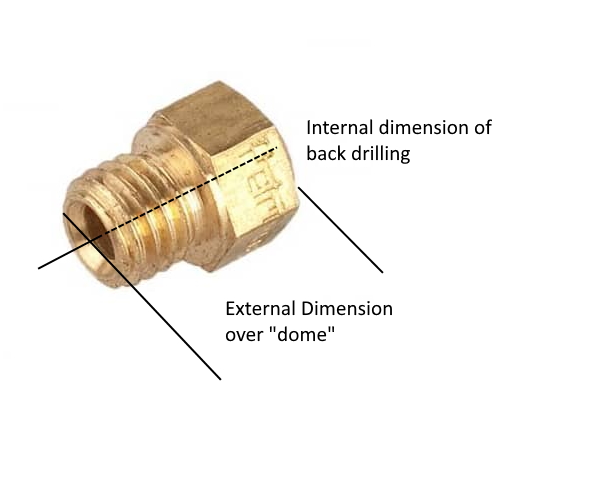

Isn't this all down to tolerances in the machining? If the back drill process goes too deep it leaves the dome very thin. Easy to make the jet orifice but it will have little or no wear resistance to the needle. Can you measure it?
It's not an easy measurement to make.. here is my idea about it. It would need at least vernier calipers or even better some sort of micrometer.
I have vernier calipers but old style so anything below 1mm is just a guess. Plus there's no way to measure the dimension of the back drilling with them, the tails is too big to fit up to the tip of the drilled cone.
