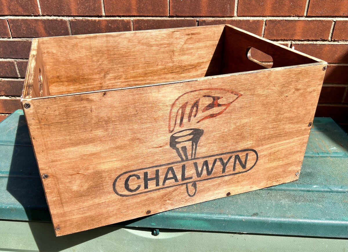

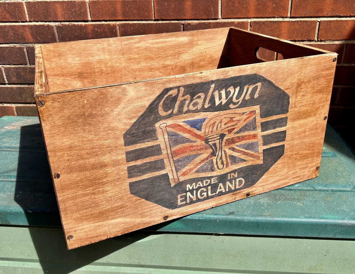

    Needing a new box to pack some recent acquisitions into, I built a sturdy crate from a few offcuts of plywood that I had lying around.
    I decided to dedicate this one to the makers of some of my favourite lanterns, Chalwyn.
    The designs were reconstructed from various sources on the computer and then printed, in reverse, on my laser printer. ( Photocopies would also work with this technique. )
    Taped to the surface, print side down, they are then rubbed over with a hot iron which transfers some of the print toner to the wooden surface. The density of the transfer is variable with the quality of the wood but generally looks like faded stencil work.
    I then added a little colour with dilute acrylic paint before rubbing it back with sandpaper.
    The whole box was then given a rough coat of wood stain to age it a bit and here you see the result drying in the sun. IMG_1848.jpeg IMG_1847.jpeg IMG_1849.jpeg

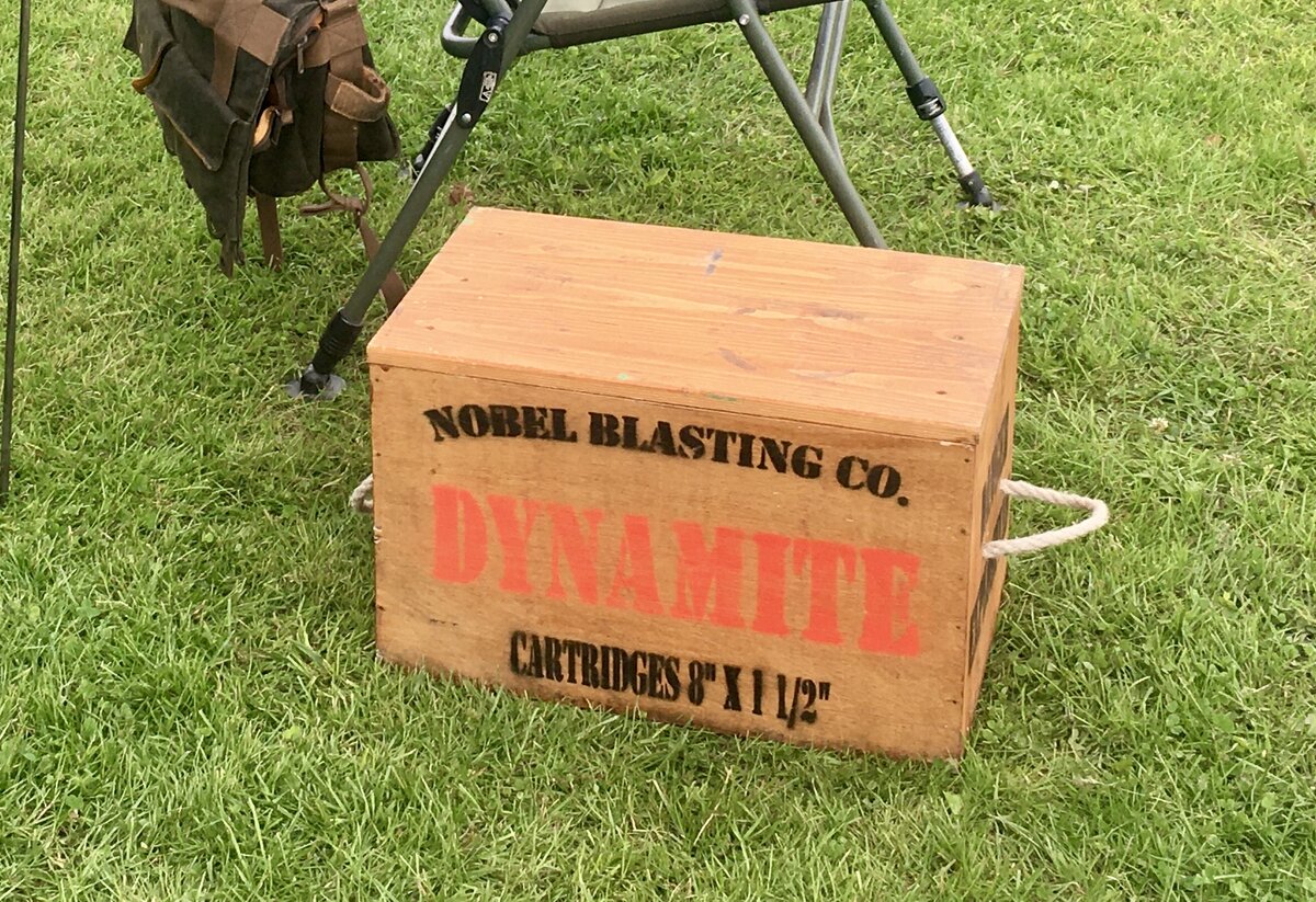

    No, not I …
    I saw this at this year’s CCS/CPL Newark gathering, so someone was thinking as you did.
    … and incorporated the ‘packing crate’ construction of their accommodation in camp.

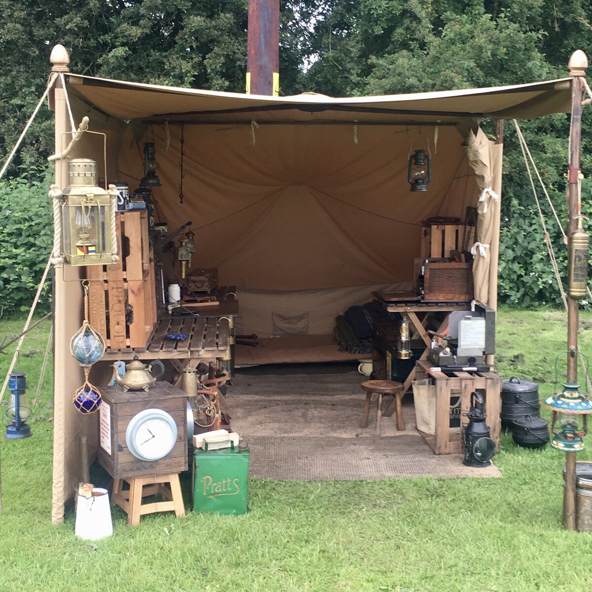

    Just realised Wayland, that’s you and your accommodation of course!
    John

    IMG_0171.jpeg Yes that is me John. Nice pair of Vestas there.
    Steve and myself are founding members of the Steam Tent Co-operative and we very much enjoyed Newark this year.
