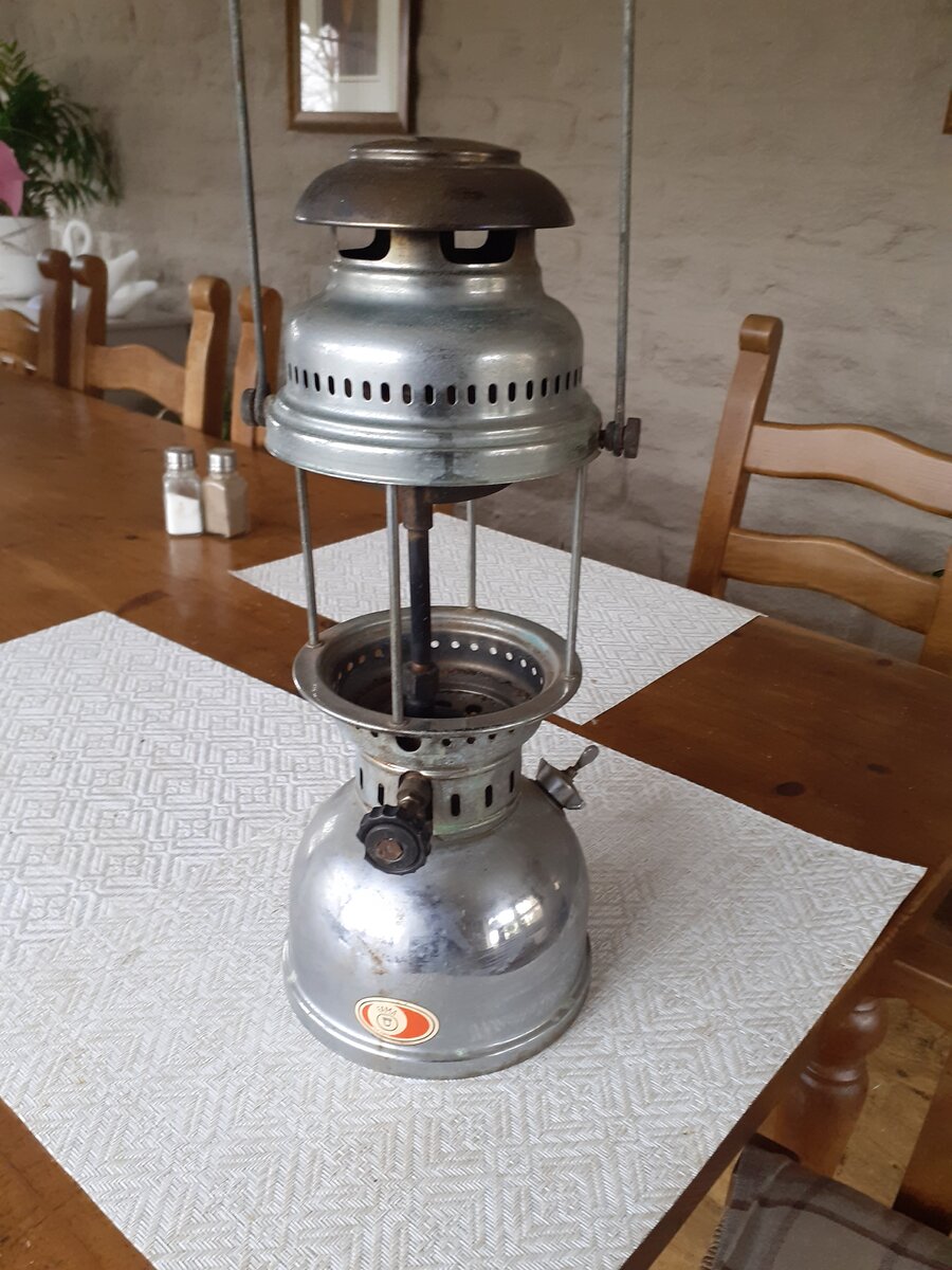

    Hi all newbie here , i have just started polishing a vintage lamp and in the cleaning process i dropped the glass shade is it possible to get a replacement?
    many thanks for any responses
    16,881
    Photographs of the lamp will help us to assist you.

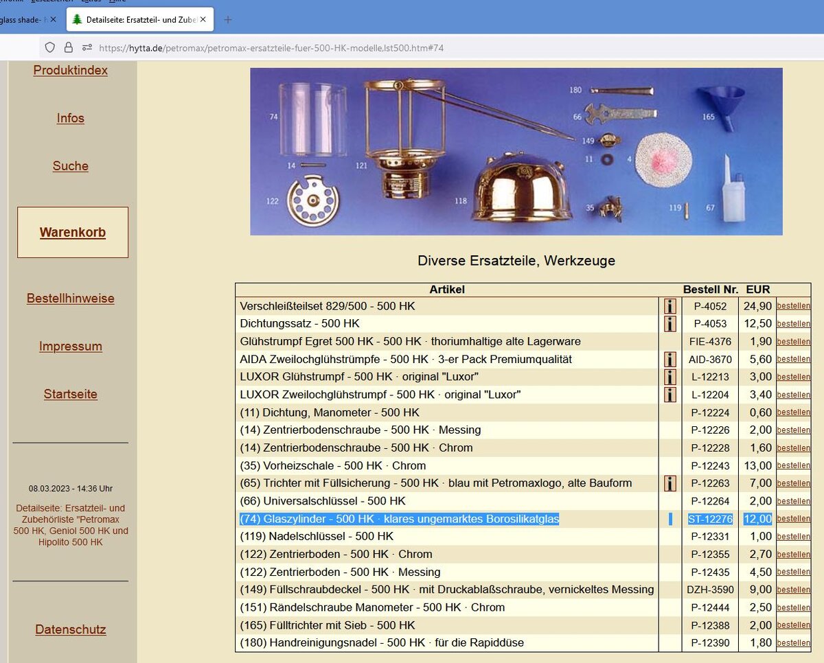

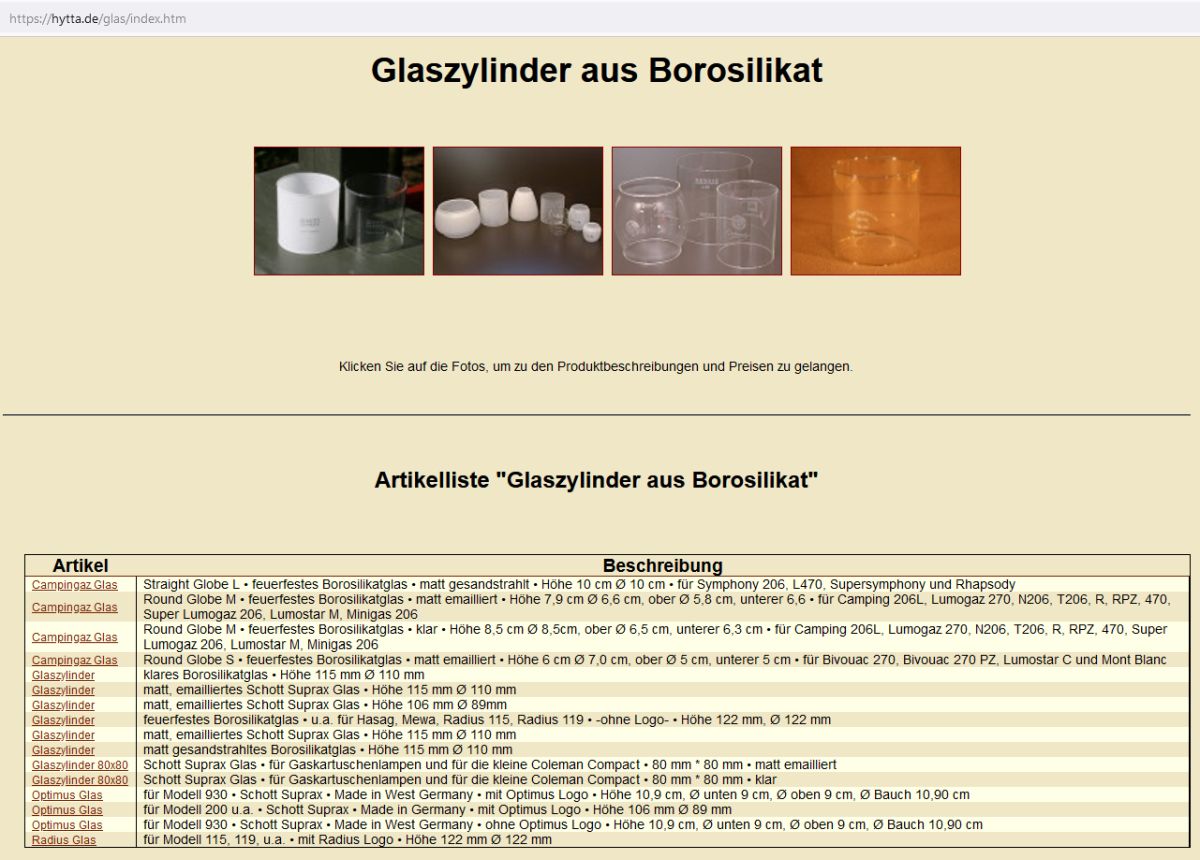

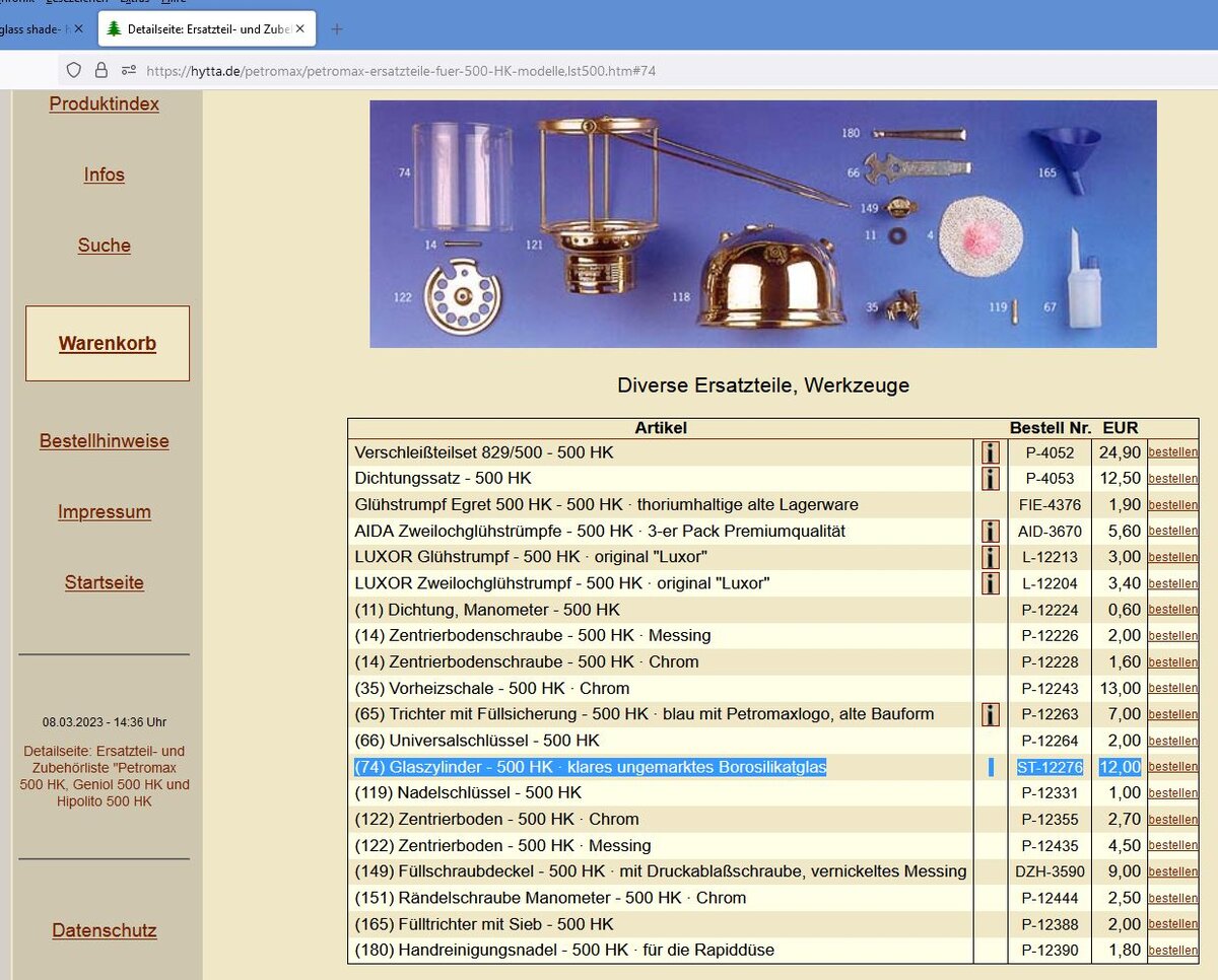

    Michael, it looks like a "standard" size 500CP lantern.
    Have a look at the enclosed screenshots.
    You can probably buy them in th UK as well.
    Good luck.

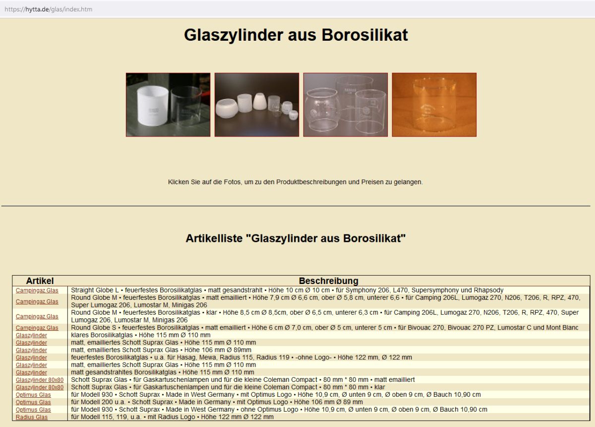

    thanks Erwin the glass measures 110mm high and 110m diameter, i cant read german so which globe would it likely be please?? many thanks

    Sorry its 115 high and 110 diameter

    Thank you very much Chris i have emailed them and hoping for a reply soon.

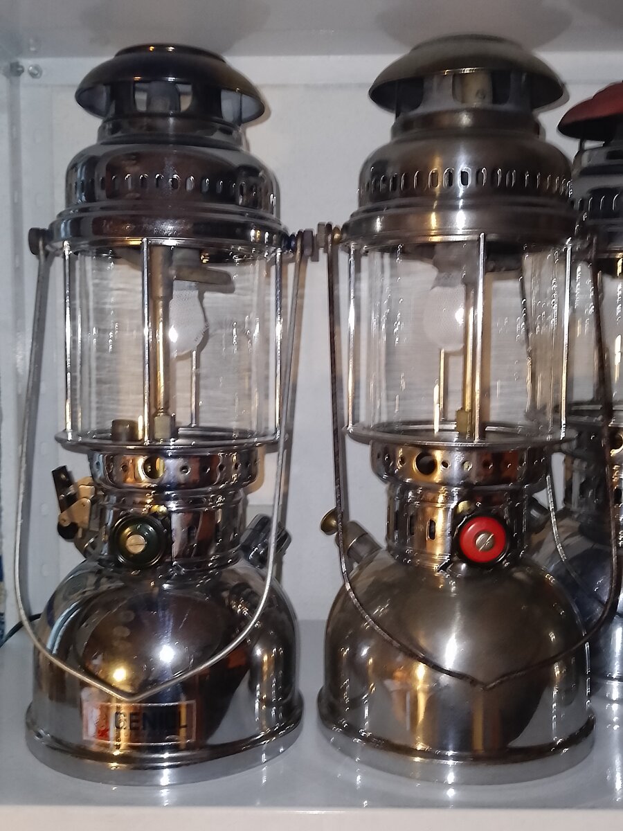

    Yours is interesting - do you think that the fuel cap/pressure release is original to the lantern ? Other versions here with that logo have the more "petromax" type pressure guage/screw
    Fama
  13. Henry Plews
    3,066
    I notice Michael's lantern is alcohol preheat only, perhaps the combined fuelcap/pressure gauge was only standard on the model fitted with a rapid preheater.

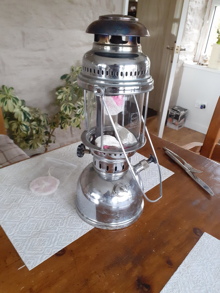

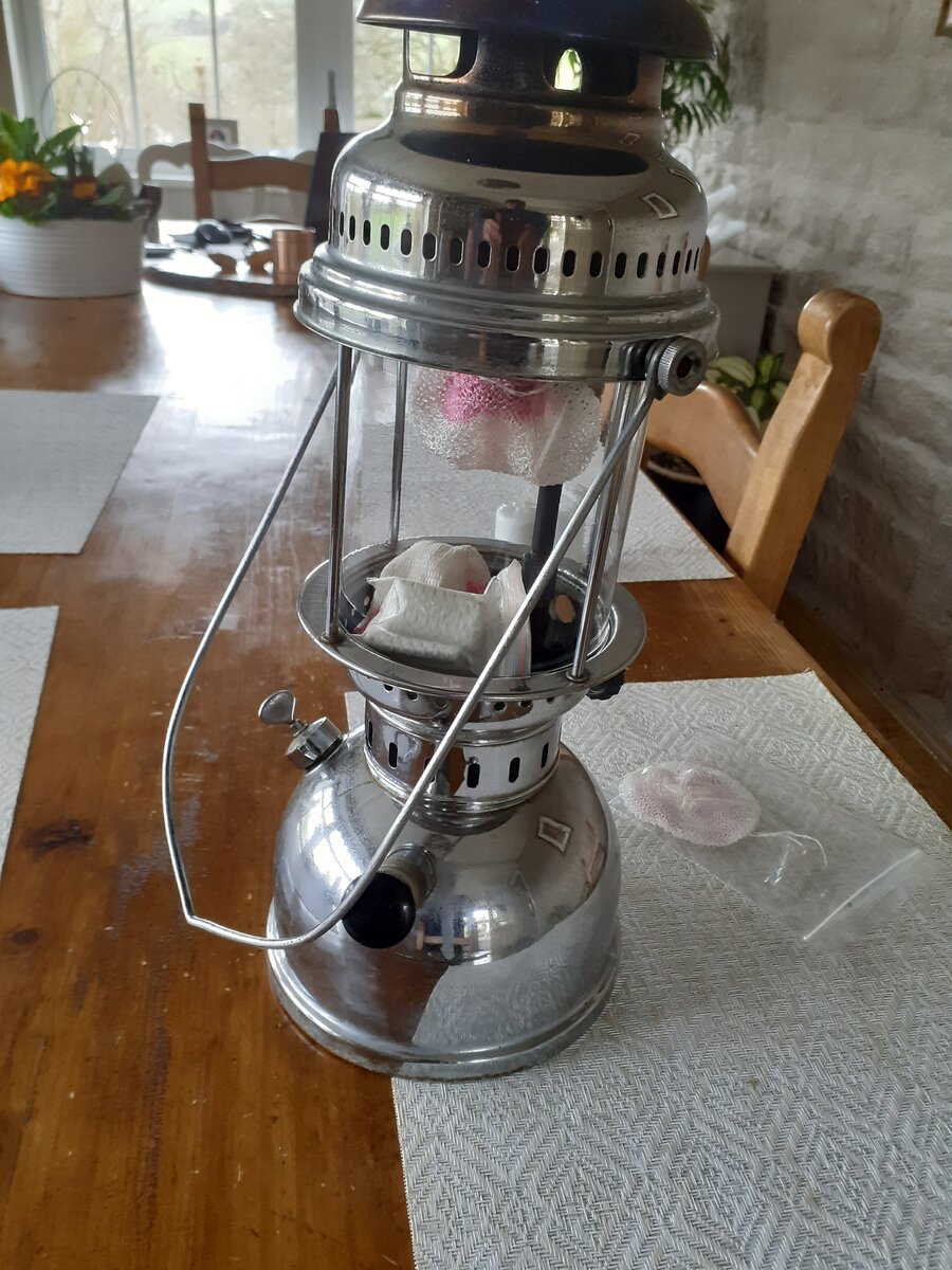

    Thanks to your help and Assorted wicks and Chimneys my lamp is now cleaned and repaired .

  17. Fireexit1 United Kingdom
    3,536
    And will we see it working later on ? :lol: - don't forget to take some nice photos of it and put it in the reference gallery here: Portugal

    i was going to sell it at Clitheroe auction but my wife likes it so i think it will be an ornament
  19. podbros
    4,099
    That looks very nice and glad you are keeping it :thumbup:
