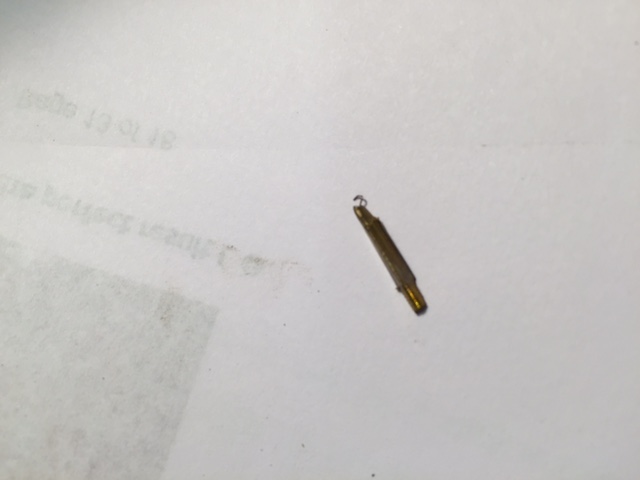

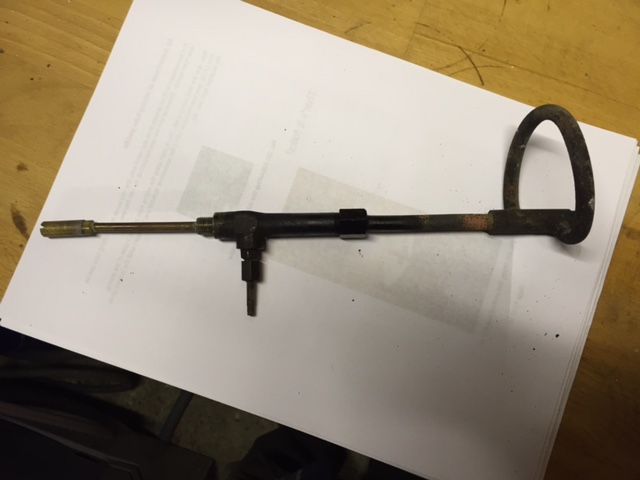

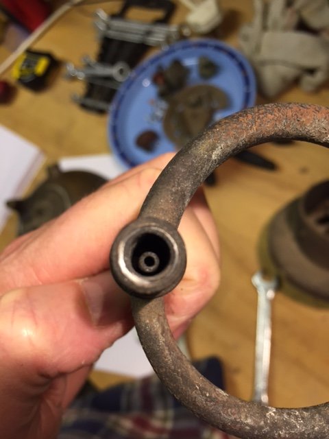

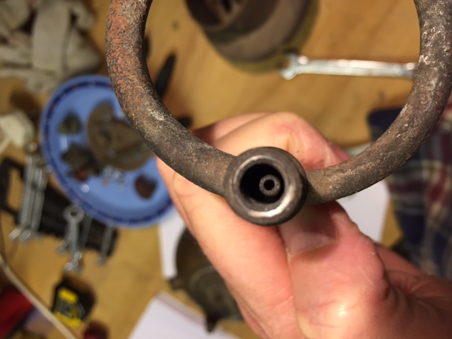

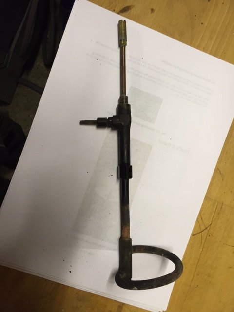

    Ok thanks for all the help. Pics to help be clearer for you all. First is the Vaporiser, I said it was bent, but I am no longer sure on that. One problem I do have though is being able to unscrew the top from the bottom?
    Next is the top of the Vaporiser where I removed the Jet nipple. Inside was a little brass spike with a wire on the top (pricker I assume) thats shown on the following pic and the wire was badly damaged. Should it simply screw out? The end of the brass bit seems to have a screw thread in it.
    The next post will have a few more photo's seems I need to make the file sizes smaller next time

    You might be able to straighten out that pricker wire if you're very careful but I think you'll end up replacing it. I'd be guessing but it'll either unscrew or be a push fit. Doubtless, someone who actually knows what they're talking about will be along shortly... :D

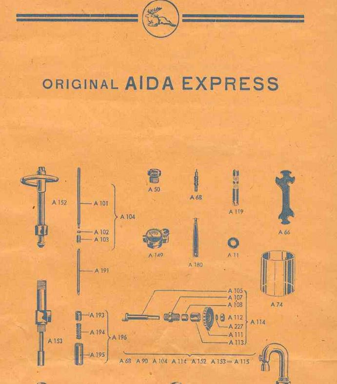

    This may help it is from the CPL referenc library, if you are a subscriber you can access it and more.

    You still have the valve block fixed to the generator. Unscrew them and the pricker rod can then be unscrewed from the eccentric block. The pricker rod is threaded and a new pricker can be screwed in. I think a Petromax pricker will fit. ::Neil::

    The problem I have is I cannot unscrew them. They seem quite happy joined together. I will try some of the special mixtures mentioned to see if I can un-seize them.
