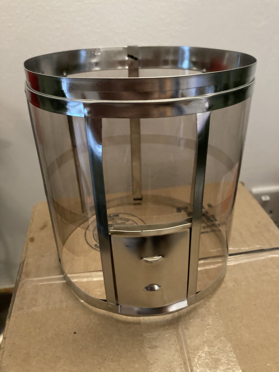

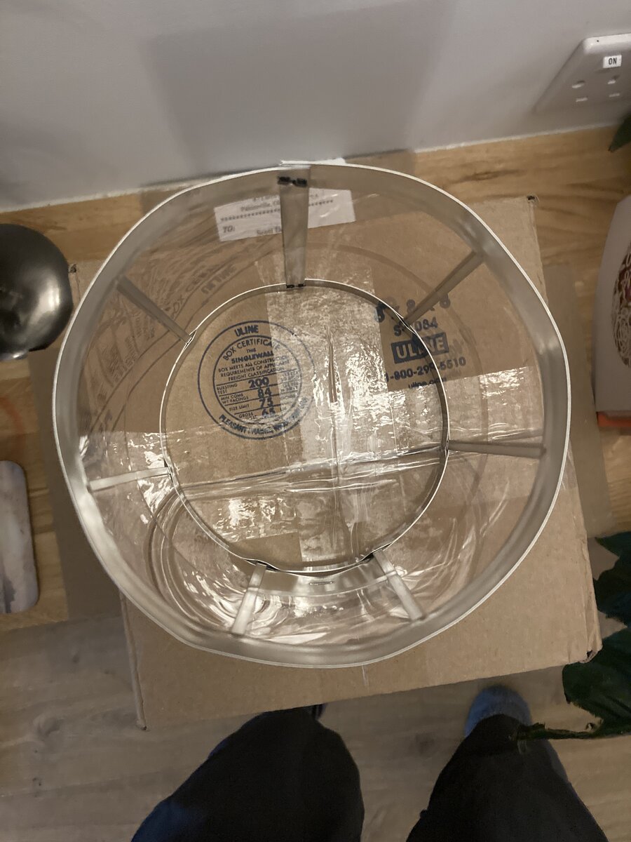

    It finally arrived! Must admit I was like a schoolboy on Christmas morning when the postie pulled this from her bag! Fred certainly makes a great mica chimney, I don’t know how he does it for the money. The 327 really looks smart now. I have found replacement mica to refurbish the old chimney and may reinstate that to the 327 eventually if I can do a decent job of it.
    I suspect that when I finally find an affordable 427 that will likely be in need of a chimney anyway, so I am hopefully a step ahead!

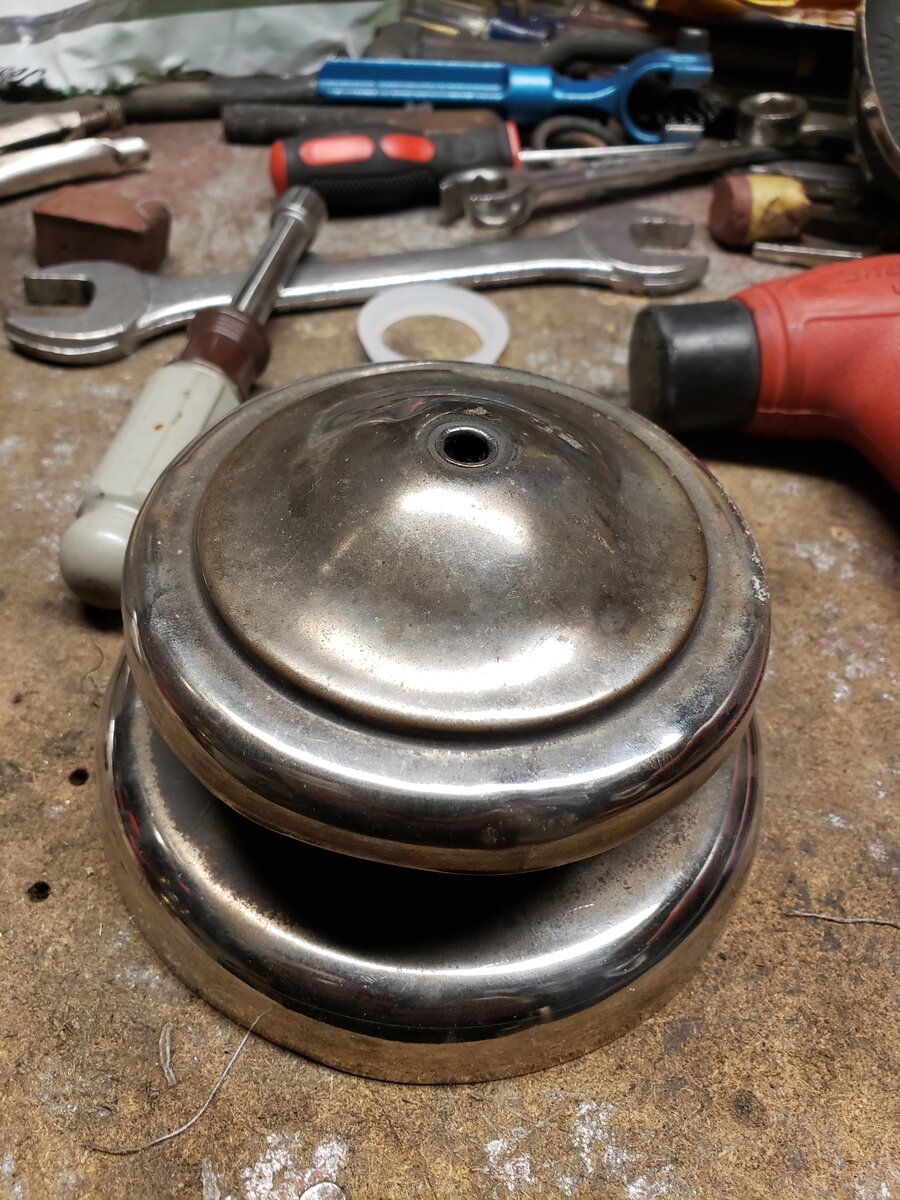

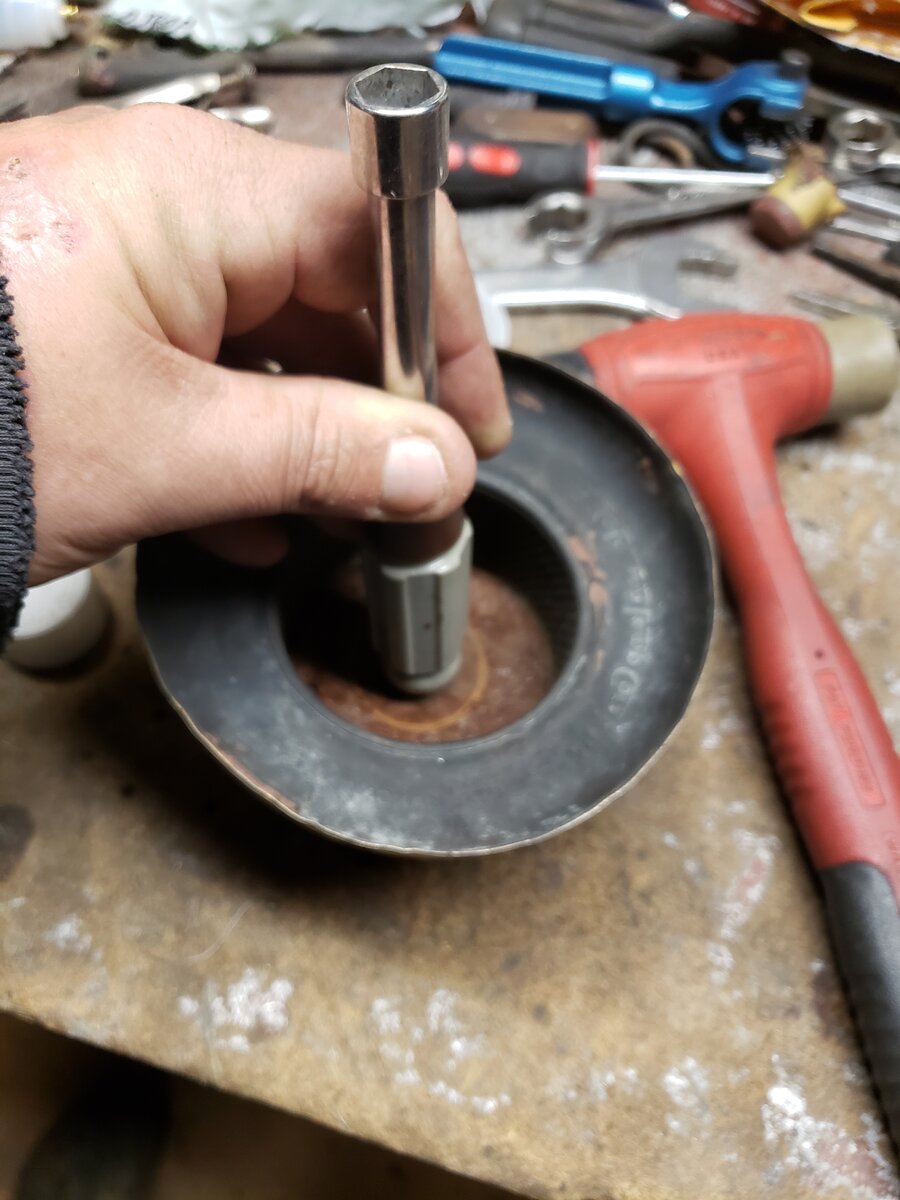

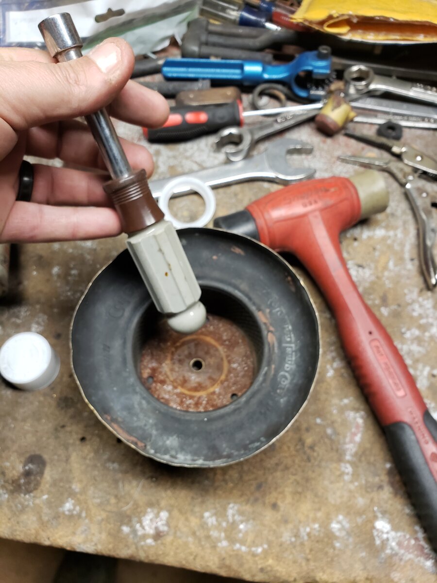

    Okay, now you need to fix center of your vent! Use a rounded handle and a hammer, place the vent upside down on a wood bench, place the rounded handle on the bottom rivet and strike with hammer until fixed. It also tightens up loose rivet as well...
  14. Scott D
    Aug 10, 2020
    756
    Yorkshire, UK
    It will stand up ok to that? I didn’t want to further damage the vent. I assume it’s been dropped on it’s head at some point, the top of the fount was slightly concave too.
  15. Joshua Culp United States
    Feb 9, 2021
    38
    Wisconsin, USA
    Oh yes, you can even straiten them as well. They are tough.
