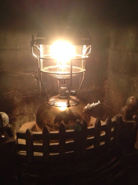

    I'm new on here, found this great forum when searching for new seals for an old and very rusted Tilley X246B which I have had since the late 1970's. It was used and much abused over hundreds of nights fishing on beaches, especially during the winter. Its been over-pumped and I re-soldered the base over thirty years ago and was (is) on its second, I think, vaporiser, but its hung on a nail under a leaky lean-to roof for over twenty years - until I rediscovered it and remembered how much I like the soft glow and hiss of a pressure lamp. Here it is, re-sealed, rust scraped off, but leaving enough so the hood does not fall apart :) but it works... Here it is - working not too badly, although it could do with a lot more work!
  2. OldGreyDog
    Aug 1, 2014
    85
    Essex on Sea
    Oooops, I messed up attaching the photo - sorry... Here it is now - I hope :)

    Update... Massive thank you Jeremy (X246A) for the excellent replacement frame for this one, which Is now looking a thousand percent better and can now be safely hung up - without risking the handle parting company with the frame :)
    There was a bit of a pressure loss soon after recommissioning which showed up as pulsing (thanks again to Jeremy for sound advice). I think this was the result of me over tightening the gland nut onto the pump cylinder, thereby pushing the seal out of place. Entirely my own fault - I should have looked more closely at the way these parts work together...
    The lamp seems to be settling in now and is used a couple of evenings per week in the fireplace - a nice relaxing light and feature that's enjoyed by all here, including the dog - who treats it like an open fire and lays down in front of the hearth as soon as its lit... :)
    Nearly forgot... I have also now fettled the other Tilley I had in the shed and alternate its use with the first one...
    Edit (addition)... Looking forward to a few Autumn nights camping now - a perfect opportunity to use the lamps 'in the field' :)
