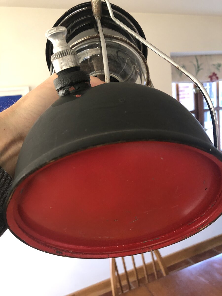

    I somehow found myself buying a Tilley x246B (05/75) recently, and have been really enjoying using it. Like lots of well made old things it has a sense of quality and satisfaction of use. A pic below.
    Yesterday I picked up another 246b (9/80) from a blurry marketplace picture for £8. It was once red, but has had the worst paint job in history.

    5. I see comments that the hood is enamelled and there isn’t a paint suitable. I’ve used heat paint on motorcycle engines in the past, but I’m guessing this has already been tried, and found unsuitable?

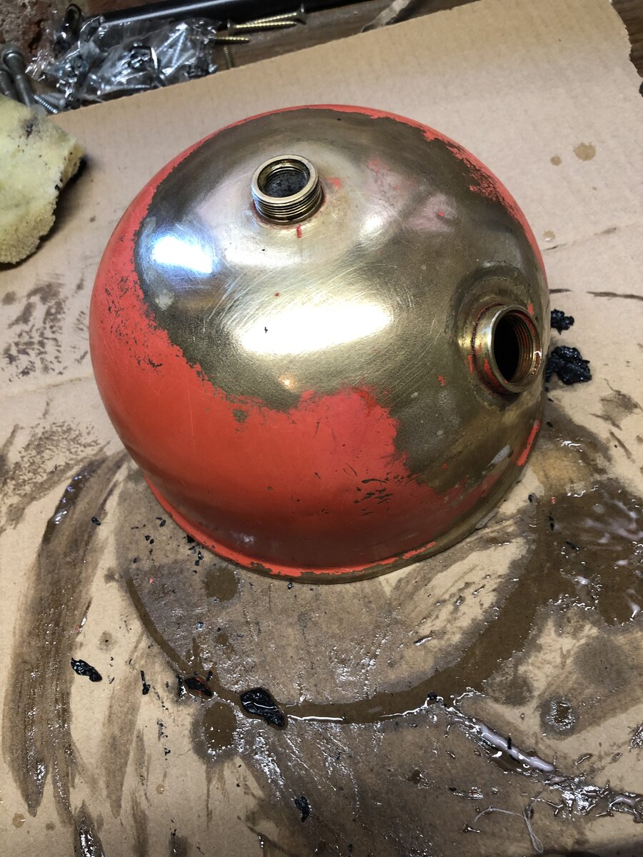

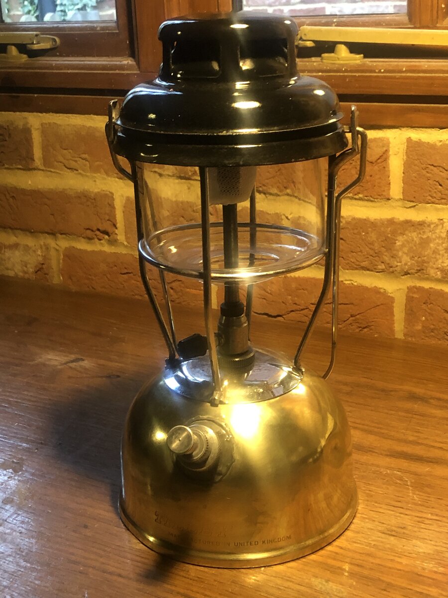

    Some good progress today while waiting for the seal kit and new mantle to arrive. Paintstripper, 0000 wire wool and some metal polish did well. I mounted the tank in my lathe (very carefully!) to make polishing easier. Pump rod, pump body and vap tube were 600 grit wet sanded on the drill press.
  14. BigStevie
    @Mark_H
    You’ve been busy! Well done, you’ve put the hours in!

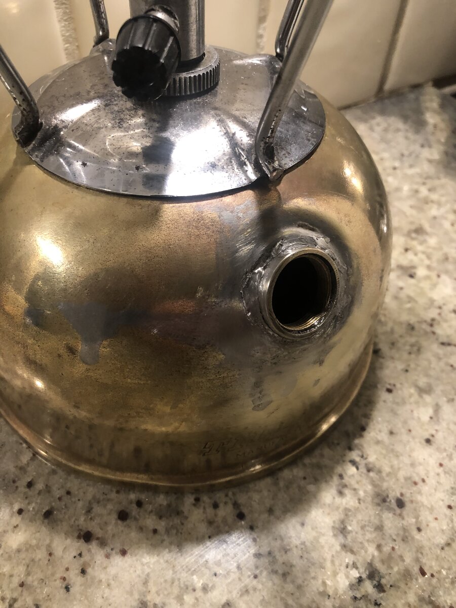

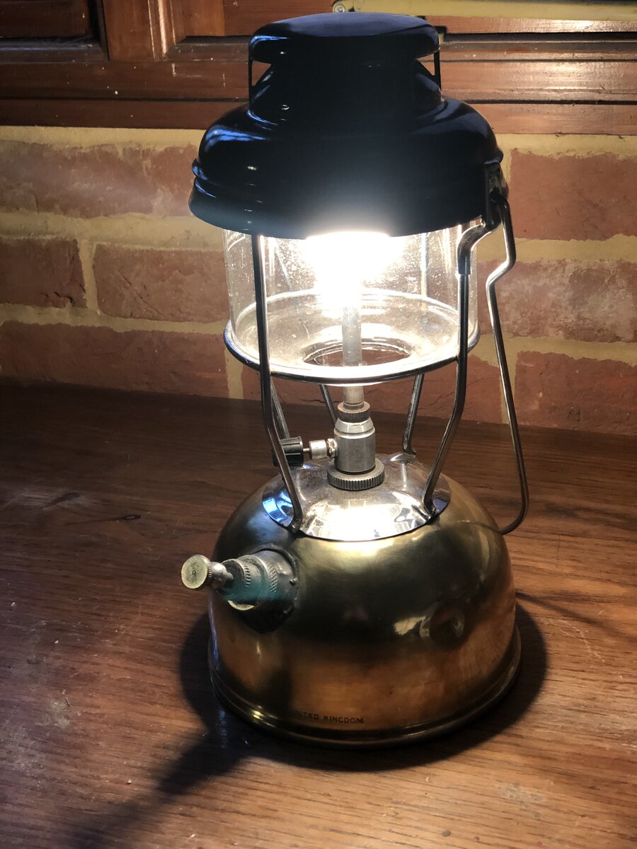

    Well, apologies for such a long gap between posts, but this lamp is now done!

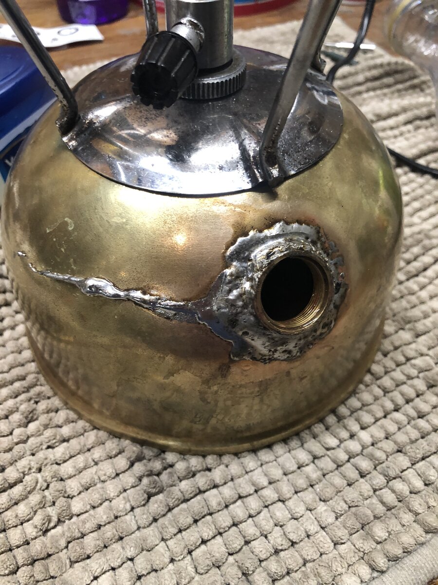

    First I tried silver soldering the tank, but not having a a good blowtorch I was getting a bit of all or nothing effect - several times the filler neck detached completely and fell inside the tank. Here’s an early attempt….
    Clearly an aesthetic disaster!
    Further attempts much neater, and seemed airtight
    But sadly after fully cooled overnight was still leaking. By this point I’d had 7 or 8 attempts to seal the cracks, and came to the realisation that I didn’t have the right tools.
    It also seemed that when new, these fillers would have been jointed from the inside before the base went on, which meant I’d never really get a good seal this way with my skill level.

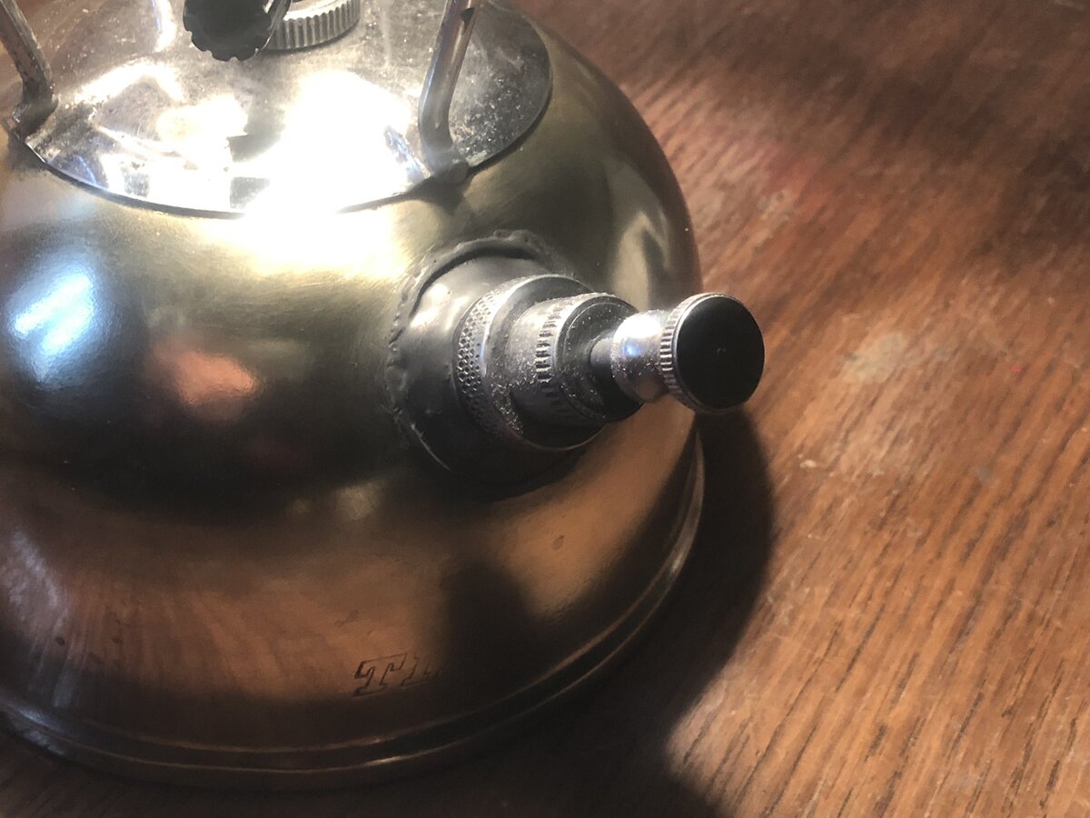

    So, I attempted the epoxy route. Araldite metal to be precise.
    Not the most beautiful - but it works! I smeared this on the inside rim, then used the pump body to sort of hang the base from to exert a ‘clamping’ pressure. Then went round the outer rim. Left for 24 hours, and pressure tested. Success. I can sand off the lumps in due course.
    Not too bad for £8 and some seals.
    First light
    So, that’s one more rescued from landfill, and it’ll get used regularly, and looks nice. Thanks for the useful advice along the way

    Were you using lead solder, often called electrical solder (50% lead / 50% tin)? It's best for this type of repair.
    Merry Christmas
  18. MYN
    Merry Christmas.
    Soldering requires quite a lot of practice to make perfect. Sometimes its not easy to get the solder to wet the metal. You need to get the area concerned hot enough. Its not easy for a pump and fount due to heat can easily get conducted away from the intended area while, the other non-intended parts of the fount gets overly hot to hold.
    You'd need a gas torch to heat the area fast enough to melt the solder. Having the right flux often determines whether or not it'd be successful.
    I have used a reactive (acidic zinc chloride) flux for soldering large steel, brass and copper sections. They are much more efficient than the resin flux used for small electronics solder. Resin flux is non-reactive on metals and preferred over other more nasty fluxes for delicate work. They don't cause corrosion.
    On the other hand, reactive/acidic fluxes start to work, removing surface oxidation even before you heat the parts and they don't burst into flames if overheated by a gas torch. But, beware of the toxic zinc chloride fumes.
    On many such occasions, I have used with success, a 200-300W electric soldering gun as heat source instead of a propane or butane torch.
    On my accounts, the reactive flux was so effective that the melted solder immediately adhered to the metal area that I suspect wasn't even that hot. I could touch with my finger, the spot that was just next to the solder even before it re-solidified.
    On the negative side, you'd need to ensure that all areas are flushed clean from the acidic residues after the job, else they'd definitely promote corrosion later on.
    Anyway, the Araldite epoxy is pretty strong and should hold. It is generally fuel-resistant but only prolonged exposure would tell. Most epoxies are not resistant to UV radiation, so you might want to overcoat it with acrylic or polyurethane finish if its going to be frequently exposed to direct sunlight.
  19. Henry Plews
    3,050
    Correct. This is also the case with the control cock fitting and the studs to which the cage fastens on earlier models. This applies to Vapalux / Bialaddin lamps and other makes too.
    I guess you've already realised that that is really the only way to keep the joint tight and would have worked for soldering. Sometimes, just getting the area hot enough for the existing solder to run is enough to effect a repair though adding a little more solder will do no harm.
    As with all soldering jobs, cleanliness is paramount, use a cleaner/degreaser or acetone or even a good detergent to remove all trace of fuel residue before applying flux.
