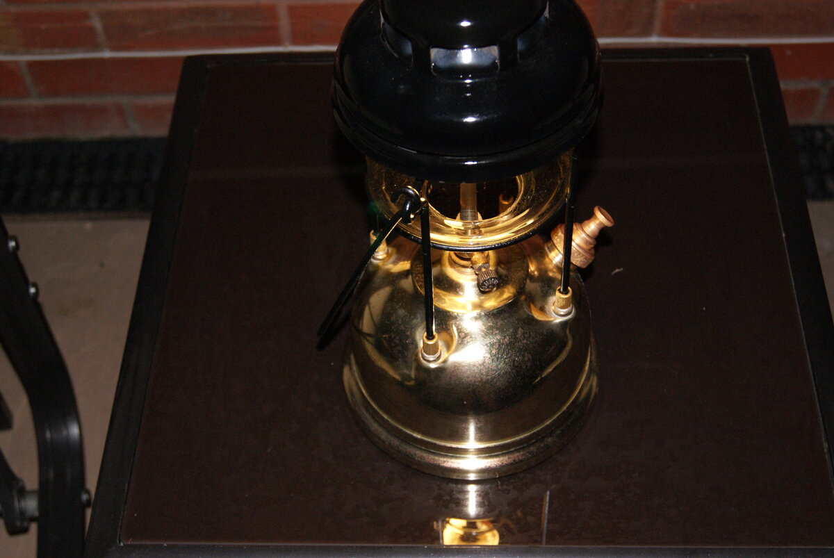

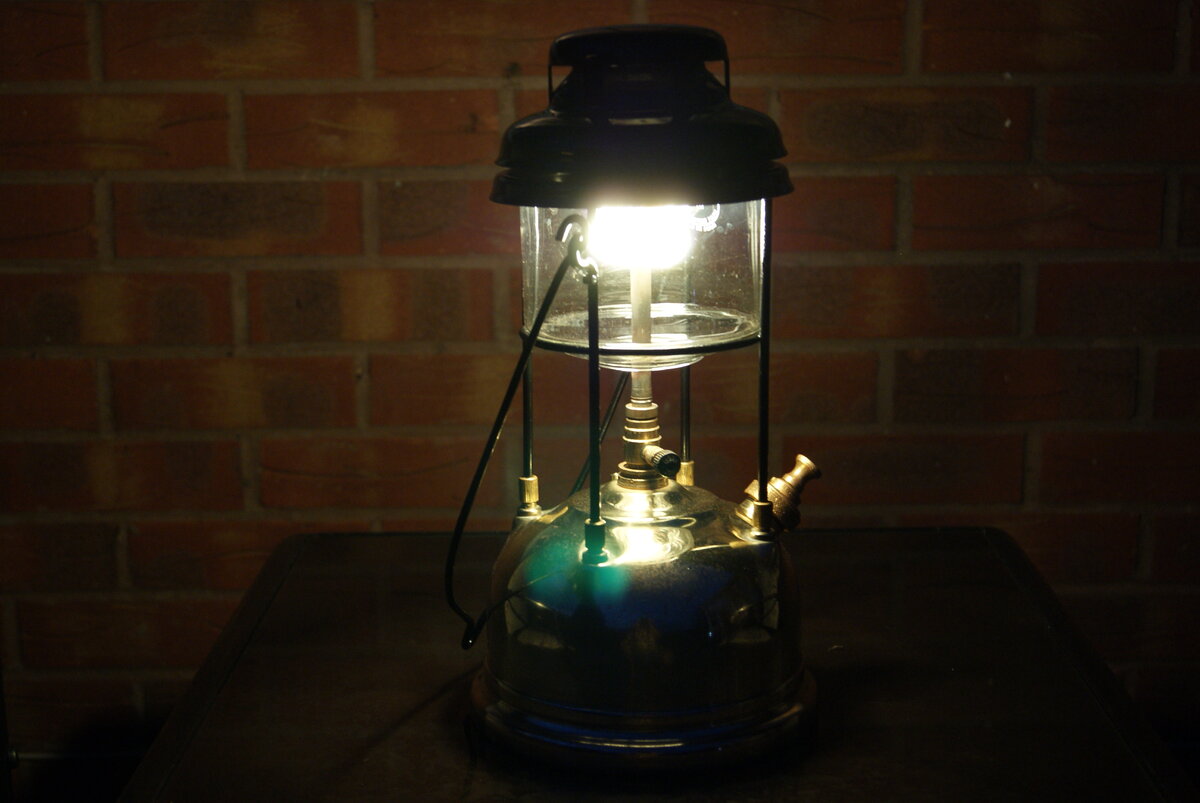

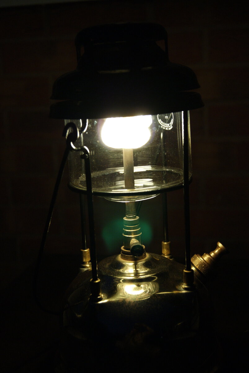

    Guardsman not used for at least ten years. The frame was in an extremely rusty state so I rubbed down smooth and left in a rust dissolving solution to prevent any further rust developing and then sprayed with VHT black. The fount had previously had most of the gold paint removed at some time and then polished poorly. I didn't feel confident in re-spraying gold paint on top o0f brass so I've spent some time polishing the fount with Solvol polish.
    I don't know if I've done right by doing all these things but it is many times better than it was and I'm quite chuffed as it's my first renovation. The main thing is, it will be used and not scrapped.

    These are such good lanterns, so far better they get to be running than languishing uncared for in the corner somewhere.
  3. Gary Waller
    Apr 3, 2018
    618
    It looks great and it working well. Just a query but do you know why there is no middle ring around the frame?

    I don't know why it's missing. I noticed when rubbing the frame down that there was one on at some time. It's been very neatly cut off level with the uprights. I just assumed it was a modification done at the factory. I'm new at this game so I haven't any experience. Should there be one fitted?

    Great work! Another lamp saved :thumbup:
    16,652
  7. BigStevie
    Good to see another lamp saved, well fettled! There would have been a middle ring on the frame originally, no worries without it. Modern Tilleys have it missing now by design...

    You have done a very good job fettling your X246 Guardsman. Well done and it’s great that you posted the money shot.
    One of the great things about our lampie hobby is that as you progress in restoring lanterns you start to learn to tackle new skills, one being spray painting founts (tanks), and in doing so you learn and become proficient in these new skills.
    Now, your Guardsman needs a mate ...... But beware, when you have 2 lanterns, they breed ........ :lol:
    Enjoy your new hobby and I’m looking forward to reading your future posts.

    The way the handle is fitted indicates the frame is from a 1950 - 1954 lantern but the tank is 1954 - 1957. In this case, I don't think it's too important. You've made a fine job of your first fettle, the lantern looks good and is working well. Congratulations.

    It was given to me by a family member who hadn't used it for about ten years. The frame was pitted due to corrosion so I had to rub it down to reduce the pitting. The fount was tarnished heavily. I must have spent over an hour polishing with Solvol by hand. The polishing revealed craters of copper which I couldn't remove; you may be able to spot them on the photo's. I wouldn't have a clue on its authenticity of the different parts. I was intent on using all the existing parts where possible so I suppose it's a mongrel! I really enjoyed doing it and it works. On to the next one.

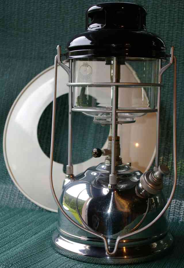

    This version has the ‘new’ X246 tank; a cage with 'ears'; and absolutely no stamping.
    [From: Tilley X246 (1950 -1954) ]

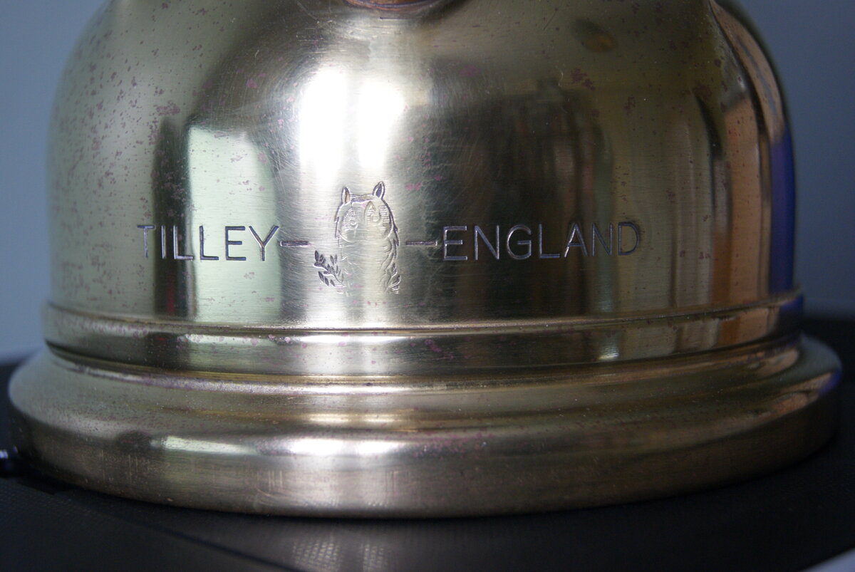

    1954 - 1957: This version has the cage with clips mountings a for the handle (bail); tank with a groove around the top of the base flange; tank stamped with “Tilley — Owl — England”; no date stamp until October 1956. (See note below).
    [From: 1954 - 1956 Tilley X246 Guardsman Deluxe ]
    [From: 1954-1957 Tilley X246 De Lux ]
    October 1956 onwards: Tilley date stamped the tanks; inverted the base plate; and reintroduced the 1950 to 1954 tank (ie no groove around the base flange); thence to X246A and X246B.

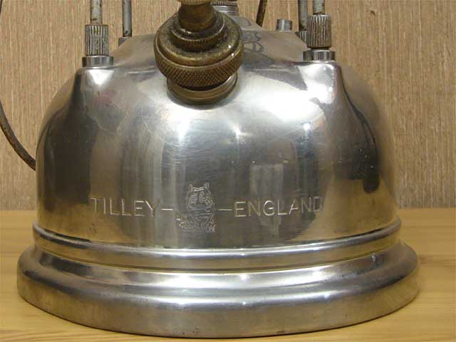

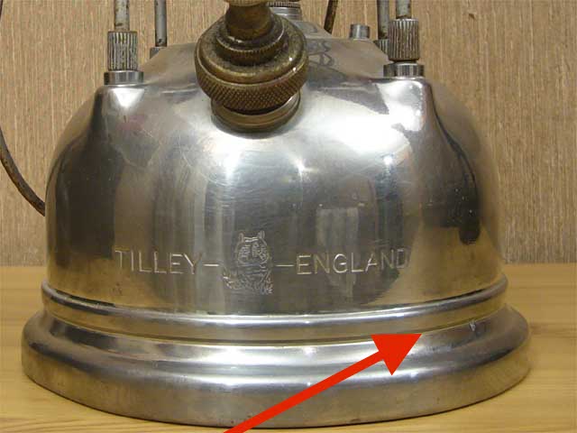

  21. Tony Press
    11,053
    I’ve had a PM about “the groove”.
    This is “the groove”:
