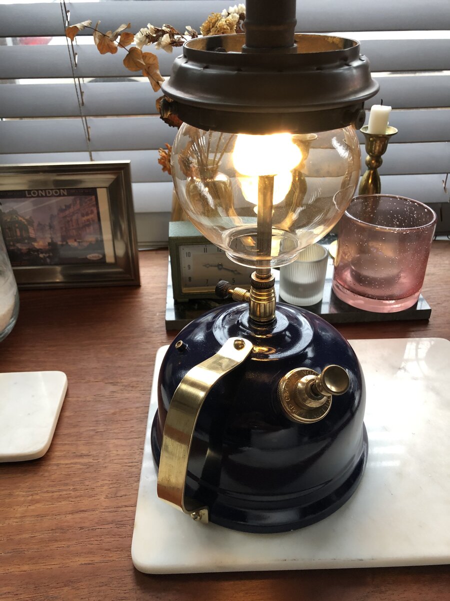

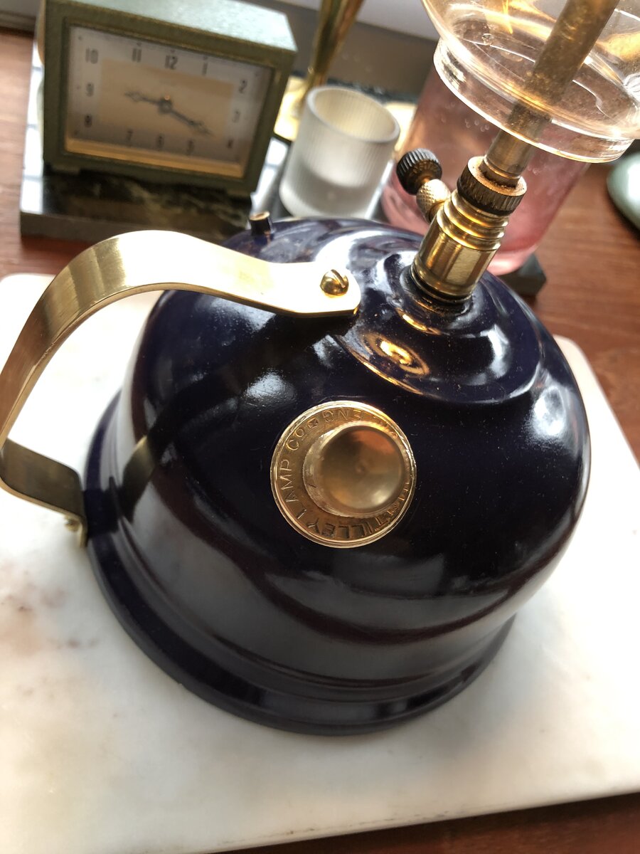

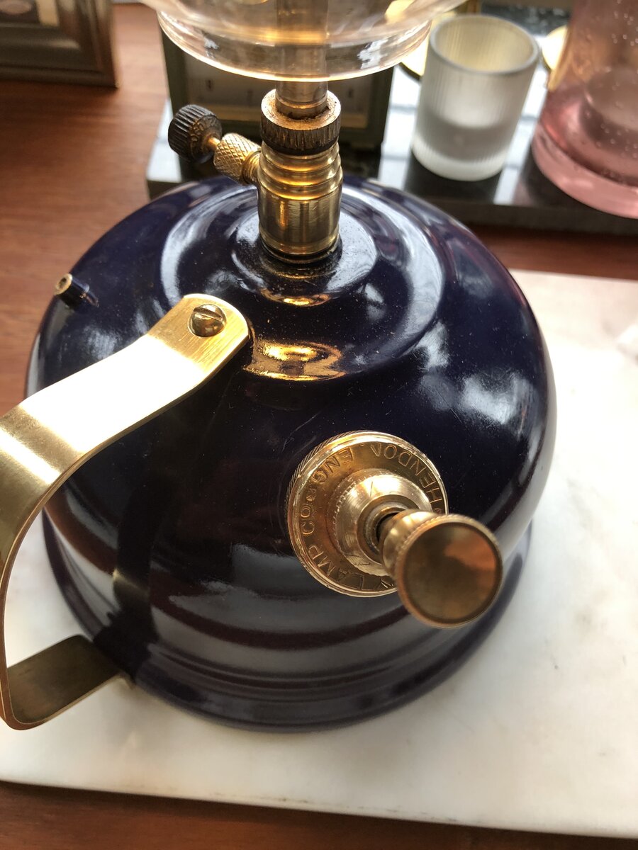

    Hello chaps,
    I'm a pressure lamp virgin and have recently acquired a lovely old Tilley table lamp (photos attached) and wanted to call on your bright minds (!) to garner a bit more information about it.
    It came off eBay and I've done a little bit of restoration work by polishing the brass components (which were pretty tarnished) and also gave it a new coat of paint. I've given up trying to shine up the gallery for now as it just blackens after the lamp has been in operation.
    From my research, I think it's a Hendon-made TL14? or TL13? What was the difference between the two models? I was wondering if anyone was able to date it? I'd guess it's late 1930s or 1940s?

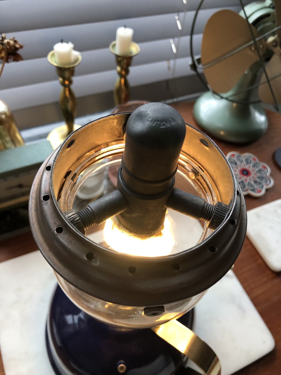

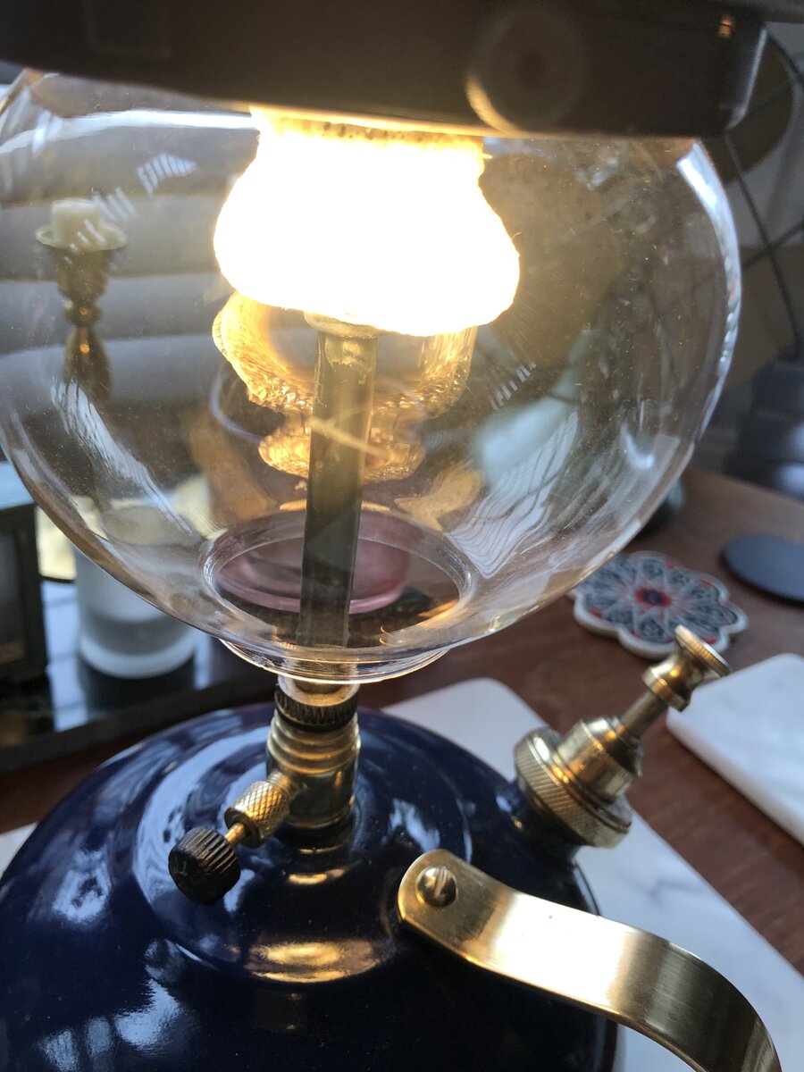

    Also, I've noticed the vapouriser looks particularly short on this lamp. Is it the wrong type for this model? I believe it had a new one fitted before I bought it and also new seals.
    Lastly, I'm finding the pump is getting very stiff. I've tried unscrewing it from the base and clearing it by pumping any residual paraffin out but it's still pretty stiff. Any ideas on how to make it a bit less resistant? I feel like I'm going to end up with early-onset arthritis in my hands if I can't soften it up!
    Thanks for your words of wisdom in advance.
    Best,
    Shane
  2. podbros
    4,117
    Hi Shane!.. Welcome to CPL!:)
    Nice tablelamp and working well :thumbup:...I think they were designated a TL14 with the clear globe and a TL13 with the shade?
    Someone will no doubt correct me if i am wide of the mark;)
    Is the pump leather dry? If so try a spot of paraffin or 3-in-1 oil...you shouldn't need much
    Thanks for sharing your photos : )

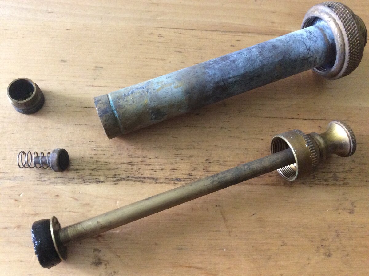

  4. BigStevie
    @Shane C.K.
    image.jpg Hi Shane and welcome to the forum.
    You need to strip the pump apart and give it a c,want and perhaps a new leather. There’s also a non return valve in the end of the pump.
    Hope this helps!
    Stevie

    It's a waste of time trying to polish the gallery if you plan to use the lamp. The copper in the brass oxidises when it gets hot and forms copper oxide (CuO) which is black. If you polish off the oxide, all you're doing is exposing some fresh brass to oxidise once more. Eventually, between you polishing and continued oxidation everytime you use the lamp, the brass will become so thin it'll form a hole at some point. On the other hand, if you leave the copper oxide layer alone, it prevents the oxygen in the air getting to the brass underneath and the gallery will last much longer.
    The choice of vapouriser is up to you - you can fit the shorter 606 or the longer 169, depending on what you think looks better. I think the 606 was the original Tilley fitment though - the lamp was designed for low-ceilinged cottages etc.
    Hope that helps...

    Hi @BigStevie ,
    Thanks for the photo again.
    So, I've taken the pump apart cleaned it and given the leather a bit of paraffin as suggested by @podbros , but it's still pretty stiff. Would DW40 help or is that a bad idea? The leather does seem to be in good condition. (see photo)
    I can't seem to get to the non-return valve you mentioned, but I can see the spring through the holes at the bototm of the pump. Does the bottom of the pump unscrew as well?

  11. David Shouksmith
    WD40 isn't much better than paraffin for oiling pump leathers - it's apparently just paraffin and perfume designed to disperse water (WD=water dispersant) rather than lubricate anything. Any oil will do (except boiled linseed oil) so try a bit of olive oil from the kitchen cupboard. Paraffin is a definite last resort!!

  14. BigStevie
    @Shane C.K.
    As you can see in the photo I posted, the nrv sits in a cup that screws into the bottom of the pump tube. They can be tight!
    If the pump leather is dry, soak it overnight in some oil. Continued stiffness May be due to the pump cylinder being deformed, does it look straight and round?

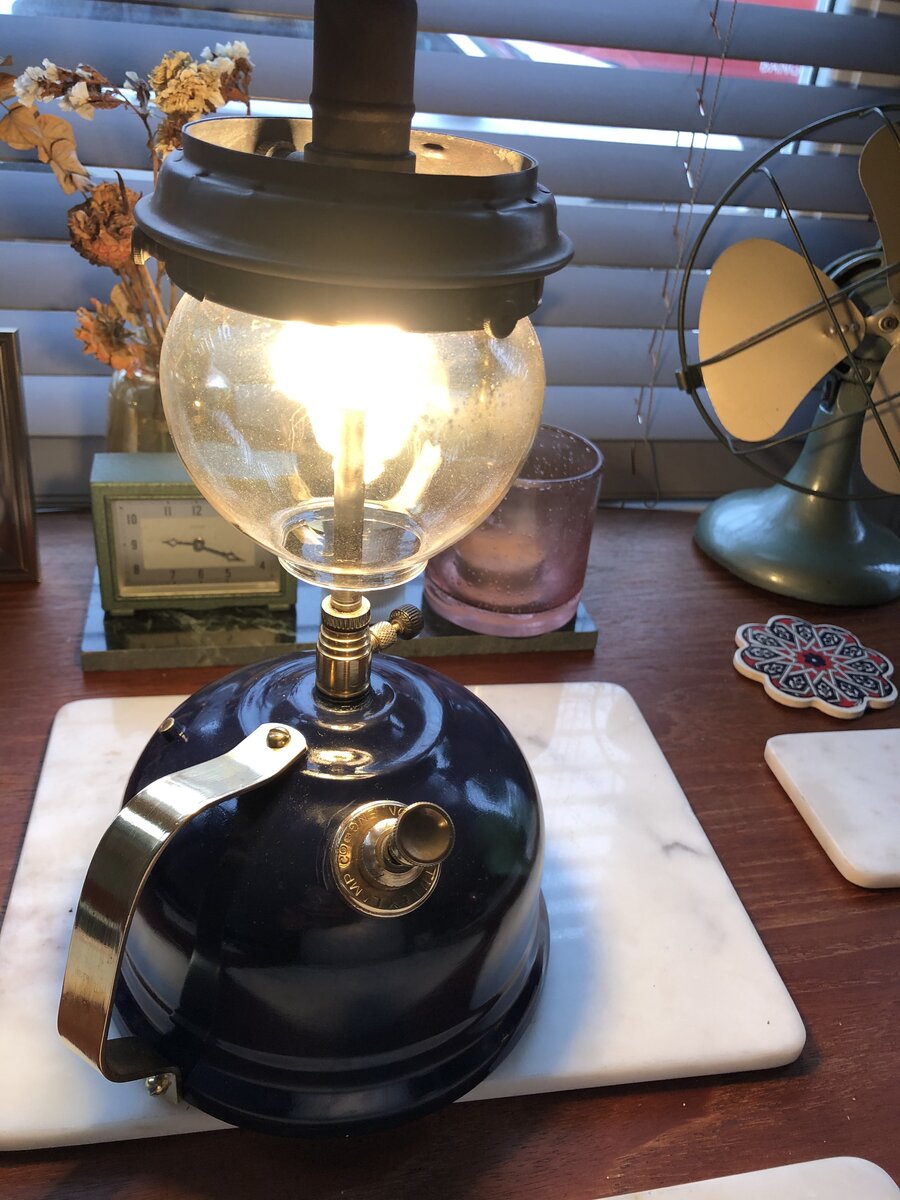

    Hi all,
    Just an update - after a little soaking, the olive oil worked like a charm. The pump is much less resistant now - my wrists are very grateful!
    It's also burning more brightly now as a result. Attached are some photos of it in action!
    Thanks everyone for all your hints and tips and if anyone has any information on how to date the lamp, do let me know.

    I concur with @podbros on the type. TL14 has the Tilley 182 globe.
    Nice lamp, and welcome, @Shane C.K.

    It's working well and the way to date the tank is to check the depth of the socket which the control cock screws into.
    If there is just enough depth for the current control cock, which is called a GF., then the earliest that the tank can be is 1940, but if the socket is much deeper then the tank is pre 1940.
    The vapouriser which is currently fitted is a 606, but your lamp would look better with the longer 169 vapouriser.
  22. Henry Plews
    3,068
    Referring to Jim Dick's book (Tilley The Versatile Vapour Lamp), the earliest incarnation appeared in the early 1930's when the longer (aprox 7") 169 vapouriser was standard. The shorter (aprox 5.5") 606 didn't appear until the advent of the X246 after WWII.
    @Shane C.K. the only difference between the two vapourisres is the length.
    If you wish to purchase a 169 vapouriser, be aware that they are produced in the far east, they are expensive and there is no guarentee of quality.

    You're a bit out David. TL13/14 is contemporary with TL10 so not later than 1945.
    Vaporiser 606 was available in the 1930s. It was used on the AL10, 11 and 21 lamps. However for all the table lamps and lanterns the standard would be Vaporiser 169. ::Neil::
