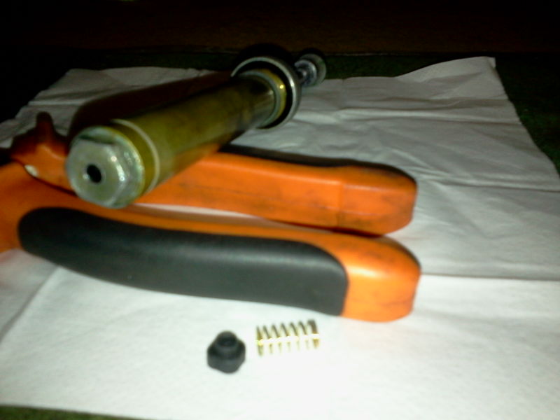

    The bit I can't work out is,how to get the washer valve and spring into the bottom of the pump. I poked the old one out with a bradawl and pulled the spring out with pliers but now can't get the new ones in. Anyone know how to do it please?
    I read on another post that the hexagon end with 2 holes in comes off but am not sure if mine should or not as I can't shift it so far. 1337204567-2012-05-16_22.44.33.jpg
  2. Mackburner
    That hex nut unscrews. They can get tight and you need to be careful you don't crush the tube. However if you grip it close to the end where there is a brass insert you should be able to get enough of a grip to unscrew the cap nut. Might be good to use a little penetrating oil and another trick is to shove the end in boiling water which will loosen any fuel residues that might be welding the threads together. ::Neil::

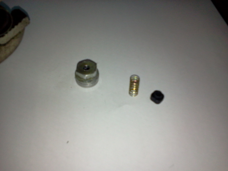

    Well I got the Hex end off but its got a bit attatched to it and I can't work out where the washer and spring go? They're too big to go down the hole in the middle. 1337252618-2012-05-17_12.05.57.jpg
    Anyone know what do do next or have I broken it?

    Hi
    Like most of the newer Tilley type pumps the two metals of the pump ( alumimium & brass ) have corroded together & you have pulled out the whole pump end which is not unusual at all , just frustrating :doh: , I have found that when they're this bad they are nearly impossible to seperate with out doing any damage & you would be better finding a new one :thumbup:
    What you will need is a new old style brass top pump to replace this one ( from a Guardsman lamp & they are readily available on ebay ) or perhaps someone here may have a spare , if you have no joy PT me & i'll have a look in my spares box to see if i have one :D :thumbup:
    Stu :D :thumbup:

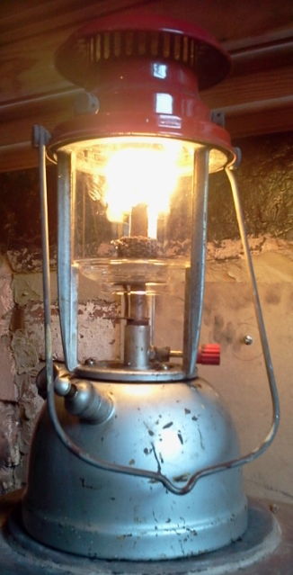

    Here's a photo.
  19. Shed-Man R.I.P.
    1,032
    Well done Jane; a bargain at that price. I think it is the Bialaddin 315 model. A very reliable and well made lamp. I particularly like the hinged support for the spirit cup on that model; the hinge allows you to raise the cup for preheating and then to lower it out of the glass globe when the lamp is going. It is always best to do this as it stops the breheater material getting too charred when it is in the lowered position. Were the other two in as good condition? You are definitely inflicted with advanced "Lampitis" now. Good fettling - Steve.
