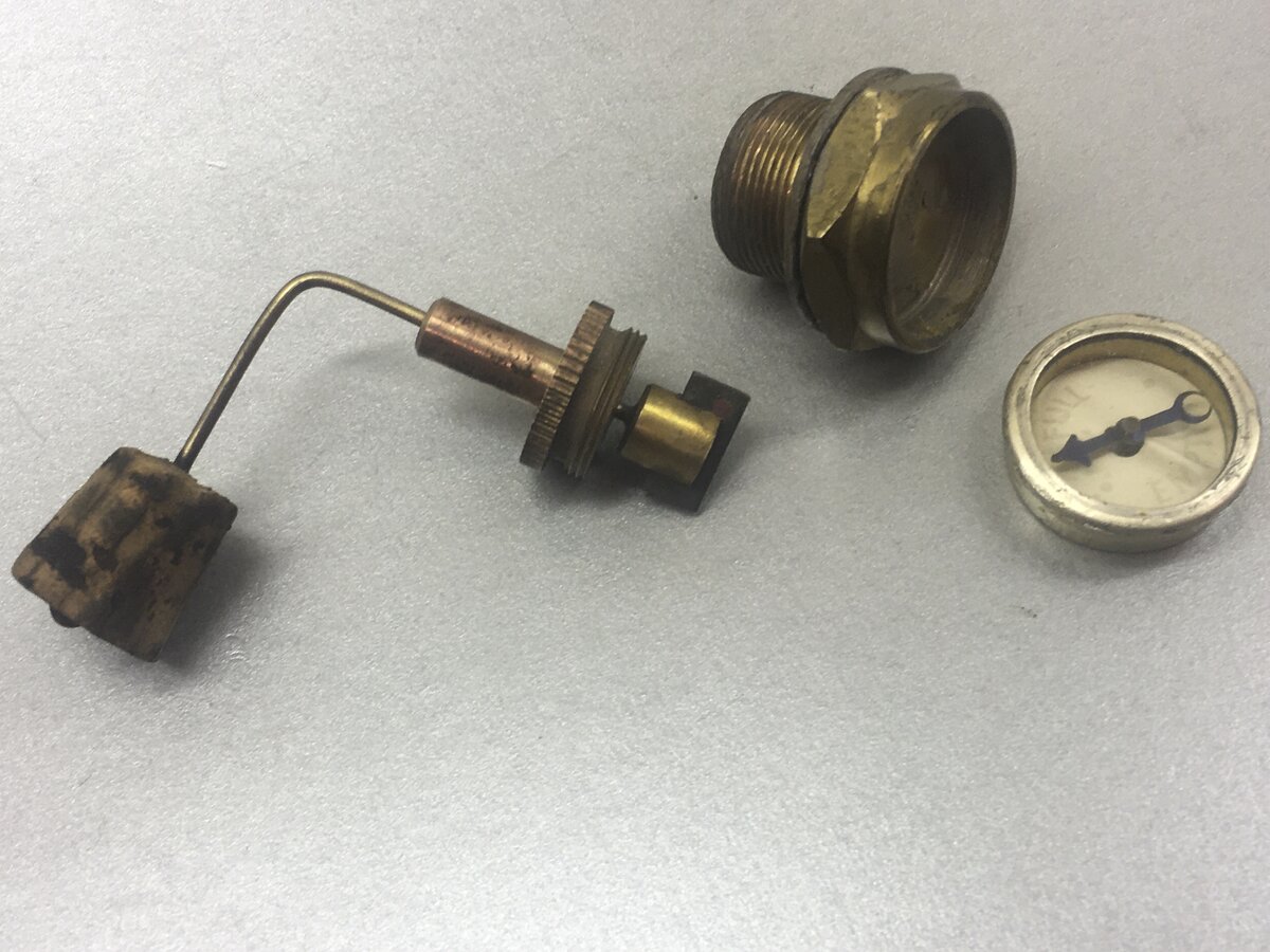

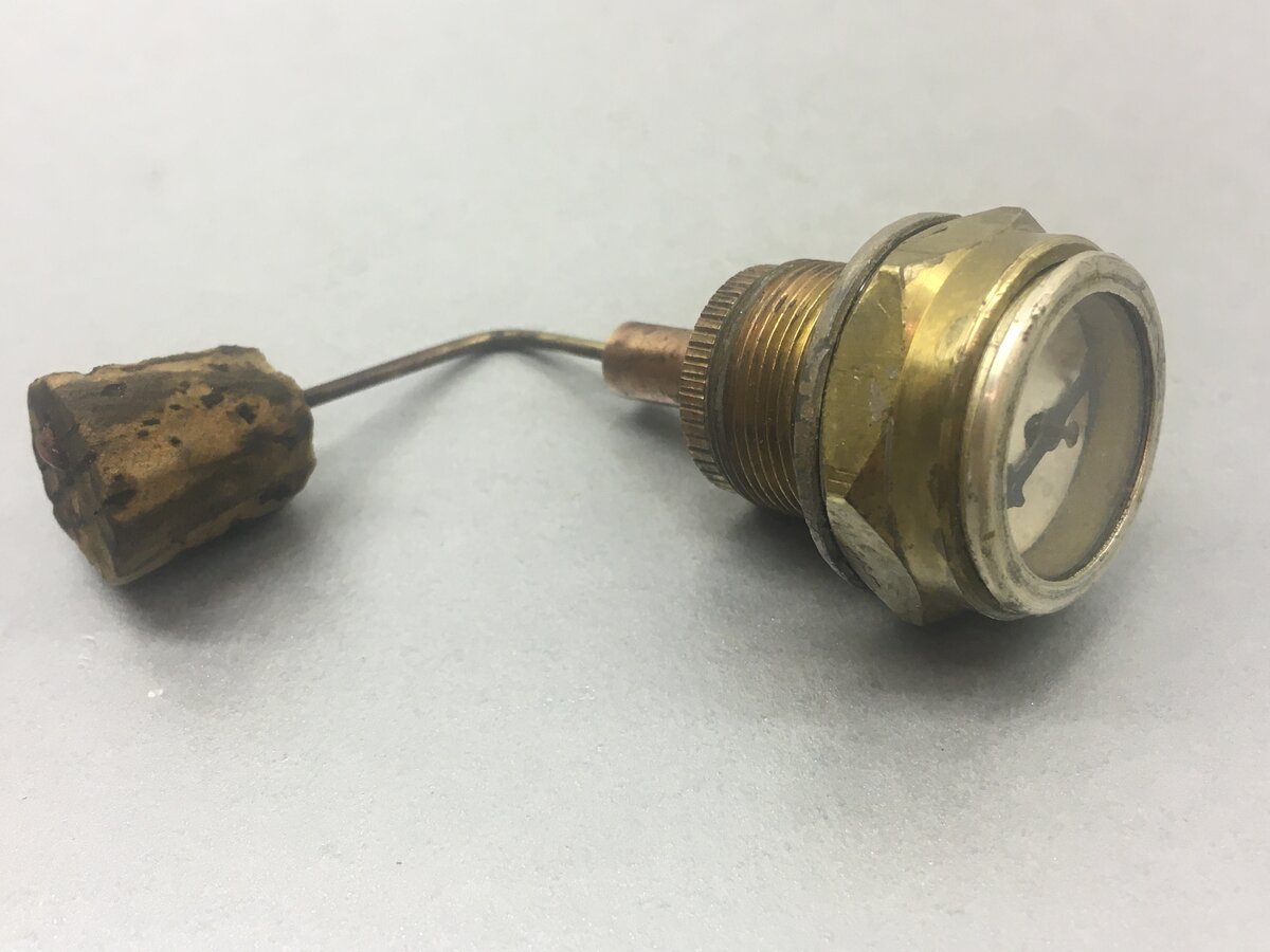

    Hello all I have replace the seals in the pump bar one which is damaged but it still holding on for dear life and I am unable to get it out, the pump works quite well but there is an issue with tank itself the pressure gauge glass is gone so I don't know it that will effect pressure or not but if it does is there a way to seal it?. Cheers.
  7. podbros
    4,100
    Hi @Balach Mor
    Do you mean the fuel level gauge?
    Is it a heater with the big steel tank?
    cheers
    edit : a photo will help here with advice for the correct model? :thumbup:
  8. Balach Mor United Kingdom
    Feb 23, 2023
    32
    Isle of Skye
    I'm not sure it is a gauge on side of the tank, it being the fuel gauge would make sense, I believe the tank is made out of steel with a mettalic coating/paint as most of the tank has surface rust on it
  9. podbros
    4,100
    Ok, it sounds like the larger fuel tank that was used on the R55 and similar on the other livestock or brood heater types
    I believe that the hex fitting is the seal to the tank (possible lead/fibre washer) so having no glass doesn’t mean a leak
    does that make sense??

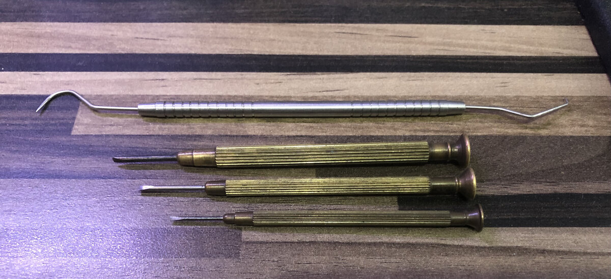

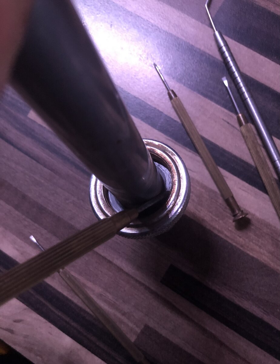

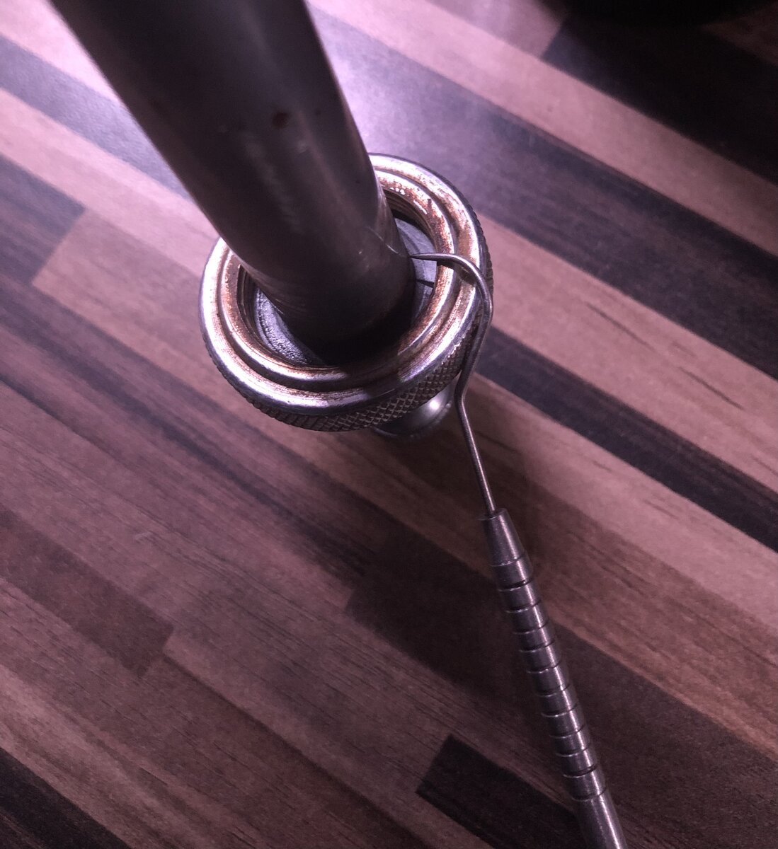

  11. podbros
    4,100
    I am assuming this type of washer?
    (it’s a different pump but the same principle having a washer in a recess)
    I use a dental type pick (ebay) as pictured but small watchmaker type screwdrivers are useful if the washer is rock hard??
  12. Balach Mor United Kingdom
    Feb 23, 2023
    32
    Isle of Skye
    Yes that is the washer, I'll give that a try and will report back when it have got it sorted

    lots of good info by members that have repaired the gauges including a recent one by @presscall
  14. presscall
    1,791
    Lancashire, UK
  15. podbros

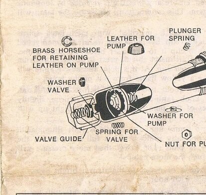

  17. Henry Plews
    3,067
    It's important to make sure the rubber pip is pressed firmly and squarely in its brass cup.
    Are you sure the non return valve assembly is the right way round?
  18. Balach Mor United Kingdom
    Feb 23, 2023
    32
    Isle of Skye
    Thanks for the diagram Henry, I seem to be missing the valve spring then.
  19. Henry Plews
    3,067
    That'll do it. Base Camp have the springs (part No. 610).
    You can make your own by shortening one from a ball point pen.

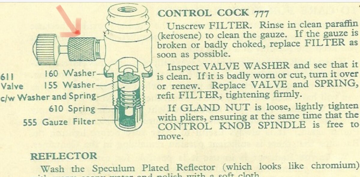

  20. Balach Mor United Kingdom
    Feb 23, 2023
    32
    Isle of Skye
    I'm impressed by the ingenuity, it works a treat, it now pressurises but I it leak at the control tap now where the picker contol is, do I need to replace it or is there a way to take it apart?, Cheers.

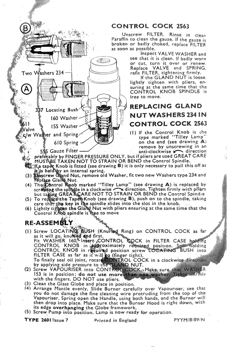

  21. Tony Press
    @Balach Mor
    1. Unscrew the control knob (anti-clockwise) from its shaft.
    2. Unscrew the packing nut from the shaft, and removed the washer or O-ring(s) inside the packing nut. You might need to use a bit of heat on the rubber washers inside.
    3. Replace with a new washer. I use two O-rings (supplied by The Fettle Box).
  22. podbros
    4,100
    you may have a different plastic control knob ? should just pull off
    will you be posting some pictures as well at some point?
    happy solstice
    p
  23. Tony Press
    @Balach Mor
