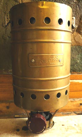

    I need ideas on fixing an old Taylors 68 pressure kerosene heater I have.
    It needs a kerosene tank and I have two ideas (I bought it w/out a tank).
    Heresy I know, but I am considering putting a gravity feed kero tank 2-3 feet or more above the unit. Anyone done this? Will it work?
    My 2nd thought is to take an old, OR a new, pressure tank from an el cheapo pressure stove and adapt this as the heaters tank.
    The stove runs on your run-of-the-mill primus kero burners. Nothing fancy. It will be placed in my sailboat when fixed.
    Your thoughts.

    As your Taylors is described as a pressure heater, it will need pressure - which will be far greater than any gravity feed you could supply it. It is the pressure from compressed air that forces the fuel through the vapourisor where it is turned to a gas to be forced through the jet - all under pressure. I'm afraid gravity will not supply the 'goods'!
    That is - unless I have mis-understood the working of a Taylors!! Which I confess I have never used. It would appear there are gravity fed Taylors too from what I can discover on the net. But it looks like a new 1.5 gal. tank with pump is in excess of £400!! :-#

  3. esarratt
    Mar 3, 2015
    63
    North Carolina, USA
    I follow on the pressure issue, thanks!
    I can adapt another pressure tank to serve the purpose; I'm pretty handy.

  20. phaedrus42
    phaedrus42 Subscriber
    2,056
    From what I can see in the photo, the burner looks suspiciously like a Primus or Optimus regulated burner. Perhaps the heater could fit on a stove fount? I have also seen cylindrical, even upright Primus stove burner founts with the burner fitting on a tube coming from the side of the fount. That should provide ample capacity and run-time.
