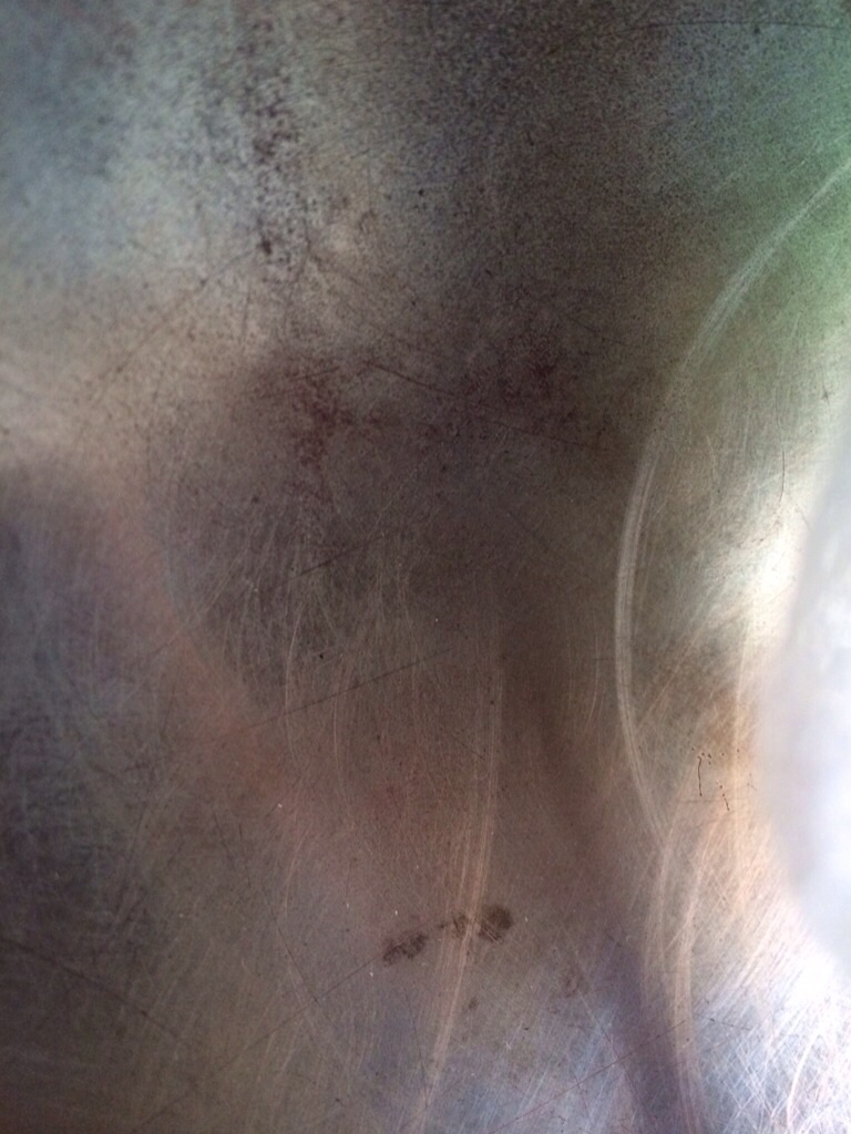

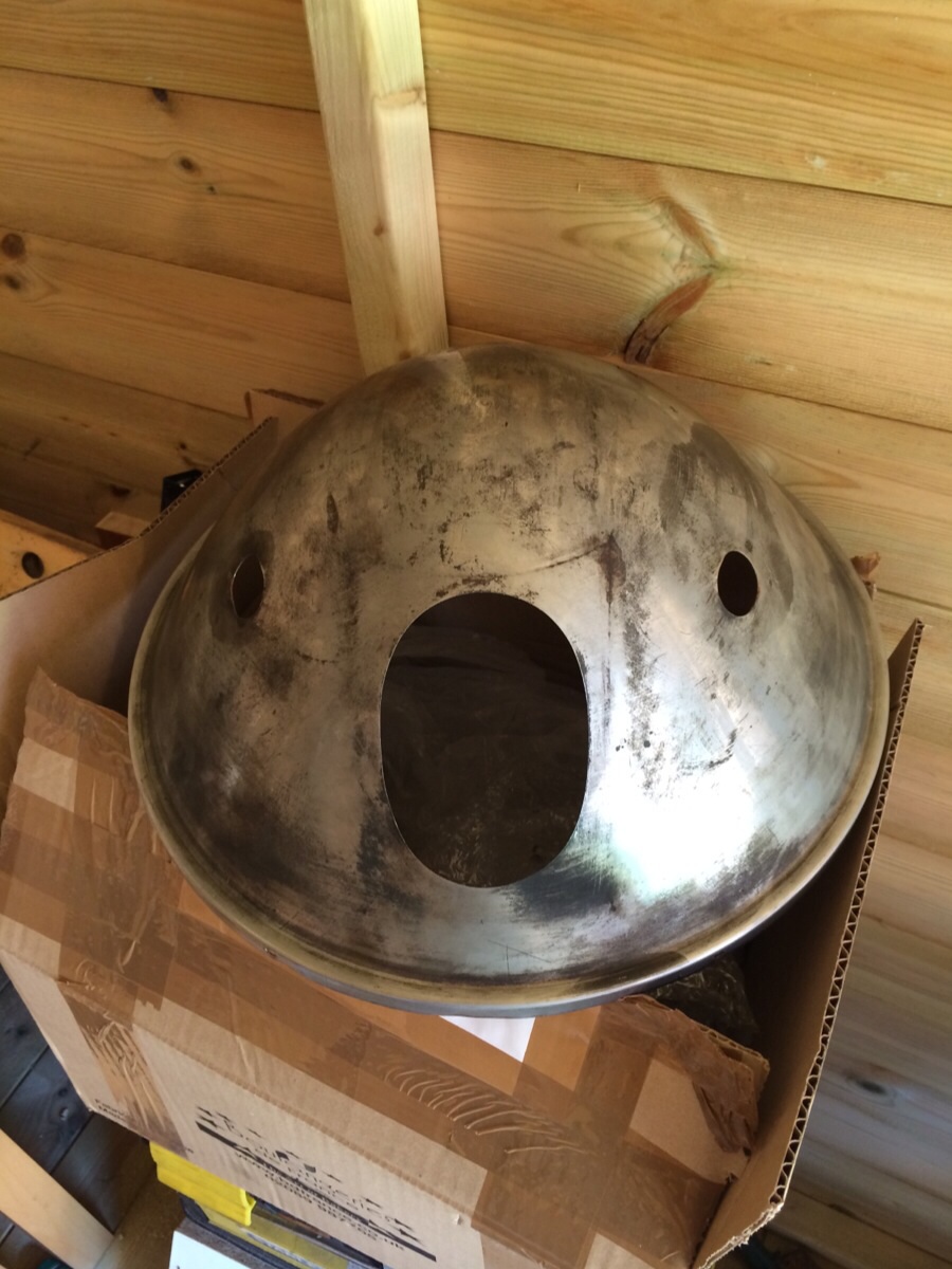

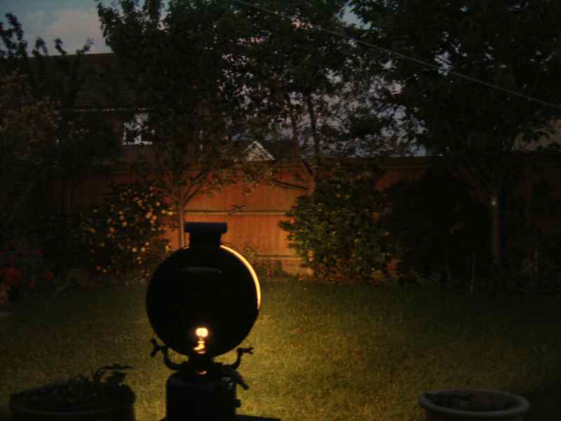

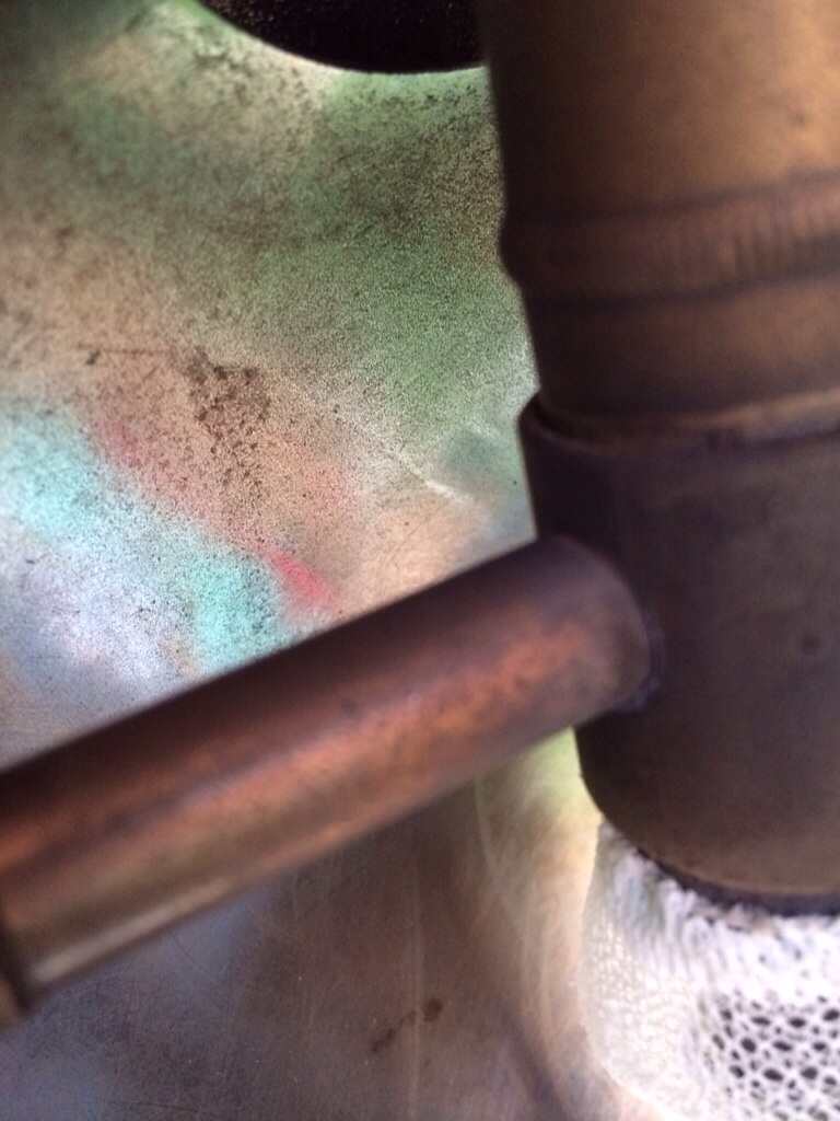

    Check out my scummy reflector. If you look at it square on, there's no reflection from the rear of the mantle at all. Hopefully, this is where my troubles lie.
    EDIT: It looks as though the lamp is lit, in the third photo. It isn't.
  18. David Shouksmith
    That looks about average for an FL6 reflector and I wouldn't worry too much about it. Still, you've got a better one on the way...

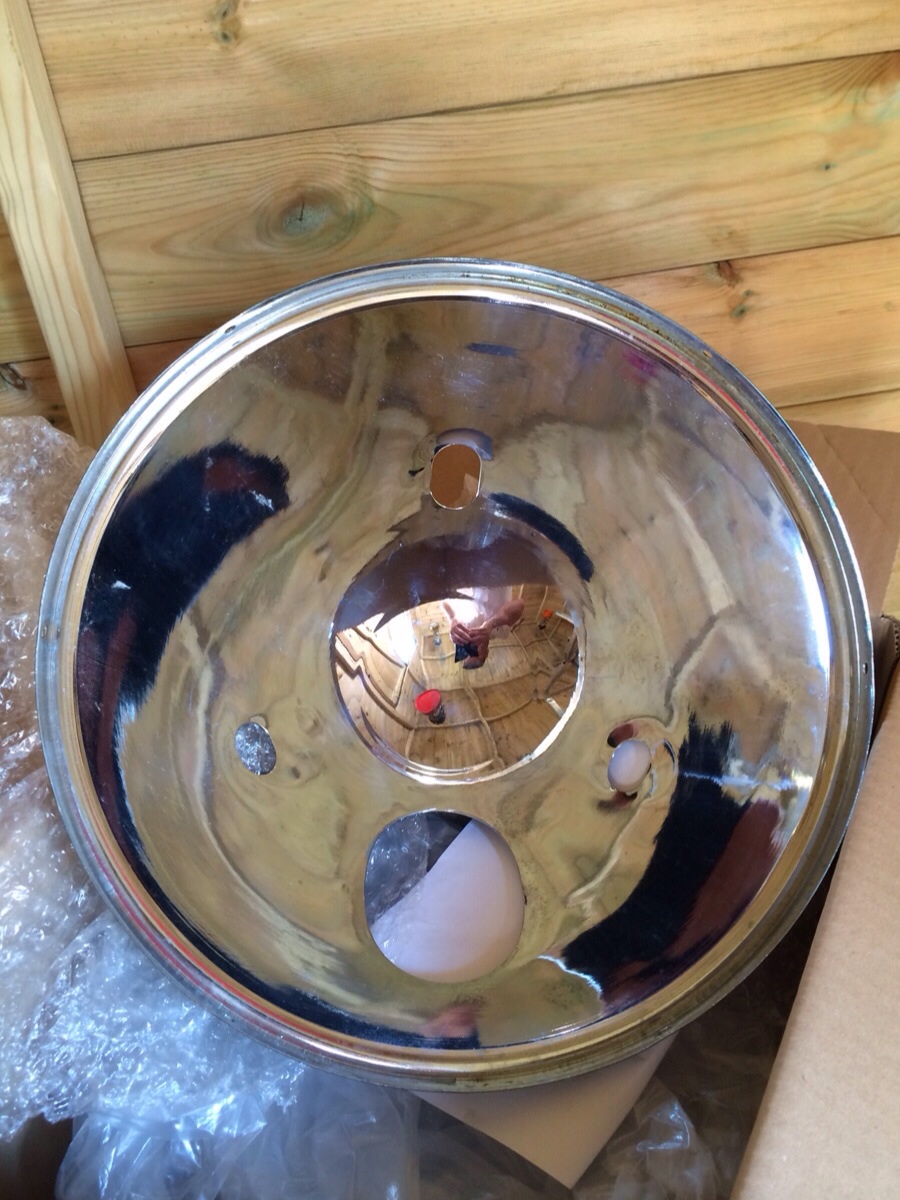

  23. Andrew-77
    Sep 4, 2013
    26

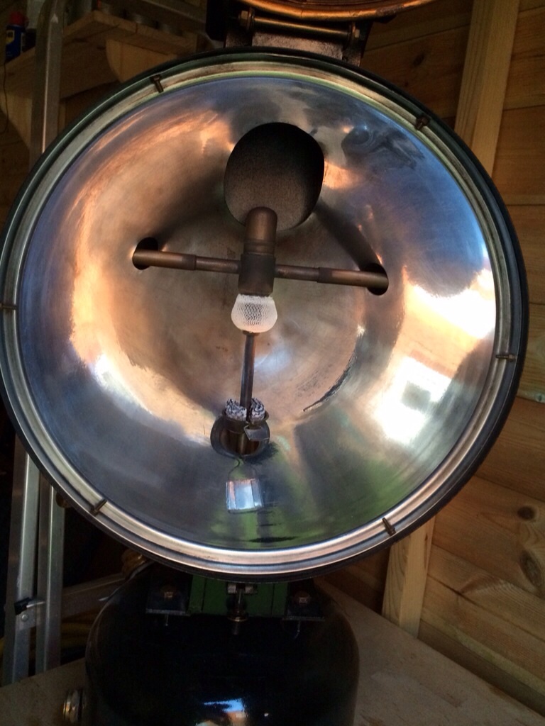

    It arrived this morning!
    Now if that doesn't make me more successful and attractive to women, then I don't know what will. If you look closely, you can see three other lamps in the pic. None of which are terribly exciting.
    I'll fit it later and try it out.
  24. Gneiss
    Gneiss Subscriber
    Oct 7, 2012
    1,590
    It is a thing of beauty when you see one in such good condition...

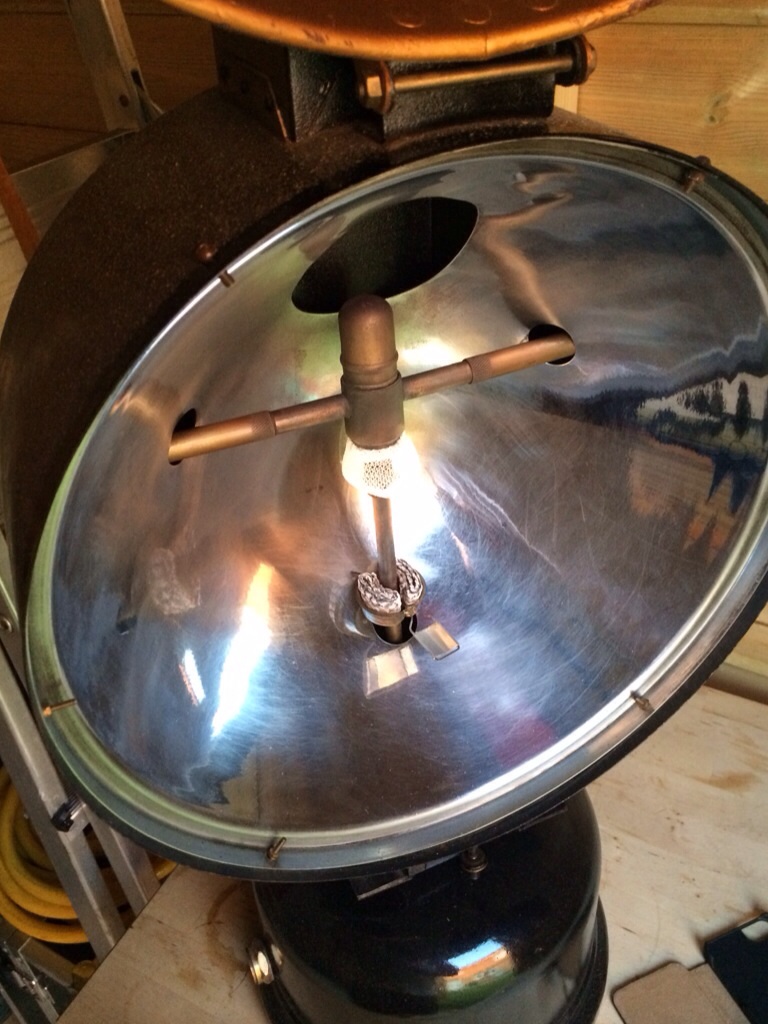

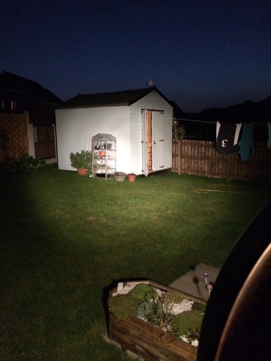

  27. Andrew-77
    Sep 4, 2013
    26
    That would have been a nice find; nothing there though.

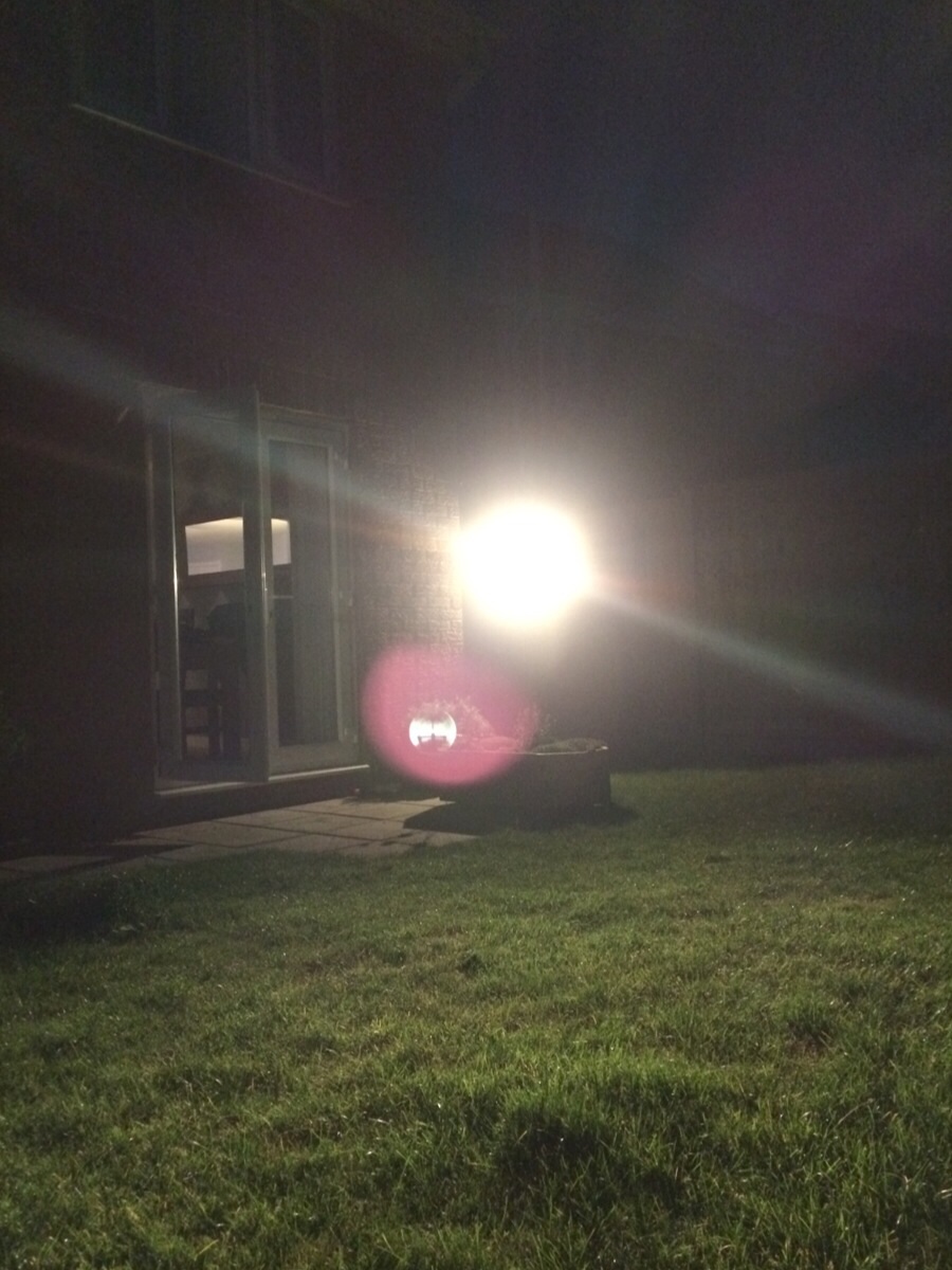

    Anyway, quake before the power of the beast! (Excuse the washing)
    I'll shut up about it now.
  28. JEFF JOHNSON
    16,882
    It's working well! :thumbup:
