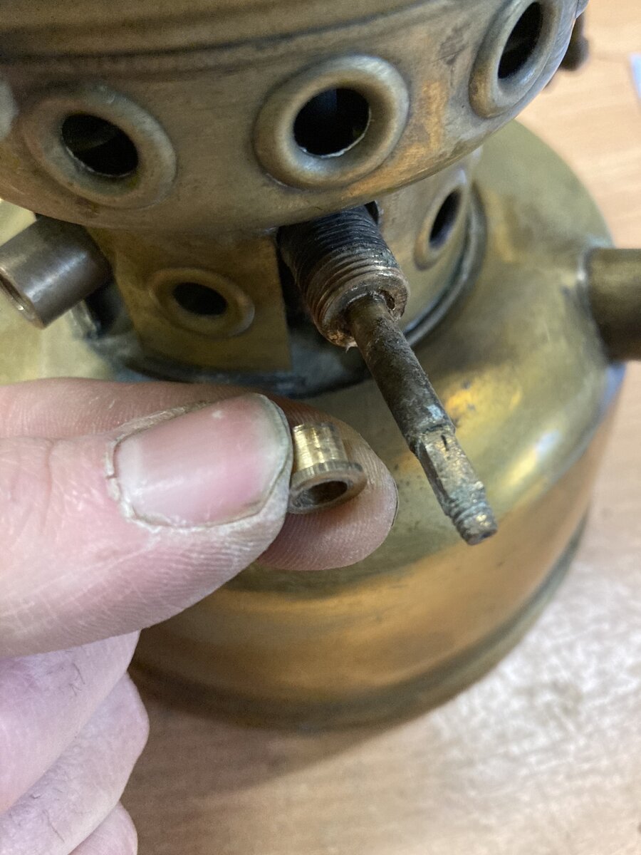

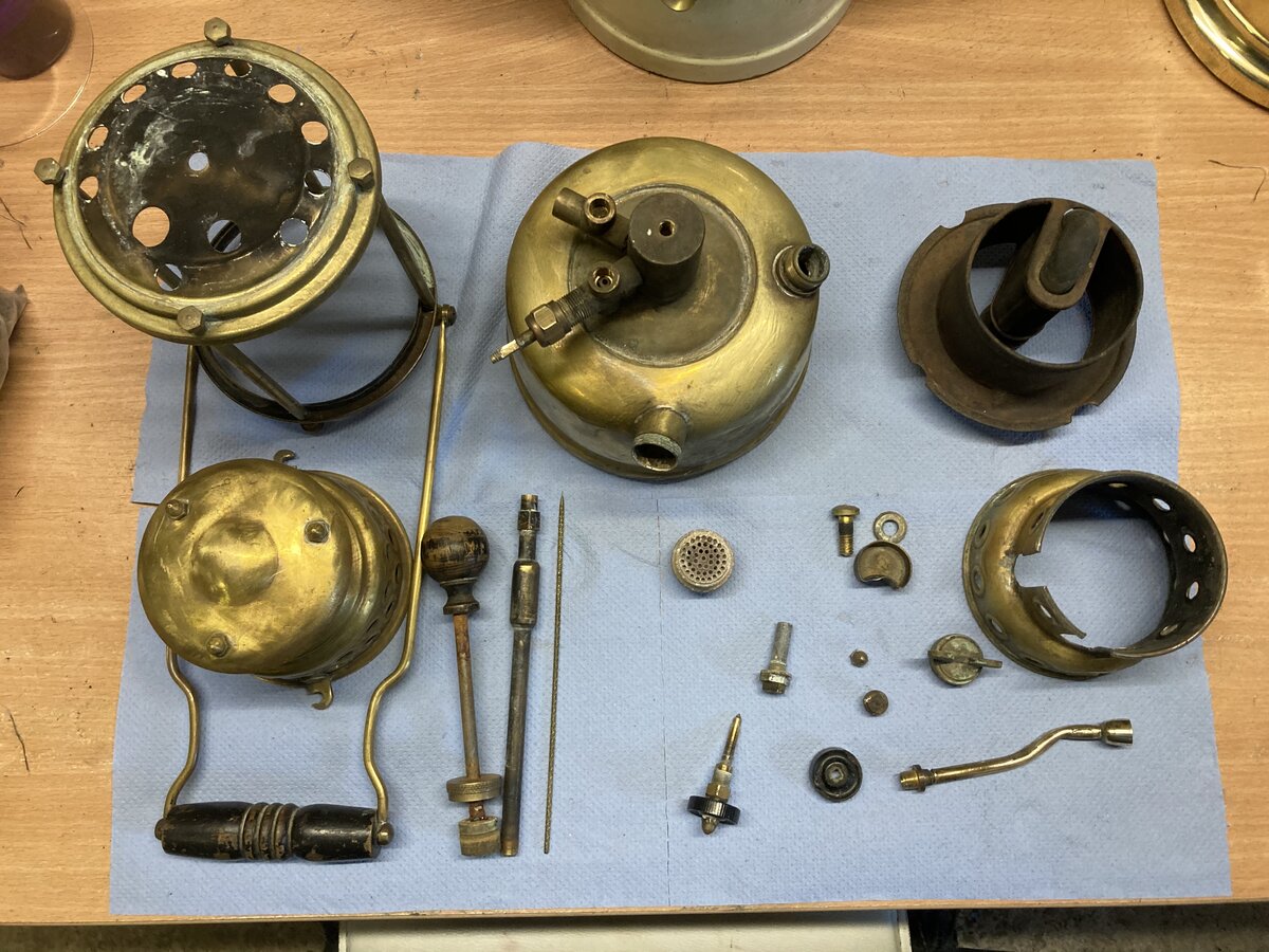

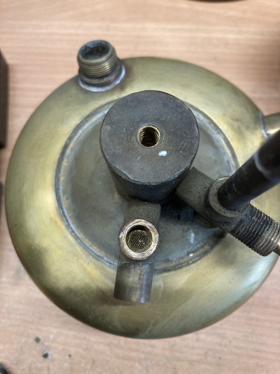

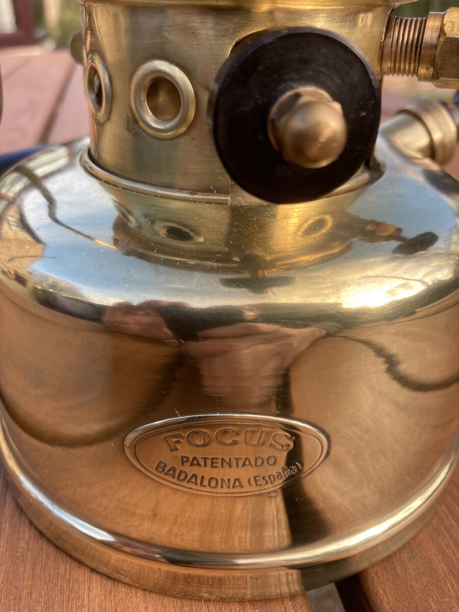

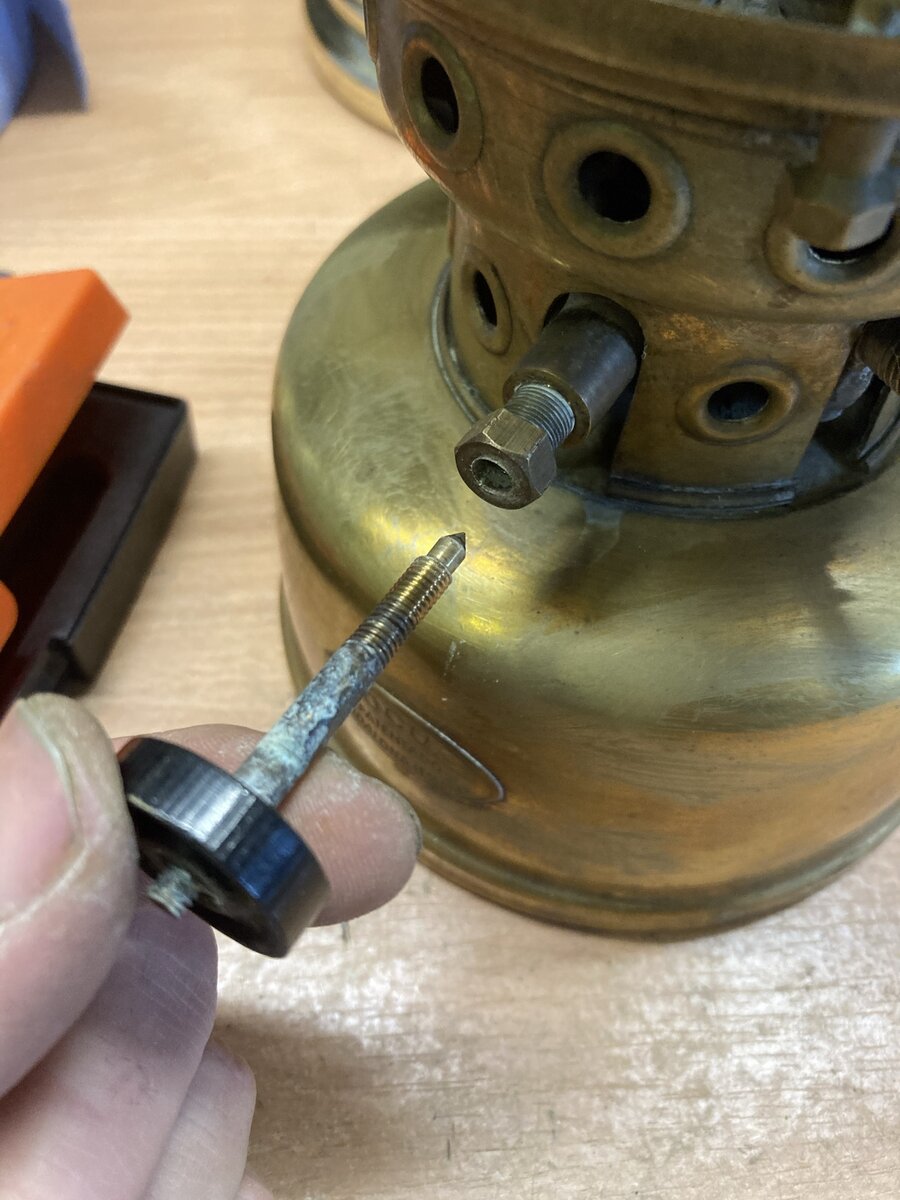

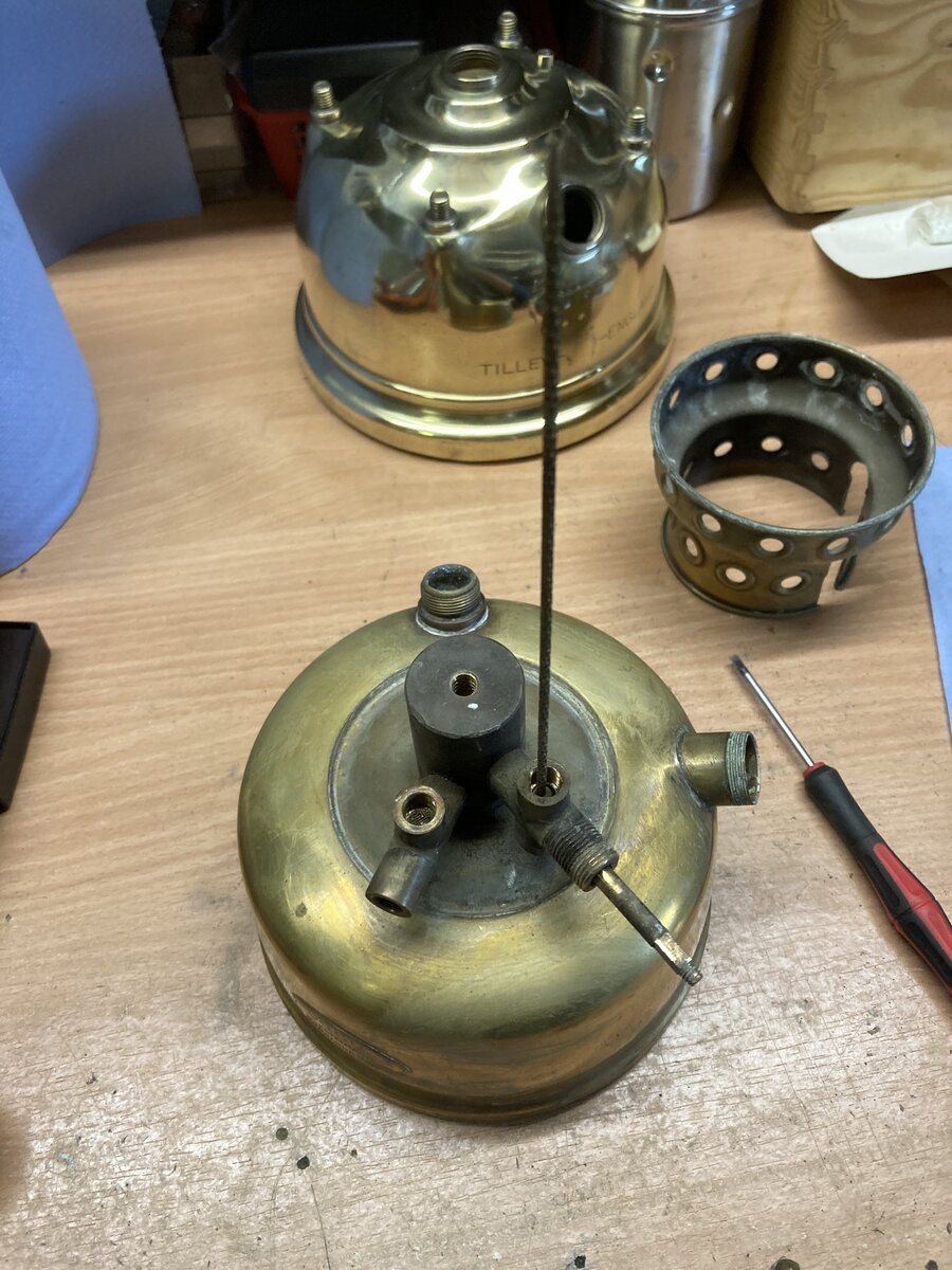

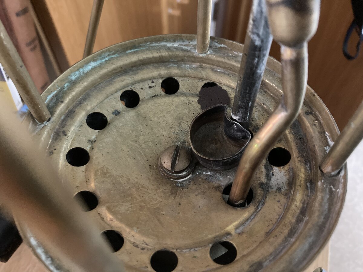

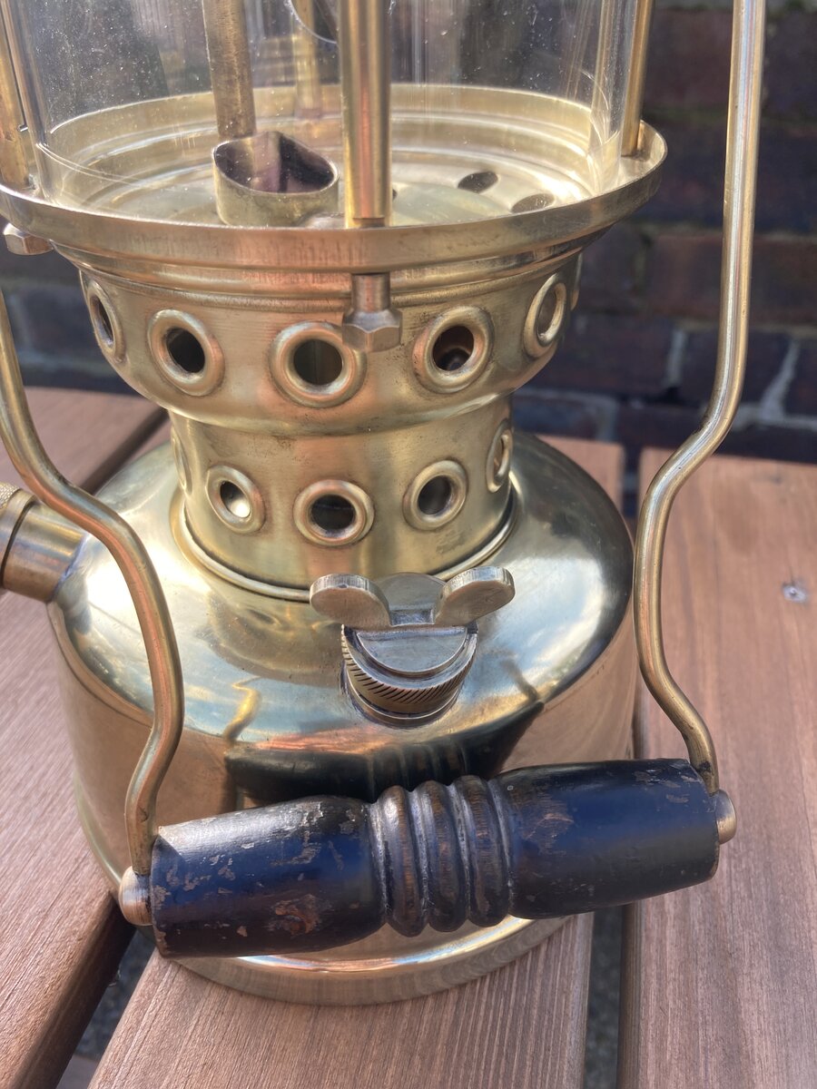

    Sourced from Spain a few months ago, the lack of a nice easy service kit and my own lack of knowledge and experience meant this one took some getting right.
    The strip down and clean up was straight forward enough. I could hear the patina gang telling me to leave it as it was, but it really was just dirty for the most part! A vinegar bath and a very fine wire wool clean brought it up beautifully.

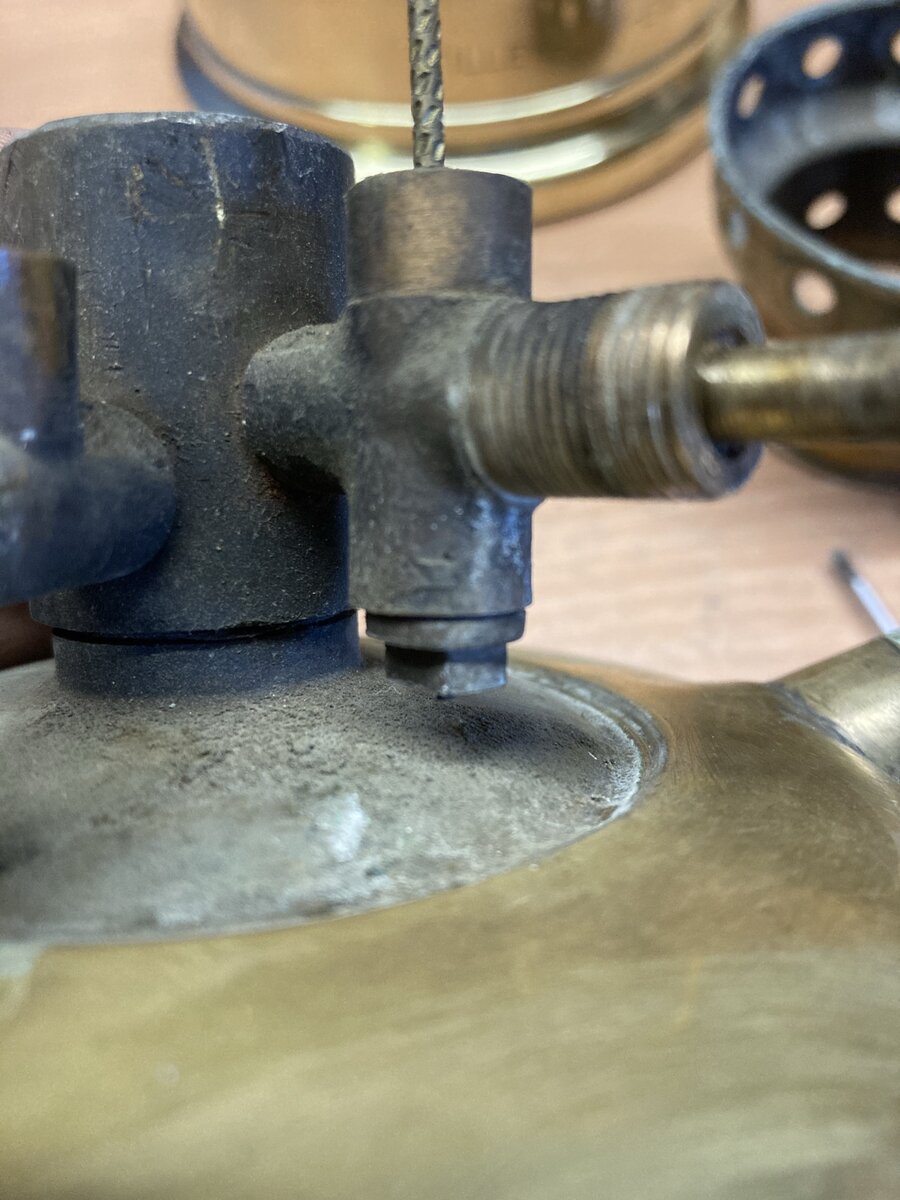

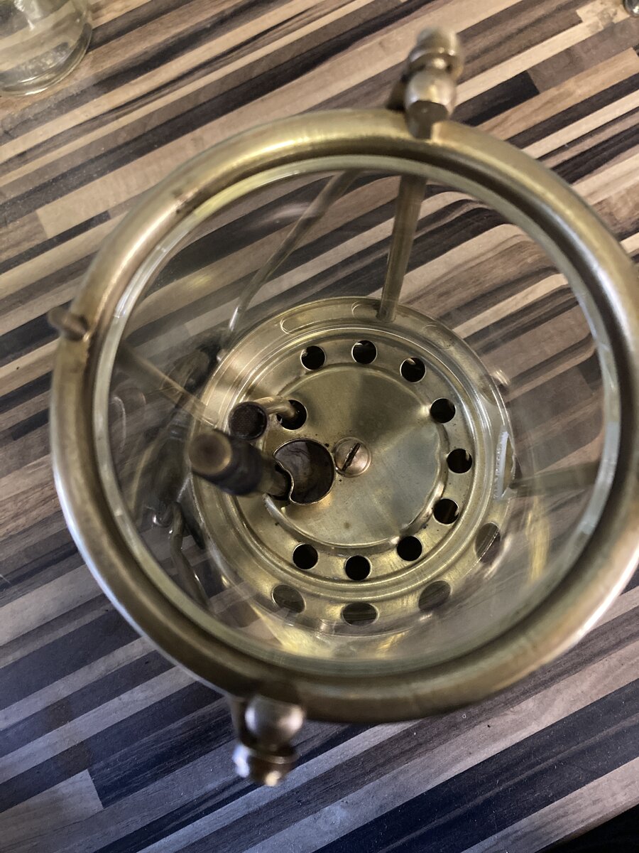

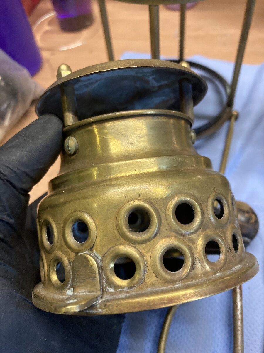

    The lantern was actually in pretty good shape with the cleaning wire and needle in tact. It’s certainly an unusual needle, more textured finish than I have seen before.
    2DFF6B0C-2B8D-44EB-84D7-41502EA8322F.jpeg 9A186183-4036-4759-AAAB-EF80BCD86A54.jpeg 73697F9F-19E8-4CF9-B679-A52AFA7FB18A.jpeg 9D80C48B-56B4-4310-B30A-282F34BFCFF9.jpeg D140B62C-D4A2-47A7-92F6-4DEB6F51C16E.jpeg

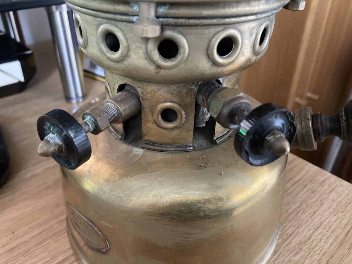

    Reassembly was more complicated as I had to make my own lead washer, a first for me, and and identify parts from other manufacturers. Vapalux served me well for the NRV refurb. The pump leather was shot and a Tilley cup was too small but an Optimus fit perfectly.
    I was particularly nervous about the valve stem gland packings but was advised that graphite foil was worth a try and it certainly seems to have done the job, though it’s a bit fiddly.

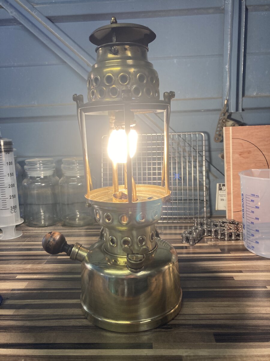

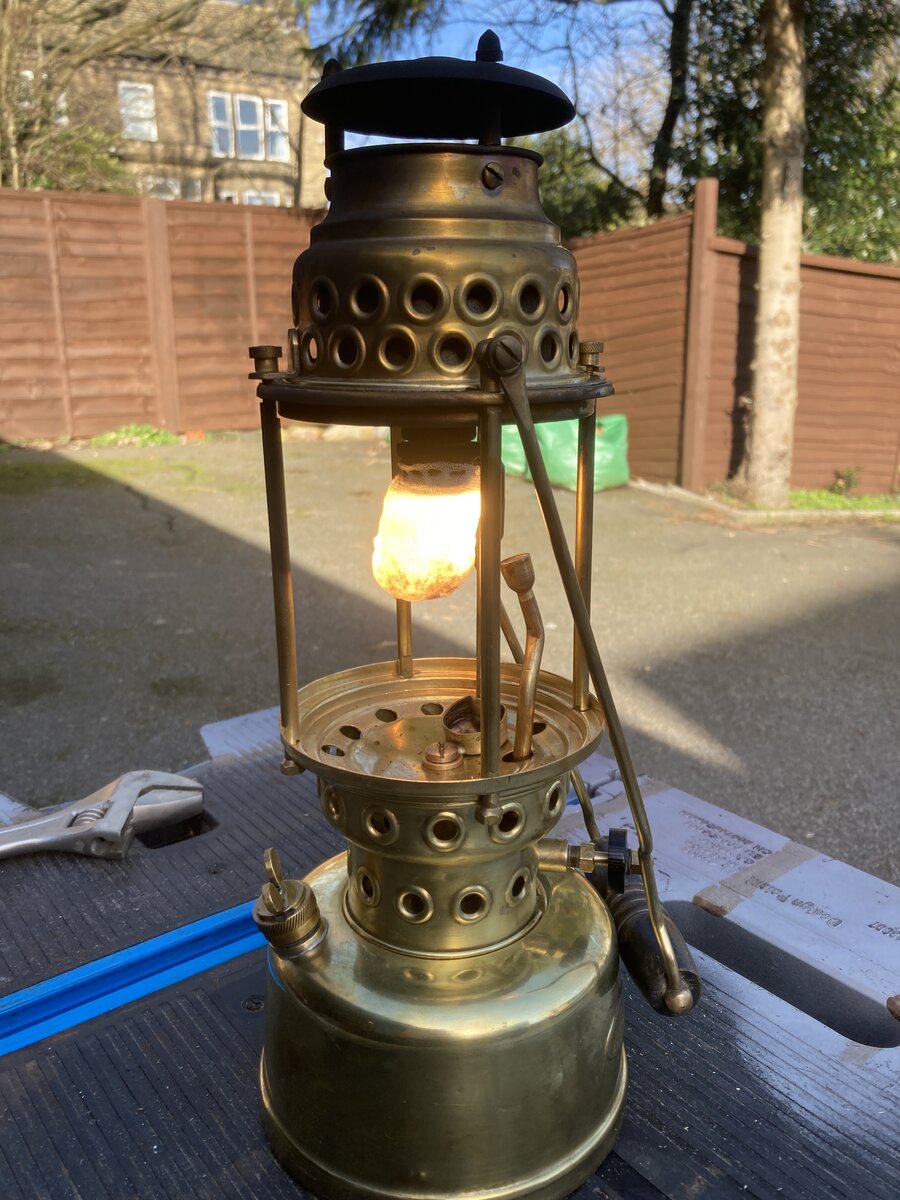

    The light up was worrying me with the oddball spares I’d utilised and everyone’s gasoline safety advice still fresh. However last week’s successful firing of my Coleman 327 had given me a bit of confidence so I tried to light the Focus fuelled by Brake Cleaner, outside. The first attempt was a total NRV failure. Managed to get a bit more of a nip on the NRV and tried again. Second attempt NRV failed again. Stripped it out and found the washer hadn’t seated properly and had become damaged on install.
    Third attempt today and away she goes. Took much more pre-heating than anticipated, certainly compared to the Coleman so I presume it’s due to the vapouriser on the Focus being more substantial plus I used the fairly modest spirit cup whereas the Coleman I preheated with my torch.
    After a minor flare up she cleared her throat, coughed and spluttered for a bit and eventually settled to a nice bunsen flame. 4th light up with a mantle (21a) and chimney on and a full paraffinesque preheat and she lit beautifully. I did try the lanterns pre-heat torch and it worked but did seem to depressurise everything very quickly. I may be using it incorrectly though! Anyway, really happy with how it turned out and what an adventure!

    C59EF65D-B7FF-44D2-8553-71B8ECF0BA6D.jpeg Does anyone have any advice on use of the preheat burner? It works but possibly too well, as it depressurises the fount very quickly. Should I just crack the valve rather than open it fully, and would it be necessary to add more pump strokes after the preheat before lighting?

    I don't have a Focus but I do have a Primus 1051 which is a petrol lantern and later versions have a preheater that works the same as the one on your Focus.
    With no instructions to follow, here's how I light my Primus 1051. With all valves closed and 1ltr of fuel in the tank, I put 20 pump strokes worth of air into the tank. Operate the preheater lever which opens the preheater valve 1/2 to 3/4 of a turn and apply a match. After 5 - 10 seconds, open the main valve and when lantern lights, turn off the preheater. Add more air.
    The vapouriser in your Focus lantern is a heavy duty affair and will most probably need more preheating than the Primus one, I'd start with perhaps 15 or even 20 seconds and see how you go. If it still flares up, preheat some more. If it lights O.K., you can experiment with the amount of time you need to preheat.

    Thanks Henry, I had another try and managed to preheat using just the preheater. I just cracked the valve open ever so lightly and then did have to apply more pressure once lit. I think the spirit cup is the easiest option really though.
