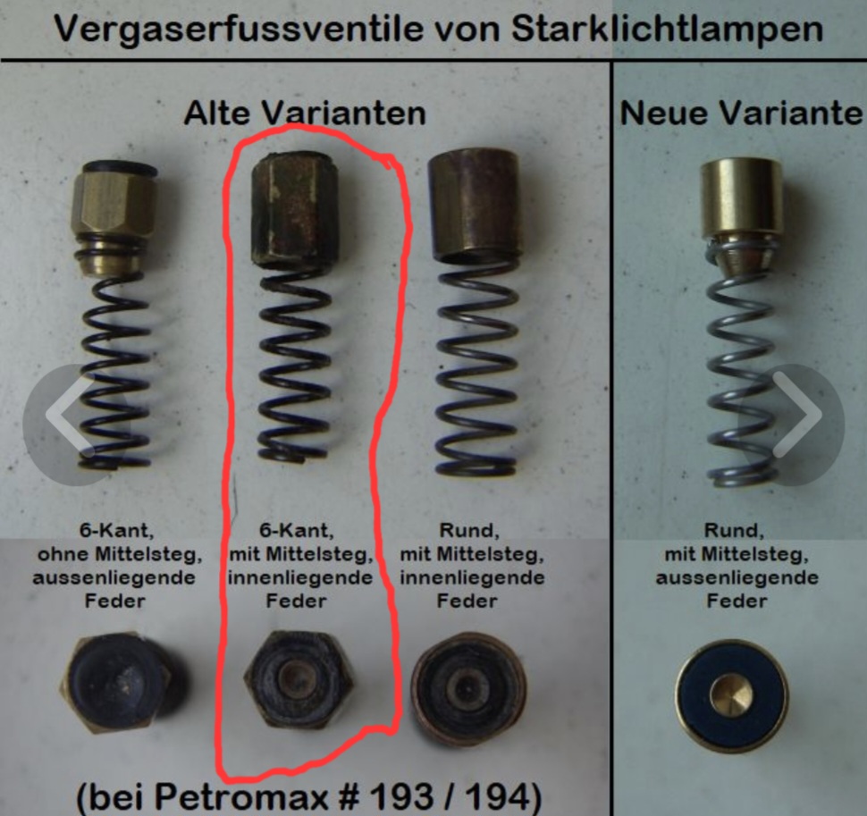

    The current production footvalve parts aren't the same as those made in the 1960s. I would believe yours would appear like these:-
    My Petromax from 1961 has a footvalve similar to the ones shown above. I had the same problem many years ago with it not sealing.
    If I'm not wrong, these older parts wouldn't be available anymore. At least, they would certainly be very challenging to find any.
    Replacing the petrified 'rubber' pip can be a little fiddly due to the centre brass 'stub'. You need to first bore a hole through the new elastomeric material(viton, buna-n, etc). The old rubber needs to be eased from its hexagonal holder. It can also be burnt-out like what you might do to remove hardened seals from the filler caps of old Coleman lanterns. Some members had already done this with success.
    On mine, instead of replacing the hardened rubber, I had replaced the old compression spring with one that was considerably stiffer/stronger. This managed to get the pip to seal.
    An alternative might be just replace the entire footvalve plus its tube with a new-manufactured item instead of just the holder/pip. The new internals aren't the same and tend to result in the problems you mentioned.
    In my vague memory, I had made new pips from a variety of materials using either a 3/16" or a 5mm hole punch. Viton can often be a little too hard especially for old weakened springs. I often use natural cork intead.
