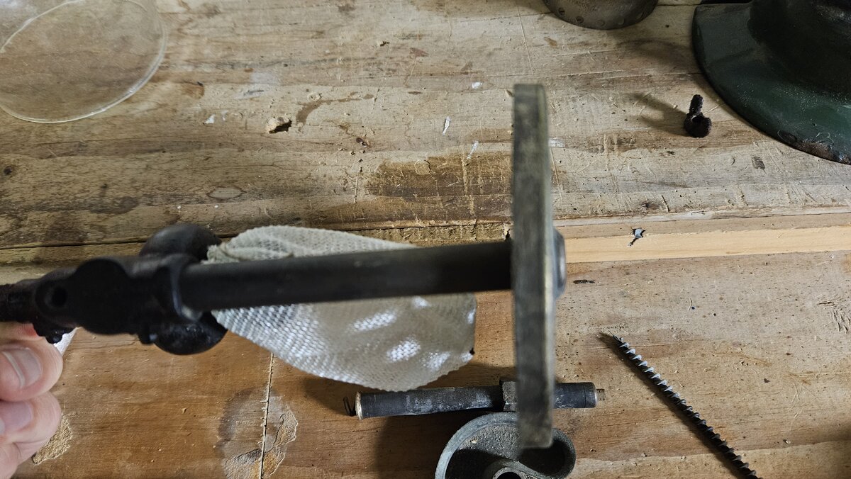

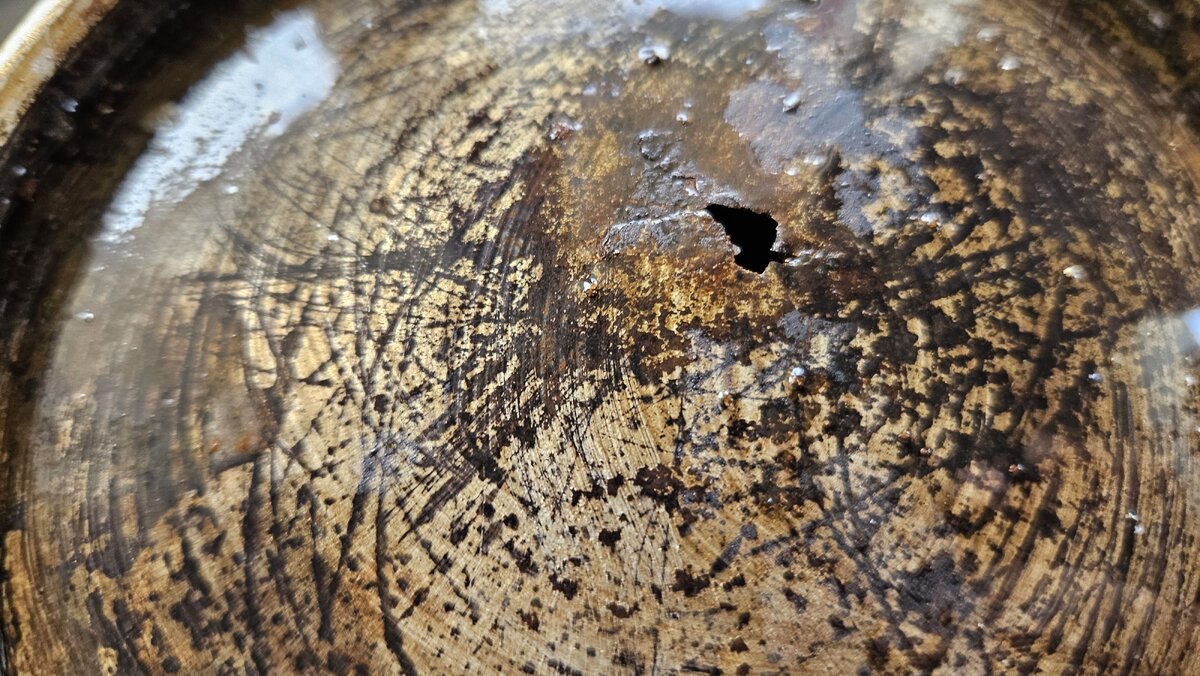

    Anyway I've stripped it down and don't hold much hope.
    It's full of rust inside and I'm unsure if it's eaten through, looks like it must have had water in the tank at some point? It should not rust like this.
    A good amount came out as you can see in the photo.

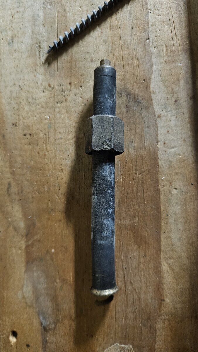

    The generator is bent, im hoping it's possible to straighten this.
    Also the air tubes on the base have bent, are these easy to straighten out?

    Put a few small steel nuts or ball bearings and some paraffin into the fount and shake it until your arms hurt and cramp. Rinse out afterwards with clean paraffin and if there are no leaks it should be good to use outside away from anything that can burn incase of leakage or fire.
    The back end of a tight fitting dril bit can be used on the insid of the generator to straiten it after the coils have been removed and it is cleaned.

    I will give the drill bit method a go, nothing to loose

    I also have used round steel bars to straighten the air tubes on Coleman lanterns.

    Well some bad news, the steel bottom had indeed rusted out, there were a couple of rust spots on the base I had some concern about, and the freezer finished it off and it just flaked off after thawing out.
    It never completley removed the dent either, but got rid of some of it, the steel looks wafer thin on the bottom of the fount where its rusted.
    I could weld it up and pour some epoxy in the base to seal it, but I have no idea if its worth it or if anyone bothers to repair these.
    At the end of the day I bought it for parts, but i thought I would have a go at saving it if its worth the effort.

    40
    Perhaps still useful as a display piece or at least a display holder for spare parts

    Yes I'm thinking will be good for spares, you can't save them all!
