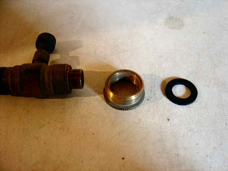

    The parts shown in this picture are the only bits that should unscrew...

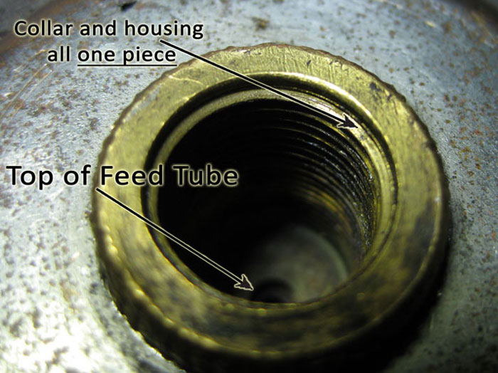

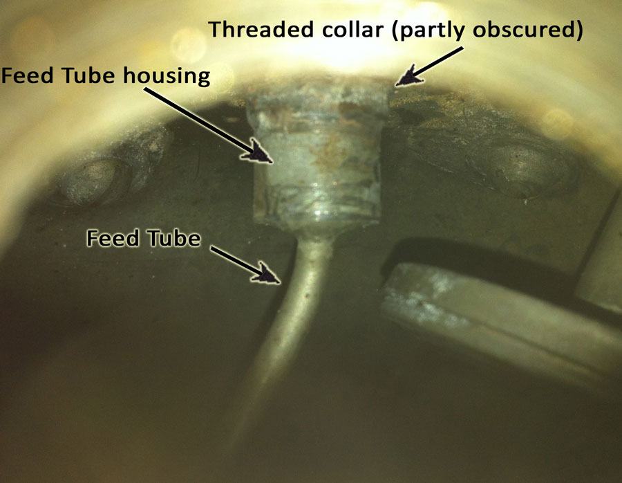

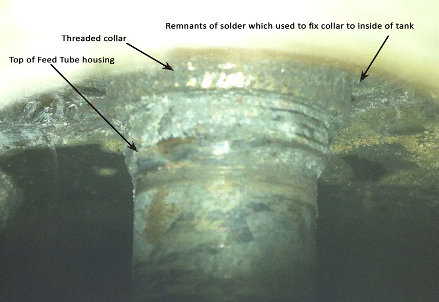

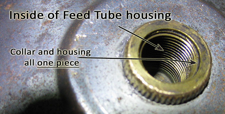

    Inside the tank is a feed tube which draws the fuel up from the lower part of the tank. This feed tube housing is actually part of the outer collar (not separate). Both screw into an inner collar originally soldered onto the inside of the tank. It's this solder which has been disrupted (by me heating it) thereby allowing the inner collar to spin freely.
    See the photos - they explain more clearly I hope.

    Ian .
    Only way is to resolder carefully from outside .
    You might have to fill font with water up to top of pick up tube so you dont melt the solder joint there .
    Bob .

    I would first wash /clean and soak inside with vinegar 1/3 solution, secure frame studs from outside with washers and nuts use a spare control cock and vaporizer to hold socket from falling in while soldering and finish with heating joint while tank is inverted. :: Graham

    I was thinking of inverting the tank as it is, the GENTLY heating the outer again and (as I can just see the inner collar) use one of those long thin solver sticks to 'flow the solder around the ring again. I will take on board the nuts/washers to secure the frame studs to stop them moving if the solder there softens. Will also tape wet cloth against them and the filler opening to avoid overheating. Also I will use a spare control valve/vaporiser stem to hold the collar against the inner wall.
