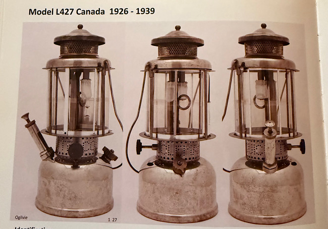

    Coleman 427 Canada , November 1927
    Which generator is originally installed in this Coleman 427 ?
    Q99 or R55 ?
    Until when was the Q99 still installed at the factory ?

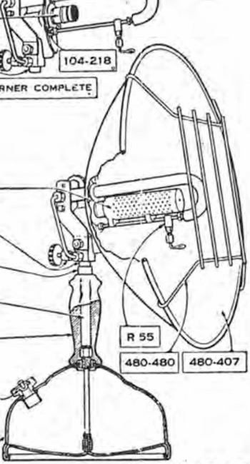

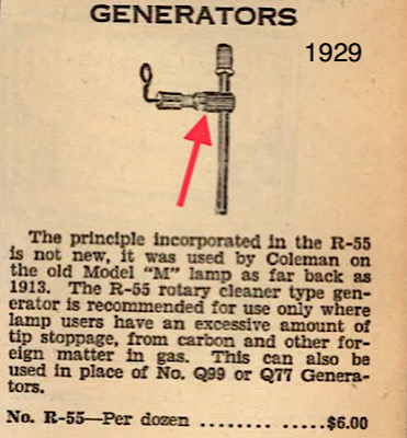

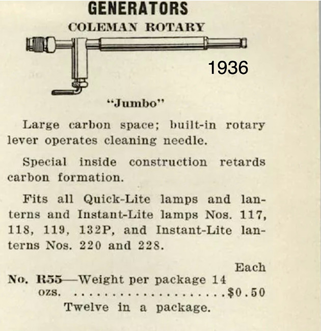

  8. coleman54
    Jul 21, 2020
    271
    Oklahoma, USA
    The Coleman R55 is shown in the Coleman shipping records handwritten by Hiram Strong: began shipping in bulk June 1929.
    The first Coleman gpa to have the R55 as “standard “ equipped was the no. 480 hot ray heater started shipping September 1929. The first design was a similar version in the same time frame as the AGM on their radiant heater and 256 lamps and 287/288 lanterns. The Coleman applied for patent in 1932 not granted till 1934, was a different constructed design. Before it was granted the design was changed again to a jumbo type tube body to give more space for carbon build up, a big aid for kero models.
    R55 was an available upgrade from that point (June 1929) for Instant Lite lamps 117,118,119 lanterns 220,228 and also Quick Lite lamps and lanterns.
    R55 began as standard equipment on L427K , L427 in Toronto and US 1935.
    @Tony Press @MYN
  9. coleman54
    Jul 21, 2020
    271
    Oklahoma, USA
    IMG_2025-09-28-072504.jpeg IMG_2025-09-28-084902.jpeg IMG_2025-09-28-085100.jpeg

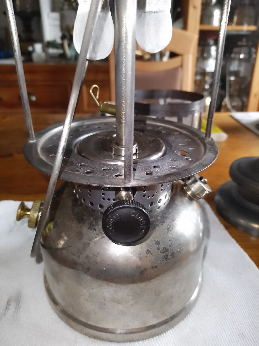

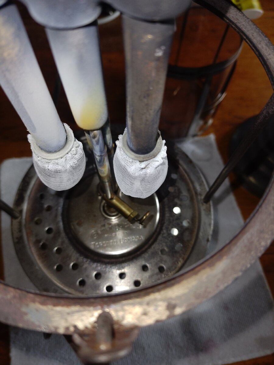

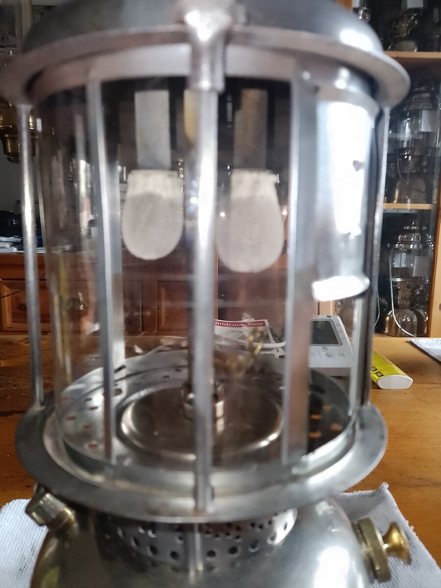

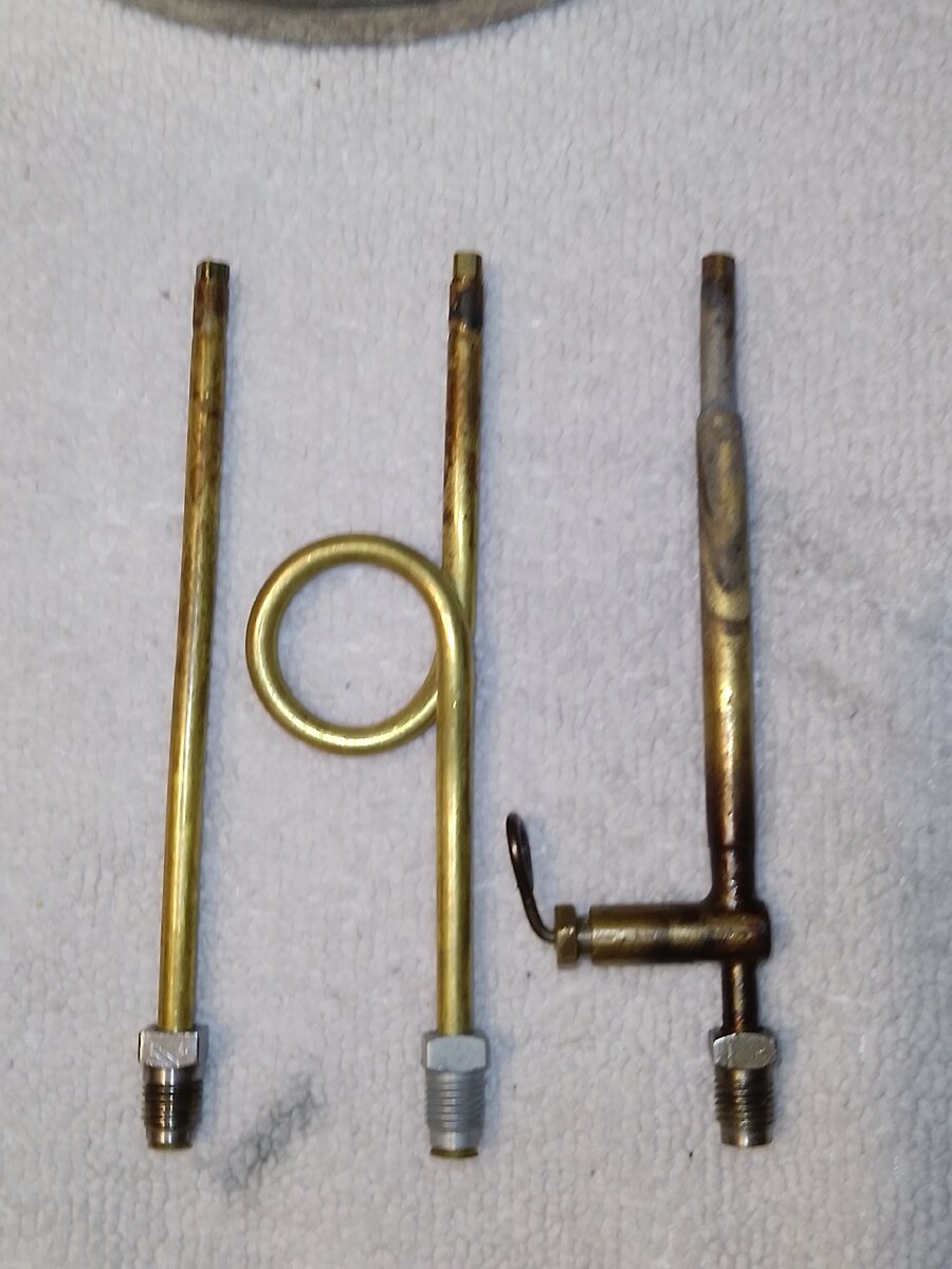

  10. Reinhard
    Reinhard Germany Subscriber
    Oct 15, 2018
    1,084
    This Canadian Coleman 427 from November 1927 only fits an R55.
    With a Q99 , the loop would be positioned directly behind a pole.That can't be right.
    IMG_20250928_154627.jpg IMG_20250928_154350.jpg IMG_20250928_154235.jpg IMG_20250928_154549.jpg

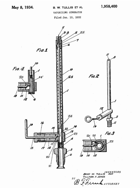

  12. MYN
    Thanks for chiming in, @coleman54
    I've forgotten about the earlier generator described in the patent US1958400A.
    Yes, it looks like the predecessor to the fatter one.(same inventor).
    That'd be another piece of evidence that the R55 had be in circulation before the patent date.:)

  14. Reinhard
    Oct 15, 2018
    1,084
    Thank you very much for your intensive efforts to clarify my question.:thumbup::thumbup:
    I dont't think this Canadian Coleman 427 has ever contained a Q99 generator.
  15. coleman54
    Jul 21, 2020
    271
    Oklahoma, USA
    Glad to help. Not ever having a Q99 for a 1927 lantern would be quite a feat, the only option would be a Q77 economy generator, there were no R55 available until mid 1929. It was a different design than the one shown in your images on your lantern now. The R55 you have is not original to the lantern and appears to have been manufactured a number of years later design that was not available.

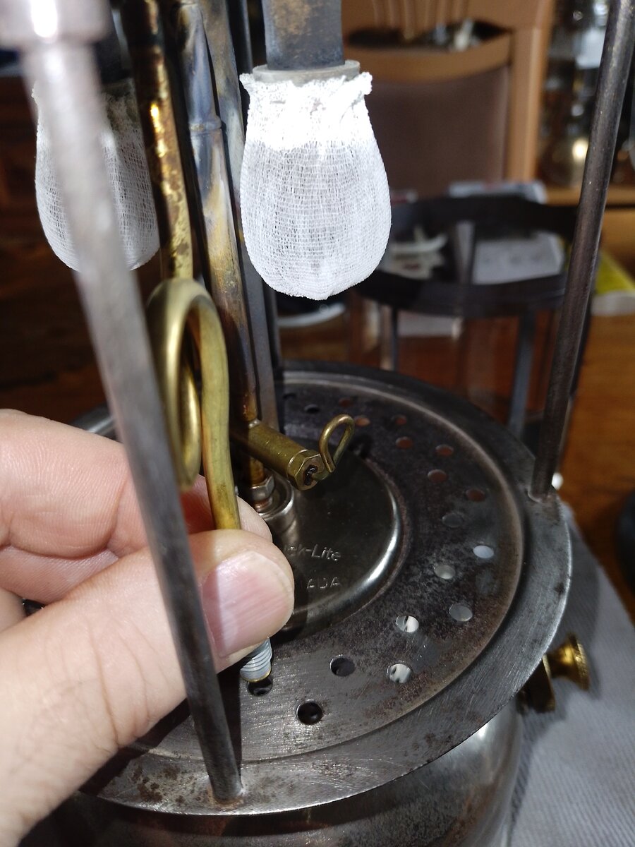

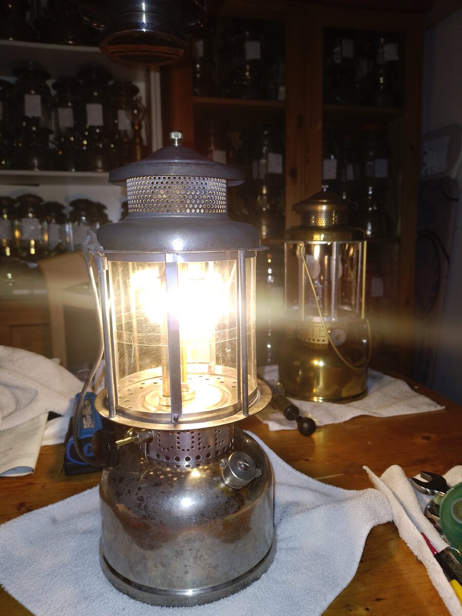

  16. Reinhard
    Oct 15, 2018
    1,084
    Today I installed a Q77 generator.It works just as well as a Q99 or R55.
    Is it possible that this Coleman 427 was delivered in Toronto in November 1927 with a Q77 generator?
