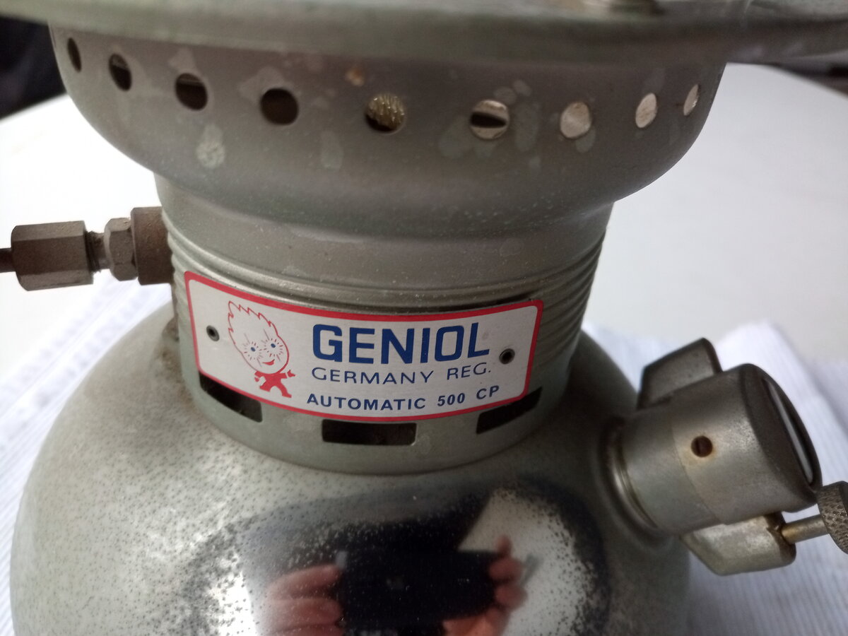

    Moin,
    My new Ebay shot :
    IMG_20201020_135947.jpg IMG_20201020_135934.jpg IMG_20201020_135953.jpg IMG_20201020_135959.jpg IMG_20201021_110935.jpg IMG_20201021_133352.jpg IMG_20201021_133406.jpg IMG_20201021_133422.jpg IMG_20201021_133439.jpg IMG_20201021_134037.jpg IMG_20201021_134615.jpg IMG_20201021_134834.jpg IMG_20201021_134840.jpg IMG_20201021_135203.jpg IMG_20201021_145113.jpg Geniol Automatic CP 500

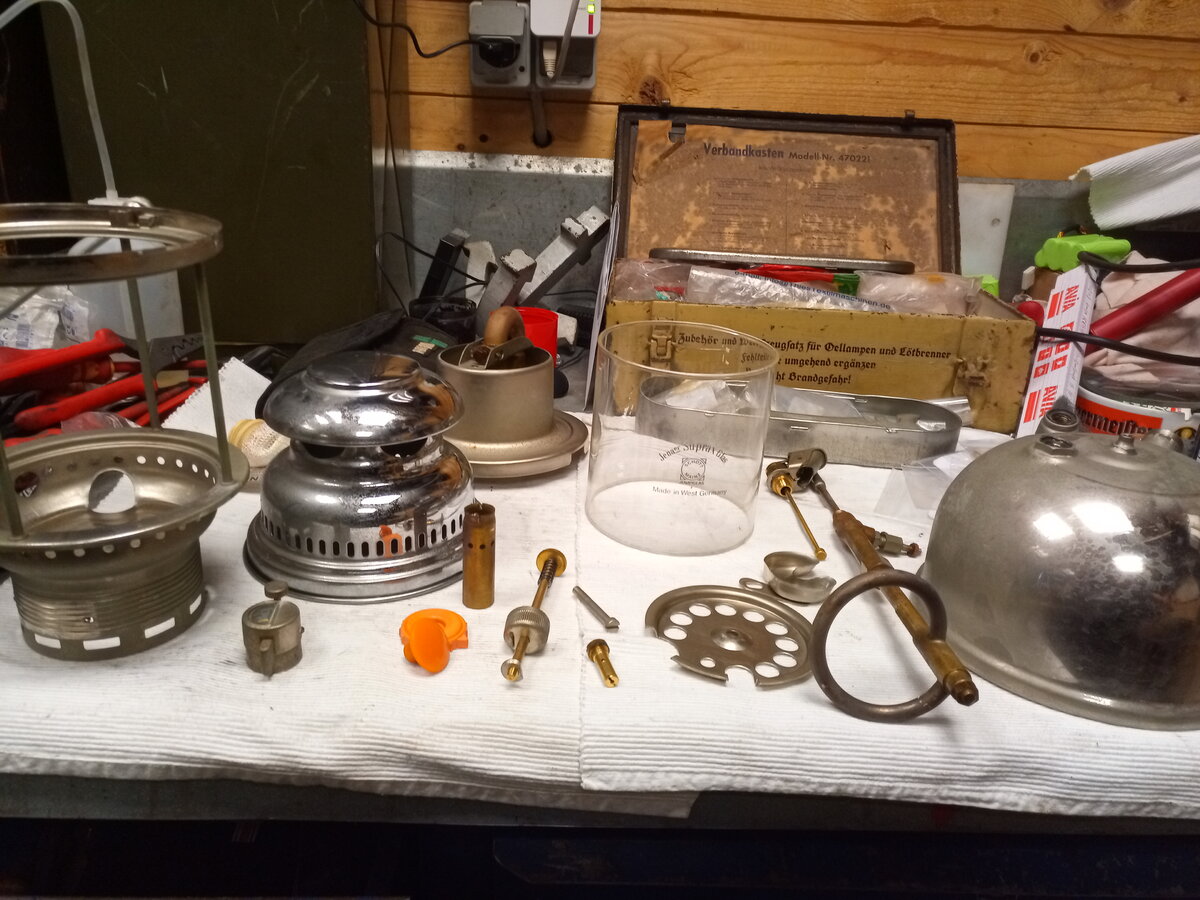

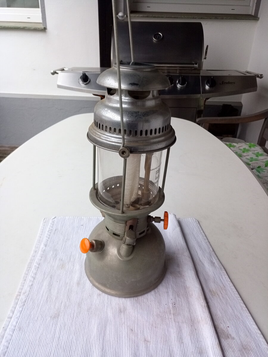

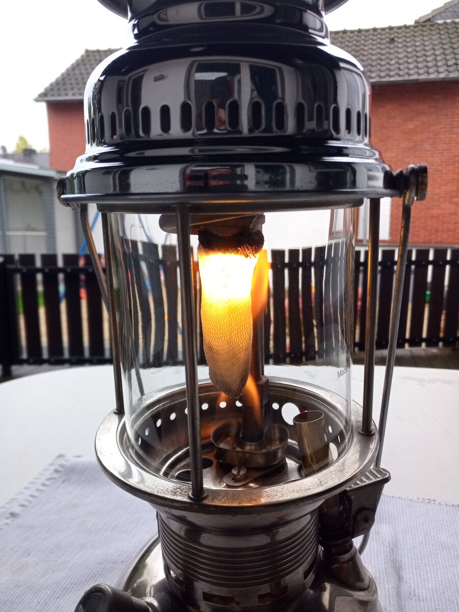

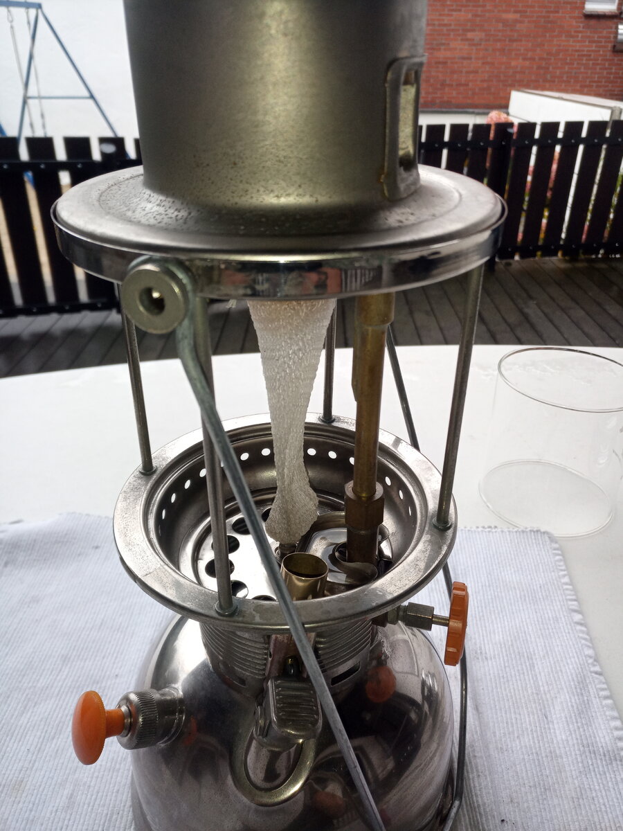

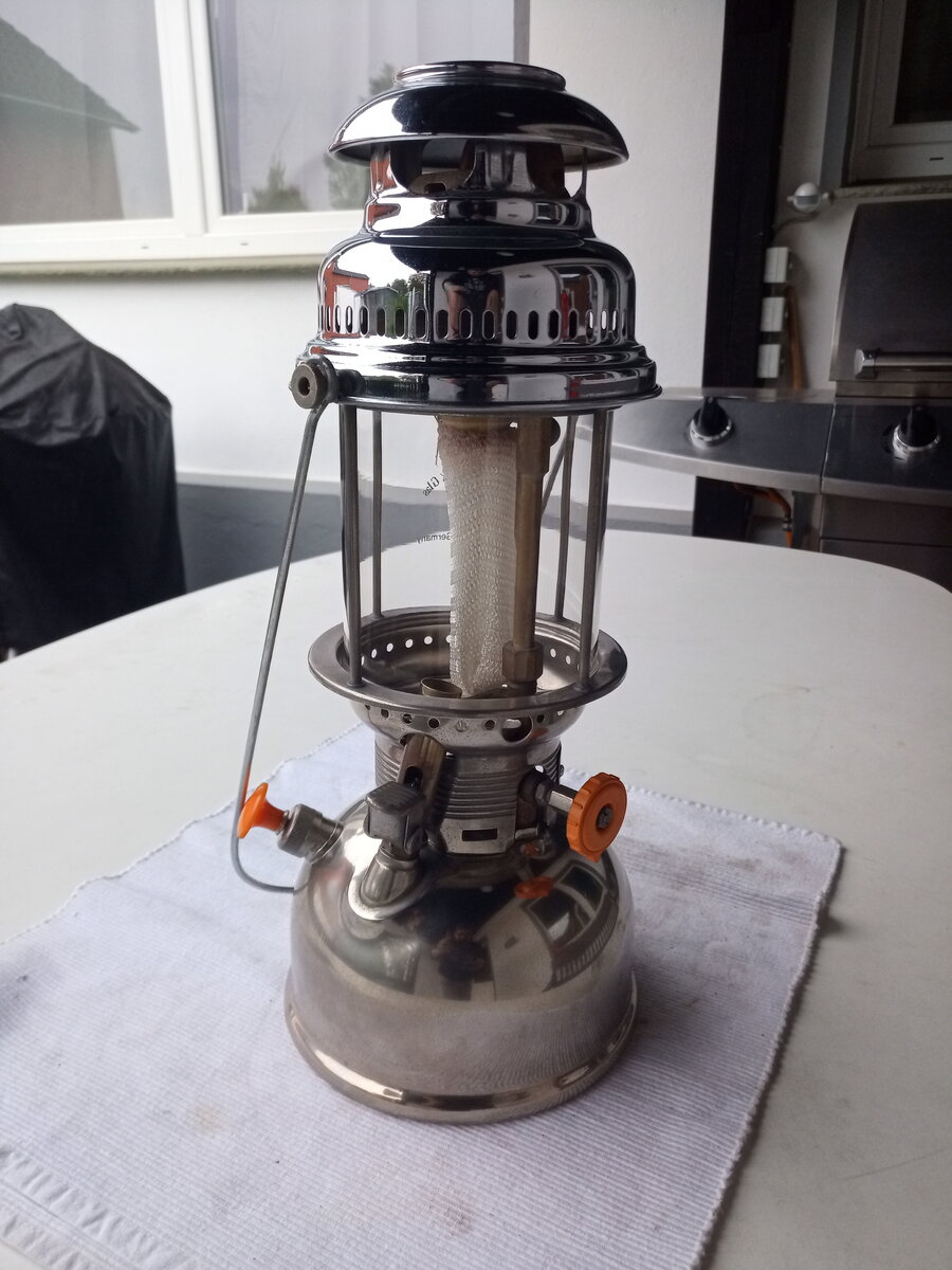

    After successful ultrasonic cleaning, major maintenance and subsequent lengthy and extensive polishing, the old lady is fit enough again to turn on light. Apart from the usual seals, there was nothing that needed to be replaced.

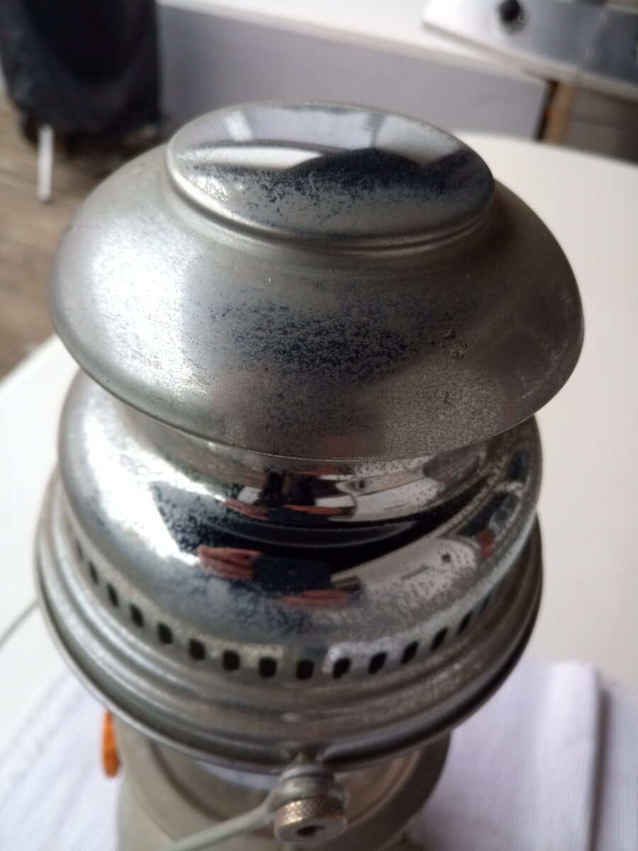

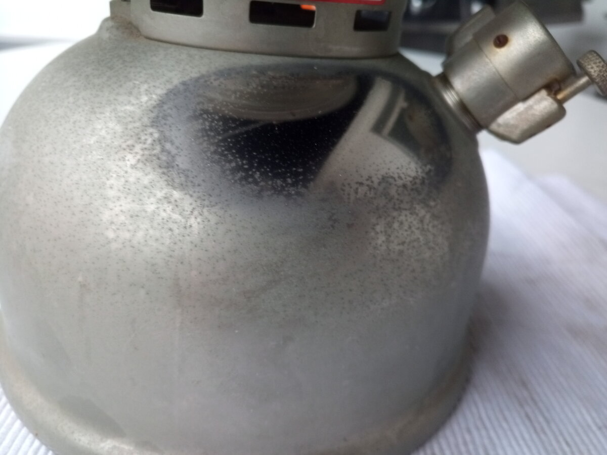

    The lamp has apparently fallen down and has minor wounds that were only noticed when polishing.
    Unfortunately, the applied electroplating is so weathered that not everything could be polished to a top surface.
    In the bottom of the tank I discovered a 4 / digit number, not only a 3-digit number as I first saw.

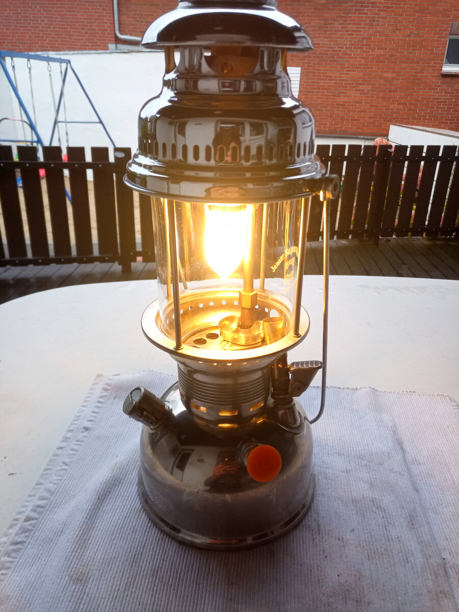

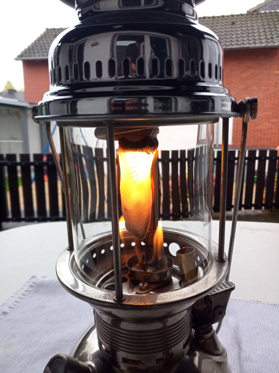

    The first start with the incandescent mantle, which had been attached since manufacture, was promptly successful.
    After at least three times the time that a current and freshly unpacked mantle needs to get in shape, the old sock is still very presentable!
    Now I'm just missing some information about the orange controls and the approximate year of construction.
