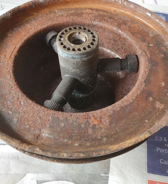

    Following on from my earlier success, I went fishing on the Bay of E last week, and my latest Tilley catch arrived today.
    I was fully expecting to replace all the washers, no problem, but as can be seen from the picture, the '707 Spigot' is missing from my lamp, it appears to have been sheared off.
    So, do I:-
    a) Regard this as a total disaster and throw the catch back again and hook another? or
    b) Treat this as a minor inconvenience and go see if I can remove the broken end in there?
    If your answer of choice is (b), then how do you suggest that I go about the task, please? - I'm quite happy about using large and small hand tools, but my array of power tools is limited..

    That burner is most likely knackered, the threads which the spigot screws into look stripped, but you could take a junior hacksaw blade and cut whats left of the spigot out, but I would get another burner and submerge the old burner in a tub of vinegar for a while until it loosens enough to take apart, so that the dome and the mixing tube which is inside the dome can be salvaged and the air pipes and nuts can also be salvaged.

    Hello @Ian Roll , if you want to salvage the burner follow @JEFF JOHNSON directions, soak the burner in straight vinegar, pull it apart, if bits are very tight, suggesting heat and quench, try, repeat, the spigot may be removed with an easy out, like whats used when the bolt/stud has snapped off. The burner spigot can be bought on julians ebay or the basecamp.

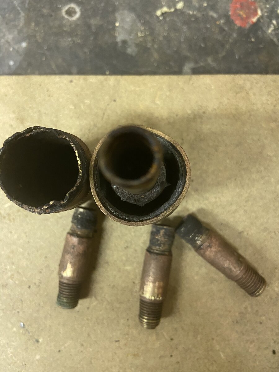

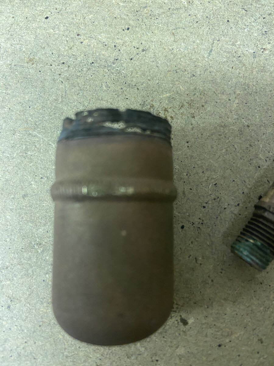

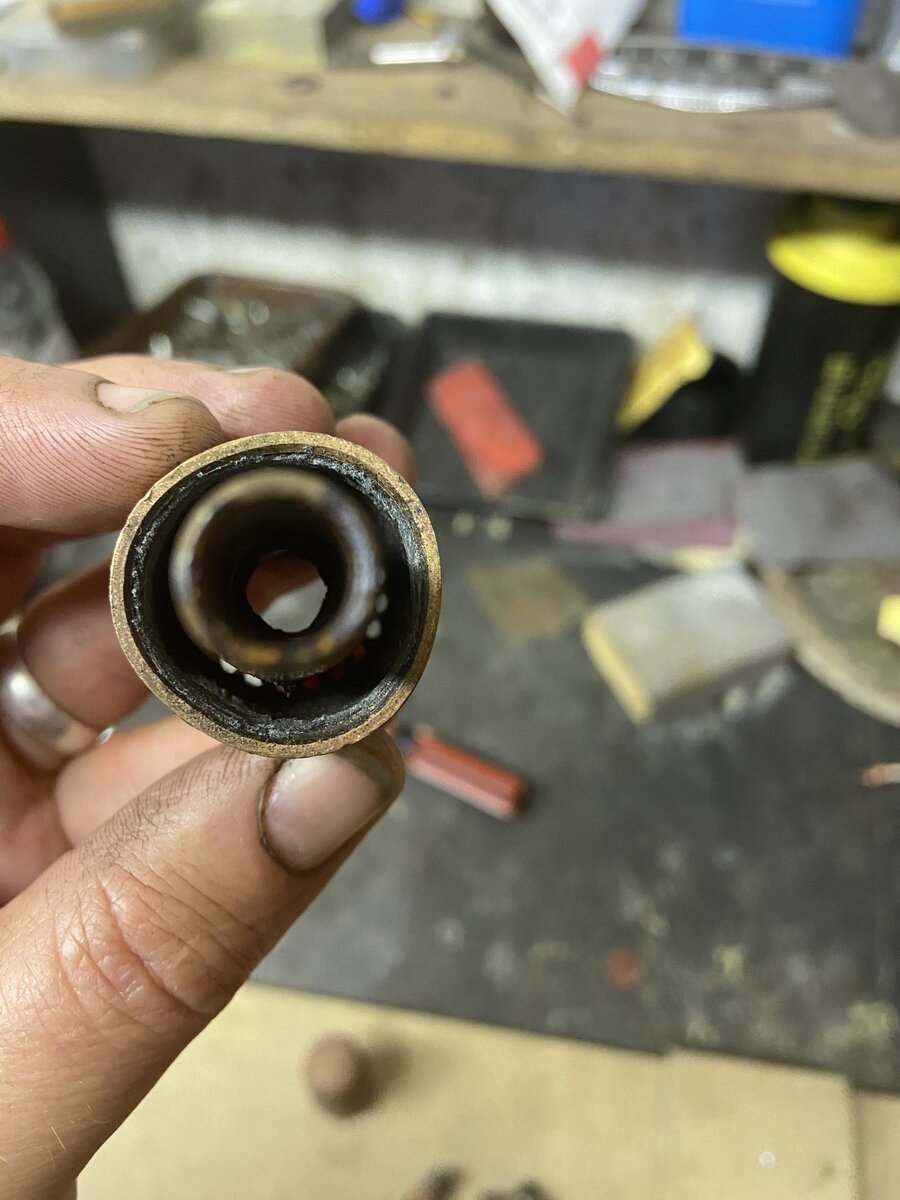

    Hi @Ian Roll looking at the deformation around the burner holes I’m afraid to say I think it looks pretty knackered. Burners like this will continue to work to a certain degree but as soon as you try and remove them they disintegrate. See pics below of one I did recently. Yours may not be as bad as this was but you get the idea. Vinegar works, I personally use 50g of powder citric acid in 500ml of water to clean all my brass burners, the crud literally falls off and this aids unscrewing the burner. However you may still find out after that it’s knackered. Good luck.
