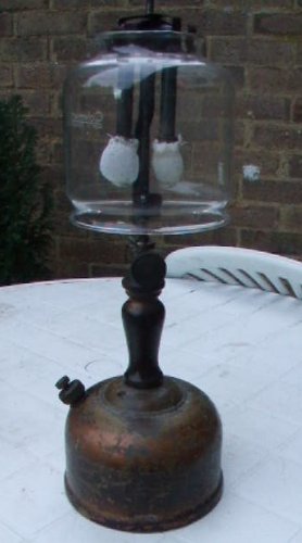

    Is there an aftermarket source of globes for Coleman table lamps of the type shown here?
    16,881
    Hello James, I have found mine at auctions, some have been fitted to caravan and house gas burners, others have been in boxes of assorted glass globes.
    So, I would say that the sources for these globes are auctions, junk/antique shops, boot and jumble sales etc..
    So happy hunting! :thumbup: Jeff.

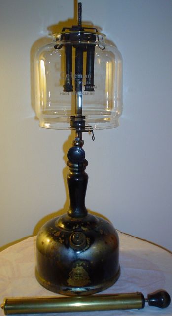

    I was told (but not tried it myself) that the northstar globe will fix as a good replacement

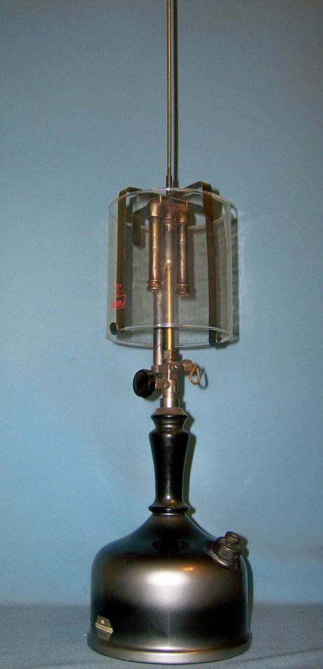

    Hi James,
    Leacock Coleman Center has reproductions of the 355 protector globe. It's a part number 132-355. BUT, they get $69.99 for it. OUCH!!! They do however sell a globe holder that utilizes a Coleman two mantle lantern straight wall globe shown in the image. It's well made from heavy stock and comes with the attachment screw that will accept a hanger rod that they sell to go with it. Sorry, I don't have the part number. But if you contact them I'm sure they will know what you're talking about.
    Bob

    I made one similar of the last picture with some metal and wire plus a globe for Px 250 cp. Do it yourself.

    Many thanks to paul_m for supplying me with a globe.
    Can someone tell me which model it is so I can put it in the gallery? It is a Canada lamp, I think a 168K. I can't light it at the moment has the mantles have holes and I need some more.
  8. Mackburner
    Could be a 168K. Hard to tell with these because there are several in the same style. However if it has a simple straight fuel feed and an alcohol cup then it is a kero lamp and will be a 168K. Most Canadian stuff has a rubber stamp in the base with model number. ::Neil::
