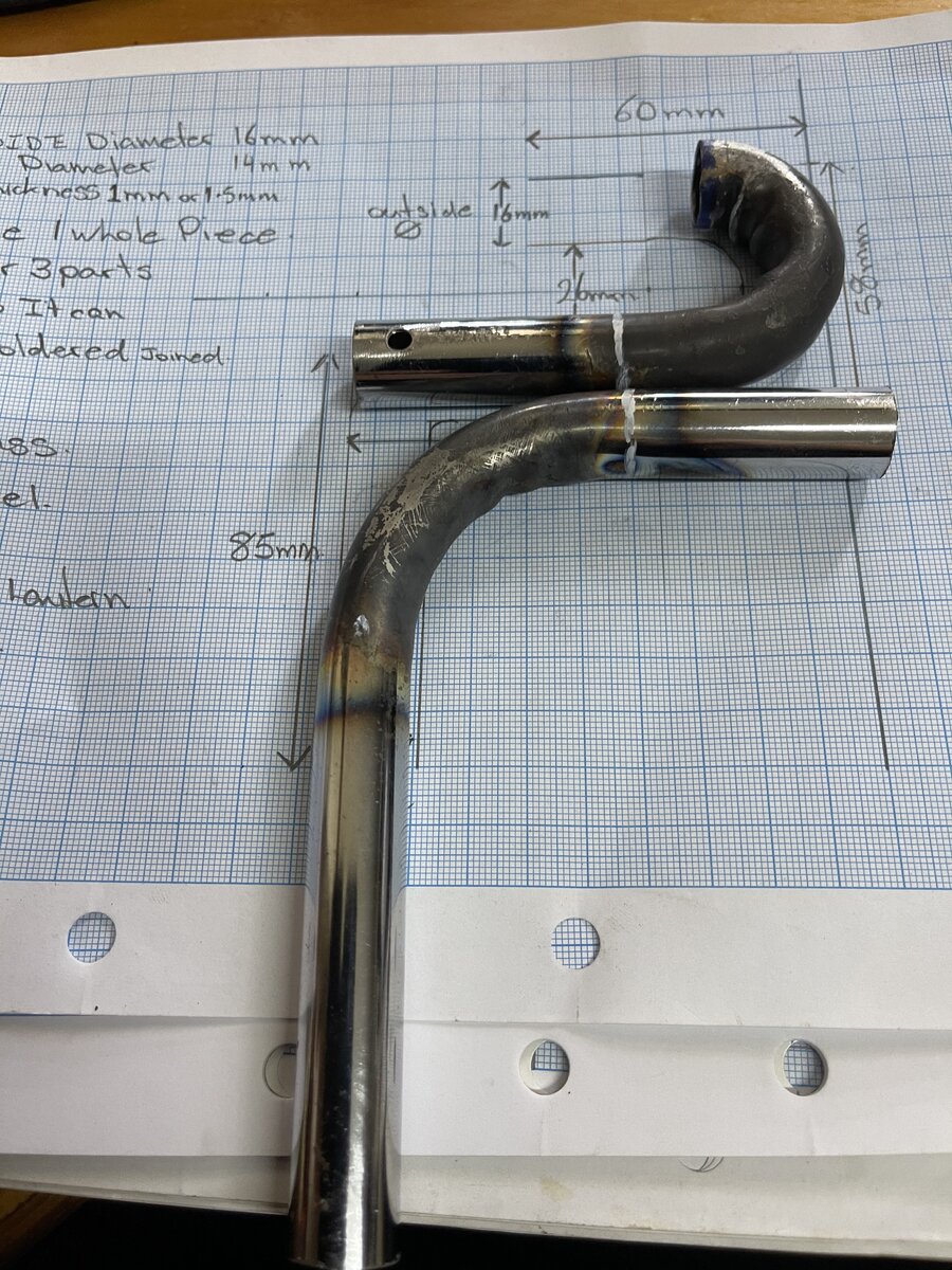

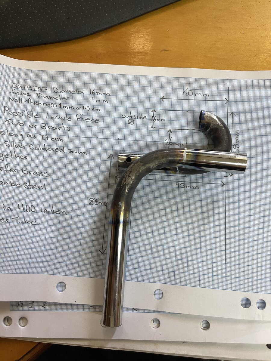

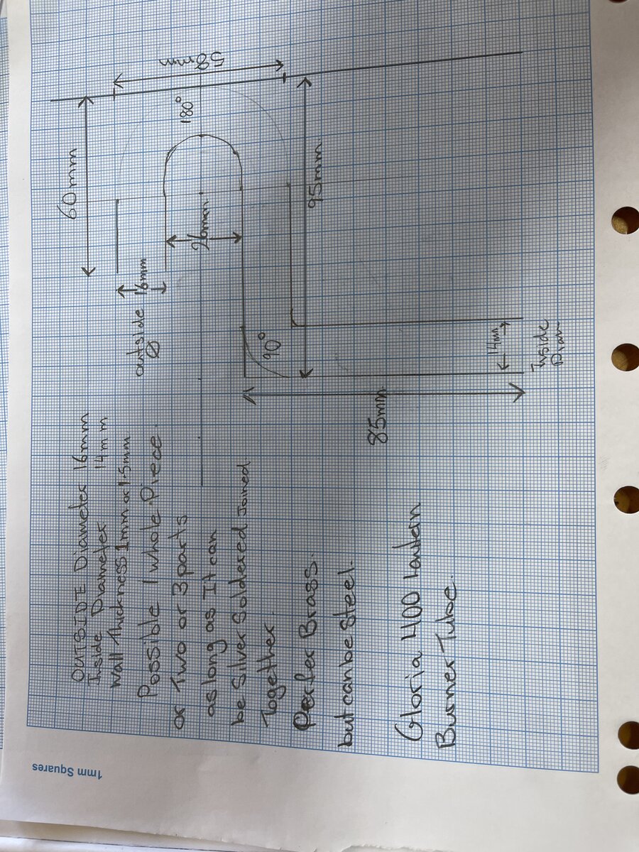

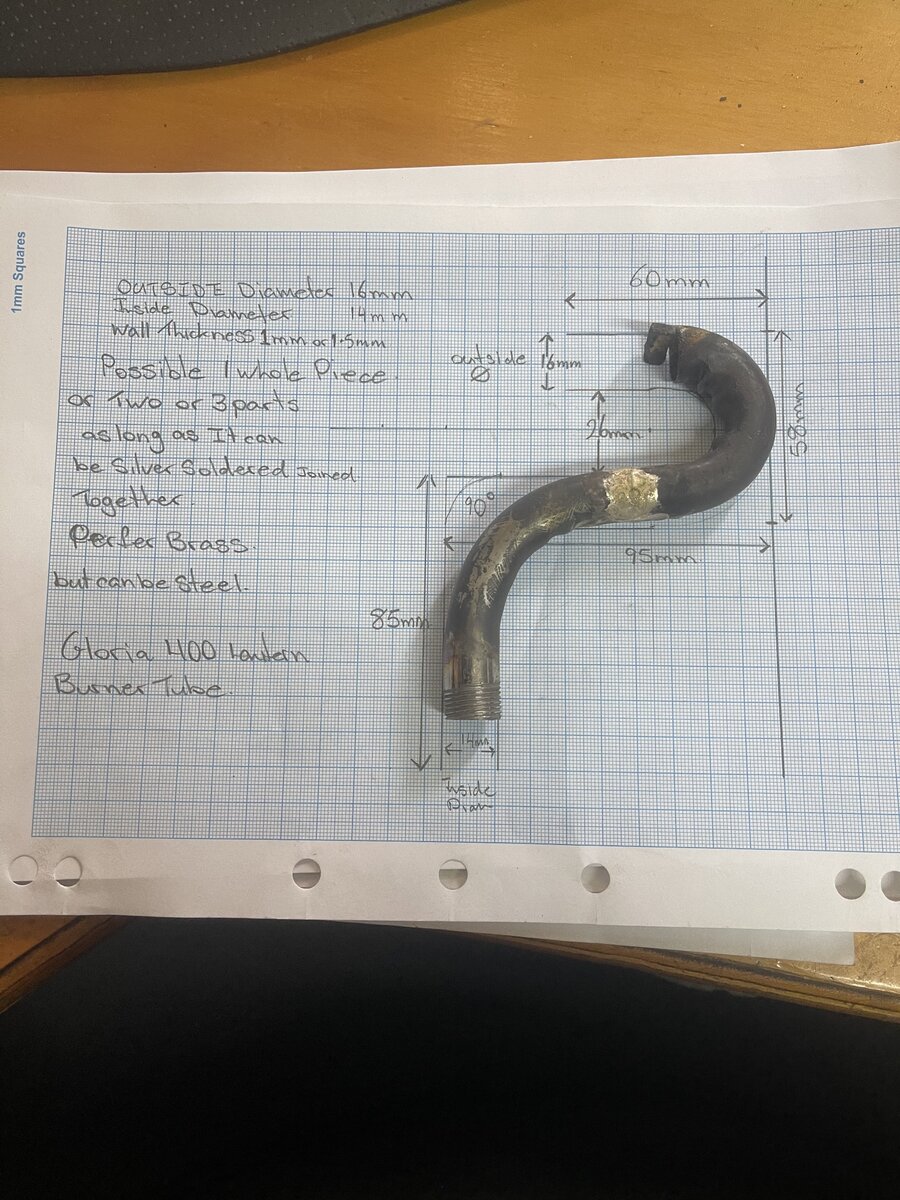

    I had a plan so I made some carful measurements and drew the plan on 1mm square graph paper 4BF683AB-DAE8-47BB-B218-CCFBD5FA5ABB.jpeg
    I sourced material, I looked for brass tube but not much of what I was looking for and too distant and cost. I needed 16 mm tube I found what I needed at the bathroom section 16mm Crome towel rail. Cheap and plentiful.

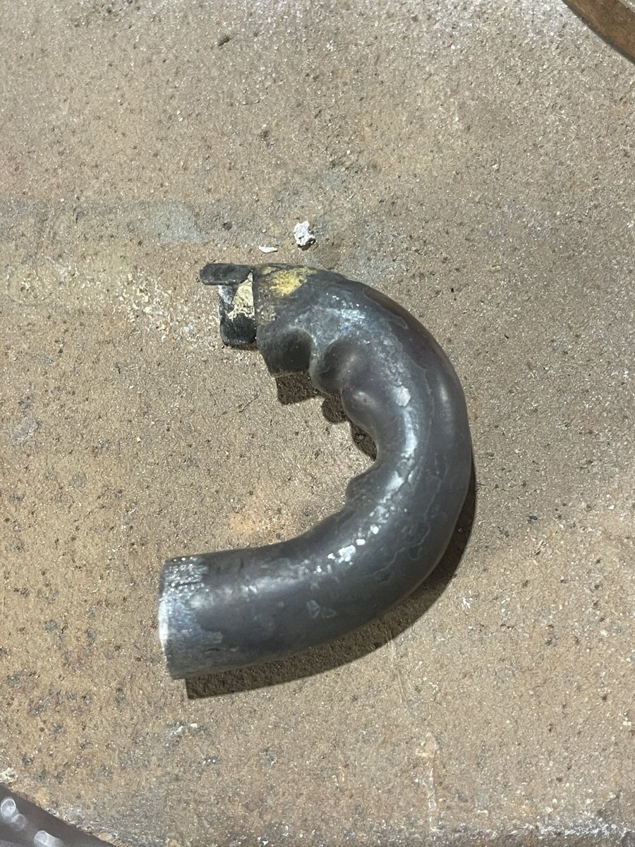

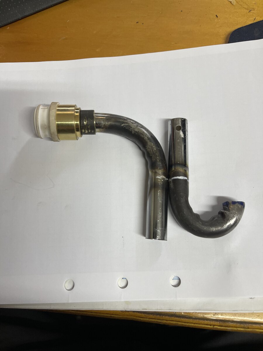

    I tried heating and bend but it kept breaking and collapsed, I used a spring internal but that did work well either, I was given a tip by the fellas to use sand inside the tube so I YouTube it and watched what they did. I gave it a go. Seal the ends I compacted garnet in it.
    I made a basic bending jig.
    I made the burner in two parts. The 180 degree bend then the 90 degree. 36EB5730-F6B2-44FD-9350-1301E2CD67EC.jpeg
    I have the parts so now the fine tuning.

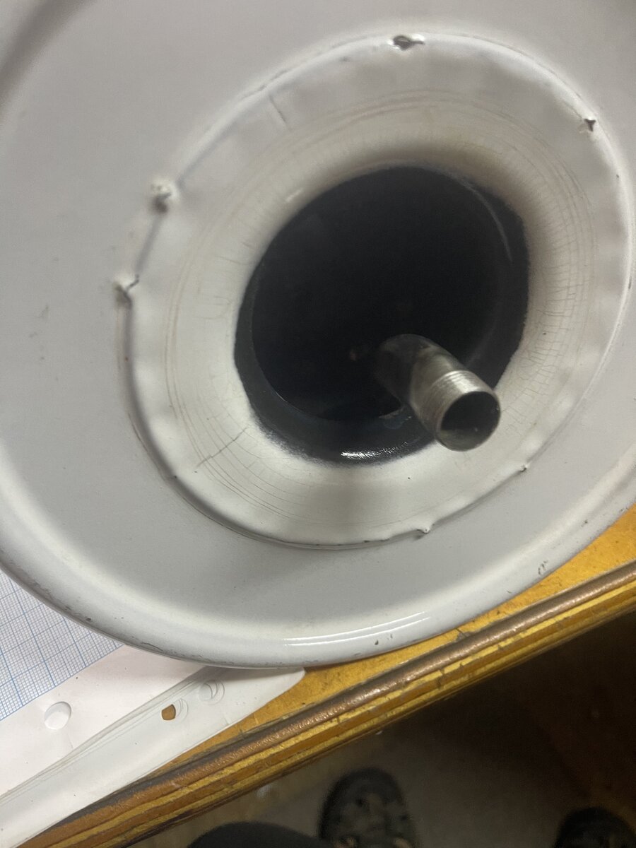

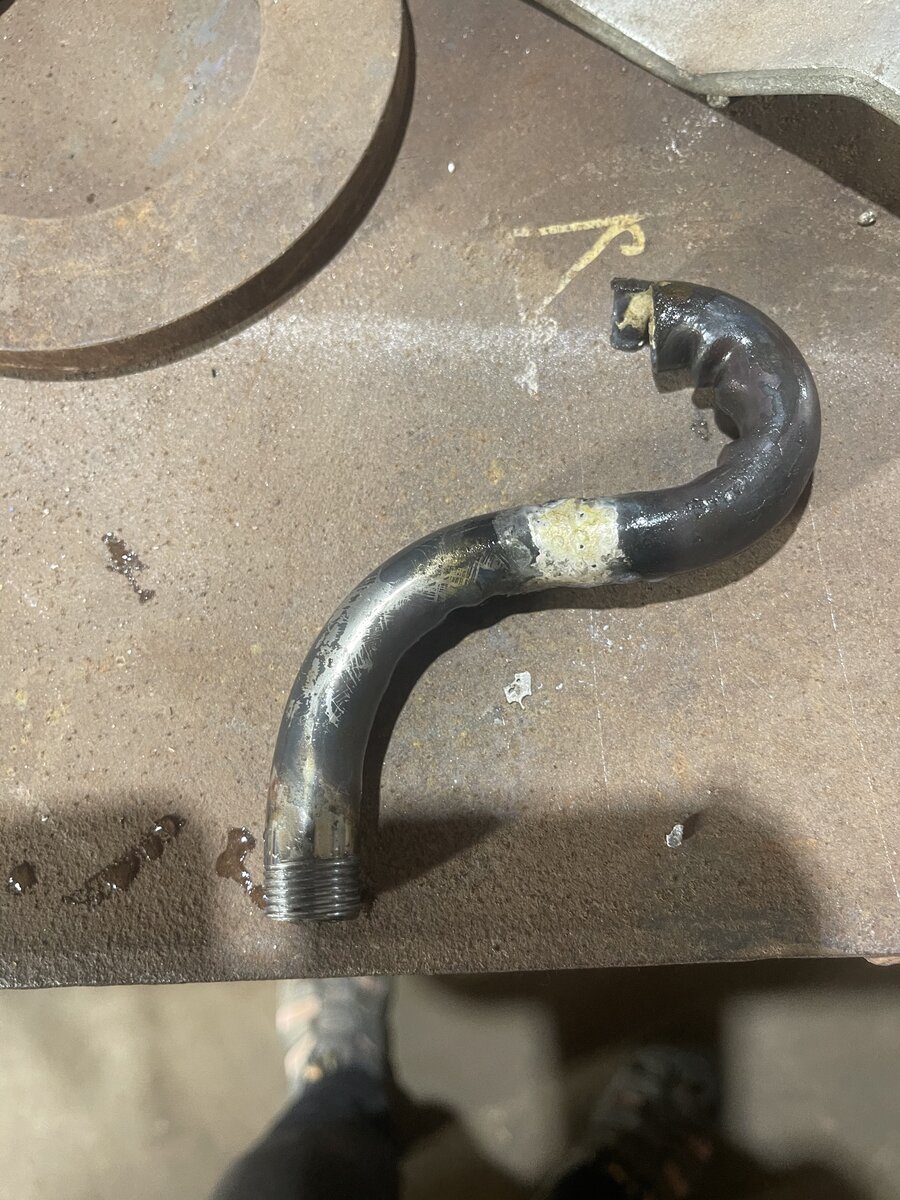

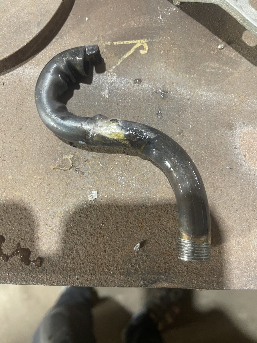

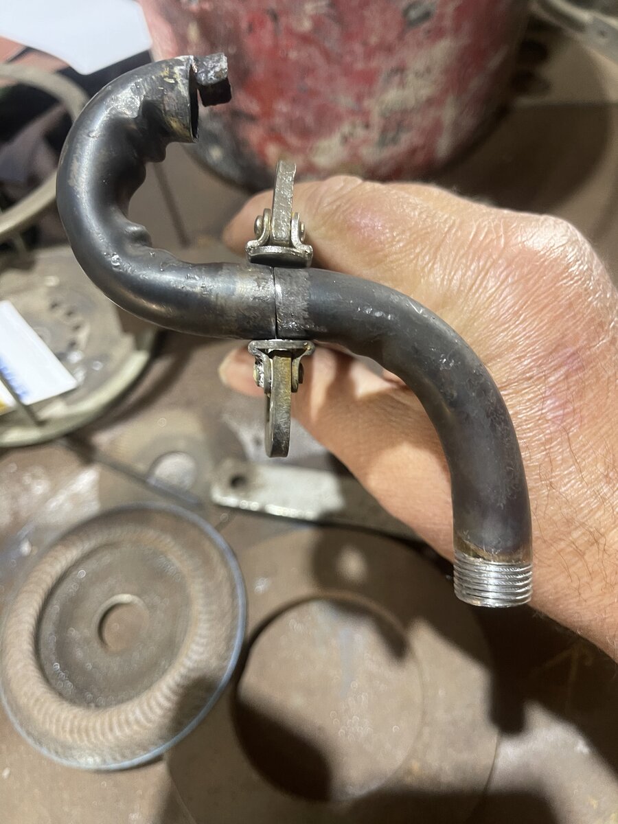

    The 180• bend needed to be fitted to the keeper where the generator vaporises. Bit fiddle, the bend also has to fit inside the outer part and inner part. 7251D8EC-0717-4020-9936-D00FE9C56D42.jpeg

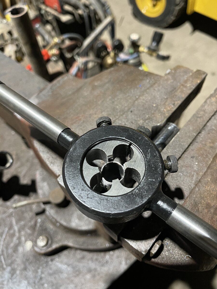

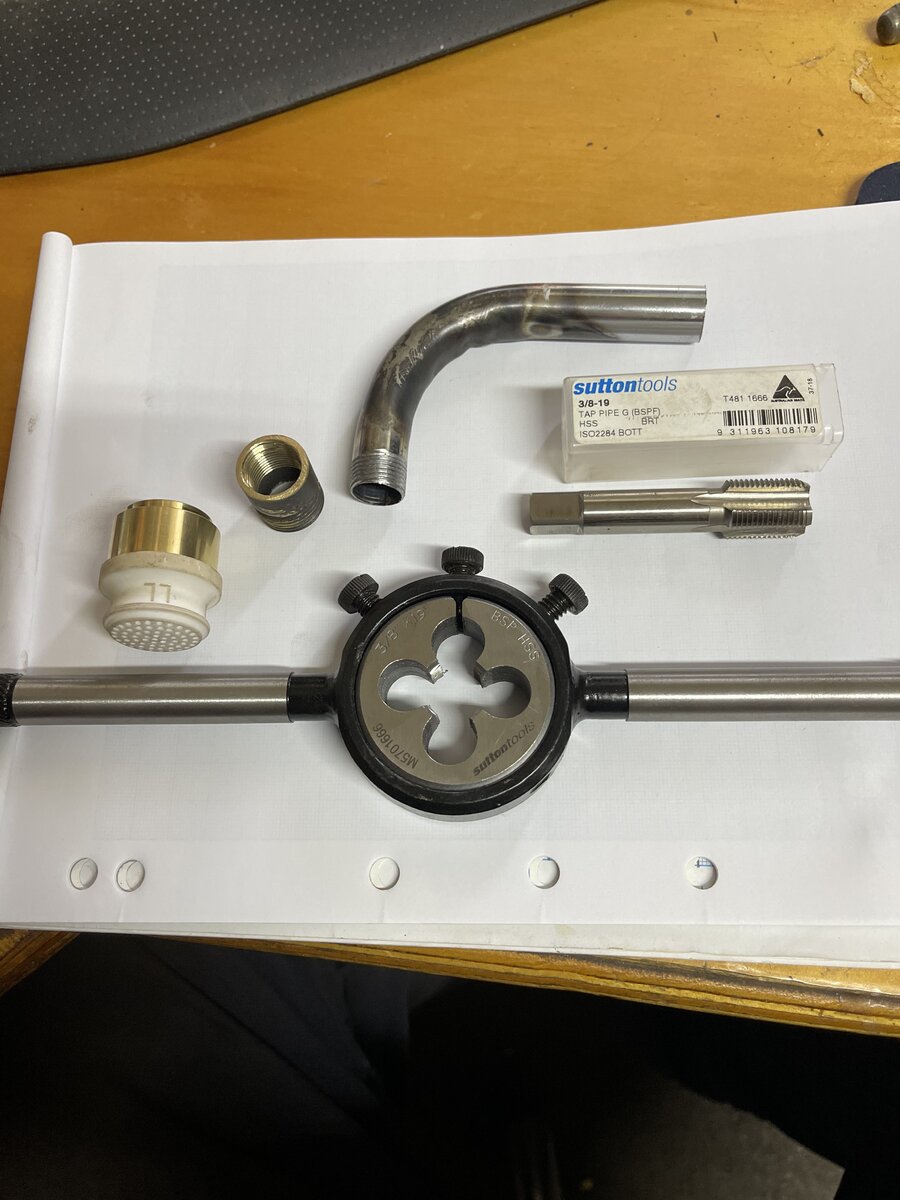

    I cut away small bits and constantly compared it to my picture plan.I made the burner cap from an Aladdin 1A burner. I tapped the burner tube. And the inside of the burner cap part. 14C82A7D-1F7B-4135-9872-3E92166F6F21.jpeg 87CE91EF-A263-437A-8F3B-874038AB67E4.jpeg 4D685EA9-7FE9-4734-AC26-20D56E102BB7.jpeg

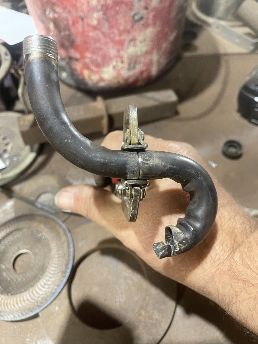

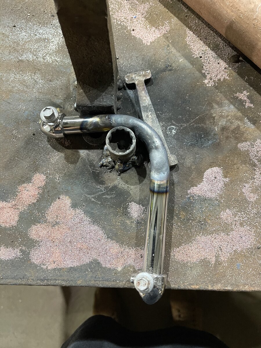

    It’s coming together. Still some more preparation cut file etc. it’s a bit of pre assembly ready to be soldered together
    1473ACB4-B8D6-47AD-99F3-E774A6679A22.jpeg D91676E0-D7B8-4A49-A92C-AEDCDFF7C98F.jpeg
    aligning and ready for silver soldered
    D17B24C2-4E2B-46D3-84D0-09B228681A81.jpeg A1D78BF9-FE9C-44C5-BB2D-1A126B155E83.jpeg

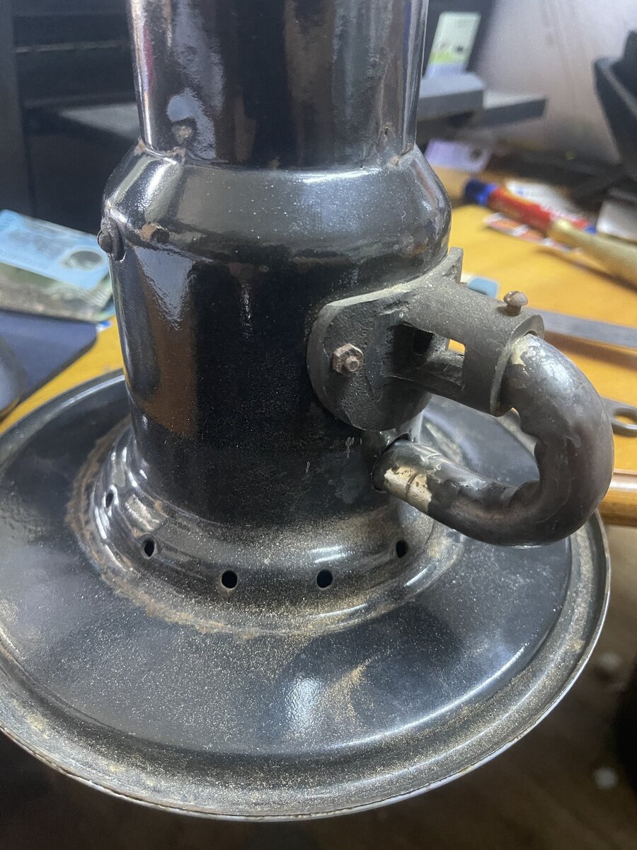

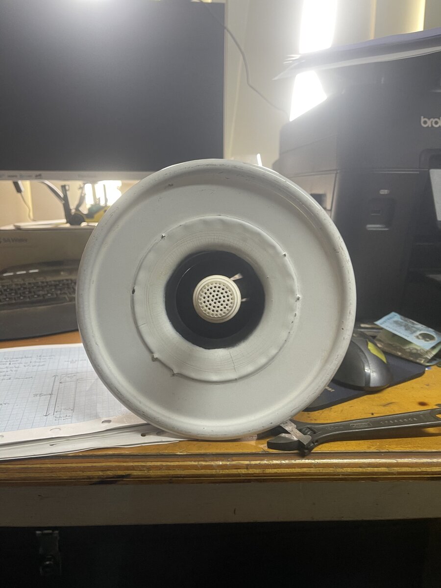

    I assembled everything and installed it in the lantern. It looks even better than thought.
    DE39501C-15B9-4C71-9D02-18D504AD0648.jpeg 95C30BD7-A649-42B0-982A-796B216110BC.jpeg 7B5E5370-E7F8-4CE0-9FD7-02497B382B9B.jpeg D3A4995D-918A-4D4D-A610-928476C309B0.jpeg
    mom very impressed with my fettle skills, all self taught. Trial and error , learn something, try again. Don’t give up.
