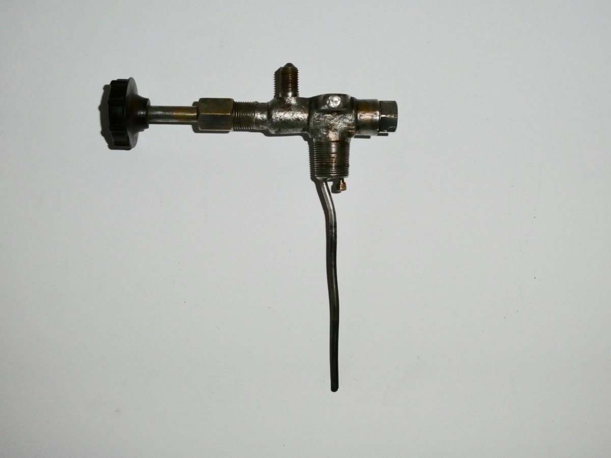

    I've chosen to post this lantern here, as I am sure this was assembled in Australia by the the Gloria Light Company of Australasia. It is essentially a Lind-O-Lite 119 (as shown here by Neil McRae) but it has the Australian Gloria 33 fuel control block and wheel, and an Australian Gloria generator (vapouriser) as seen on the Gloria 33.

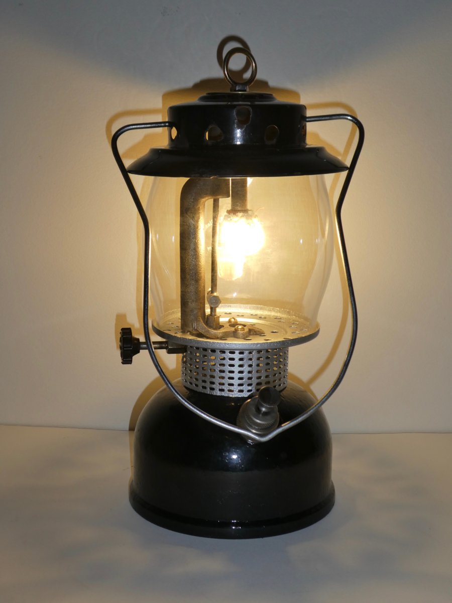

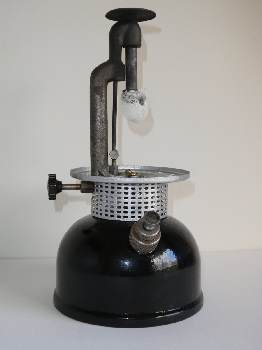

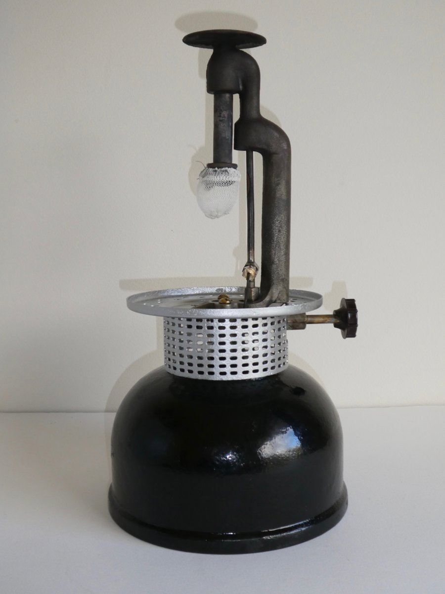

    This first photo is the completed lantern with the parts that I had. I manufactured and borrowed some replacements for the missing parts.

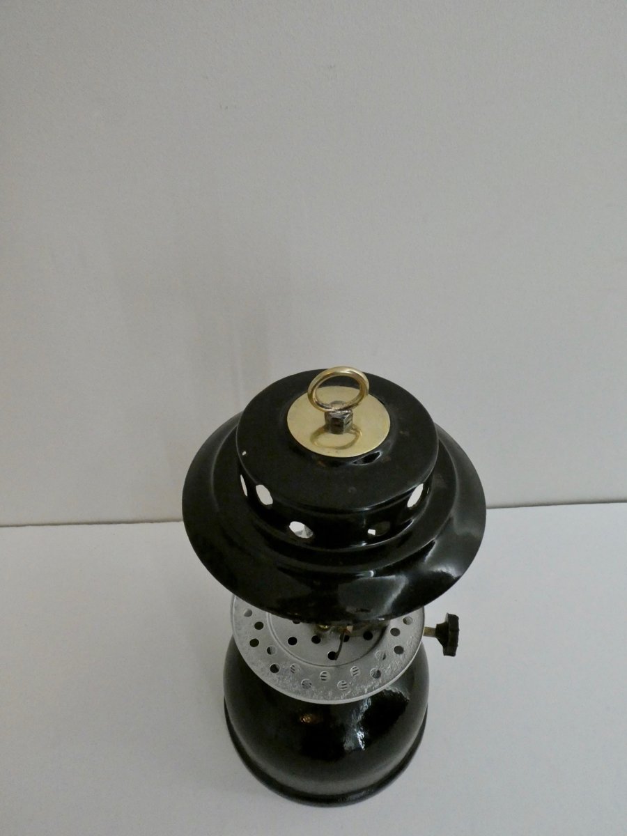

    Here with my home-made final and borrowed bail.

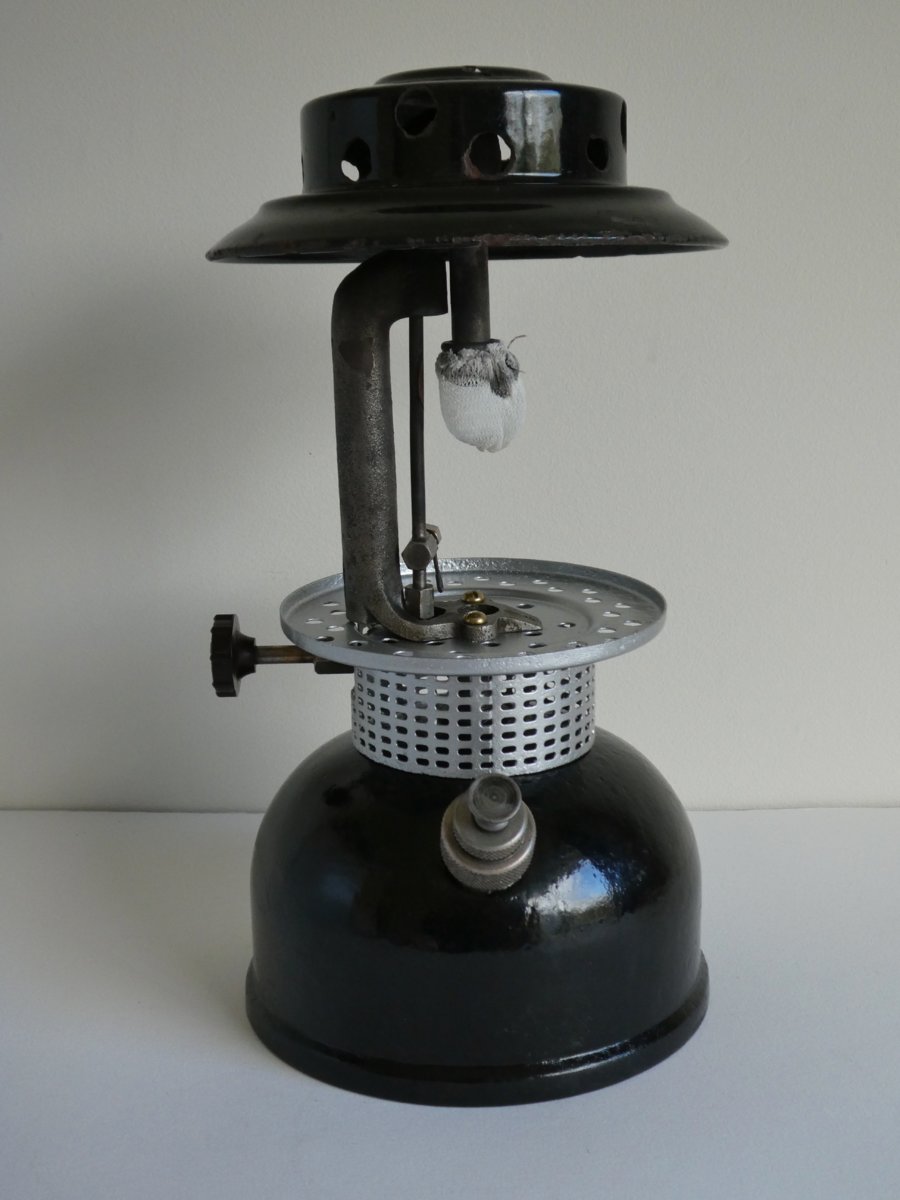

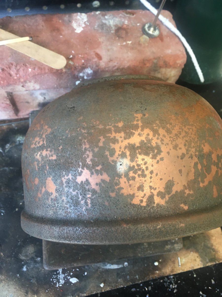

    As it came (but after the collar was de-rusted and primed).

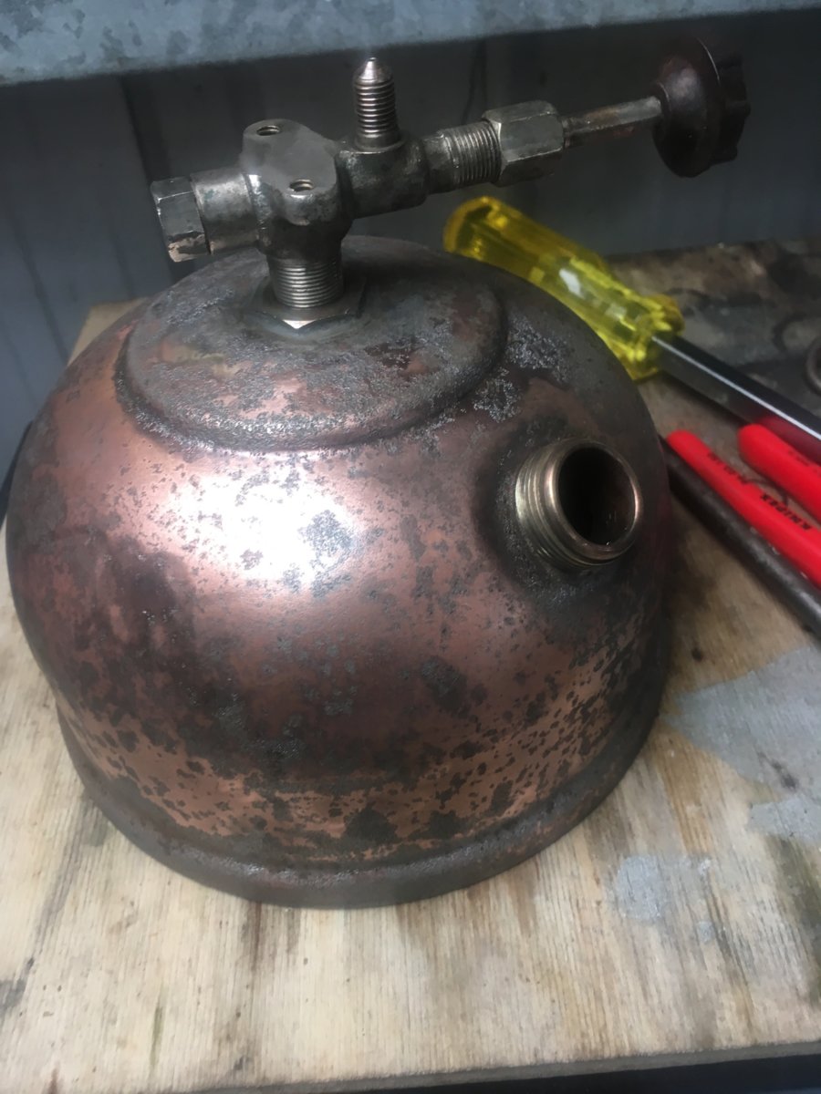

    Fettling this lantern:

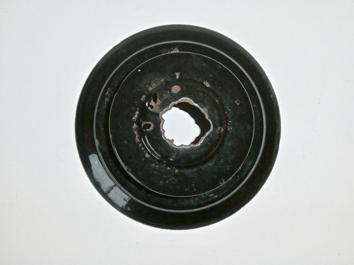

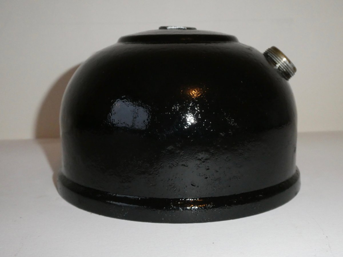

    The tank was very rusty, so I cleaned off all the paint, removers the fuel block, then soaked it in "Evaporust" (a chelating solution) for a week, washing it out every day or so.
    I treated the other steel parts (not the burner) similarly.

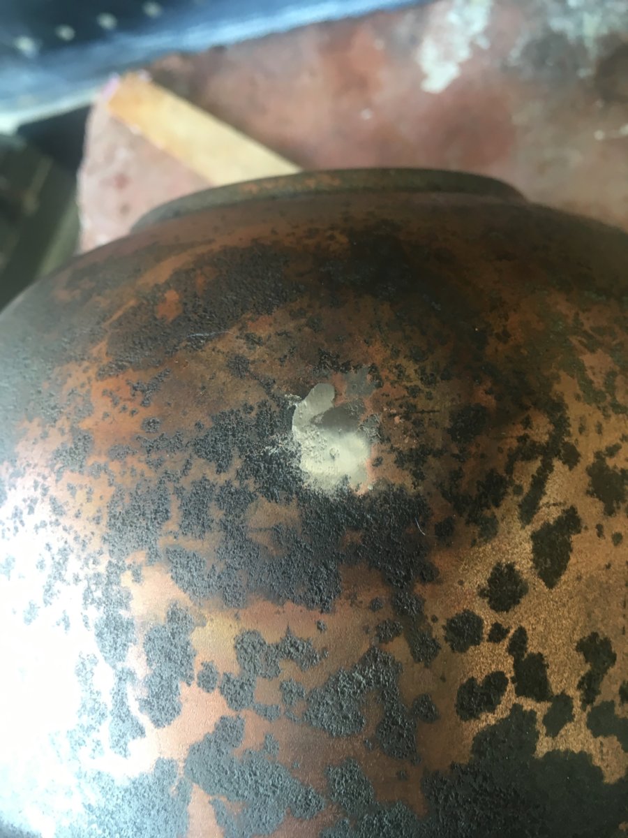

    After all the rust was removed it was clear that there were some small rust holes.
    I decided to bite the bullet and get the Australian equivalent of POR 15, called "KBS Gold Standard Tank Sealer". After preparing the tank for the sealer, I put some sealer in the tank and ensured that the entire inside of the tank was coated. I then pressurised the tank with a battery operated car tyre pump to force the sealant through any holes to the outside of the tank.
    After the required period of having the sealer in the tank, I poured it out and then painted the outside of the tank with it.
    After a week of hardening, I sanded the tank and repainted it black. It's still pock marked but entirely functional.

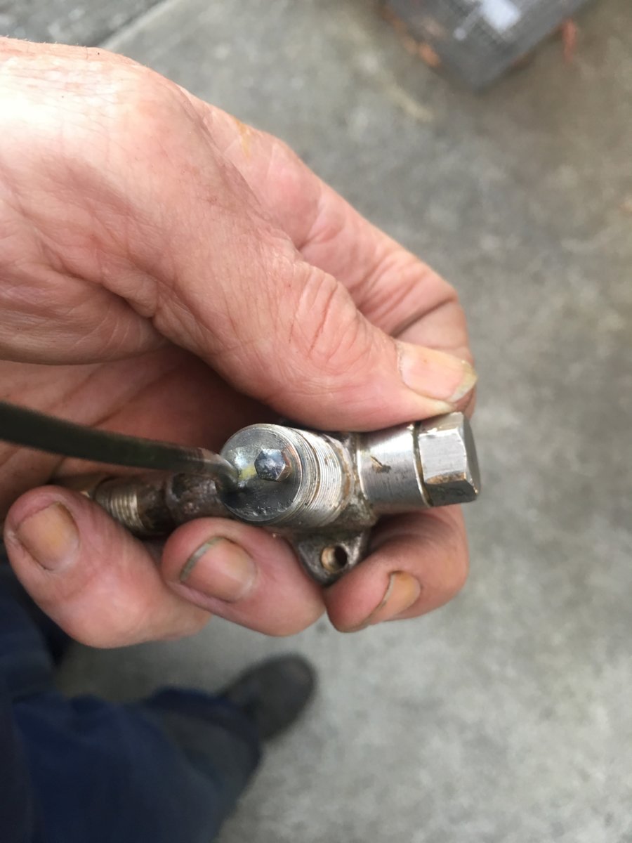

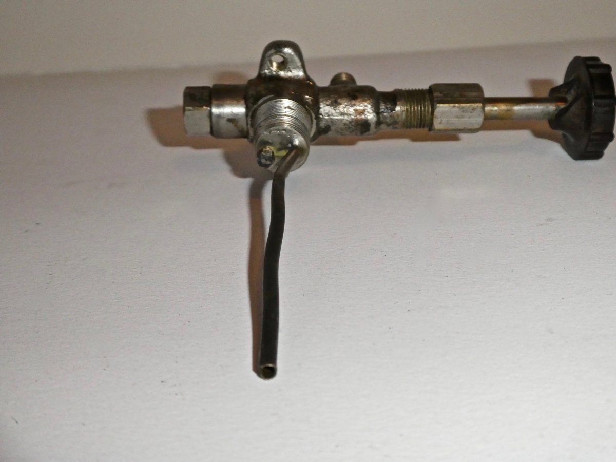

    Note that the small hole in the hex fitting on the underside of the fuel pickup is soldered over.

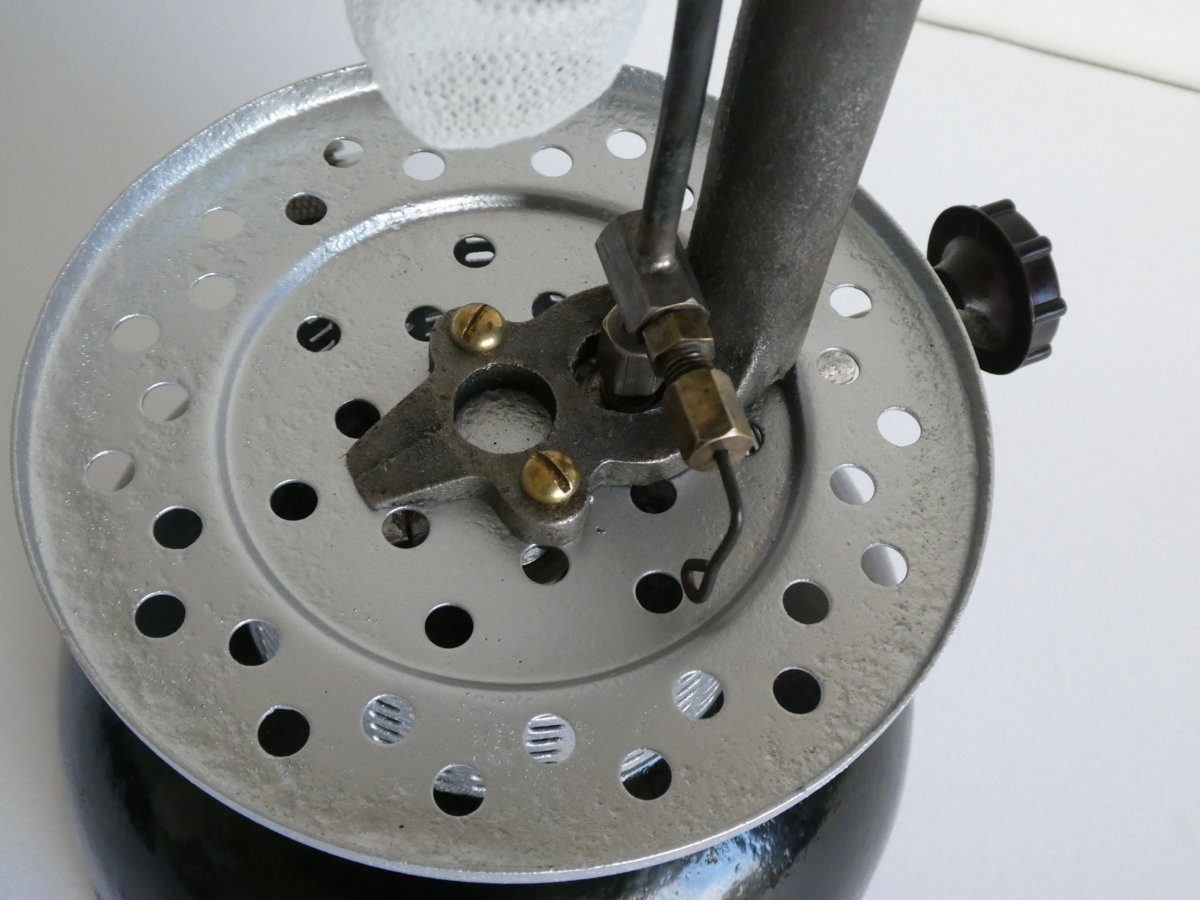

    I made finial from a bolt that was filed to accept a brass ring brazed to it. I used two brass discs to sandwich the hood between the disc at the top of the Lind-O-Lite burner and the finial bolt.
    I borrowed a bail from a "Campway" lantern.
    I am very pleased to have this lantern. It is unusual, and represents another component in the Australian Gloria story.
    I am also very pleased to have got it back in operating order.
