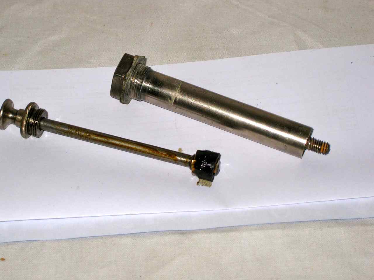

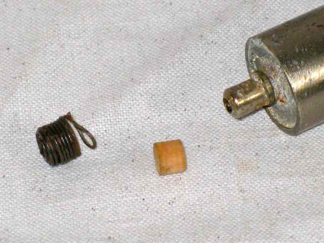

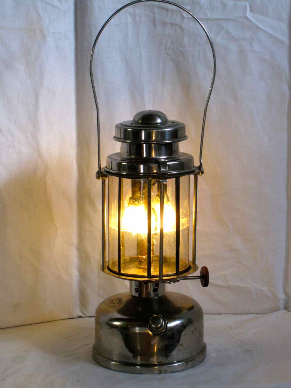

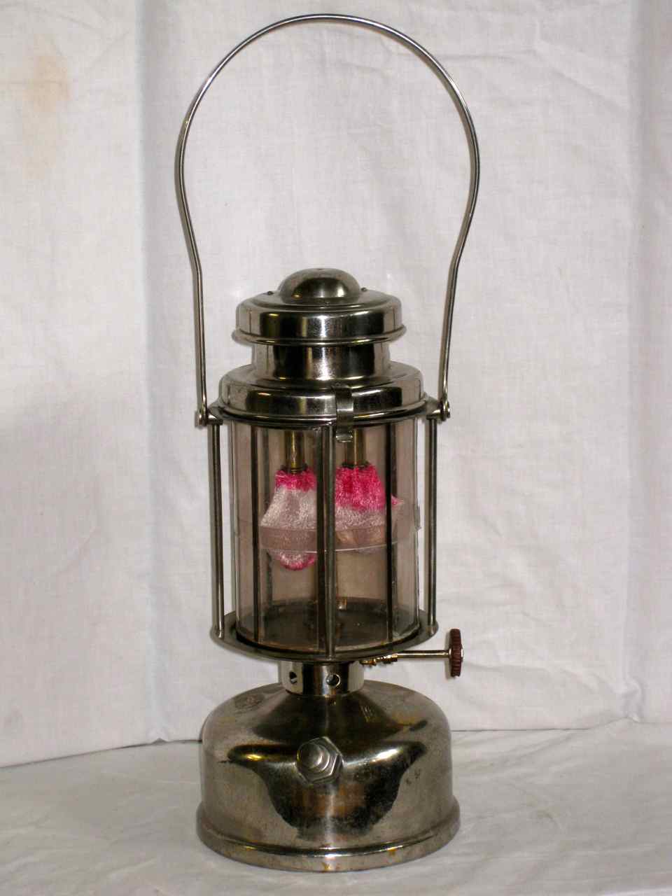

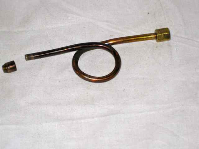

    Hello,
    here is my AUER FEYER lamp.
    I have no idea where the lamp was built.
    Interestingly generator and pump valve.
    Please help me with the Indentification!
    Thank you! Andreas
    1370020948-Auer_6.jpg 1370020963-Auer_1.jpg 1370020989-Auer_2.jpg 1370021008-Auer_4.jpg 1370021023-Auer_3.jpg 1370021041-Auer_5.jpg

    From Spain, Mr. Andrea Lampenlos?
    I have two Laterans with a nearly identical Top .

    That was made in Chicago USA by the Gloria Light Company at some time in the 1920s. The parts are quite distinctive although I have not see this particular model before. It is very like a model R but that is a torch lighting lamp with a filler/inlet valve and yours has a match lighting generator and a built in pump. An interesting lantern that will get added to the lists in the PLC.
    Here is an image of a Gloria model R. Lamp and image are owned by Terry Marsh in Chicago.
    You can see this is the same basic lantern but with torch lighting generator and without a pump.
    Your lamp has obviously been exported by Gloria for re branding as Auer and I would assume that will mean somewhere in continental Europe. We have an Auer which appears to be Italian already in the galleries but I supect there is a German retailer behind the Auer brand. ::Neil::

    Thanks for your information.
    I found the lamp in Spain. As you have written, the lamp was probably built by Gloria Light Company for Europe.
    Greetings Andreas
