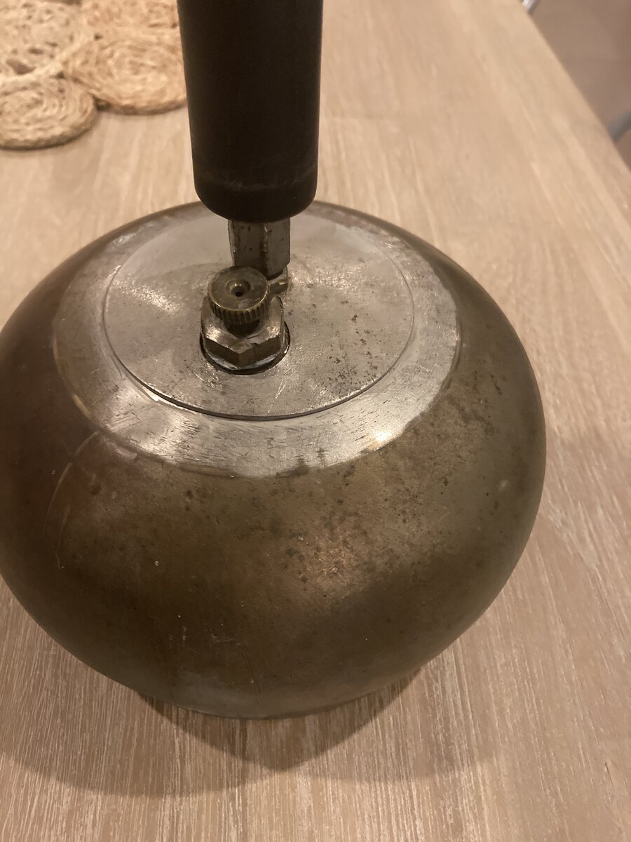

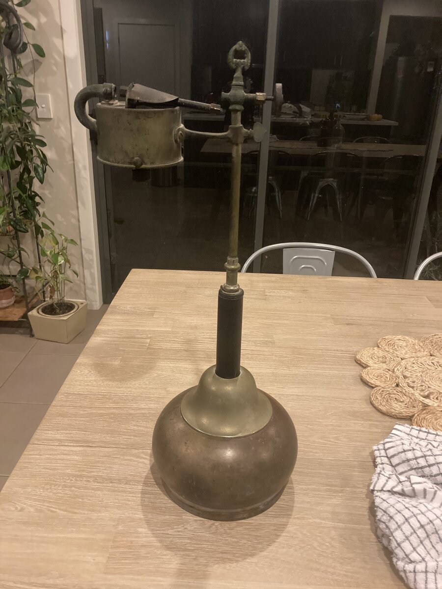

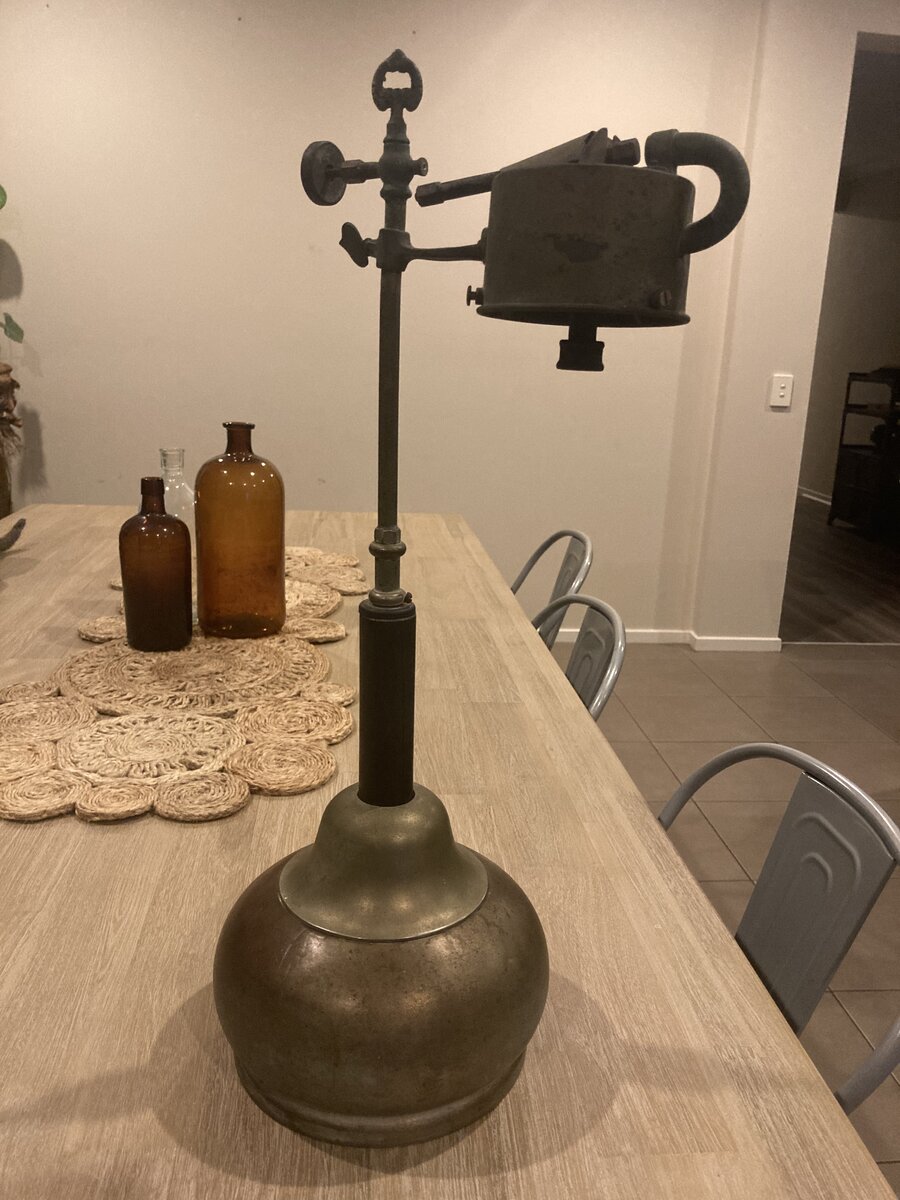

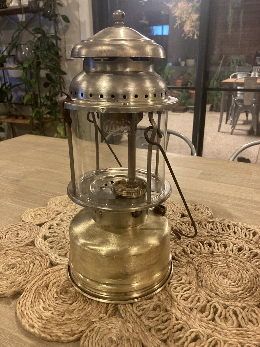

    Today on the hunt for an Aladdin lantern, ended with great results. Whist negotiating with a lovely lady, she mentions she had something beautiful I may be interested in..
    Now I’m pretty new to collecting lanterns, stoves and the odd kero blower, so when presented with a lamp, I was a taken back. Sure it was nice to look at, but unfortunately not my thing. (Also having my partner with me, meant I was quite reluctant to indulge in more than one purchase)..
    luckily this lady twisted my arm, and I came home with my Aladdin, and what I’m not learning is a 1920s Gloria lamp.
    now, I’m hoping to learn a bit more about this beauty, which has stolen my heart, and will likely ignite the next part of my collecting journey.
    I will be on the hunt for a new generator for this girl, and a globe more suitable than that which it come.
    Ive also learnt it takes shelite, rather than kero, as I was first told, but how does one pressurise this tank? I assume some form of pump might be needed… please enlighten me :)
    also includes is a before and after of the new Aladdin :)

  2. Matty H Australia
    Mar 12, 2022
    16
    Geelong
    New Aladdin, although the picker wire is missing :(

    Your Gloria will need a bit of work, but is probably quite repairable.
    Look through the Glorias in the Reference Gallery and you’ll see how they’ve been restored.

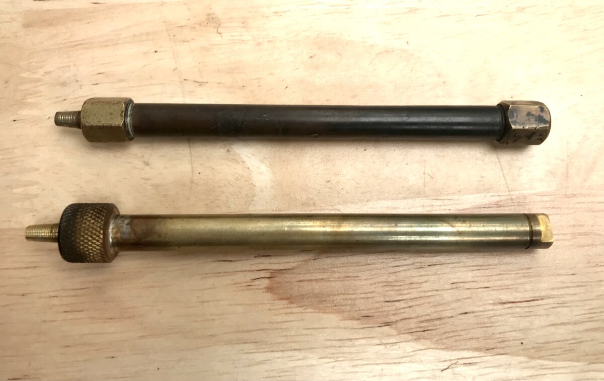

    You can buy reproduction generators from Old Coleman Parts in the US, but you’ll need to make sure the receiving threads on the lamp are ok.

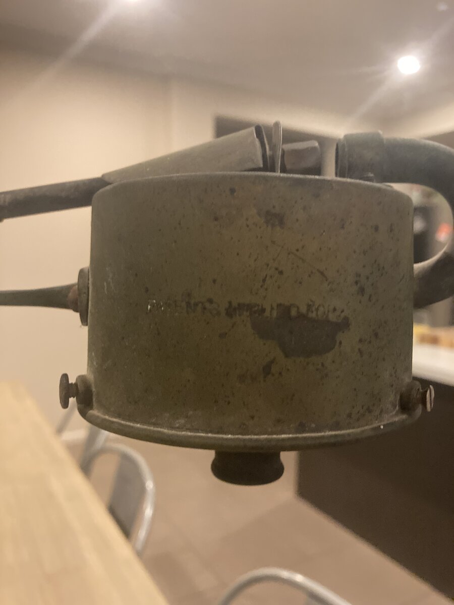

    Is there a maker’s badge on the tank?

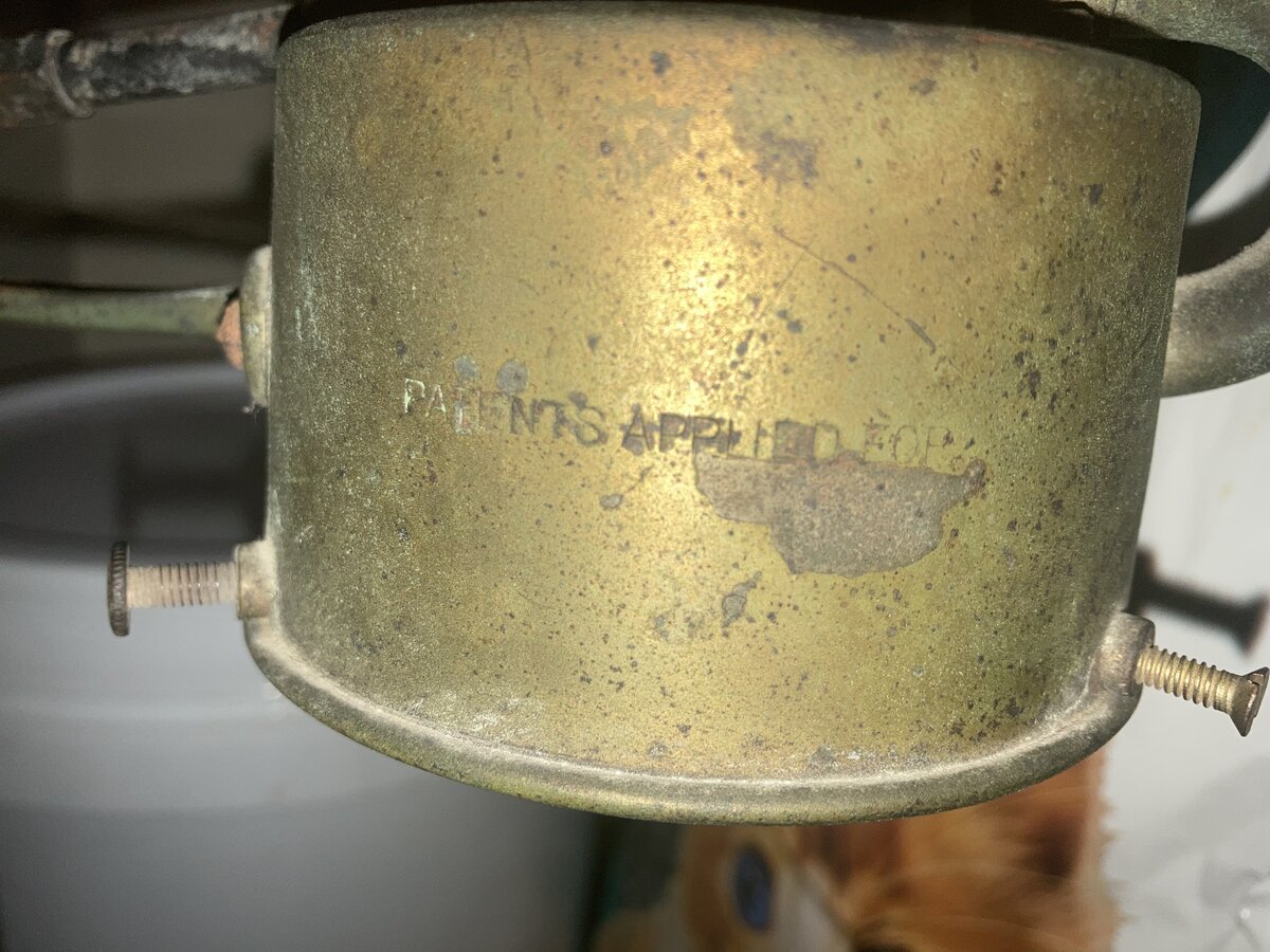

    Edit: What does the stamping on the burner cowl say?

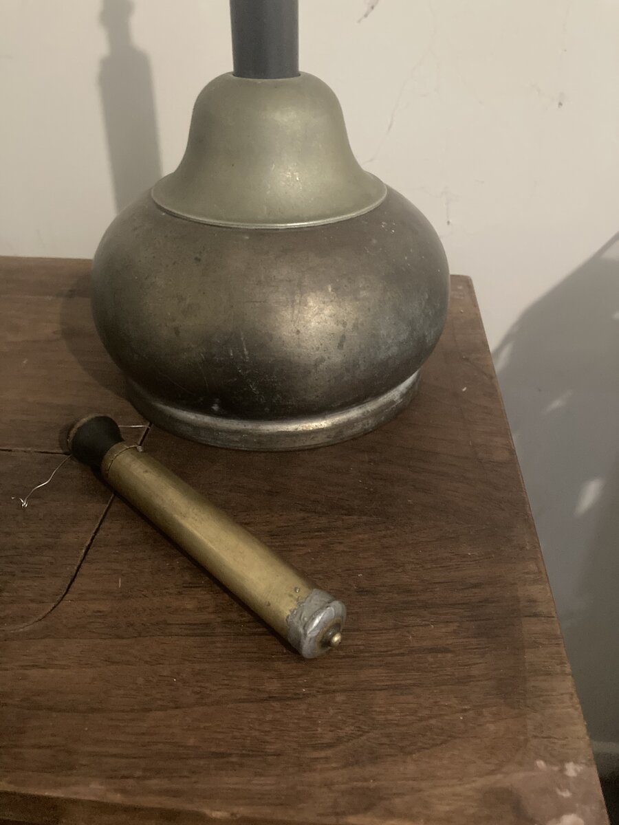

    The tank is pressurised by a pump.

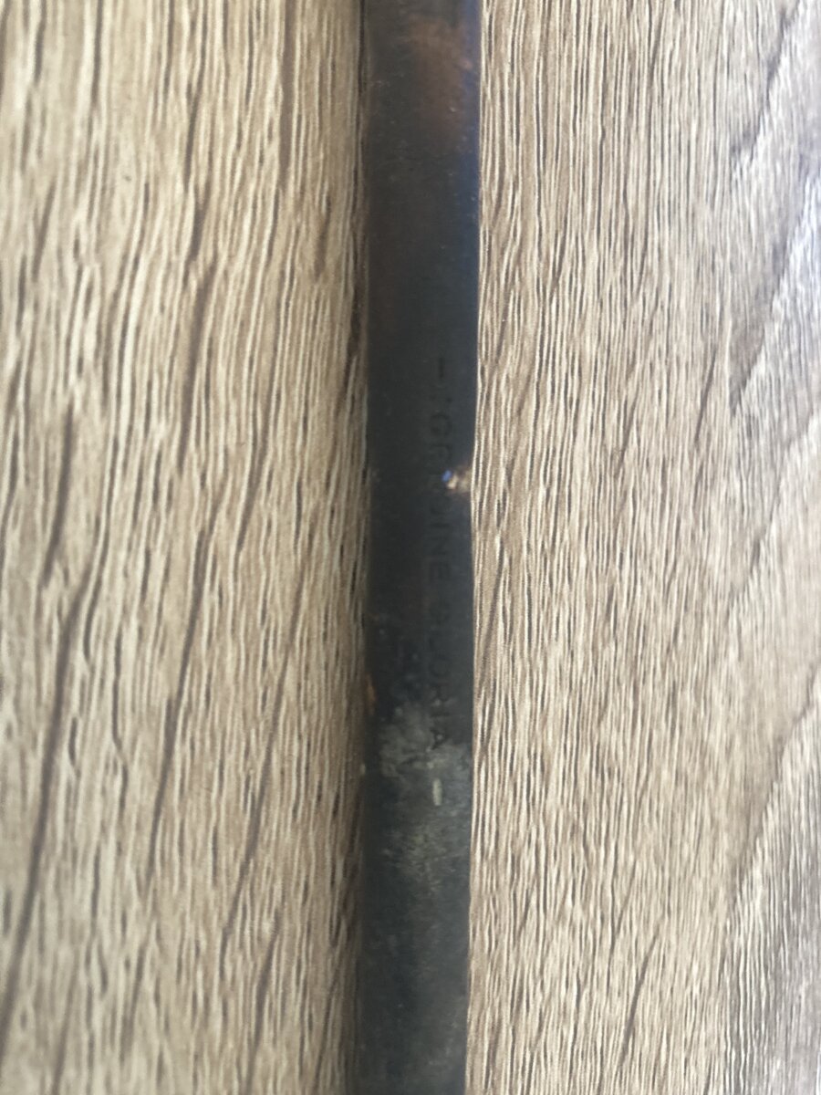

    @Tony Press, hi again tony, cowl appears to say “patents applled fop”

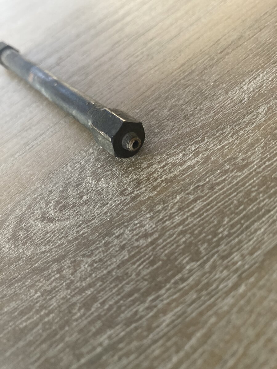

  11. Tony Press
    11,105
    @Matty H
    Is Gloria/Chicago on the cowl anywhere?
    Edit:
    1. You have, I think, what is listed in the Pressure Lamp Catalogue of @Mackburner as “Model AC”.
    2. Before you spend your money at Old Coleman Parts, can you photograph the generator for me, especially the end where the thread is?
    3. Can you also photograph the hole where the generator screws in.
    I’ve got the OCP generator saved somewhere so don’t go searching yet.

    I’m learning a pump will be required, so will be in the market for one of these also :)

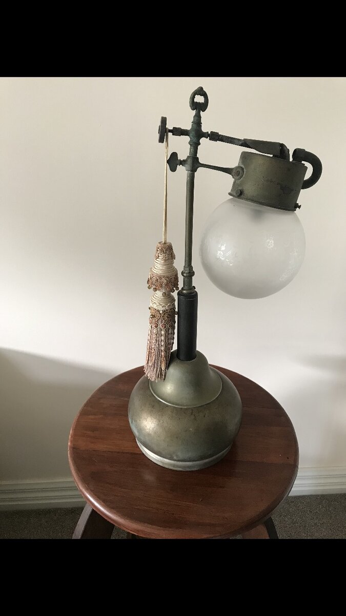

  18. Tony Press
    11,105
    I’ll fettle it for you if you like, but with care you could do it yourself.

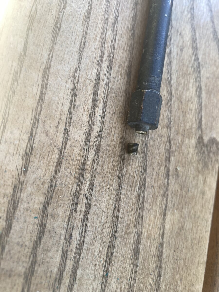

    Looking at those photos, the hardest/most delicate task is to get the broken remains of the threaded end of the generator out of where it is now. :-k

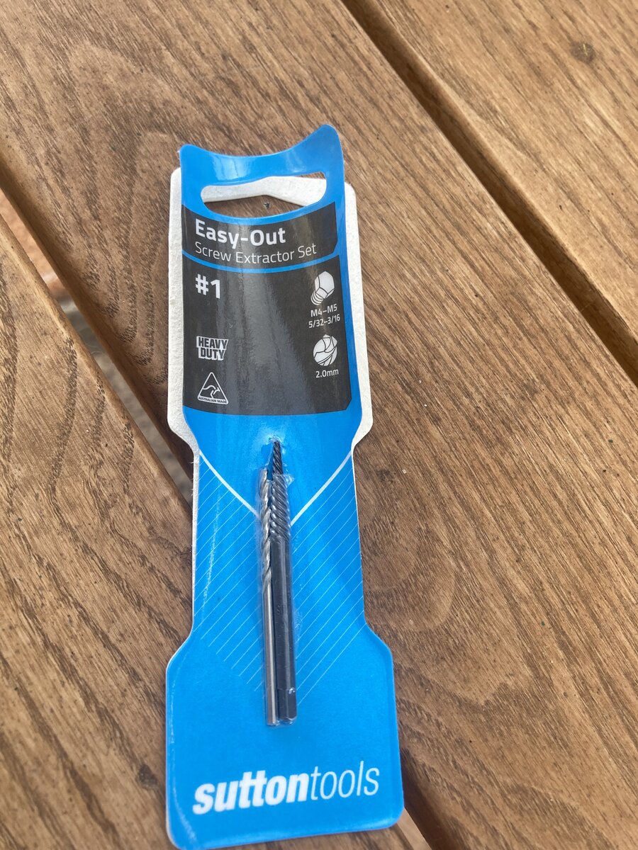

    Yes I’m off to Bunnings this morning to buy an easy-out bit, Darryl has also kindly suggested quenching, and lubrication…. Fingers crossed

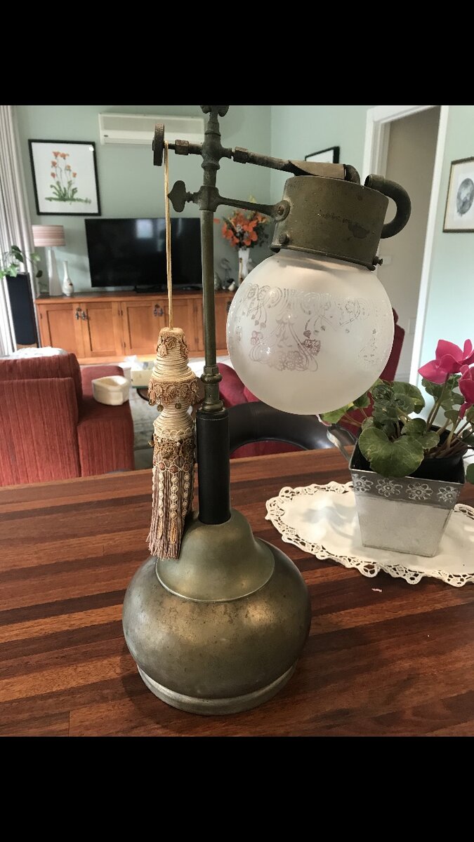

  20. Matty H Australia
    Mar 12, 2022
    16
    Geelong
    Success, thanks to the kind wisdom of the collective. Broken thread removed.
    now contemplating what level of cleaning to undertake? Or is 100 years of patina attractive??

  22. Matty H Australia
    Mar 12, 2022
    16
    Geelong
    That’s what I thought too.. is a soapy bath ok, or best to just leave her be?

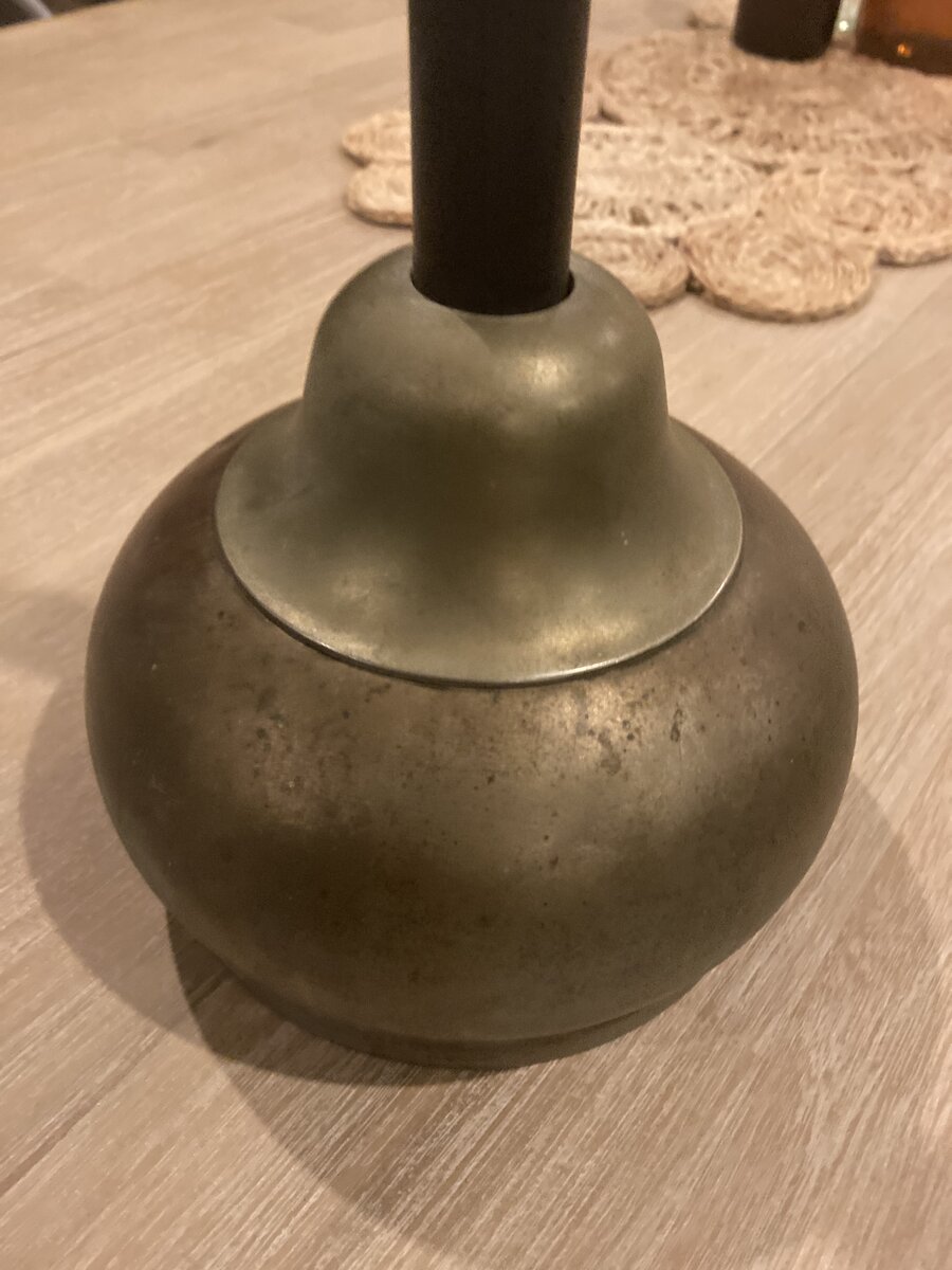

    I have a few Gloria catalogues that I’ve posted in the Reference Library, but your lamp is not in any of them.
    You will need to become a subscriber (very inexpensive) to access the Library.
    The tank is one of the Gloria “Oxo-Gas” type. A few US manufacturers used that tank in the 1910s and early 1920s. The burner arrangement is one that Gloria used on both hollow wire and pressure models.
    I have a new OCP replacement generator you can have for what it cost me (post from US is very expensive at the moment).
    OCP reproduction on the bottom.
    By the way, what size easy-out did you use?
    Best regards

    Easy-out 2.0mm and a tiny bit of wd40 did the trick.

  26. Matty H Australia
    Mar 12, 2022
    16
    Geelong
    Must really be my lucky week, upon being informed of the type of pump I needed, I was able to find one at a local flea market, not surprisingly, they had no idea what it’s intended use was… the perfect little accompaniment to this Gloria.
    Thanks again for all your help guys, hopefully not long till she is firing up again…

    A soapy bath under pressure is a good idea (under pressure) Before trying to light (to see if there are any leaks)
