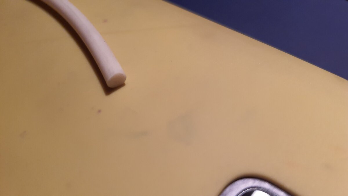

    Hi I have a question about rubber sealing in the one-way valve in the cerosine tank...
    Does it have contact with cerosine can I replace it with a piece of silicon tube?
  2. Lubos Slovakia
    Jul 27, 2021
    29
    Slovakia

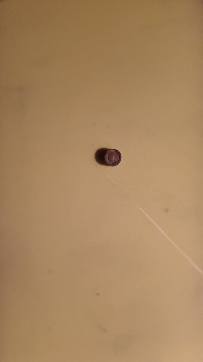

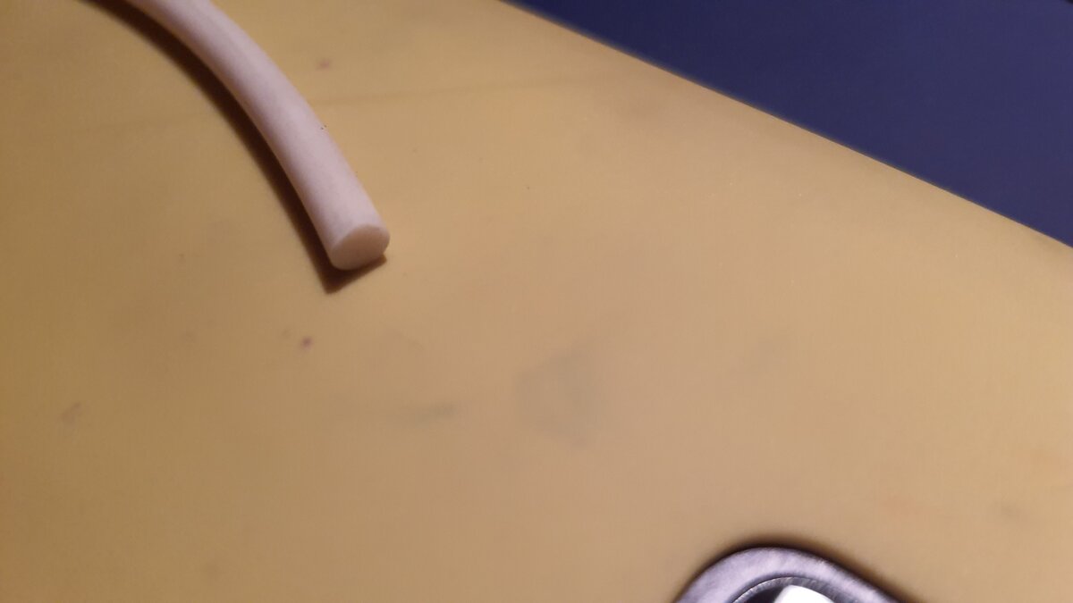

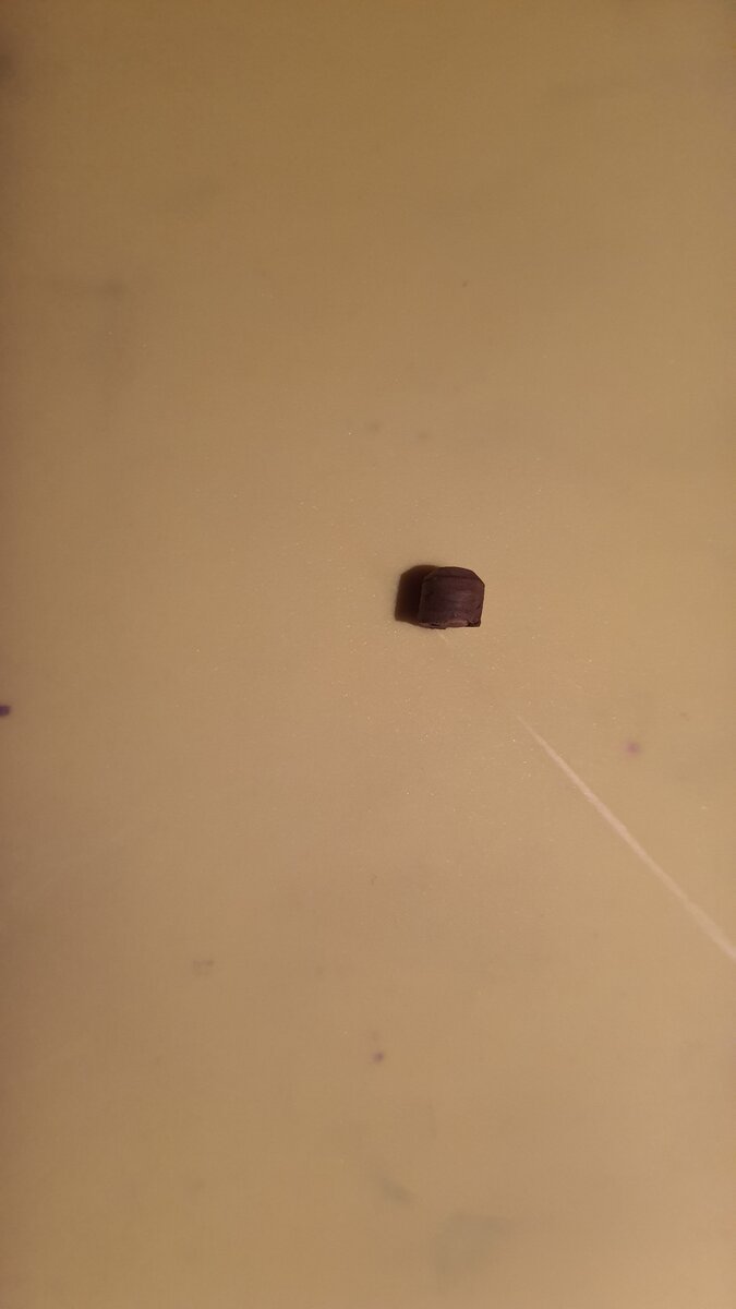

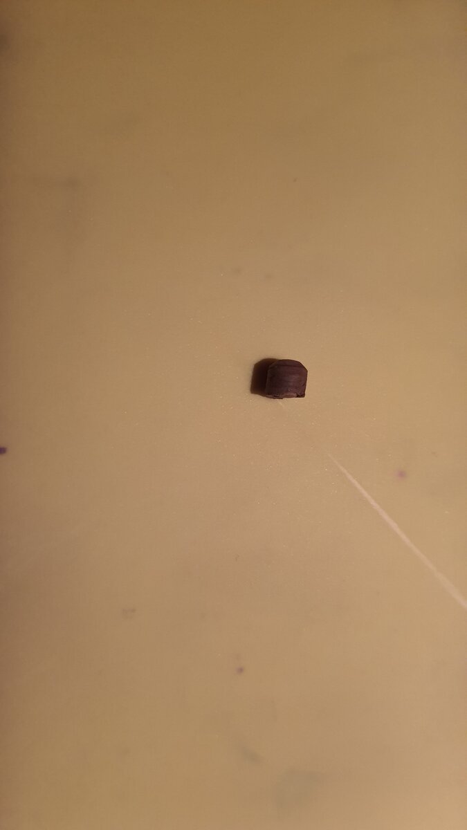

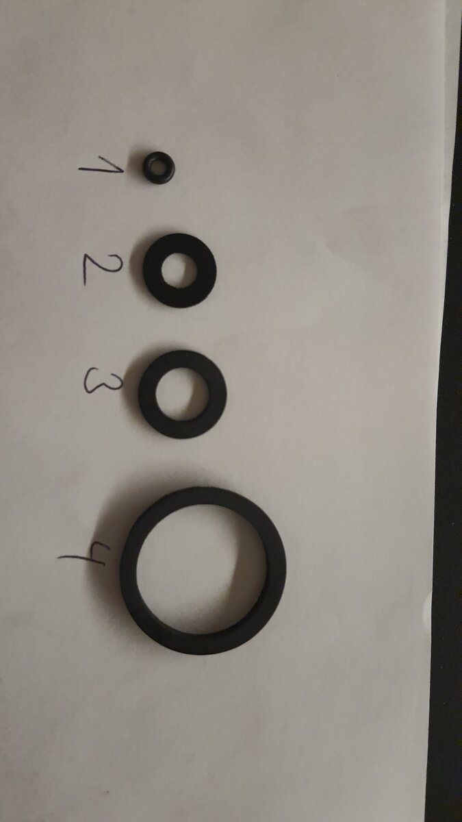

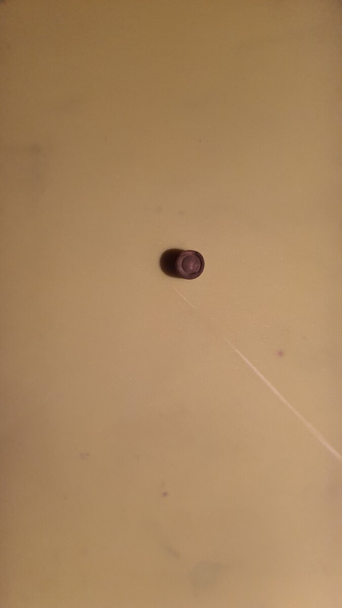

    Hi Colin
    I want to replace the rubber tip #17 in the manual photo 1-2 with peace of silicone tube photo 3.
    The link down on page looks great but I don't know where to put all the washers.
  3. ColinG United Kingdom
    4,816
    I would not use the silicone material. The pups and washers sd by the Fettle Box and Base Camp are made from a fuel resistant material called Viton rubber I believe and I do not think the silicone should be used.
    If you only need the pips, I think either supplier will be able to sell you only these.
    If the silicone degrades with either heat or chemical action it will mess up the NRV.
    Alternatively you can buy a complete new NRV for really not much money.
  4. MYN
    The rubber pip in the non-return valve is always in contact with the fuel(kerosene) in the fount when its filled.
    Silicone rubbers are not fuel-resistant. They will swell and eventually disintegrate in the fuel.
    A long time ago, I found that out. I made a pip by moulding it in the brass cup of the NRV using high-temperature red RTV silicone gasket material. I left it aside to fully cure before using it.
    It worked ok initially. But later, the silicone seal failed as the pip swelled and bits of it went along with the fuel into the cleaning needle mechanism, generator and blocked the jet/gas tip orifice.
    Silicone rubbers are usually quite resistant to heat, oils and water but NOT to common fuels(kerosene, petrol) and organic solvents.

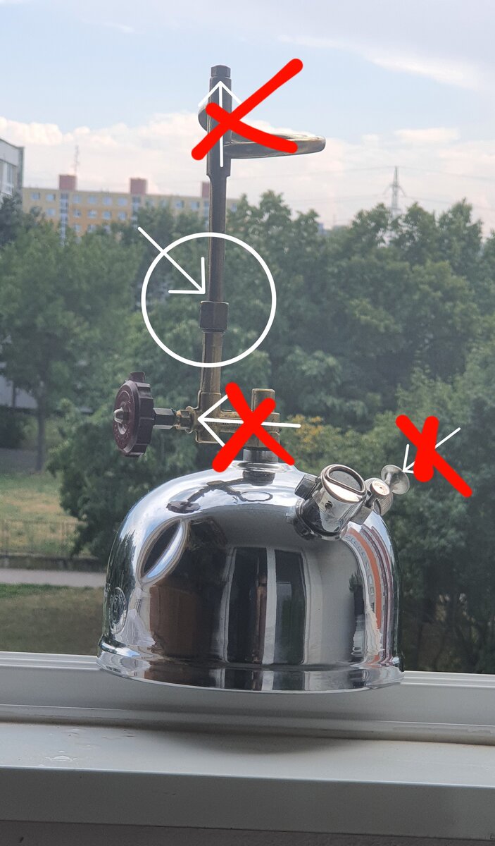

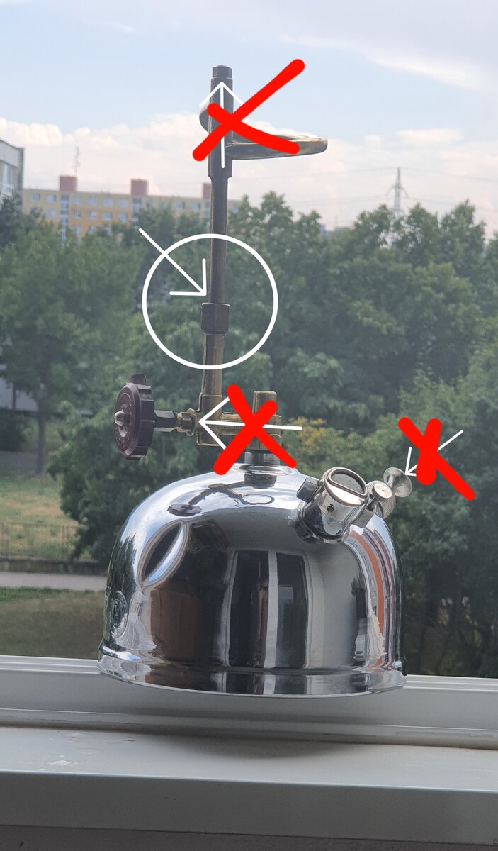

    Hi there
    I have another question pleace...
    On the photo circled... I screw the nut all the way I can, and as tight as I can and the top part is still moving...
  7. ColinG United Kingdom
    4,816
    Hmmm, your drawing is a little confusing. Do you mean the nut that locks the vaporising tube in position? The vaporising tube has the loop of tube at the top close to the jet. If this is still able to turn then something is definitely wrong but I'd need to be more certain of what you mean. Could you make a video to help us understand? You can upload it to YouTube and post the link... that's the simplest way I've done it anyway.
  8. MYN
    You should be able to turn the nut quite freely with your fingers till the cone-shaped end of the upper generator gets squarely seated/mated on the lower part's cone-shaped hole. Then tighten the nut with two spanners/wrenches. One holding the bottom part while torqing on the top gland nut.
    The top(Preston loop generator) should not move at all once tightened.
    If not, something is physically defective or mismatched. Check that the generator belongs to this lantern and the threads are correct. Check the conditions of the generator's mating parts...male(upper) and female(lower) parts.

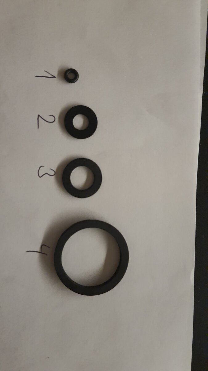

  17. Lubos Slovakia
    Jul 27, 2021
    29
    Slovakia
    Hello
    I come back for an advise...
    Can you tell me please where to put all these washers?
    They are for Tillylamps and I have Goldmohar lamp but I think there isn't such difference...
    Thank you for all your response
  18. Fireexit1 United Kingdom
    3,538
    Hi Lubos - sorry - you think wrong. The Tilley and the Gold Mohar are totally different !
    If you wanted washers for the Mohar I think a place to start would be Anchor or Petromax, but no guarantees of anything fitting.
