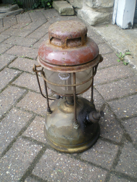

    I managed to find this Tilley for under a tenner - who could resist? (just don't tell the wife)
    This is my first X246 and from research I think it was made between 1957 & 1961. No name stamps on the side of the tank but looks like it has a very faint date stamp on the bottom. Although I'm happy stripping down and servicing X246 B's I've never done an X246 before so will be proceeding slowly!
    In my opinion, a more straightforward fettle than the X246B. Good for under a tenner.
    I'm curious about the date you think it has stamped on it. The hood is brown, and of the original shape for that kind of hood (ie one 'lip' rather than two).
    Let us know what the stamping says.

  3. Stuart Taylor
    Apr 19, 2015
    207
    Fife, Scotland
    I think the styling at the top end of the cage dates it earlier. Going to say 1949 - 1954. But others more knowledgeable will provide the correct answer.
  4. David Shouksmith
    The handle attachment would suggest earlier - up to about 1954/5
    There's not a great deal of difference. The NRV is plain (as opposed to shaped) and sits in a small brass cup. Also, the control cock sits in a small brass collar which allows the knob to be positioned between the brass uprights. I've never had to do it so I've not bothered to figure it out but, apparently, it's not difficult. Gneiss published a 'how-to guide on here, somewhere. Hope that helps...
    Edit: crossed with Stuart...

    Update: I've given the tank a good scrub and what I thought were numbers are just scratches. There is no makers stamp or numbers anywhere on the tank.
    does that narrow down the possible date of manufacture?
  12. Tony Press
    1949-1954 inclusive.
  13. Scouter Bill
    Scouter Bill Subscriber
    Apr 30, 2015
    173
    Thank you
  14. Mackburner
    The guys are right. Tilley started to stamp the tank sides in 1954 and added a date stamp in the base plate from October 1956. Your lamp without any stamps and that loop attachment for the handle places it from 1949 to 1954 for sure. This means the quality of the parts will be good but the burner may be worn internally and might need replacing. ::Neil::
