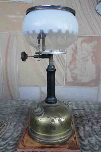

    Good to see that there are still collectable lamps out there.
    This one turned up at Katoomba NSW. In the shadow of the 3 Sisters.
    Interestingly it has a Wizard Hollow Wire Glass in it. You hardly ever see these with the glass in them. Even so who is to say that this is original for lamp.

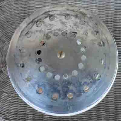

    There are a few discrepancies in comparison to Wizard to make you wonder. There is a 20 mm difference in the ID of the section that sits on the base plate of lamp. The top of the glass has been ground down to remove what normally would have been the lip to attach to the Wizard HW.
    The top retainer was made out of the insert in the bottom of an Aladdin 1A.
    Looks a bit " Optimossy "
    Colin

    Very interesting find. It is probably impossible to know what was "standard" on the GS lamps.
    How do you know the top comes from an Aladdin 1A?
  3. Colin M
    Dec 4, 2010
    235
    Hi Nils,
    Cuz I took it out of it.
    Colin
  4. Nils Stephenson
    3,384
    At least we know then that it isn't original. ;)

    Anyway, getting back to the lamp. Is it necessary to have the top cap on the globe? Will it fall off if it isn't there? I'm just thinking that there might not have been one originally, or at least when the Wizard glass was adapted.

    As can be seen from the shape of the glass it is top heavy. In its use on the Wizard HW this is OK as it is suspended under the burner with smaller section to the bottom.
    On the GS application its a bit like trying to balance a pyramid on its apex. Not very stable at all, OK when left alone but try to move it and it topples over, definitely needs something to stabilise it.
    Another scenario is perhaps an inverse spider so to speak like on the wickie lamps
    This could be just an exercise in futility but I find the discussion interesting which is what it is all about. .... an expression of views.

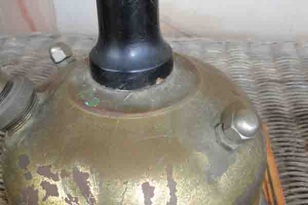

    Does the tank have the studs where an AP2 frame would attach like the other lamps shown in the gallery? Is the pump like a Kayen one?

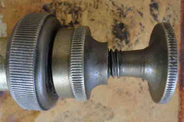

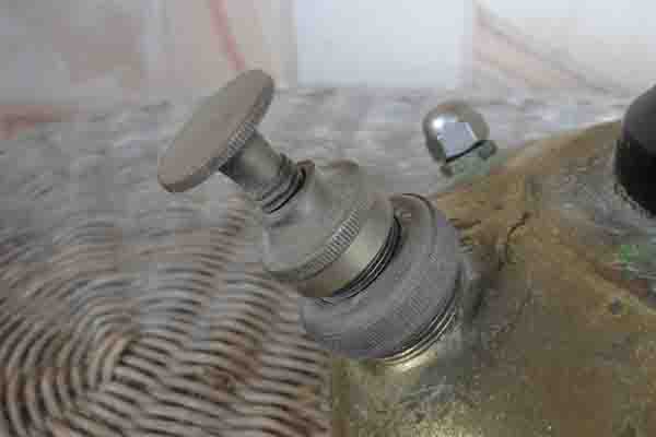

  15. Colin M
    Dec 4, 2010
    235
    Some more pics.

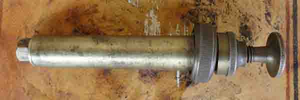

  16. Colin M
    Dec 4, 2010
    235

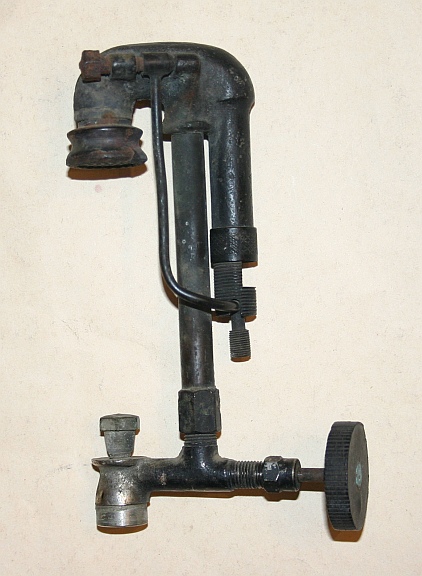

    More pictures of pump.Threaded at Pump knob, allows to lock down and seal the valve at bottom of pump tube.
    Colin
  17. Nils Stephenson
    3,384
    I'd forgotten that these burners were for petrol, so good to see a positive shut off for the pump. It is very much like a Kayen part but with a few small differences, knob with thread, different valve and straight knurling. Looks very proffesionally made so I'm tending towards the Kopsen (or supplier) idea for manufacturer.
  18. Colin M
    Dec 4, 2010
    235
    Opps, a problem, thread doesn't appear to be affected so will probably put a sleeve over it.
    Colin

    Is this vapouriser/burner assembly intended for the use of paraffin/kerosene or petrol/gasoline?
    It looks as it is able to preheat paraffin very well, the pipe going down from the big burner head to the vapouriser makes me think that the use of paraffin should be possible...

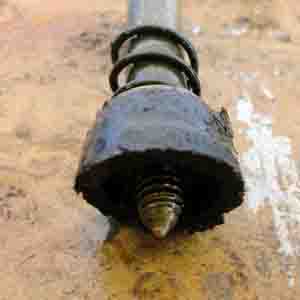

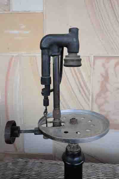

  20. Mackburner
    The burner on these is a 1920s AGM gasoline type. It will not like kero. This table lamp is interesting because it uses a home grown tank but the handle and burner unit are clearly old AGM. I suspect these lamps were made around the late 1930s and pehaps into the 1940s. From 1938 AGM were in trouble with a very acrimonious strike in 1938 and a liquidated buy out in about 1942 ish. I think it is very possible that these obsolete AGM parts were sold off cheap either by a desperate management or a receiver and used in Aus to make a cheap product. If so those burners had been sitting in a store room in Albert Lea for maybe 15 to 20 years before AGM found a buyer for some of their obsolete stock. ::Neil::
  21. Colin M
    Dec 4, 2010
    235
    Picture a bit confusing, it is the main feed from the tank. Burner assemble / generator resides on top.
    Any clearer?
    Colin
  22. StephanE
    StephanE Subscriber
    Jul 17, 2011
    646
    A photo from the backside of the assembly would help :content: :thumbup:
  23. Dan D
    Dan D Subscriber
    Feb 13, 2011
    374
    I agree with Neil that this is an AGM burner. It's a gasoline quick light version. You can see this burner in operation on Bob's lamp here .
    It was patented in 1916. The patent #1207031 is an interesting read.
    The difference between yours and the others I've seen, is a slight difference in the casting (above the mantle spigot) and the long control valve stem, indicating that this was probably made for your lamp. Is there a threaded hole in the top of the burner? If so, I suspect that this could have been there to attach a shade holder or possibly a vent cap assembly along with a mica globe as this seems to fit with the support plate that is currently on your lamp. It's all speculation though.
    I have a version of this burner which I will someday get running, after I find/make a couple of the pricker parts.
    Dan

  25. Tony Press
    11,056
    CLARIFICATION OF ITEMS IN THIS OLD THREAD.
    My purpose for posting this commentary here is to clarify a couple issues that were raised in the early days of discussion of these Quirk’s Victory lamps and lanterns.
    1. The burner.
    The burner on Colin Mills’ table lamp, shown in post #15, is the Quirk’s copy of the AGM. The Quirk’s Patent (granted in 1922) is shown here:
    https://classicpressurelamps.com/threads/quirk’s-burner-patent-no-3904-1921.17861/
    The original AGM burner patented in 1916 is shown here:
    https://classicpressurelamps.com/threads/agm-burner-patent-no-1207031-1916.17860/

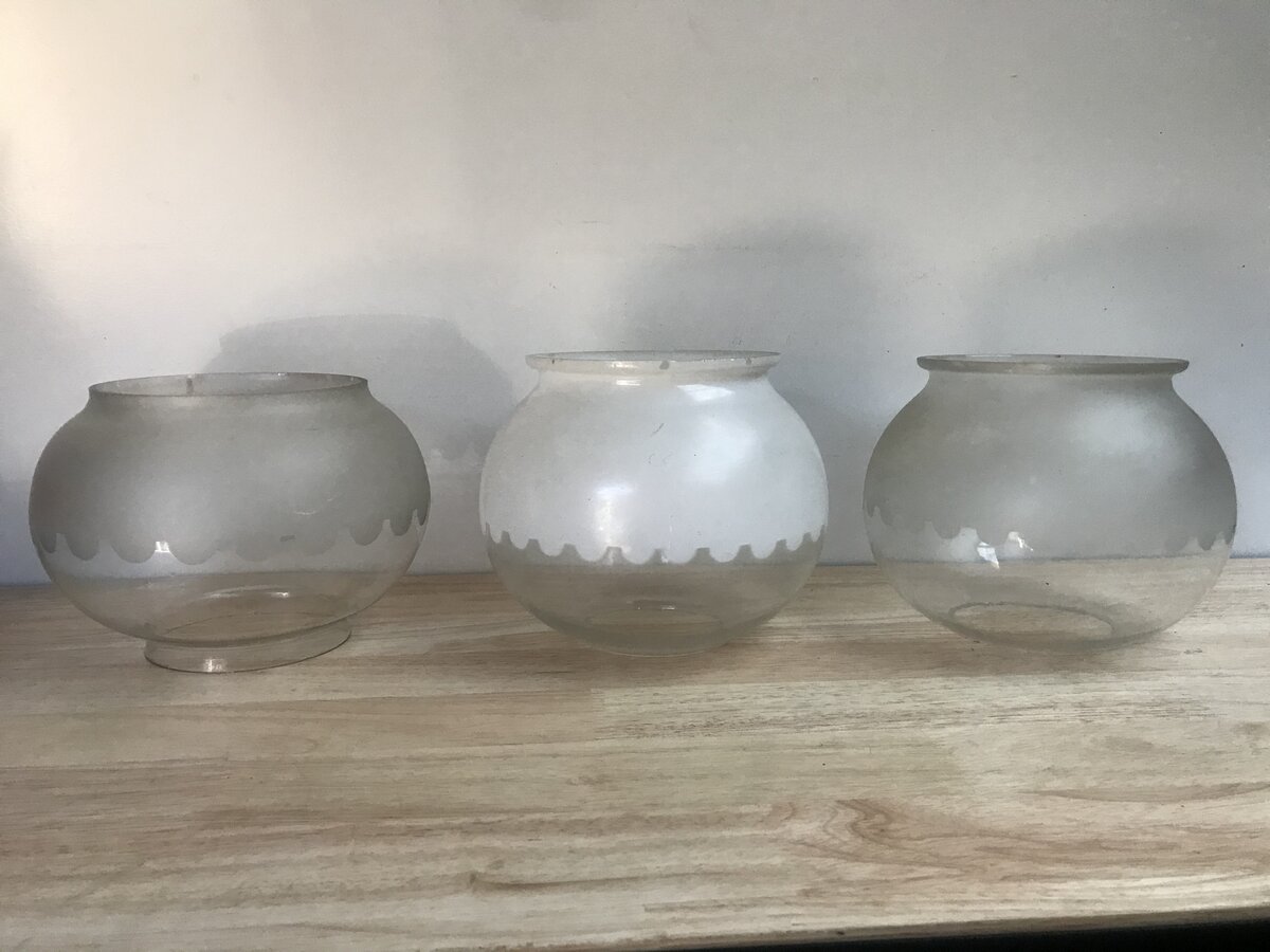

    2. The globe.
    The globe shown on Collin’s lamp is original to the Quirk’s table lamp.
    Colin says above “...interestingly it has a Wizard Hollow Wire Glass on it... the top of the glass has been ground down to remove what normally would have been the lip to attach to the Wizard HW”. The glass is not a Wizard Hollow Wire glass. I have compared the two different kinds of glasses (as has @Anthony, see below) and the Quirk’s is made differently, and is much lighter - it is not a Wizard glass cut down to fit the Quirk’s (see also thread by @Anthony shown below).
    From left to right:
    Quirk’s; Wizard; Wizard.
    Some of these issues were discussed in this thread:
    Quirk's Victory Light
    @Anthony @Nils Stephenson @Graham P @Lamp Doctor @Mackburner
