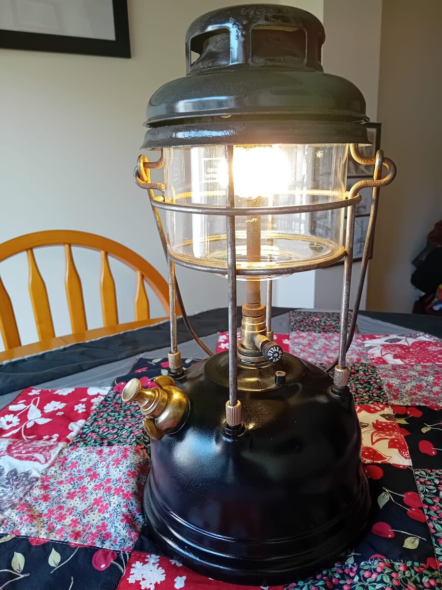

    Hi Guys.
    Just displaying my latest addition. Got this in a car boot sale and decided " IT SHALL NOT PASS "
    ( if you know, you know ).

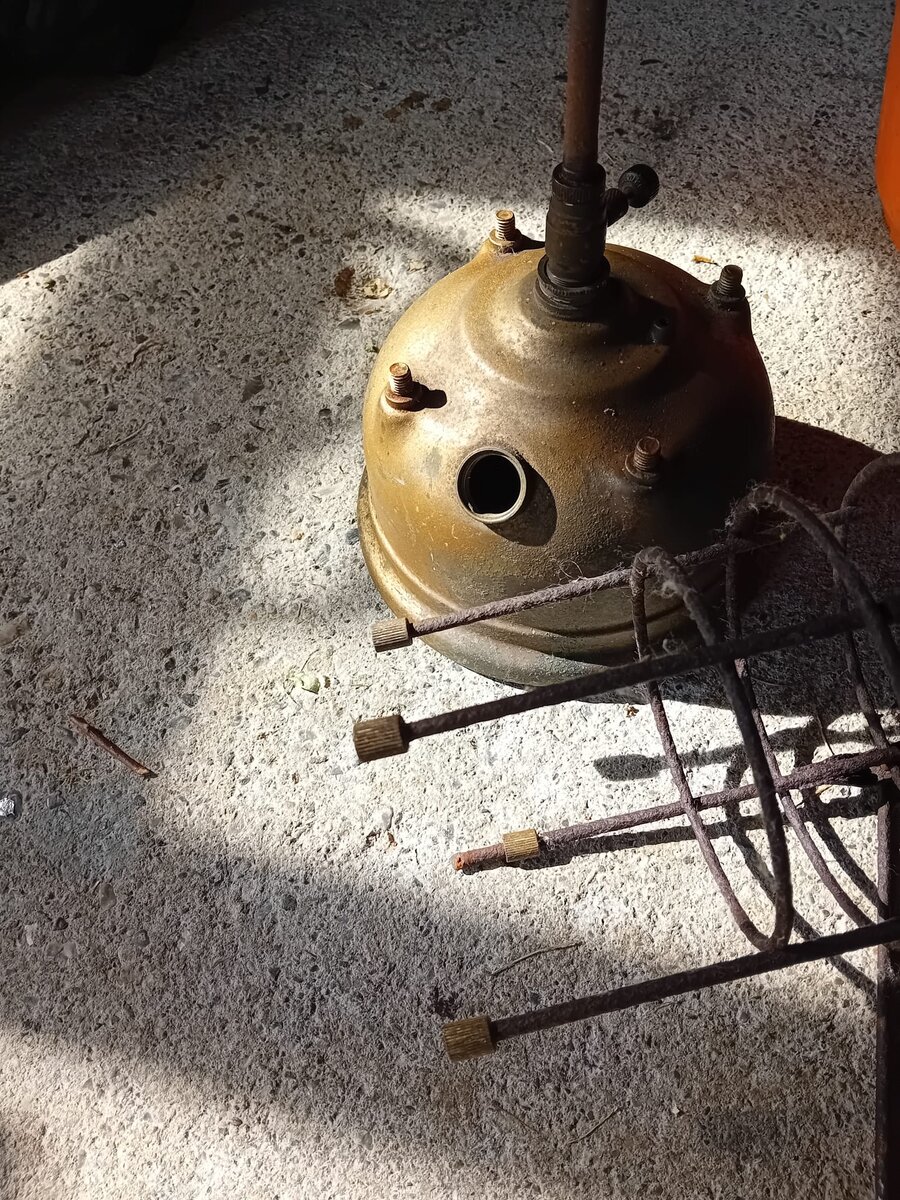

    To this......
    Kinda liked the patina on the handle and decided not to paint it.
    Also black was the only paint in my Halfords paint larder.
    You can have it any colour you want, as long as its Black......Henry Ford :whistle:
    A bit unconventional but if it didn't work out it could be undone.
    Kinda liking the result though to be honest.

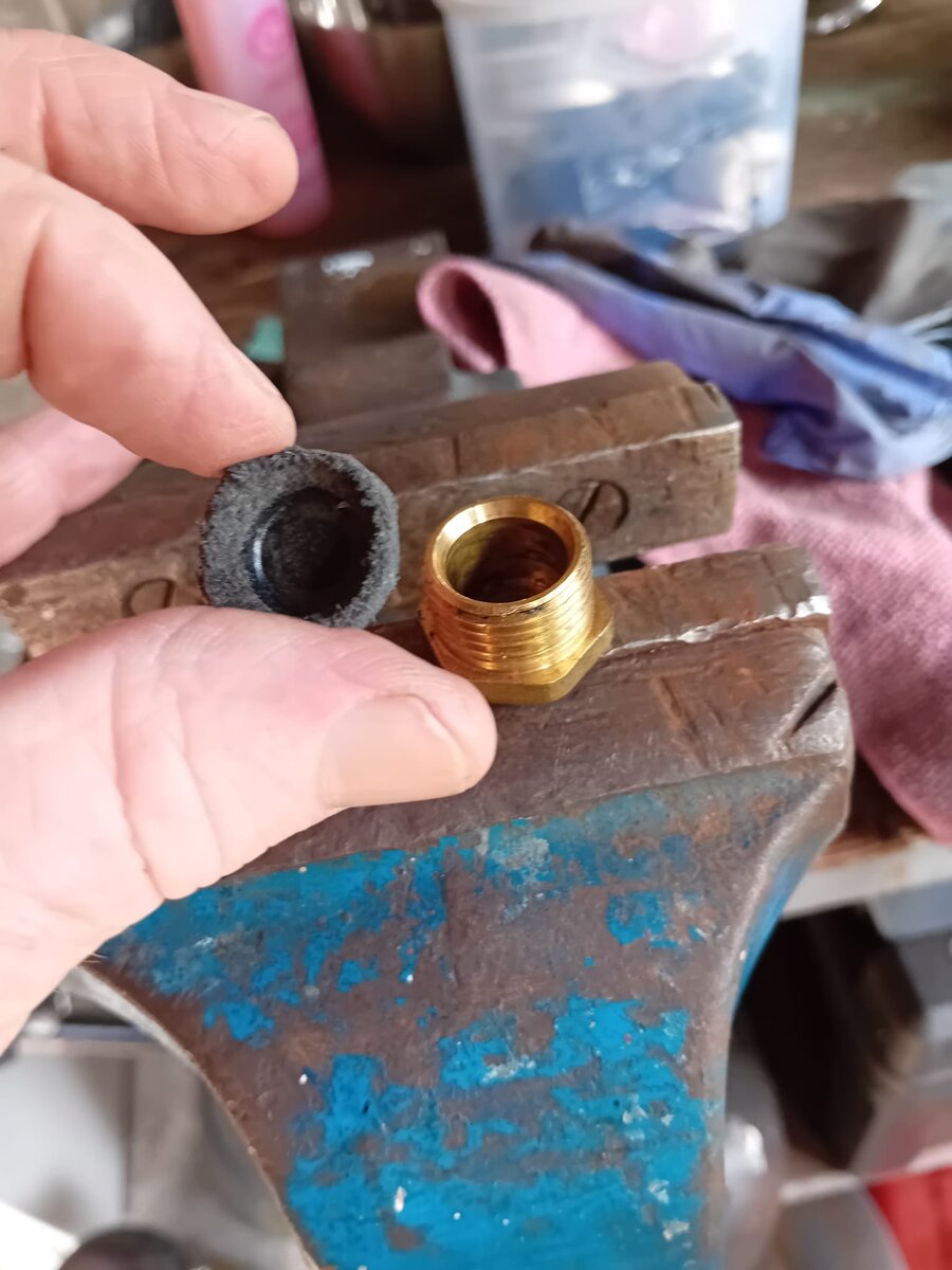

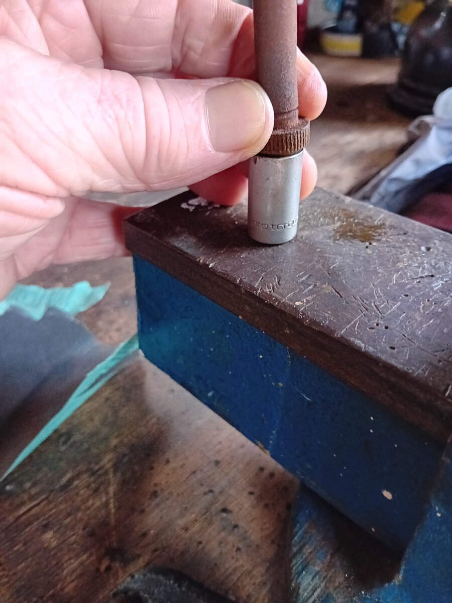

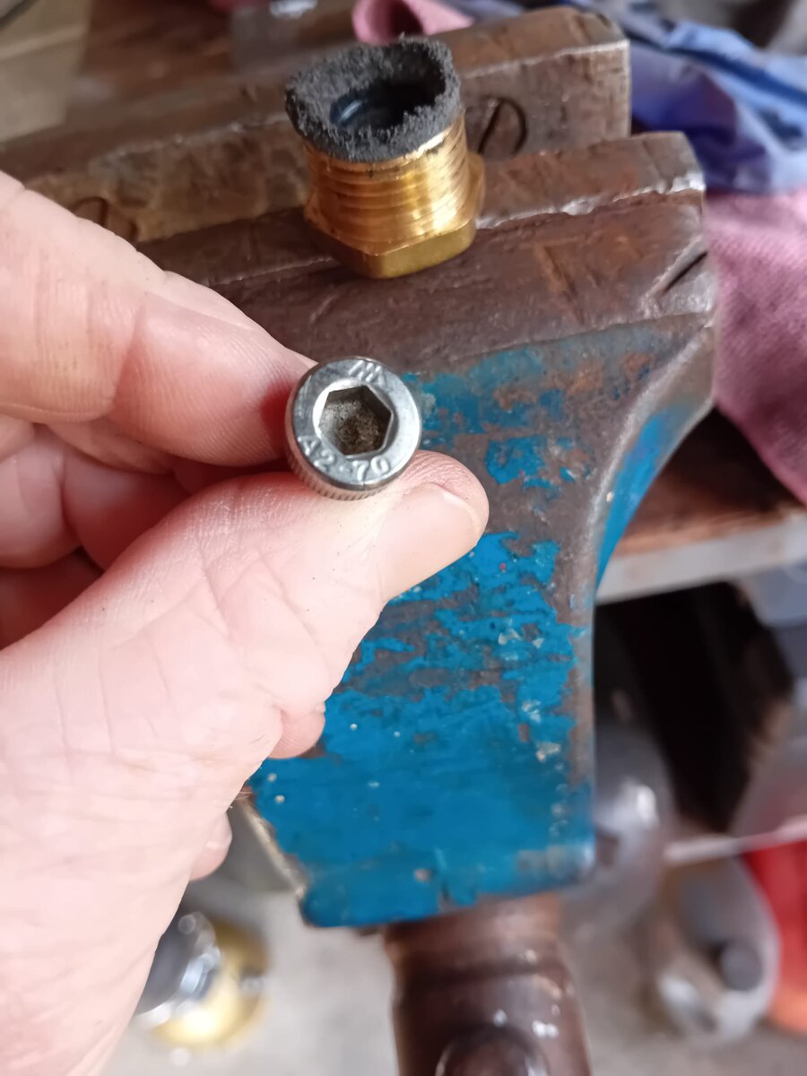

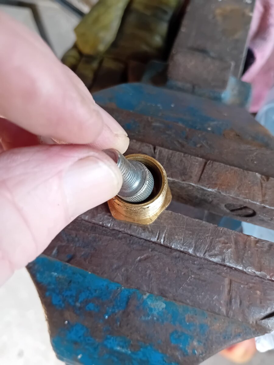

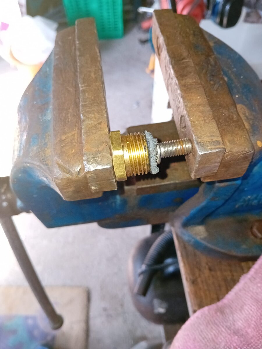

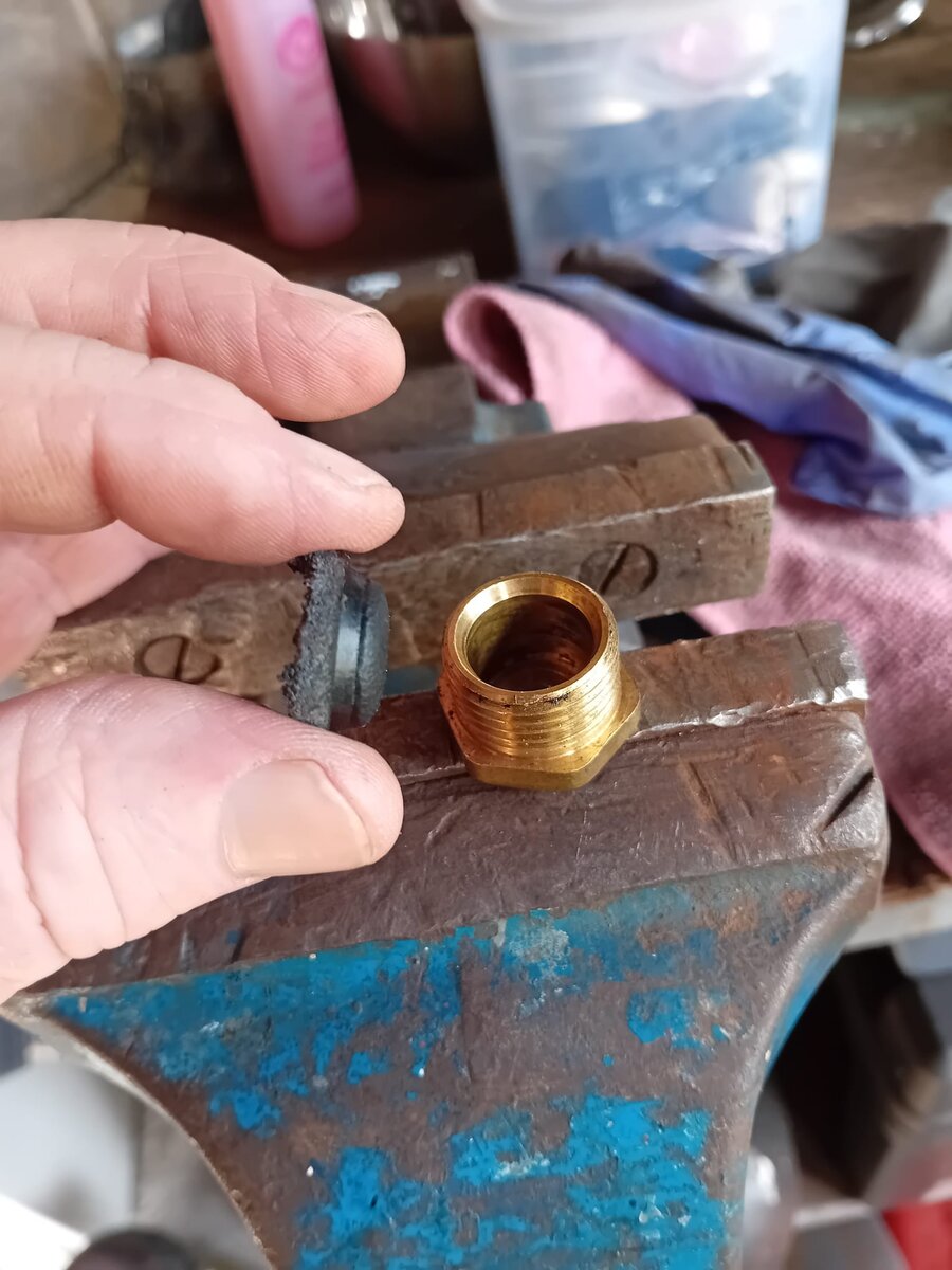

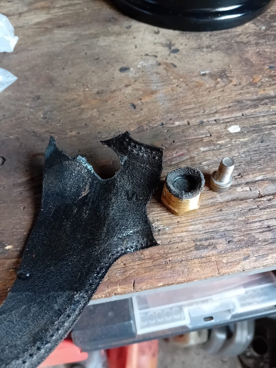

    Couldn't wait for pump cup leathers to arrive in the post, so I read up on DIY cup leathers on CPL and had a go myself.
    This is a half inch blank and an allen bolt....
    An old army issue boot worked a treat.

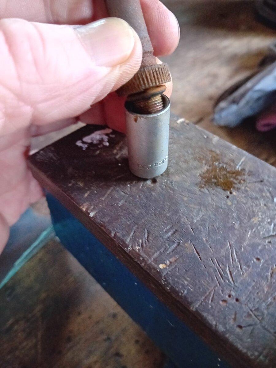

    Cleaned out the vape with usual heat and quench, using a socket to protect the threads on the vape and tapping hard on the vice....
    And so my collection grew a little......

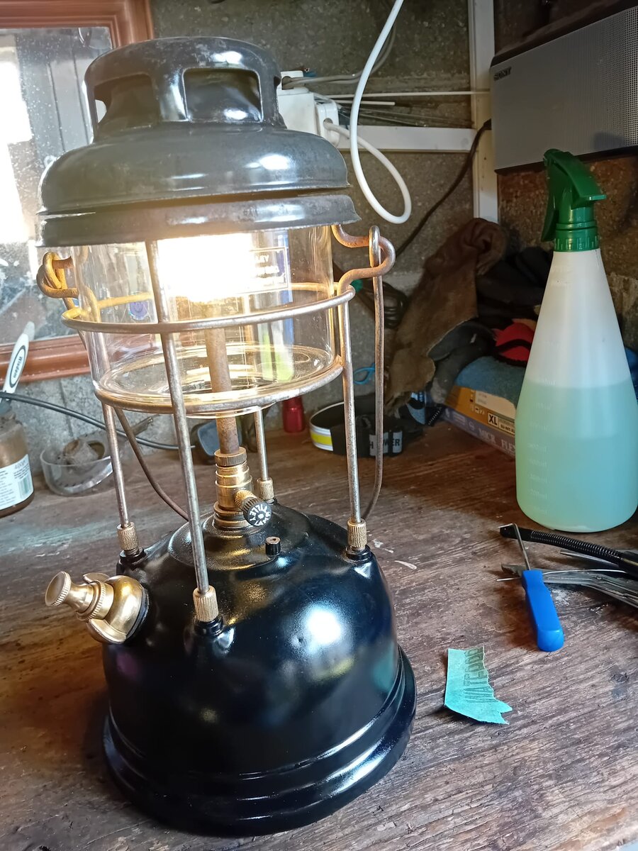

    Here it is in all its glory.

    Thanks Jeff, I m delighted with the result.
  4. ROBBO55
    4,439
    It's cleaned up nicely, congratulations :thumbup:

    Looks good, and the pump was a good find.
  7. JonD
    JonD Subscriber
    Apr 15, 2014
    1,012
    Hertfordshire, England
    Surely that is a new cage - or?
  8. Buggerlugs
    Looks fantastic mate, I also have a black X246, and love the colour. I also love the wingnut pump.

    @JonD 10 outta 10 for observation. I had two or three of these on the bench at the same time and had to do a bit of zooming in on the pics. I must have inadvertently switched cages.
    (Shhhh ! dont tell a soul. )
