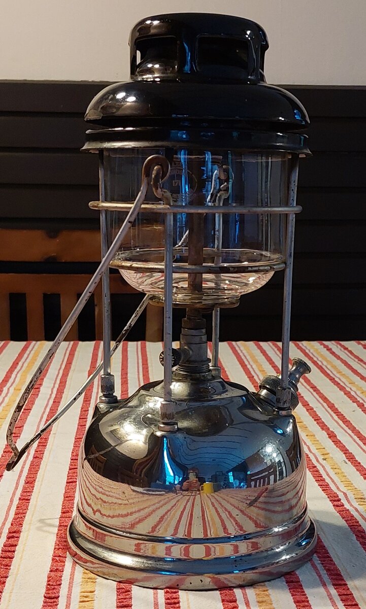

    Hi guys. I'm a new member here from New Zealand and i have just bought a X246 Tilley lamp, but unsure if it's a Guardsman or a Delux version. The base of the fuel tank is undated and there is no inscription on the sides of the tank either. The handle attachment lines up with what would be expected between 1950 and 1953 along with the undated tank. The finish on the tank appears to be nikel and is not flaking off. What are the chief differences between the Guardsman and the Delux versions?

    Hello Simon and welcome. Back in the day, it was standard practice to plate and add insect protection screens to export versions.

    Hi Henry. Thanks for your warm welcome and reply. My lamp does indeed have an insect protection screen fitted as you state. By plating, do you mean nickel plating for export models? I'm yet to get the lamp running and I'm more or less floundering at the moment. Where to buy mantles and other spare parts etc, that sort of thing. I'll take a pic of my lamp and post it here if that helps any?

    Consistent with what Henry said, by far the overwhelming majority of 1950s Tilley X246 lanterns exported to Australia (and I imagine NZ) were speculum-plated (not nickel or chrome). Therefore your lamp is both a De-Lux and a Guardsman.

    Hi Tony. Thanks for that. We'll go with the speculum-plated thought. 20231220_183059.jpg

    You have both the early style “deep” 171 glass and the first version of that style of hood.

    Thanks Tony. I'm quite excited about my Tilley even more so now. What production/model year would you say it was built in?

    You lamp is from somewhere between late 1949 to 1954.
