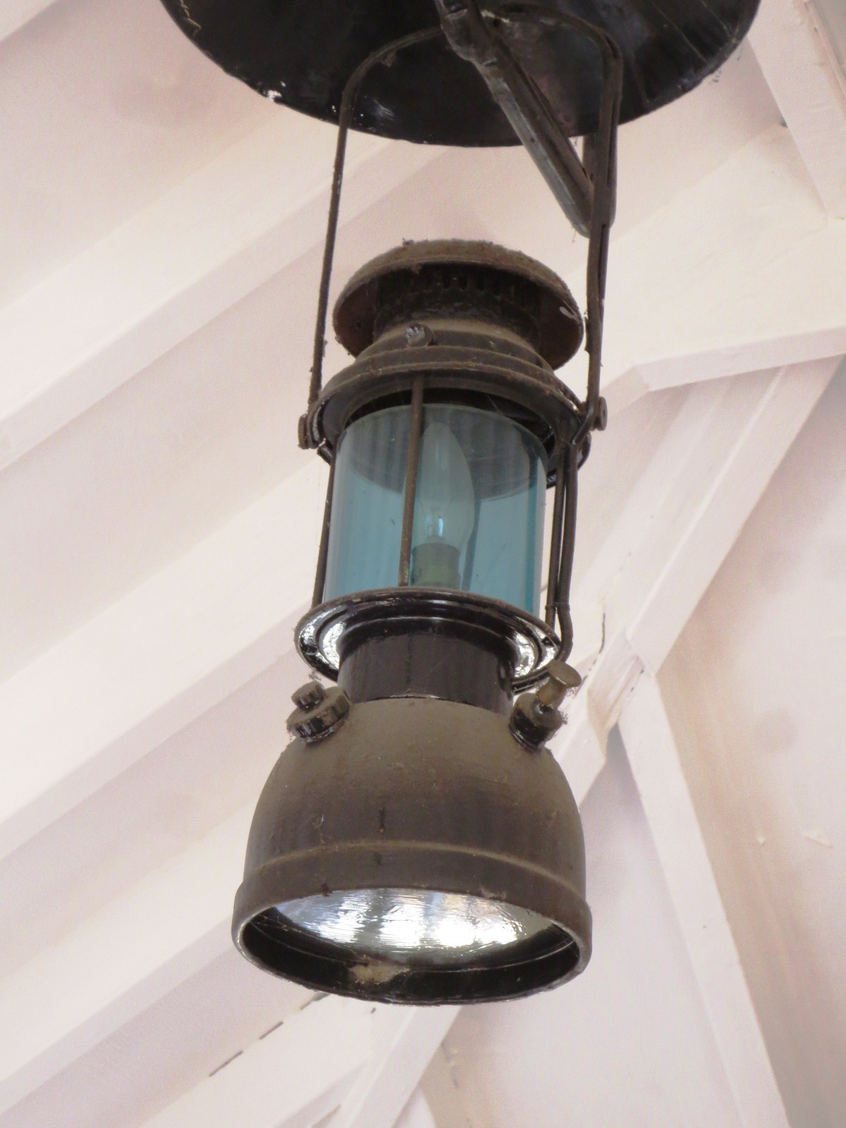

    Greetings, fellow enthusiasts, I wonder if any of you could shed any light (!) on the maker of this lamp?
    It is currently in use (converted to electricity) in the Winchcombe Signal Box on the Gloucestershire, Warwickshire Steam Railway.
    So far as I am aware it is one of an original pair, c.a 1905/6. The lamp connects to a cast iron flue, exhausting through the ridge tiles and protected by a pointed cover.
    Any suggestions, as usual, would be most welcome.

    I know there's a Tilley Ol50 on the platform at that station, but I'm not sure what lamps your talking about. Have you got pictures?

    Ok a quick Google and I've found the ones you mean. I think from what I can see they're bialaddin 300x's. The flue to take the fumes up out of the roof is a clever idea. I doubt those lamps would be the originals though as they would cast too much shadow being hung as high as they are. One of the hanging Tilley lamps would have been a more likely choice for the position of the lamp and the lighting required.

    Matthew, the period doesn't exclude a pressure lamp in any way.
    On the contrary. That was about the time when they came in wide use at railways all over the world.

    I agree. It's probably more likely that they used a couple of large wick lamps up there under those flues.
    Pressure lamps were perhaps more used in stations and platforms.

    Here's a closer view of one of the lamps in question. I haven't managed to get to examine them personally, as yet. It's still closed season on the railway until later this month, when access will be easier.
    However you can see the pressure pump and possibly a separate "cycle pump" connector?
    I am beginning to think that these lamps are not original to the building of the station. With that cowl and chimney, I think it more likely that it was originally gas lit, hence the need for the flue. So, it still begs the question: what make of pressure lamp is the replacement?
    After looking around, I am beginning to think Coleman.....
  15. David Shouksmith
    As Matt said, Bialaddin 300X, sadly electrocuted, and decades after your estimated date - Bialaddin didn't start until 1946. The 'cycle pump connector' you mention is the filler cap and pressure release...

    Albury area NSW AUstralia
    Bialaddin 300X from 1946+
