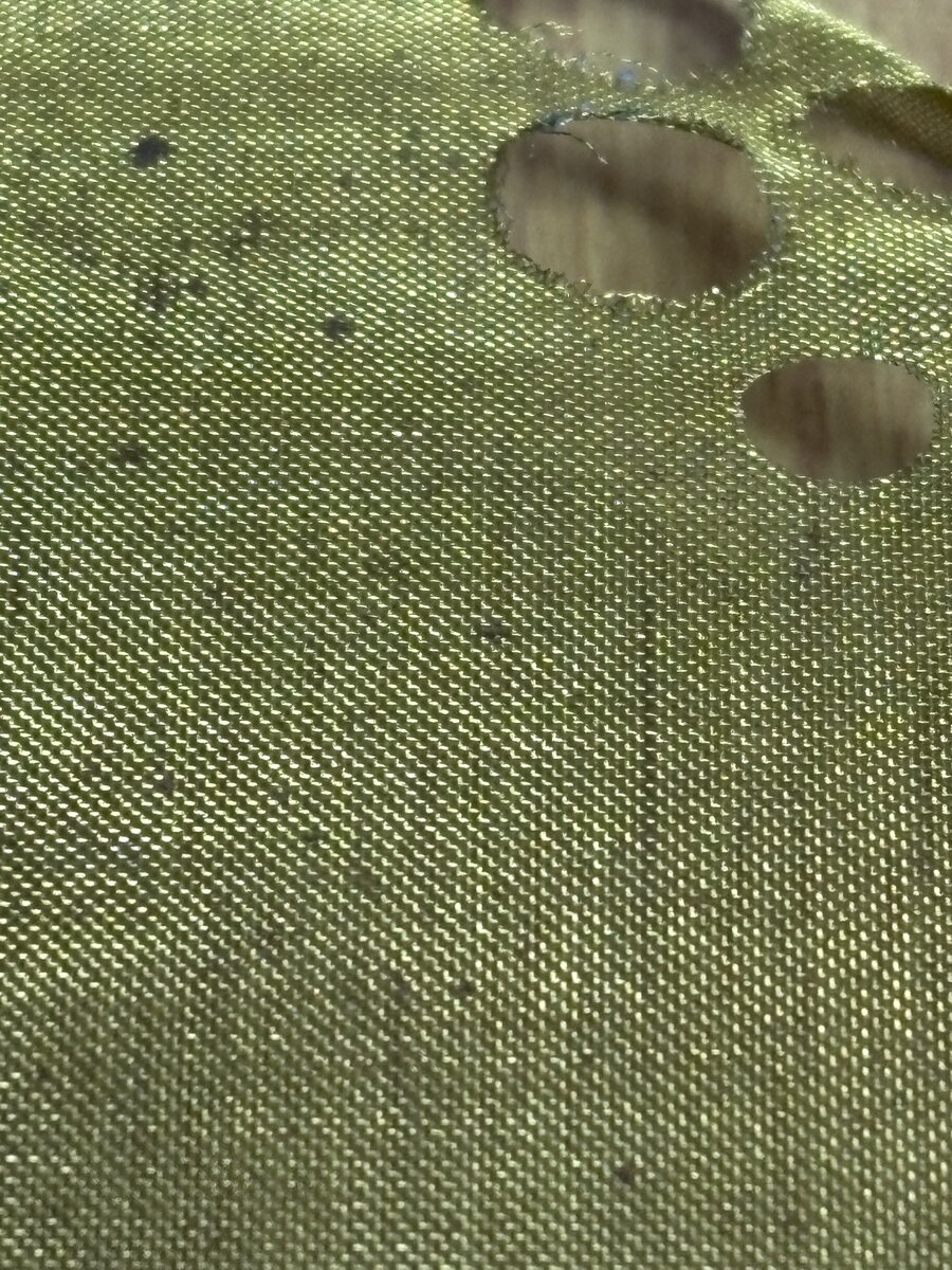

    Generator filter, brass mesh fine. You can make your own. Fine brass mesh you can get from eBay.

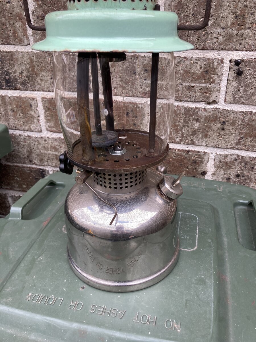

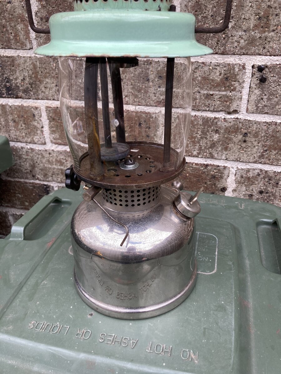

    Thanks, Darryl, for your prompt reply. You are correct, the pricker wire is broken off. Have contacted TW Sands who are going to come back to me when they are in the shop 2moro. Pictures of my lantern and original box are attached. Strangely this lantern does not have a product plate affixed to the perforated collar. Will keep you posted and might get you to help or make me a pricker. Certainly, the wire is skinny! Cheers again.

    Hi there, your kero pet is very very cool , the light green hood is original, they do come in the most common grey, but green, red, blue and black, your lamp is an early type 3.
    The air tubes with the smaller keeper rings.
    You may want to clean it up a bit, not everything needs to be super shiny. Your lantern has natural beauty. Wash with soapy water buff dry. Clean the globe. It will look very nice in the end. 300cp mantle. You will have the sun in a jar.

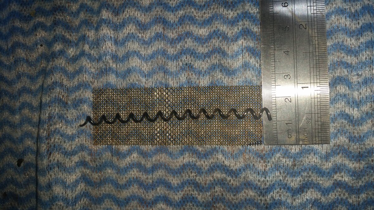

    Thanks Darryl. Despite the broken pricker I got the lantern running albeit it pulsed/flickered continuously. I put it down to the fact it doesn't have the curly spring restrictor. TW Sands are still searching for parts & hopefully come back to me soon. If I can't get a curly spring restrictor, would wrapping the pricker in brass mesh provide the same result? If so, what size mesh is appropriate, 0.5-0.2m hole/spacing? and how many wrappings would suffice?

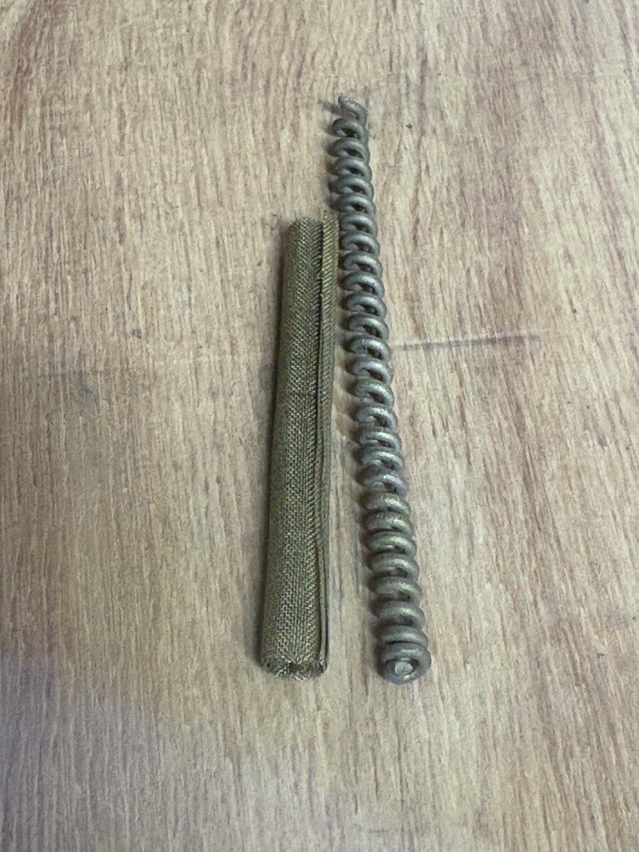

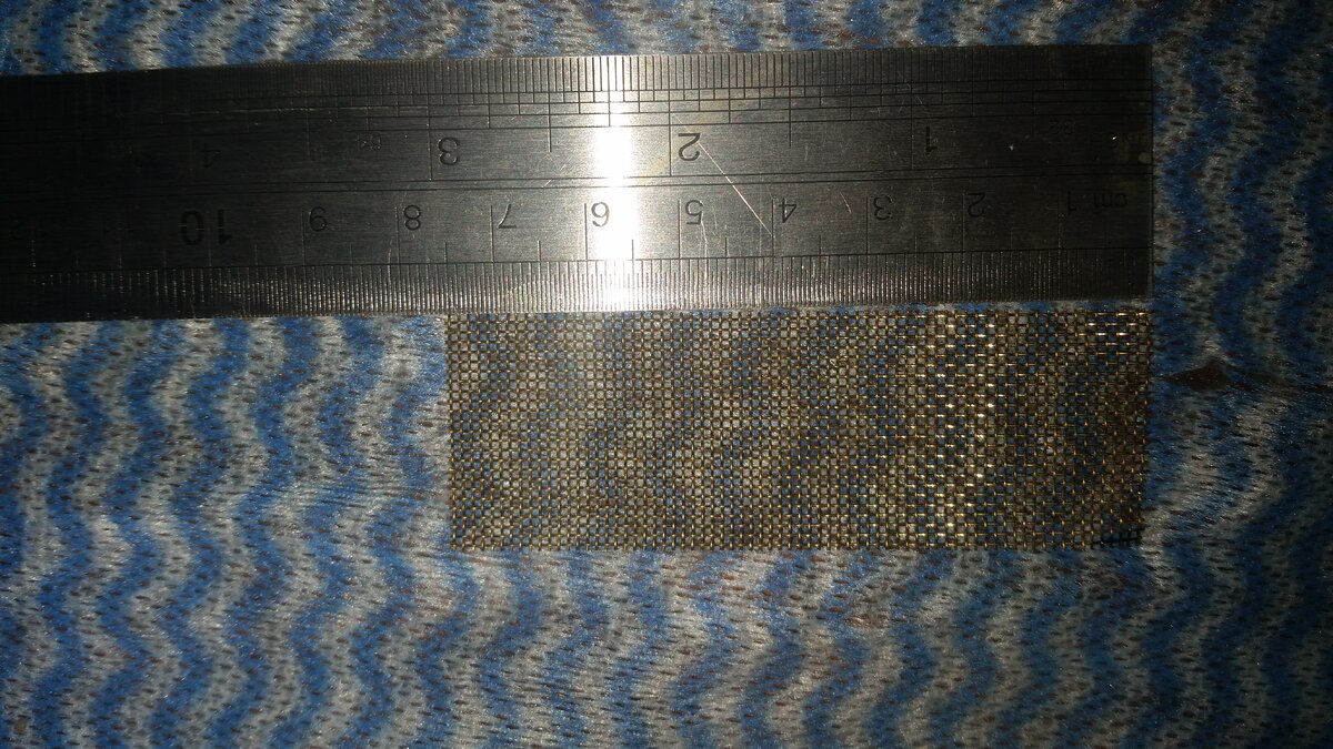

    @Konrad . This is the mesh I use it’s fine mesh, easy to roll, make it at least 3/4 of the generator. I have the curly restriction, it’s about giving fuel time to vaporise into a gas. IMG_1721.jpeg IMG_1722.jpeg

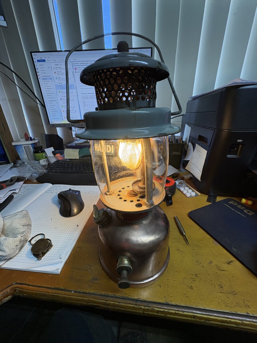

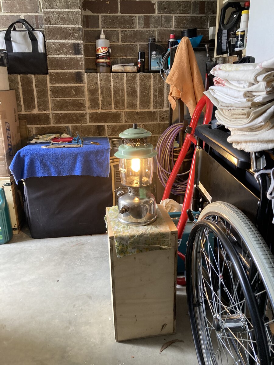

    IMG_0920[1].JPG Darryl & Robbo,
    Cheers for all your advice. Have pulled the generator apart, made a new pricker etc including cleaning and straightening the tube holding the jet. The result, see for yourself.
  11. ROBBO55
    4,432
    Congratulations Konrad :thumbup:
  12. podbros
    4,104
    That’s looking good :thumbup:
  13. Darryl Durdin
    1,651
    Excellent results, the sun in a jar.
    Well done.
