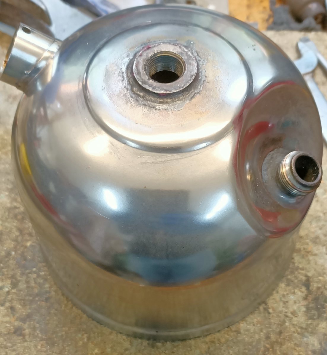

    He used it on motorbike exhaust pipes to remove the blueish yellowy heat Mark's and also to get rid of flash rust and it did such a good job I thought I'd get some to try on lanterns.
    I tried it on a discoloured chrome Anchor hood that had suffered a major flare up and it worked pretty good... not perfect but much better than it was. I also tried it on a brass Tilley PL53 fount...
    It worked very well and you can probably see it had an instant effect on contact. I used an old toothbrush to gently scrub the surface, that's all. It has a small percentage of hydrochloric acid which is why it works I guess.
    I will definitely be using it in future but I'll be careful and wash the piece well afterwards.

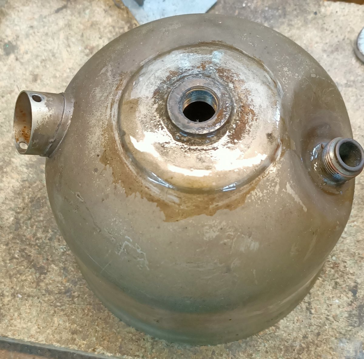

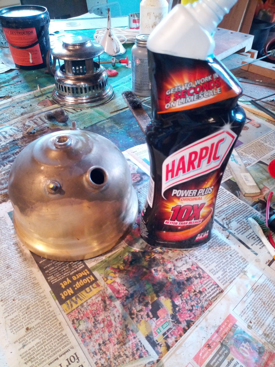

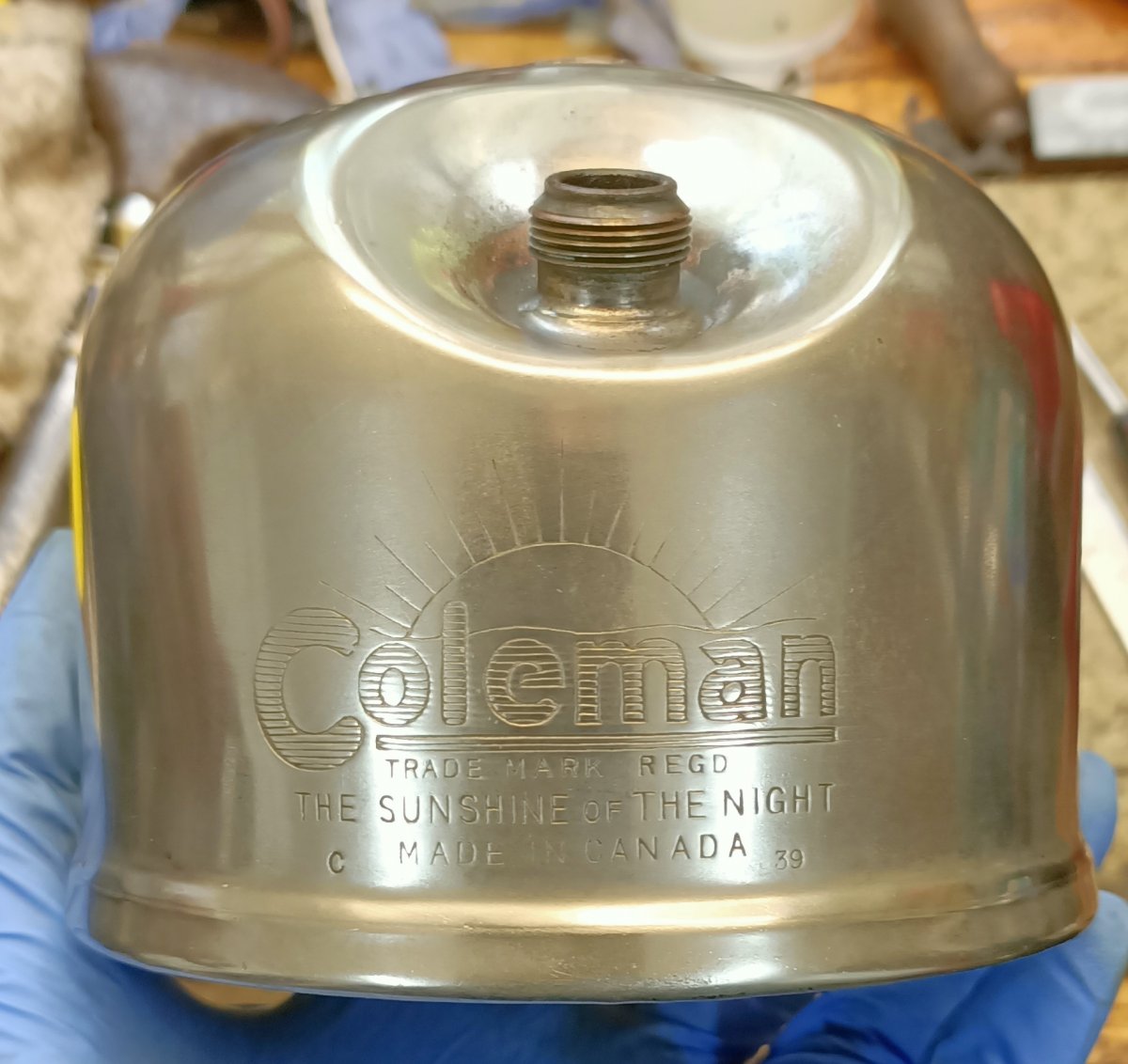

    I got some of this in the other week and thought it was time to try it out. The original stuff was out of stock, but I got the citrus stuff instead.:lol: Seems to get the crude off then a bit of autosol brings it up a treat. This project will go in the gallery when it's finished. Thanks for the heads up @ColinG :thumbup: IMG_20200517_142335.jpg IMG_20200517_142325.jpg IMG_20200517_142353.jpg IMG_20200517_142345.jpg
  12. ColinG United Kingdom
    4,808
    That worked extremely well - wow!

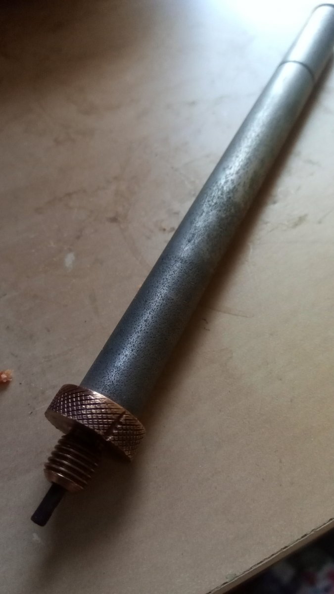

    I have used it now on a late tilley fount and a primus blowtorch, incredible stuff, just watch out on other metals as it will corrode.
    I used it on a vap tube that was rusted solid, it was bad!.........
    and this was the result of 24 hours soak and a light scouring under hot water..Fantastic stuff!
    Thanks @ColinG
