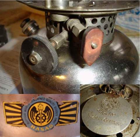

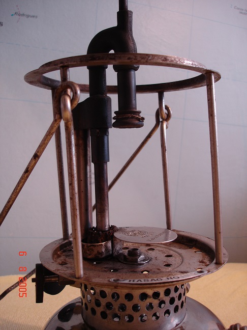

  1. pitu
    Mar 12, 2011
    66

  6. pitu
    Mar 12, 2011
    66
    Hasag 102 is much earlier than WW2. I'd guess is was produced from late 1920's till early 1930's. It reassembles Nulite products very much, but there are some differences in details (some parts are typical for Hasag, used later in most of their lanterns) so it must have been made in Germany. It could have been some kind of license or maybe just a good copy.
    There's a German patent made by Hasag, please look into this topic:
    1914-20 (about) Lux Sirius, Aktiebolaget Lux
    Neil once suggested that Hasag 102 could be a German made version of earlier Hasag 100 which was an imported Nulite 100 lantern. I think it may be a correct theory.
  7. Flygt
    Nov 8, 2012
    175
    Hi Piotr, do you have additional photos of the 102SP lantern details. Thank you, Ken

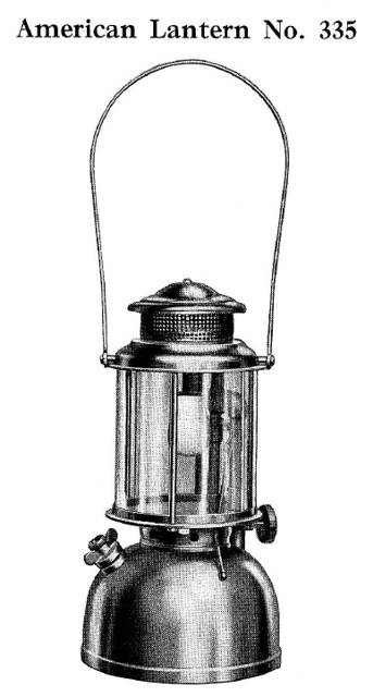

  10. Mackburner
    Hmmmm yes but that model 100 with a bayonet cage attachment is not a Nulite. That is an AGM lantern. At least the cage and hood are AGM for sure. No other company made parts like that. In fact that lantern looks like a slightly modified AGM 335 Dark Chaser. ::Neil::

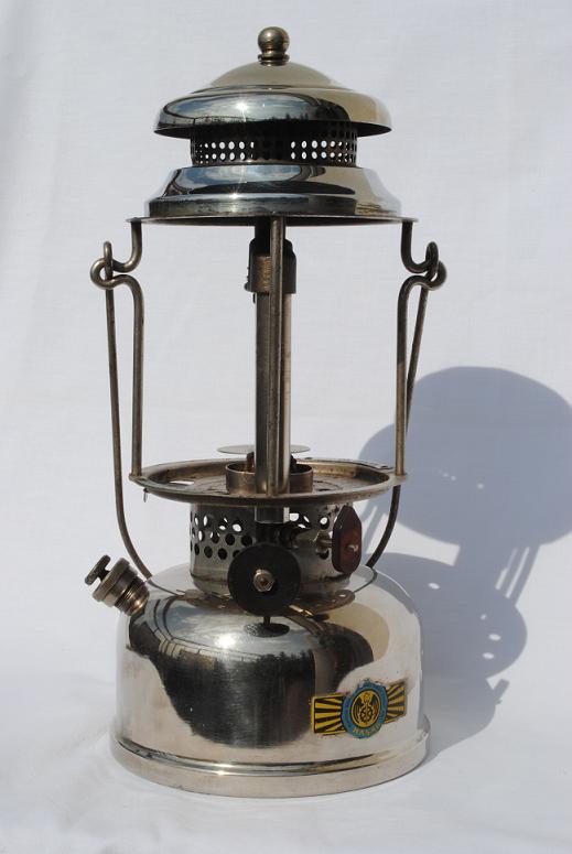

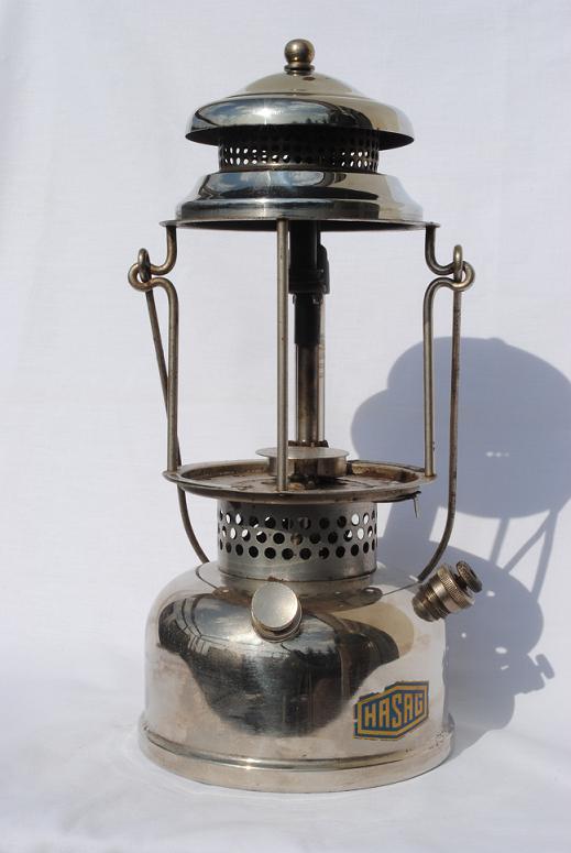

  11. pitu
    Mar 12, 2011
    66
