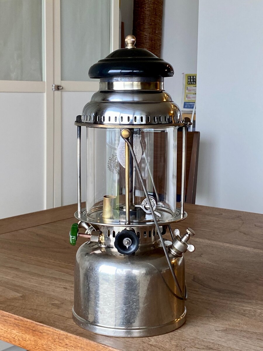

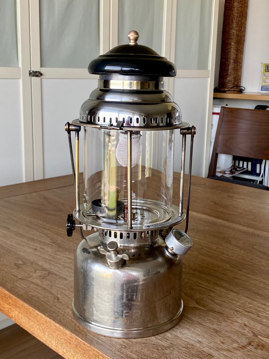

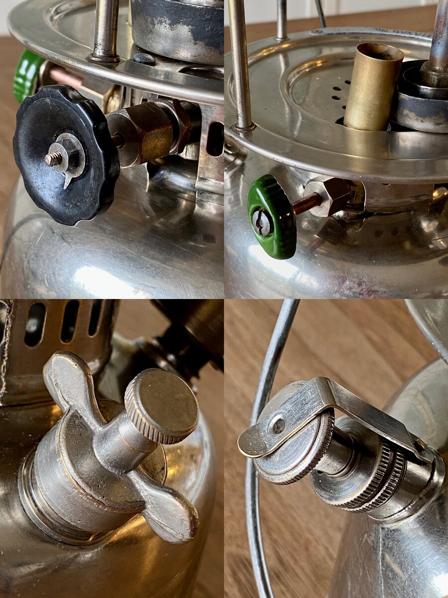

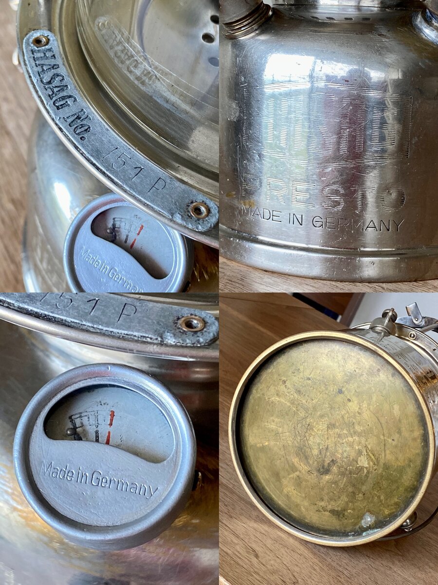

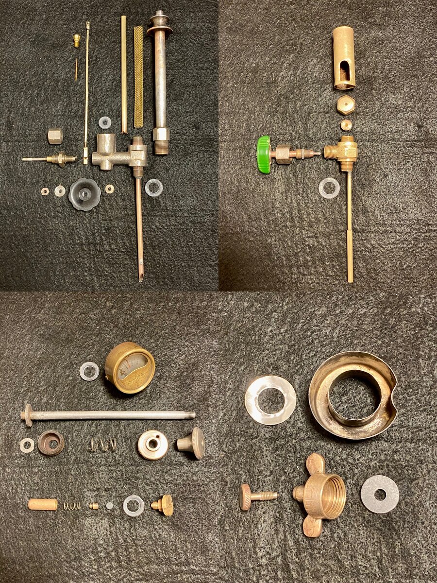

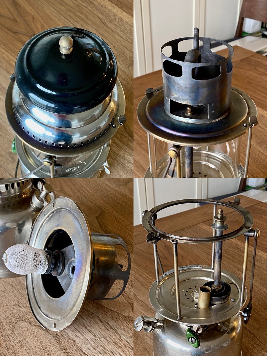

    This is a Hasag 151P PRESTO made by Hugo Schneider AG, Leipzig, Germany sometime in the late 1930s.
    It runs on kerosene and produces about 300cp.
    It was one of variants of the model 51 and was fitted with a preheat torch.
    I have not confirmed exact timing when Hugo Schneider AG introduced the preheat torch into their models.
    Judging from 151P was listed in ca.1938 catalogue and Erich & Graetz AG (Petromax) had acquired a patent of their preheat torch in the mid to late 1930s, it seems to be sometime in the late 1930s.
    Considering that World War II began in September 1939, it is a reasonable estimation that the PRESTO models of Hugo Schneider AG were only produced for a VERY short period of time.
    I suppose this is probably one of the reasons why the PRESTO models are difficult to find today.
