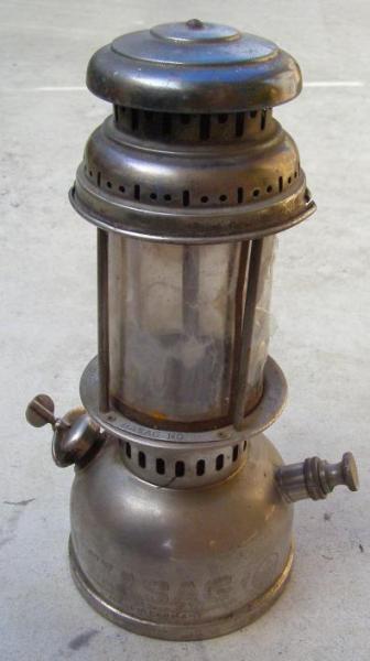

    Hello, the Hasag 34 shown below is missing its nipple jet. The replacement petromax 150cp nipple is too small. My other option it to fit a 150cp petromax generator. Before importing one, can anyone confirm if the petromax generator will fit it or will it be of a different diameter like the nipple?

    Can you make a photo?
    In my HASAG 34 is the same generator like in my
    Petromax 900.
    I can change the jets from HASAG to Px 900
    But your HASAG has the older logo

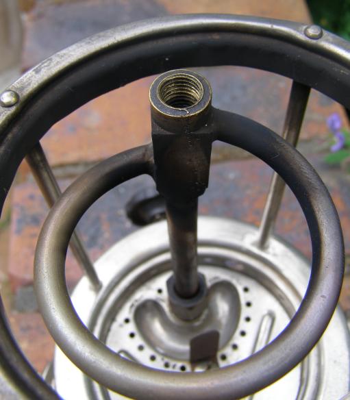

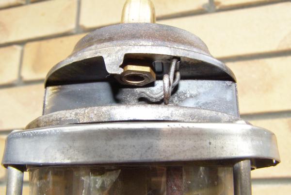

    The opening at the top of the generator for the nipple jet is about 7.5mm in diameter. Just above the jet, in the hood, you can see a small wire with an adjustment. Maybe this is for when using different fuels, not sure? Certainly would not be using anything else but kero if I was to get this one working.

    Did you test a Px jet, if her fits?

    Yes, a Px 150CP jet is too small.
