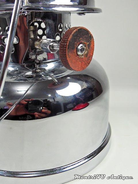

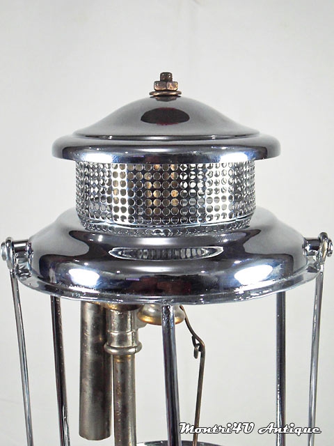

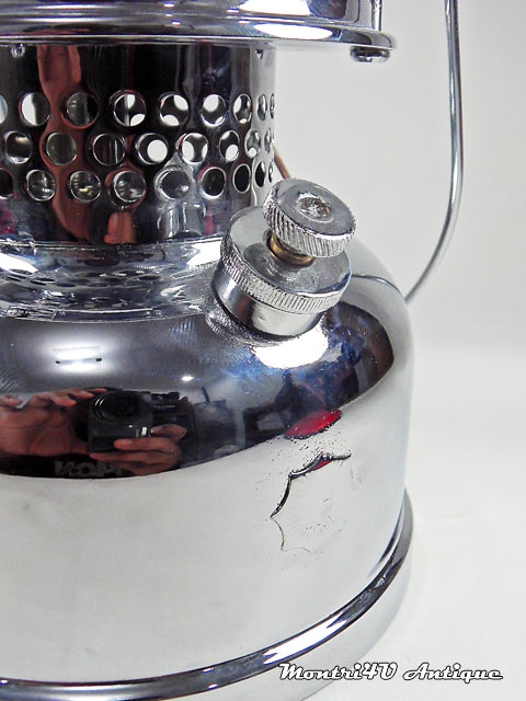

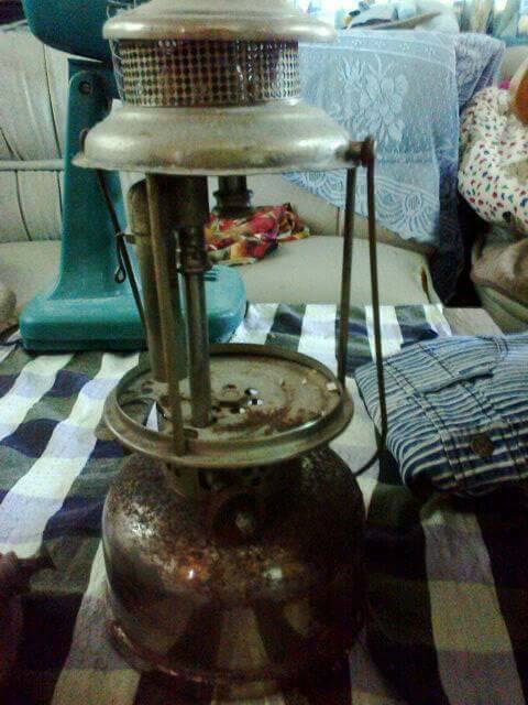

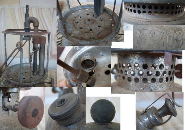

    My friend is find it. I don't know this lamp. It's original or not.
    Please see it.
    1439218552-HASAG-AGMNo100_2_.jpg 1439218577-HASAG-AGMNo100_3_.jpg 1439218592-HASAG-AGMNo100_5_.jpg 1439218610-HASAG-AGMNo100_6_.jpg 1439218636-HASAG-AGMNo100_7_.jpg
  2. Birdboy
    Dec 19, 2014
    34
    Thailand
  3. Mackburner
    Looks about right to me although there are some differences to the illustration I have. These lamps are a bit of a mystery because they are a direct copy of the Nulite Model 100 Storm King lanterns made in Chicago USA. They are so much alike that we did think they were maybe not made in Germany but re badged US product. Certainly the design is from around 1917-1918 and we know that Nulite exported a great deal of their lamps after WW1 to both Europe and the Far East. However I think these HASAG 100s were probably German made under license. I have only ever seen this one page of info for HASAG 100 and it appears to be dated 1928 which is a bit late for the model which I would have expected to be dropped from the HASAG line by around 1925. ::Neil::
  4. CrazyCamperGreg
    CrazyCamperGreg Subscriber
    Aug 10, 2015
    74
    It looks like a Nulite tank, fuel cap, and collar but the top end looks like an AGM 335. I would like to know how the cage comes off and if the valve screws into the center of the tank or offset?
    Could still be US manufacturers and assembled there.

  6. CrazyCamperGreg
    Aug 10, 2015
    74
    The ones you show do look like Nulite products but the first one posted is definitely an AGM top half. The vent and the way the bale attach are spot on. I have found many AGM products in other countries so it is totally likely that this one showed up there. As we all know the 335 was known to have bad tanks so it is highly likely this one was put on a good tank that was around at a repair shop. I have more questions about why the whole thing is nickel plated and looks like it was restored yesterday. My vote is a put together lantern from parts.

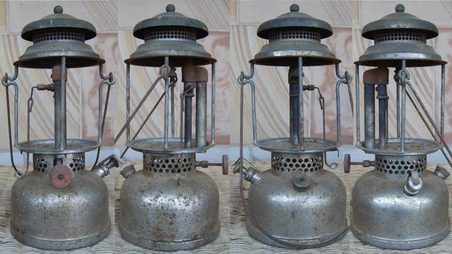

    I have picture before repair.

  10. WimVe
    3,524
    Well if you manufacture USA based lanterns and you want to conquer the world, a license with a German manufaturer would not be bad. Made in Germany was and still is a big advantage when it comes to selling stuff be it a lantern or something else.
    Personally I find the lantern displayed a very good example of a bad restoration. The new chrome doesn't match and reflect the age of the lantern.
    Besides the fact that the air intake pipe is way to short and should go through the hole in the cage base plate.

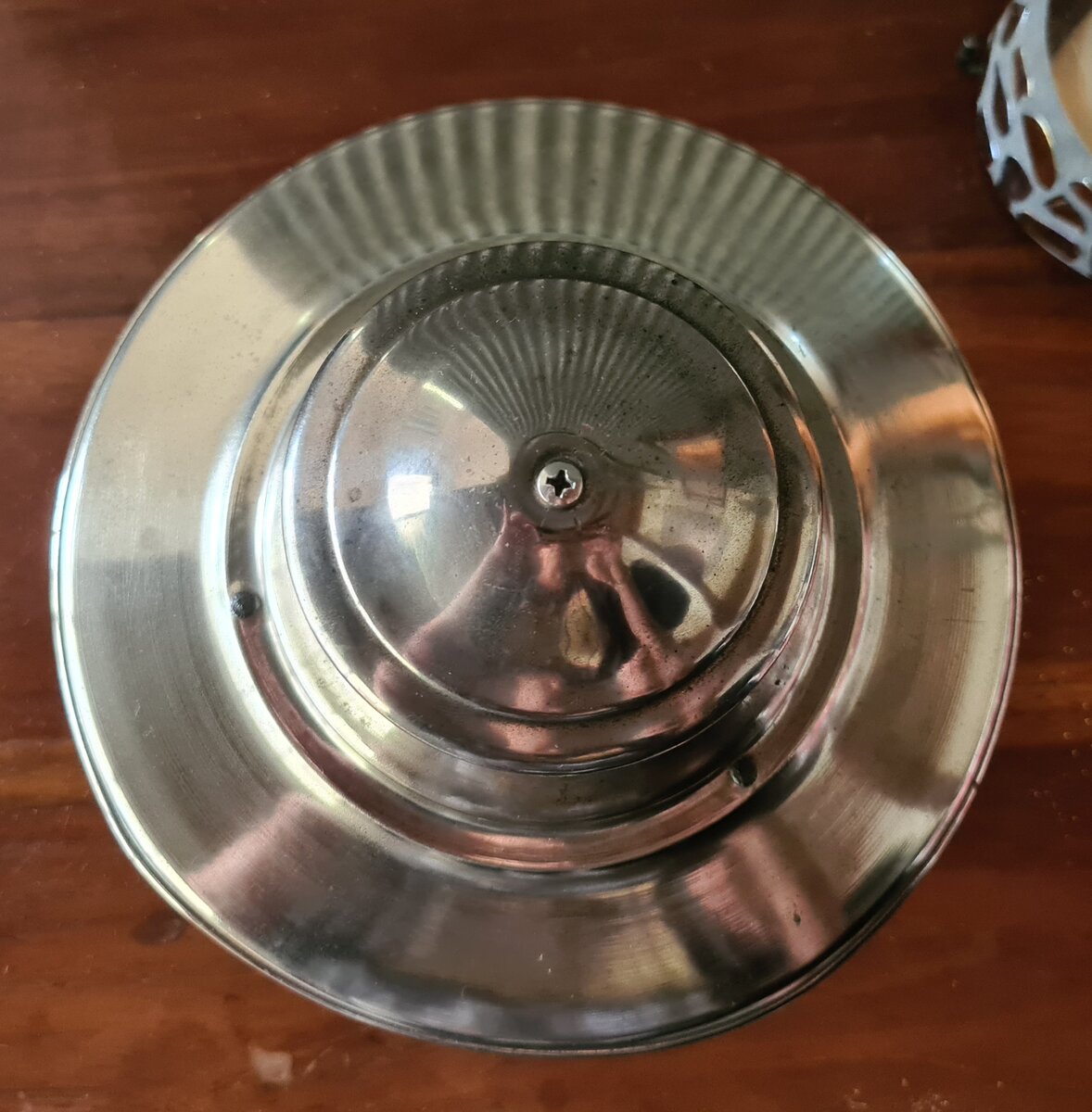

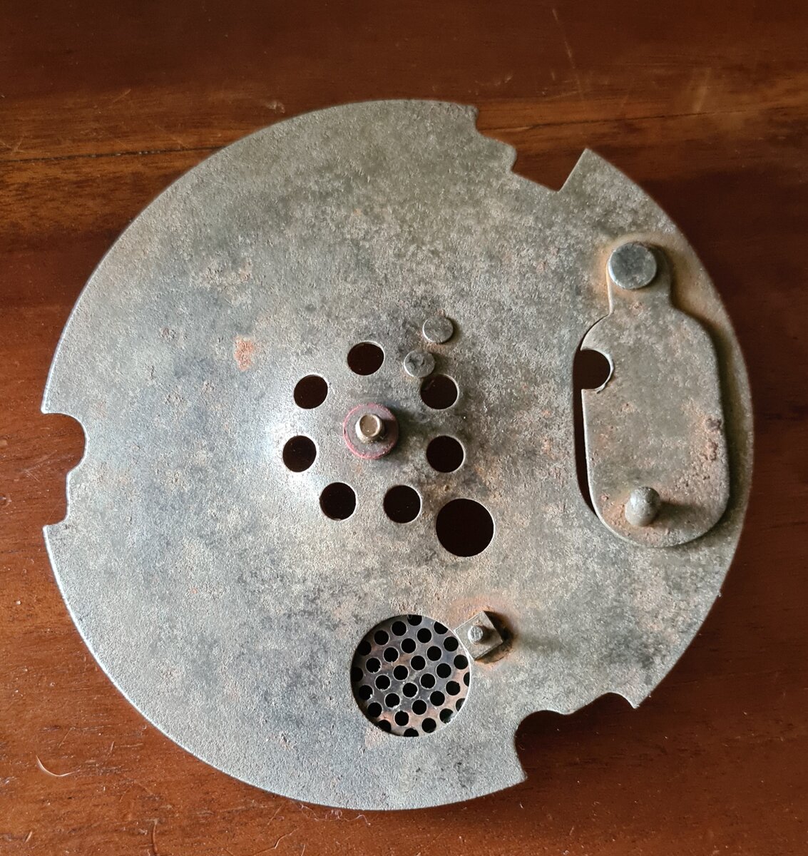

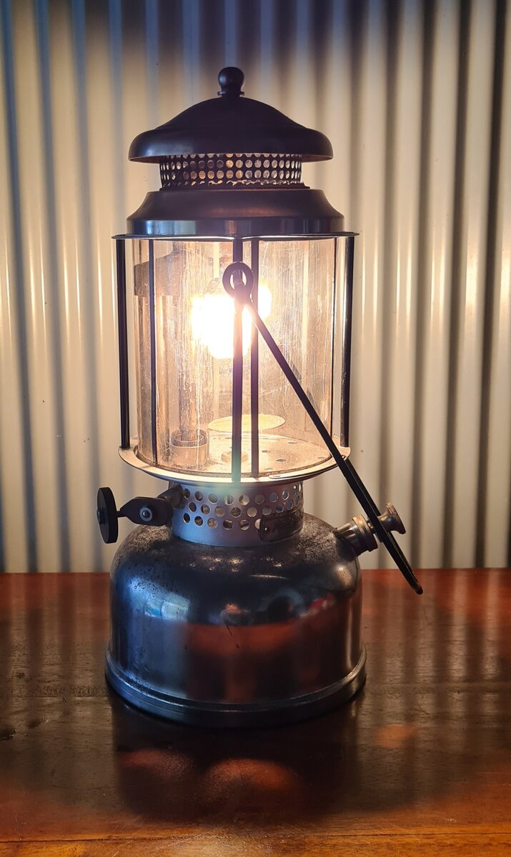

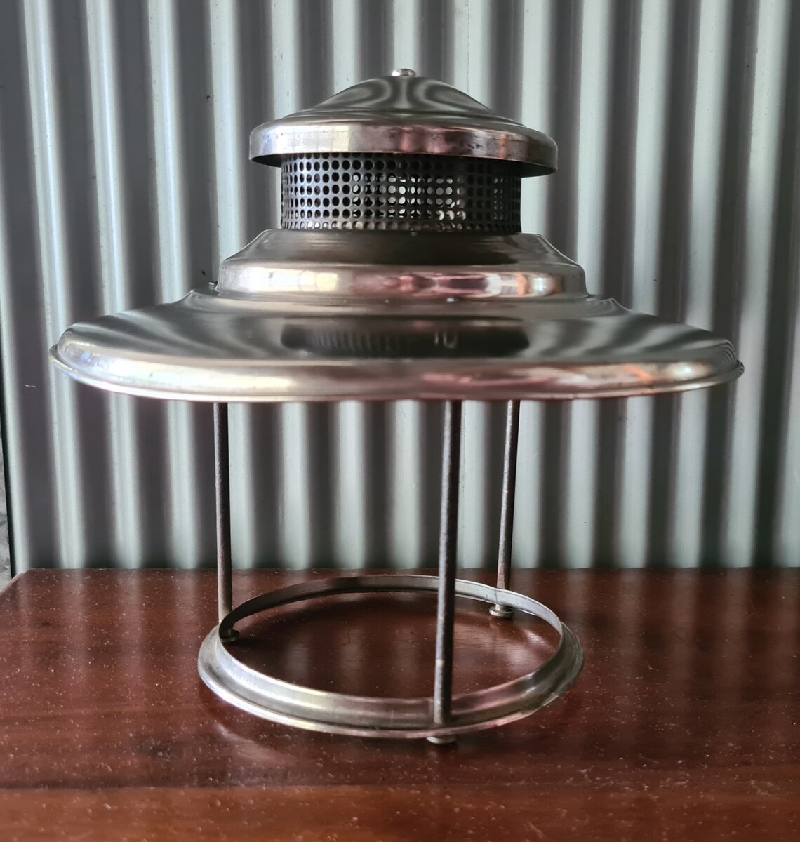

    This is the cage and hood from my AGM 721 hollow wire lantern head. It has the Strom King burner. You can see the locking points on the outer edge of the cage base plate. The three cage supports would lock onto the cage base plate by a twisting motion.
    On the overhead photo of the hood you can see a couple of the cage supports that terminate on the outside of the hood.
    20201108_094300.jpg 20201108_094245.jpg 20201109_112202.jpg 20201109_112216.jpg 20201109_113411.jpg

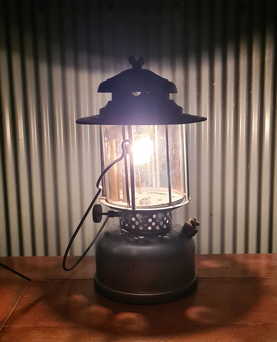

    Just for reference.
    I have been messing around with a Nulite Giant and the Molitor (Hasag 102) and lit them both. The Molitor is brighter than the Nulite Model 18. I would say the reason why is, the burner tube and cap on the Hasag is larger than the Nulite. They are not interchangeable. It was daylight when I lit the Molitor though it was a heavily overcast and rainy day so it was reasonably dull inside. 20201213_145038.jpg 20201210_193915.jpg
