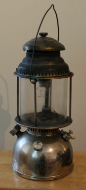

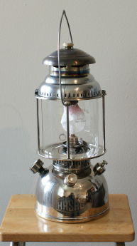

    Hello,
    This is my first pressure lamp.
    What Hasag model is this, and how old it is?
    Only markings on top nut 38/363/1002
    before and after pics:
    Tomi

    It looks like model 351.
    And these markings? S 38/363/1002
    S= Sonderklasse für sehr gute Qualität
    and numbers???
    perforated lid missing:

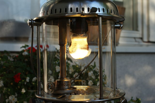

    Okay, what´s wrong?? New mantle, no leaks(1,5 atm)...but only bottom of the mantle glows!
  10. Cigarman
    Cigarman Subscriber
    Aug 23, 2014
    149
    Looks kind of like a tired out vaporizer. Maybe needs a new jet? I'd clean it out first and see.
  11. JEFF JOHNSON
    16,881
    I reckon that the vapouriser's jet is enlarged, Jeff.
  12. David Shouksmith
    BMD - Black mantle disease.
    :-k Is 1.5 atm sufficient for this type of lantern?
  13. Tomih
    Jul 23, 2015
    16
    dont know,but pressure gauges red line is 1,5 atm!
  14. WimVe
    3,543
    Yep 1,5 BAR would be a good pressure.
    But what are you burning ?
    Kesosene / gasoline ?
    Did you check the vaporizer ? Is the mesh inside still there and clean ?
  15. Tomih
    Jul 23, 2015
    16
    Kerosene. everything is cleaned...mesh? :-k
