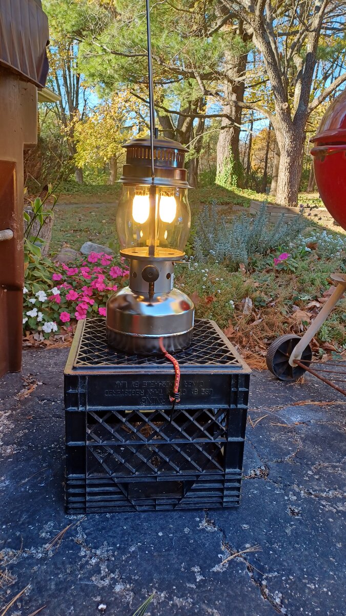

    I do have a HC firefly and mines works at full throttle at 60 psi, I’ve heard other pushing 80 psi but these lantern/lamps at 25 psi they aren’t very bright. IMG_9460.jpeg
    Here is mine (lamp head that I built using a recycled propane tank and runs on kerosene) at 60 psi with a shade, without it you need sunglasses or welder’s hat

    @presscall cool :thumbup:
    @Pancholoco1911 that is cool :thumbup:

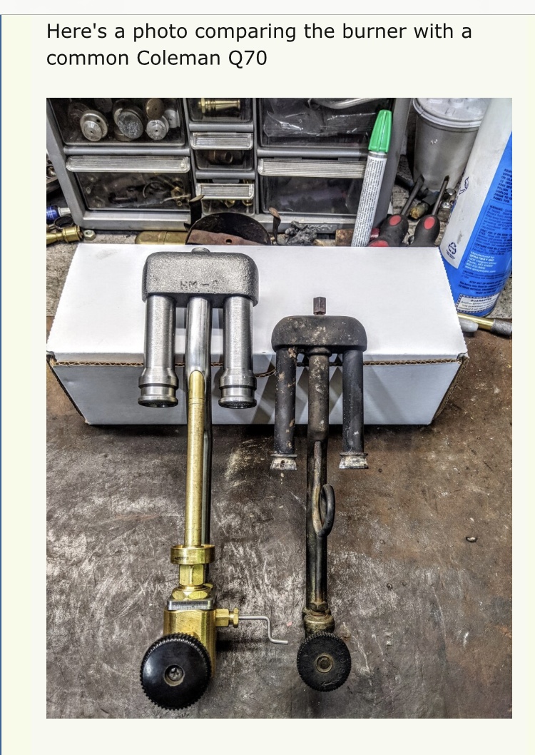

    @Thomas1
    here is a picture which shows the size of one of the HC burners,
    thanks to D. Durdin & T. Garner
    I just had a look at the website, very reasonable for handmade lantern parts imho

    That’s crazy bright pancholoco 1911
  8. Pancho
    Pancho Subscriber
    Nov 26, 2019
    506
    México
    Imagine if was without the shade ;)

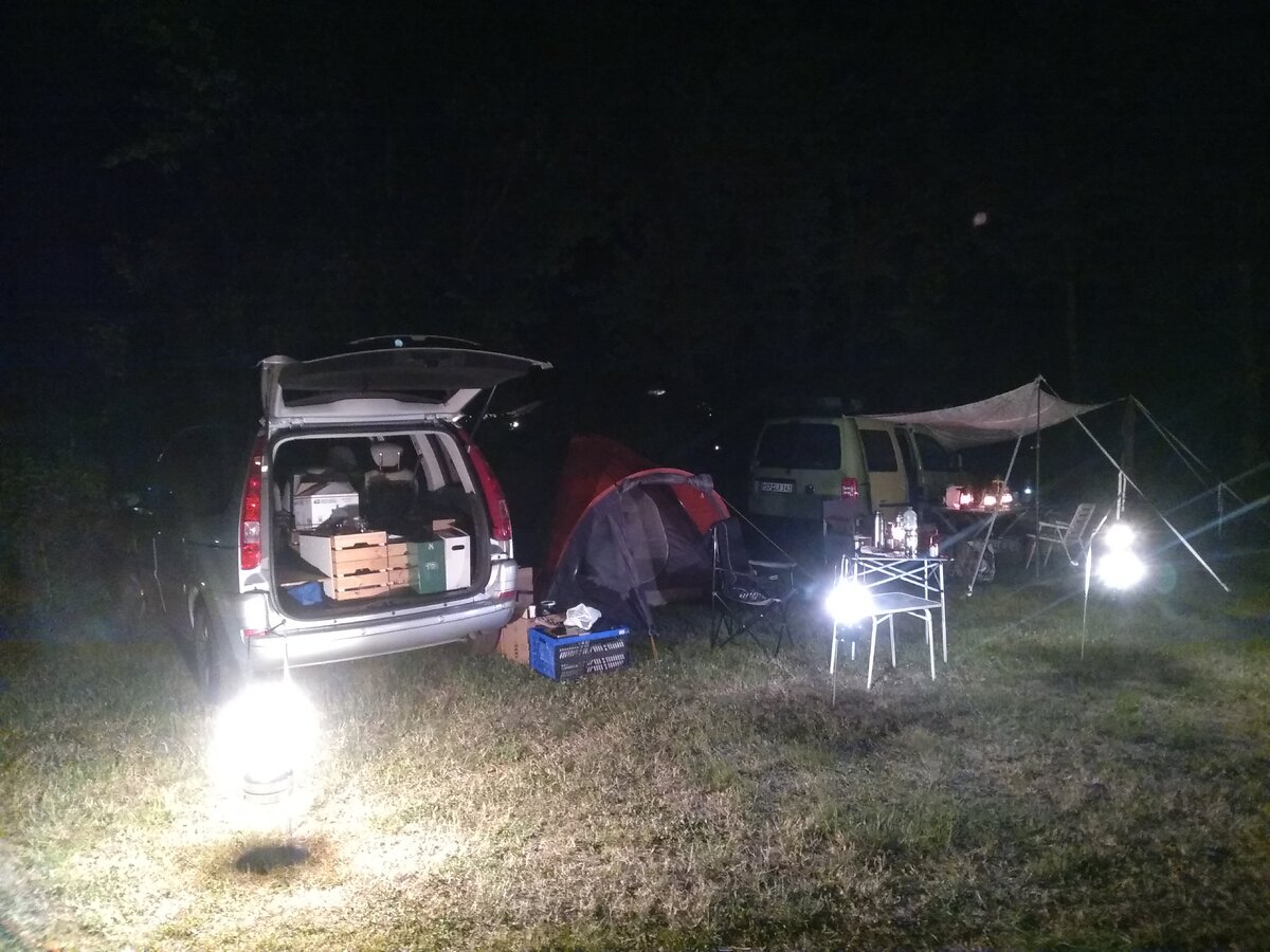

    @Thomas1 my HC lightning bug needs 5bar=70psi for full 1000cp, operating with petroleum/kerosene.
    Below 2,5bar=35psi it simply doesn't work at all.
    That's the reason, why I wasn't able to start it with the optional hand pump.
    Instead I use a bicycle pump.
    Maybe it would nicely work with lower pressure, when in use with Benzin/petrol. I didn't test, but have the optional vapourizer as spare part.
    Who doesn't believe, the HC throws 1000cp, look here. Lightning bug on the left.
