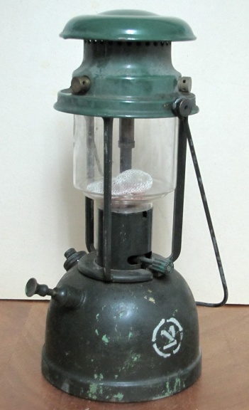

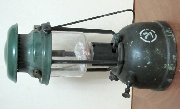

    Hi,
    Found this IDF military surplus bialaddin 310
    I would like to know the date of manufacture
    Thanks!
    16,876
    Hello Doran, according to the information which I received from Aladdin UK., this lantern's production run was from 1954 to 1959, both dates are inclusive. Jeff.

    funny thing this lantern is NOS, just painted and marked by the army and lost its original globe along the way.
    although the globe is an original bialadding globe - it was a nice find for my bialaddin 320 :)
