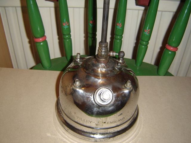

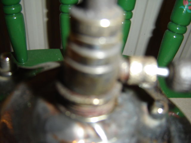

    hi folks new to the forum and need your advise please.
    i have this old lamp from my late father.
    it was covered in muck and oil.
    clean the tank a bit . the valve thing does not seem to fit right and will not go right in the tank.
    also what age could it be please.
    thanks ;)

    The 'valve thing' consists of two parts:
    1. The outer locating 'bush', which you can see in the photo above; and
    2. The control cock which fits inside the locating ring.
    So, first unscrew them from the tank. After you've changed all the washers and pips, screw the control cock back into the locating bush most of the way in and then put the washer on the bottom of it. Then screw the locating ring 3/4 of the way into tank.
    You can then use the locating bush to help position the control cock in the place you want. Make sure you have a good seal with the tank.
    It might seem a fiddle at first, but once done it is easy - and means you can, for example, have 'left handed' and 'right handed' set-ups for Tilleys.

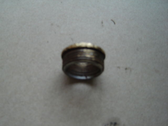

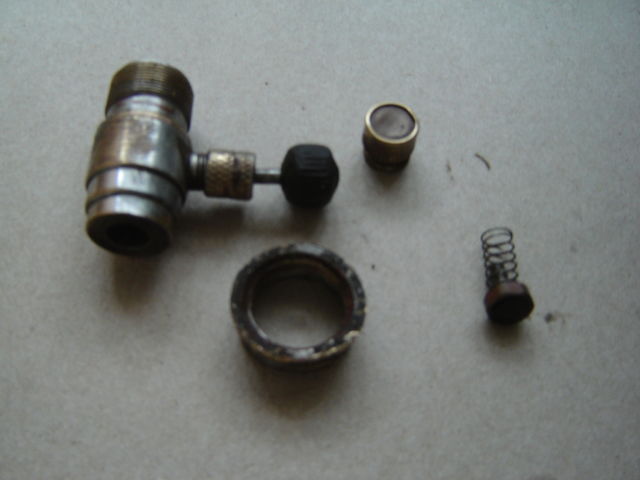

    well got some of it apart..
    the control cock will not come out?
    can undo the outer part of it but not the threaded bit!!!
    the ring that goes into the tank had some kind of loctite on it.
    do i need to get the control cock out? or would it be ok to use as it is?
    thanks for your advise ;)

    You have unscrewed the locating bush from the control cock. Now you need to turn the control cock knob anti-clockwise and unscrew it.
    That will allow you to turn the gland off the spindle and replace the gland washer if you wish.
    The spindle cannot be removed.

    the locating bush is u/s
    it had been cross threaded :shock:

  13. Gneiss
    Gneiss Subscriber
    Oct 7, 2012
    1,590
    When you do get a new collar you may find this post helps with putting it all back together...
    http://0flo.com/index.php?posts/41446
    I'm afraid I'm short of these myself as they are sometimes screwed in too tight to remove without damaging them. The collar should never be screwed all the way down, but it's an all too common mistake.. When fitted correctly you should sit proud of the tank as in the picture in the link.

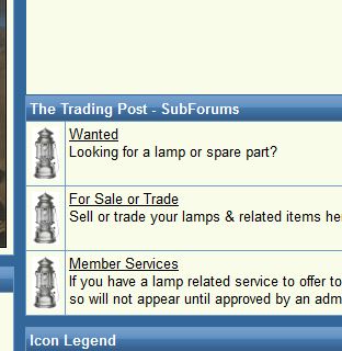

    N.E. England
    In the Trading Post there is no 'new topic' button. You need to go into the section you need - ie For sale or Wanted - then it is in top left.
    2 options depending if you're in forum view or post view.
