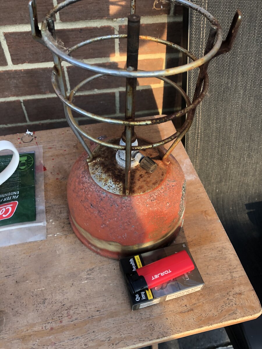

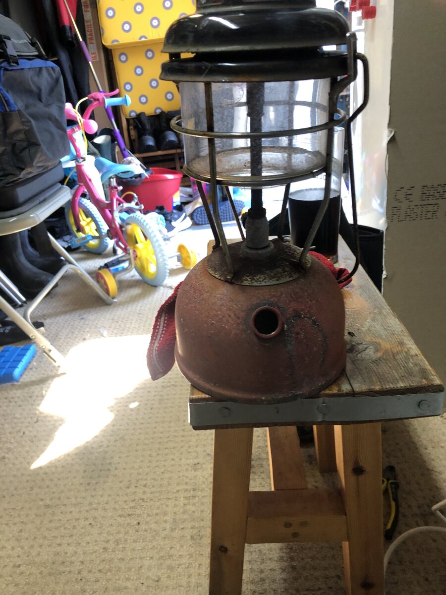

    Could anyone please assist me with the identification of a recent gift that will be a project and what kit I would need to restore it please,TIA tempImageA63Wfm.jpg tempImageAn5fPx.jpg
  2. ROBBO55
    4,445
    Welcome to CPL @tony Burridger
    You have a Tilley 246B lantern.
    On the bottom should be a stamp with a series of numbers and letters ie 1067XA . This is the manufacture date mm/ yy.
    What is yours stamped.
    No pump shown in the photo, do you have it?

    Thank you so much for your time in identifying my lantern. The only number I can see is on the bottom of the fuel tank which is 275. There is another number that I have found which is (I can't remember where cos it is in the garage) which is 214AO4BC. Could this possibly be it?
  4. AussiePete
    Hi Tony
    I was thinking that the number 275 could indicate that the lantern was built February 1975, (2=Feb, 75=1975).
    As to the other number letter combination, I can’t help you.

    Thanks a million Jean for your kind offer, I do have it just on with cleaning it. If I cold be so bold, where do I buy a COMPLETE SERVICE KIT, renewing all washers and stuff along with a new plastic knob to turn the thing on?
  8. JEFF JOHNSON
    16,912
  9. Hanzo
    Feb 2, 2016
    574
    Might want to check the tank/fount to see if there are any pin holes in it. You can add fuel or water to it j to see if its solid.
