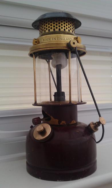

    I've finally got round to looking at my grandfather's lamp.
    It's a Vapalux 300X, which I've managed to light after some practice. The garage will never smell the same again....
    My question is, should I leave it as it is for the authentic look or polish up the brass and/or repaint purple?

    Ah, now you've gone and done it.
    There appear to be three schools of thought regarding lamps:
    1. Do nothing except blow the dust off and change the seals and washers - it keeps it's character.
    2. Restore the lamp to the condition it was in when it left the factory (or in the case of later Tilley lamps, in a better condition than when it left the factory).
    3. Renovate the lamp by stripping and polishing.
    Option 1 is a non-starter for me as my wife would insist that any such lamp would be an affront to her interior design skills and have to live in the shed. My shed is small, damp, held together by zip-ties and is at the top of the garden. Most old lamps that are in a sorry state have become that way through living in a shed like mine.
    Option 2 will involve spray painting the tank at some point. My only attempt at spray painting was my bicycle when I was aged about 14. The result was so horrible that my mates made me ride 25 yards behind them. Also, most lamps seem to shed paint like the skin off an onion. If the manufacturer, with a skilled workforce and a large factory, can't get the paint to stick, what chance have I got in my shed?
    Option 3 is the best for me. It requires only basic skills, little cost, and the wife will allow it to live in a small space behind a pot plant in the lounge.
    However, I would only polish fairly common lamps. I would not polish a rare lamp. I'm not sure how common your's is, but I am sure there are others on the forum that will know.

    Hello Nialls,
    That 300X looks to me to be in very good original condition. I would recommend that you keep it as it is. Just gently clean it, change the seals as neccessary, make sure that you only put clean, filtered fuel in it, and it will work for ever.
    Welcome - Steve.

    367
    Hi Nialls if your happy with the original paint,which to me is in great condition for its age,but i would give it a good service by changeing all the seals and giving the inside the tank a good flush out,if you decide to strip the lantern and repaint the tank, then it is best to use a etching primmer first as paint does not adhere to well to brass, if you dont use the etching primmer then you only need to run your finger nail over the paint and it will remove it.the etching primmer etchies in to the brass to form a good foundation for the top coats i found this out when i painted a live steam model of a tank engine i was building,the manufactures recomended i use a etching primmer but i thought a good clean and degrease and a good key will be enough,but i was wrong had to remove all the paint and start again.
    But looking at your lantern a full service as mentioned and i would polish the filler cap and pump and any other naked brass on the lantern and give the paint work on the tank a nice clean and a polish with some car polish and your lantern would look beautifull

    Thank you all for your replies, whic for a newbie have been very helpful. As I'm going to use the lamp the plan is to polish the brass and paintwork and see how it goes. I might though as I get familiar with the forum re-paint it at a later date. I will post a pic of the polished lamp.
    Ok now that I've sorted that out I'm going to post a thread about changing seals as I think I may have a leak.

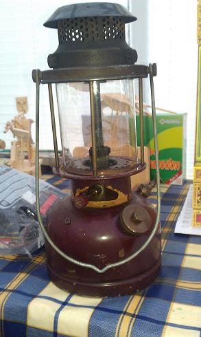

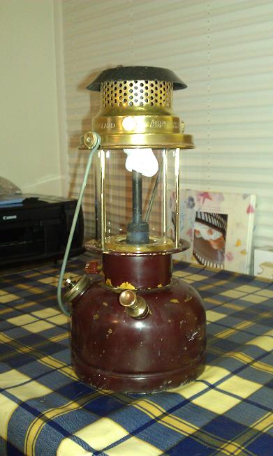

    Hi,
    As promised pictures of my refurbished and cleaned Vapalux 300X. Scroll to top to see how it was.
    The seals have been changed and I've cleaned and polished it. Unfortunately while trying to clean the besmirched glass it cracked on me; so bought a new one. Very annoying but I had to apply pressure to get it clean. Old glass.... New glass looks like it's much better made.
    It's working great now (no leaks) and the kids seem to like it. Looking forward to using it properly on holiday at Easter.
    The lantern is now proudly sitting on a shelf in the conservatory. It looks great but I'm still not 100% sure about having not re-painted it......

    Now that looks better !
    That is a nice balance between polishing whats exposed whilst leaving the originality of the fount, Good decision IMHO
