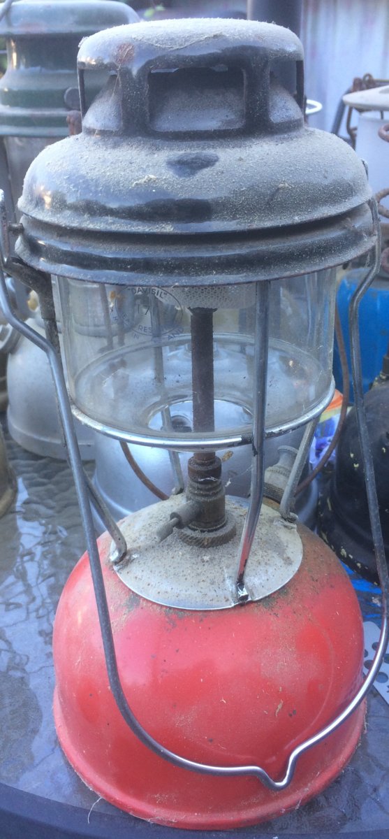

    So it looks like a normal 246A

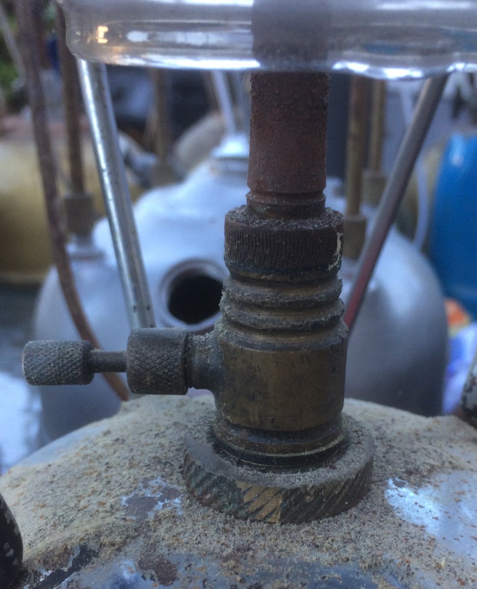

    But I've not come across a valve with this detailing before?

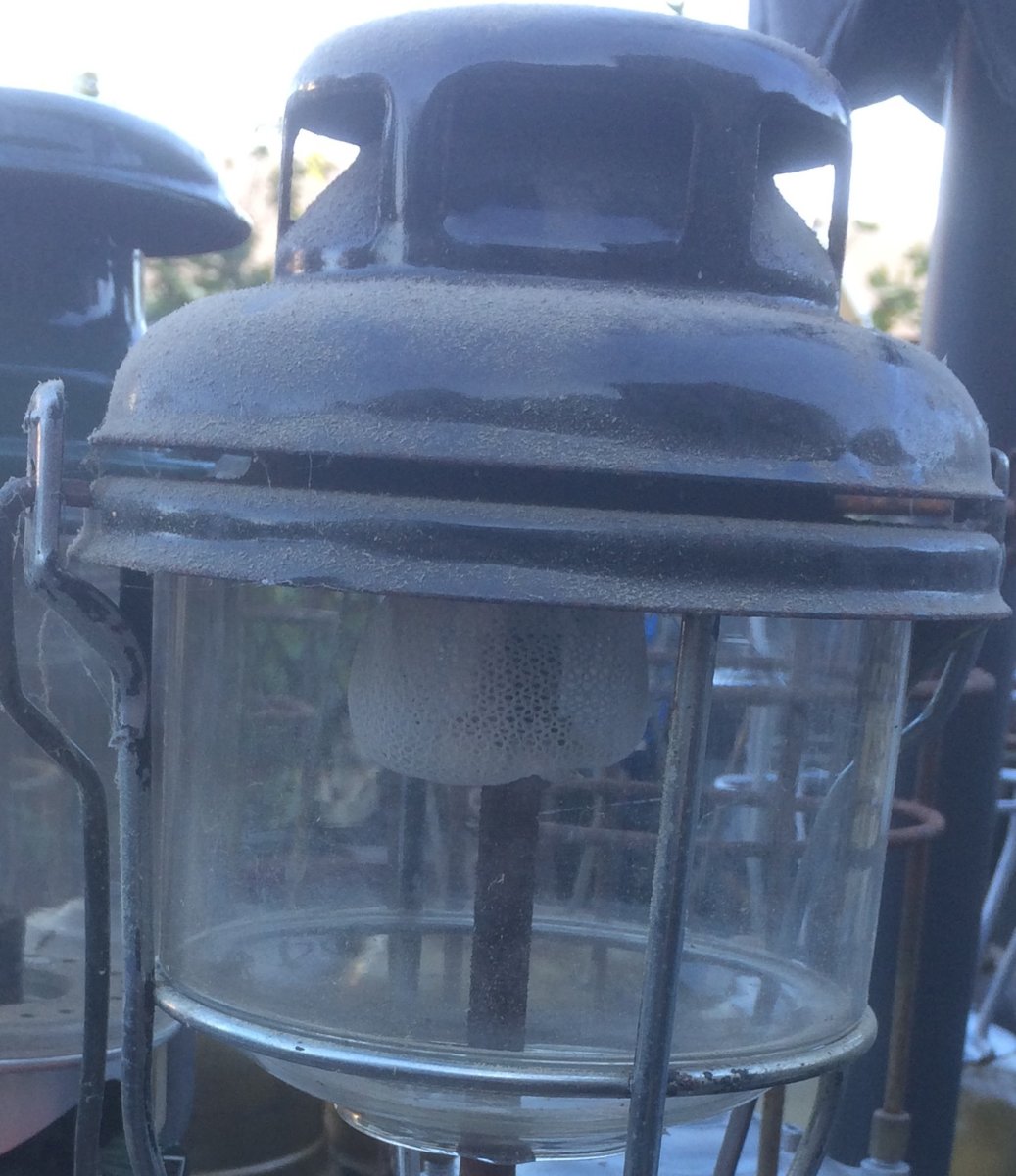

    And shouldn't there be another ring (no sign of one ever being there either)

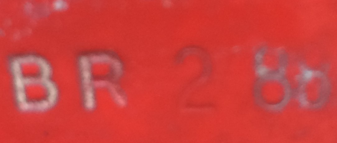

    So I assume made in Feb 1988......... but whats the BR ref all about ??

    It's an X-246-B which has been fitted with a brass GF., control cock, which were in use from 1940 until approximately 1960 and Tilley stopped using the middle ring at some point during the X246B production run.
    That control cock is missing it's knob.
    BR may be for British Rail.

    Sorry i got my A's and B's mixed up :-)..... I have 10 other 246B's and they all have the 3rd ring? Maybe this is another Tilley I need to keep an eye out for :-)

    Just had a look on the Tilley site and sure enough the new lamps don't have the central ring on the lamp frame....... to be honest i prefer the older style :-)
  7. David Shouksmith
    Don't we all - pre-1956 style.
    I presume the centre ring was dropped in Tilley's never-ending search to reduce the cost of manufacture (in this case about tuppence) irrespective of the loss in quality of their products. I suppose they also took the view that less protection for the glass would result in greater sales of replacement globes, thus double-bubble for them - hoorah! - NOT!! :rage:

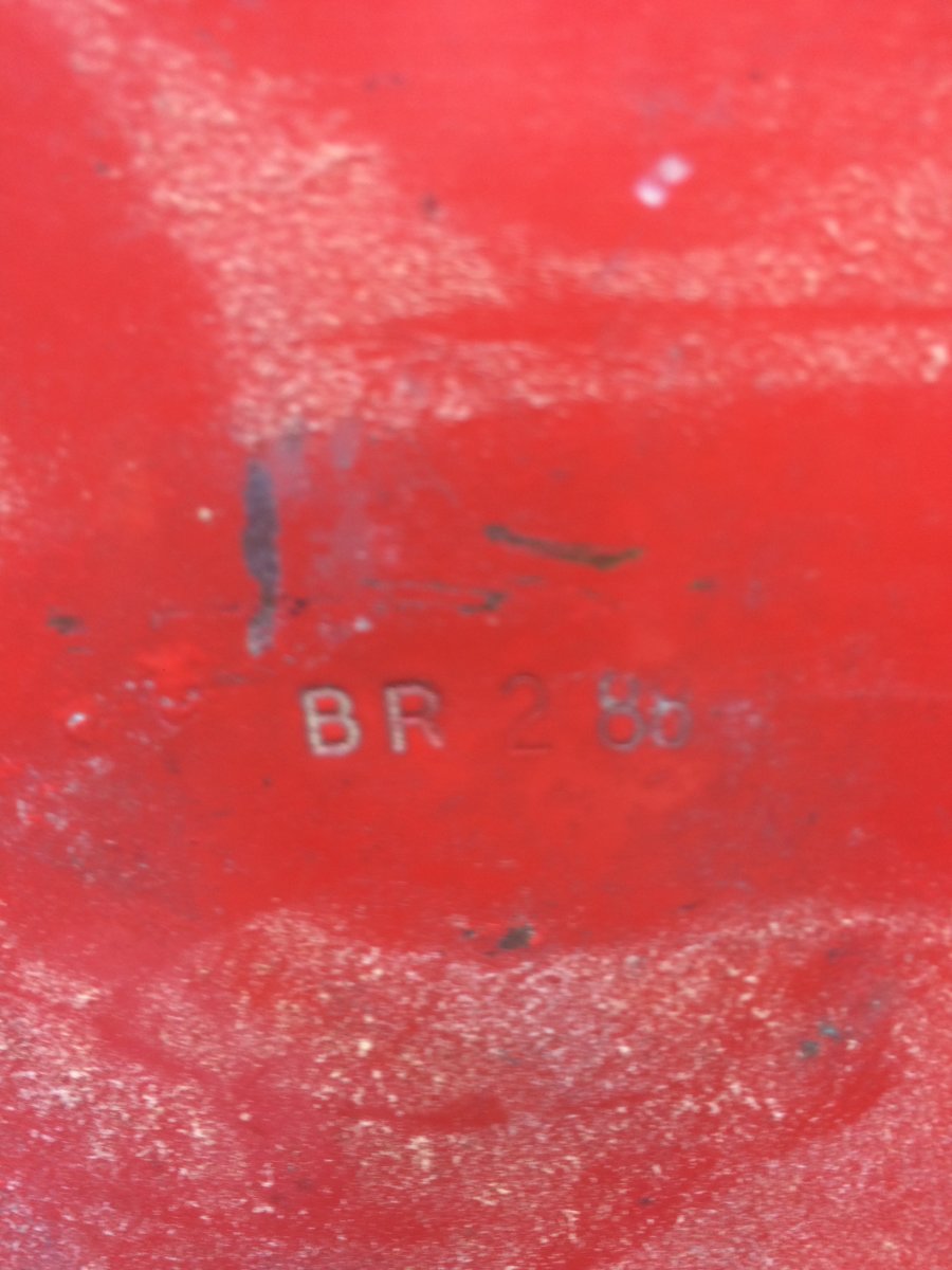

    Possibly, Jeff - but as you've probably noticed, it's on a slightly different alignment to the rest of the date-stamp. I suppose we'd need to see a good few more examples of this to be fairly certain that Tilley put it there during manufacture...

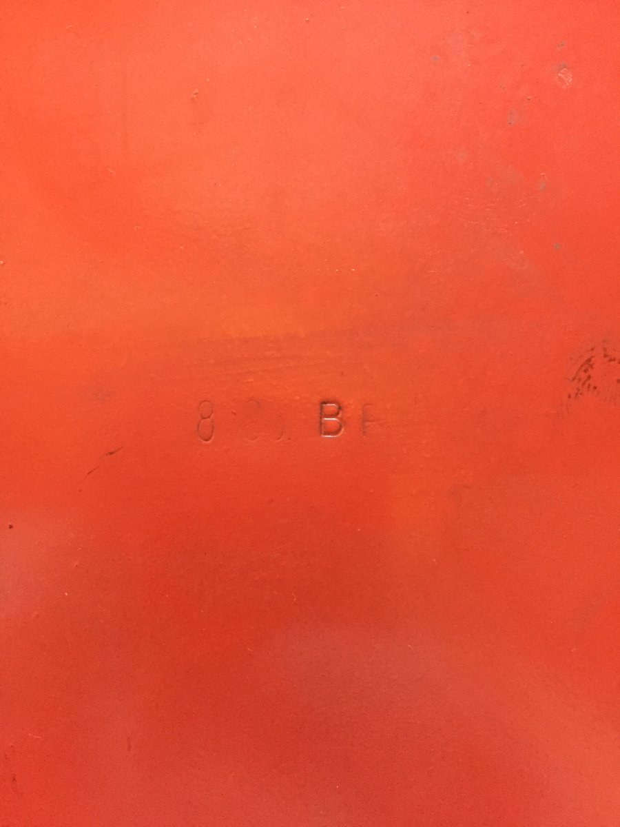

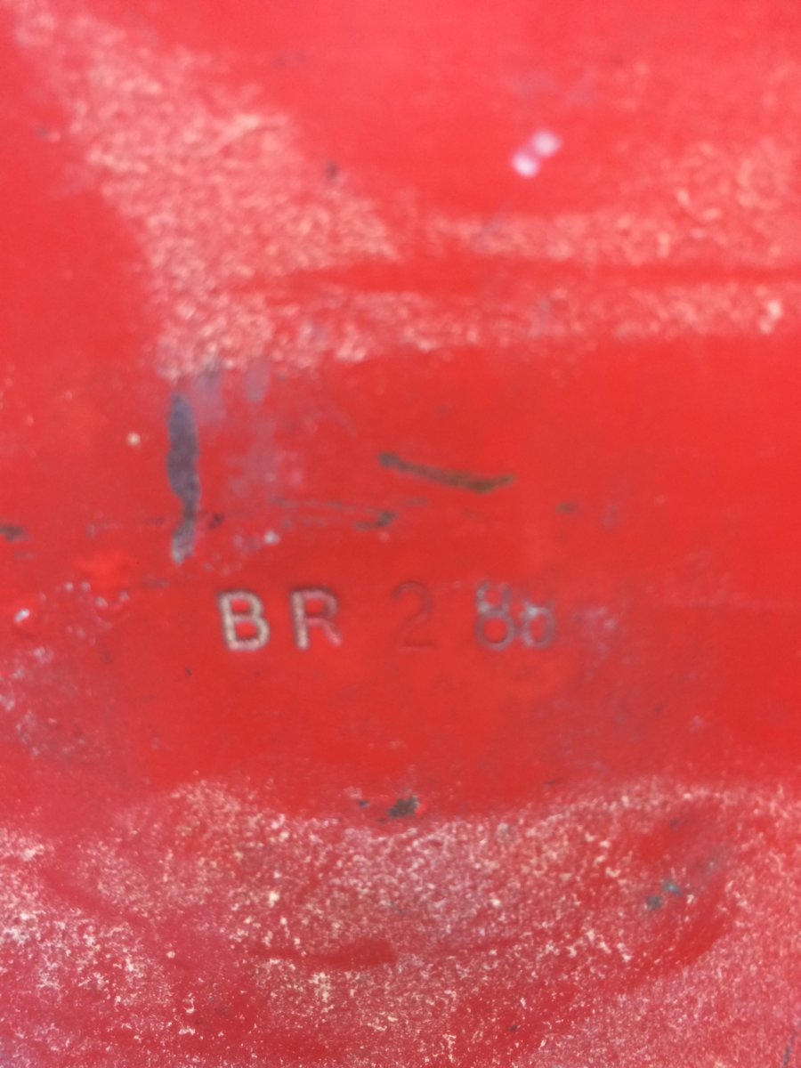

    Is this of any use ??
    Looking closely I cant see any distress to the paint around any of the stamped letters / numbers..... I know from working with old radios you cant stamp a painted surface without lifting / chipping the paint..... Any more pic's needed just ask (But i guess its just me being a newbie thinking if was something different :doh:)

    I've got around twelve of these new old stock Tilley X246B founts/tanks stamped with BR and apparently they came from/were liberated from British Rail, i've also seen quite a few Tilley 171 and 182 glass globes for sale that had British Rail stamped on their boxes,
    I believe most of the British Rail items were "saved" from the rubbish bin by people that worked for them, i've had two AL15A's that came from the children of parents that had "rescued" them from work :)

    Tilley dropped that middle ring in about 1976. I can't be precise but the last dated lamp I have recorded with the mid ring is Nov 1975 and the earliest without is dated Sep 1977. ::Neil::
