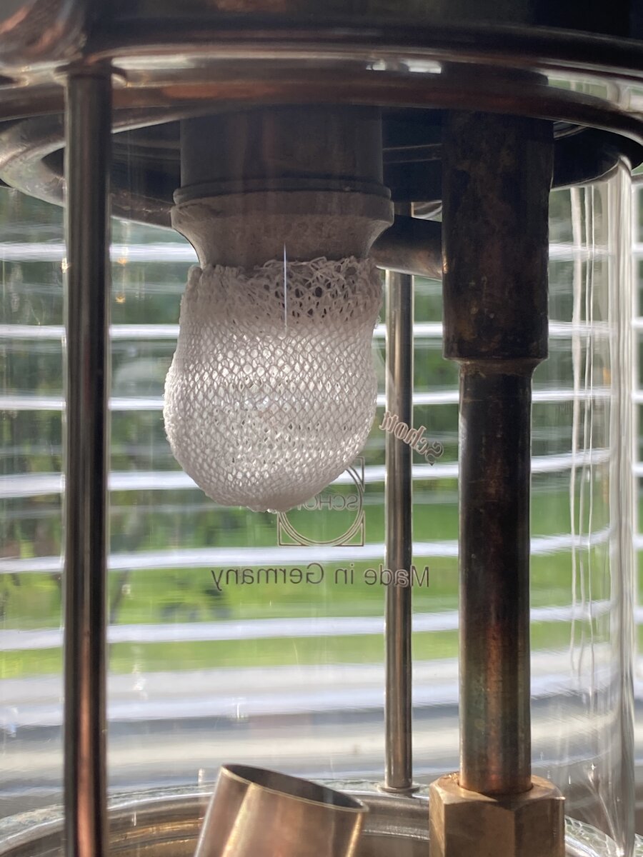

    In case it’s of use, here’s a look at the mantle and its situation relative to the vapouriser.
    Once this mantle dies the next 10 will be old Optimus No. 4 250 CP’s that I recently picked up from an army surplus store. Highly radioactive from what I’ve heard :-#.
  11. JEFF JOHNSON
    16,574
    I have found that it's better to use a more bulbous mantle as when it burns off it forms closer to the vapouriser and keeps it hotter and therefor the fuel vapourises properly and the light is bright.

    That reminds me of the HK 150. The mantle is so close to the vapouriser you can’t keep it off of it.
    What would you recommend for a bulbous mantle for the 250 CP? Will the Optimus No. 4 do? I haven’t seen them in action yet so don’t know whether they fit that description or not.
