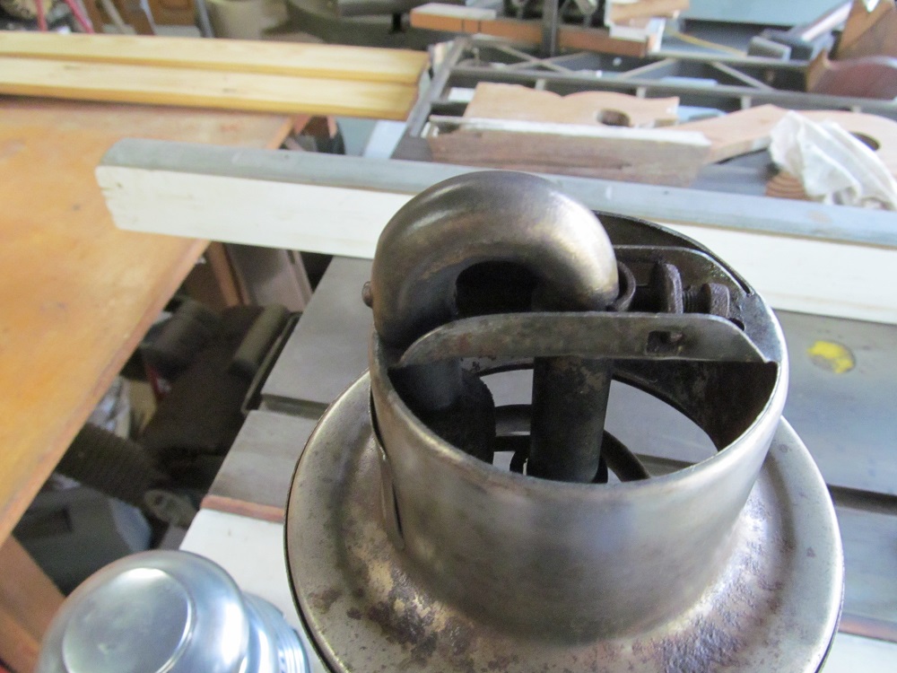

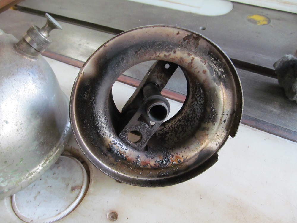

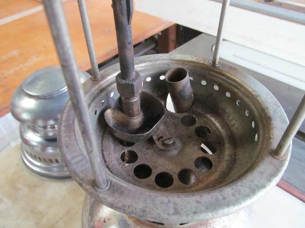

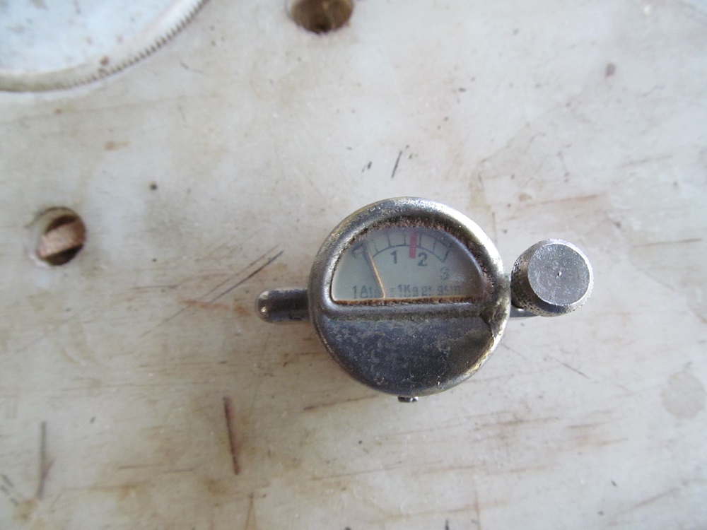

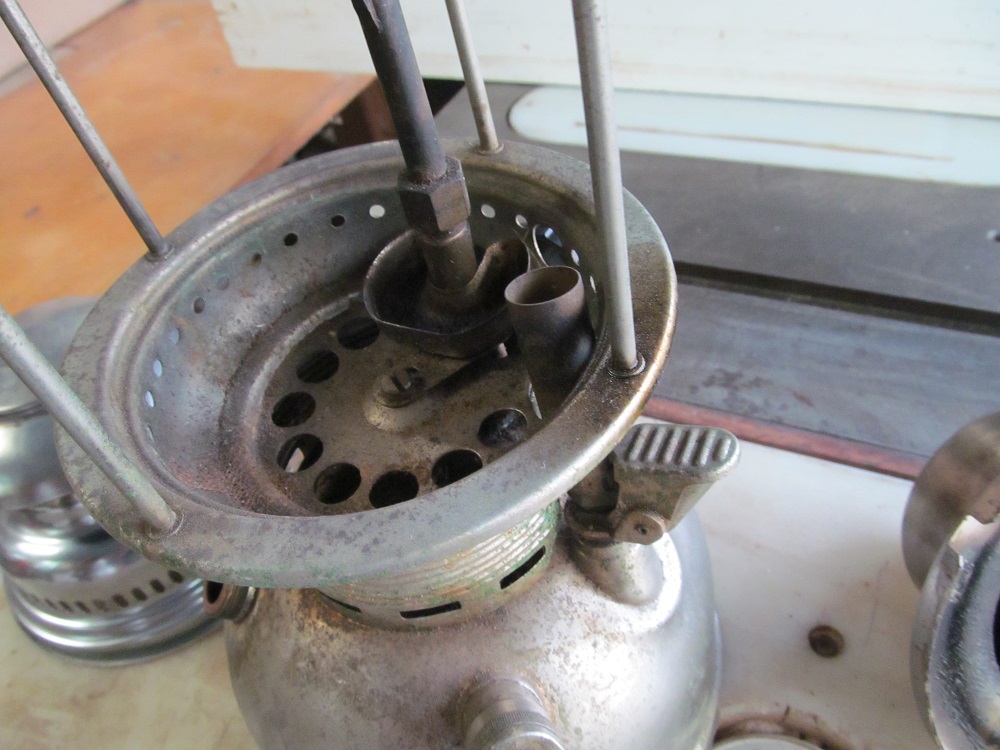

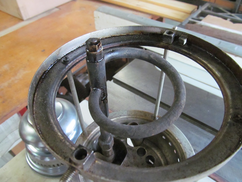

    Here is the lantern. It's an H-502--bottom of fount has numbers 9528 stamped. As far as I can tell. it's only missing the globe(but then again, I'm used to Coleman stuff, so this is new to me)
    Martin, thank you so much for the link
    Any help on how the different parts work would be super helpful---there are so many things on this lantern that I can't figure out------------

    Hello,
    De facto it is a petromax style clone.
    All the Px 500 parts should fit. The lantern looks rough. i always say: take it apart make yourself familiar with the parts and function so you know you it works and why. Find a us based petromax parts supplier and order all new seals, jet and needle, ceramic (no stainless) burner head and the right mantles.
    Biggest risk is that the previous owner used other fuel then "petroleum" (kerosene) and that you may have a clogged vaporizer.
    Never, never, listen to the b**shit of multi fuel and using other kinds of fuel.
    For the first runs use the built in pre heater spirit cup not the flame thrower.
    Have fun !!
  3. Carlsson
    3,963
    It also looks like you miss the flame spreader, but that shouldn't be hard to find.
    As Wim says, it's the same for practically all Petromax clones.
    The end of the mixing tube where the flame spreader should attach looks a bit fishy, though...

  5. ROBBO55
    4,362
    @Carlsson
    Christer, The ceramic flame spreader is missing but is the brass gas chamber also missing off the end of the mixing tube? Not a good picture but there does appear to be threads on the outside.
  6. Carlsson
    3,963
    Yes, they might be there.
    Sggoat will just have to check.

  8. sggoat
    Jan 26, 2016
    14
    yes, there are threads. The mantle mount(ceramic I think) unscrewed easily from this.It appeared reasonably clean, so all that I did was warm soapy Dawn and dried. I think it is ok. No chips or any damage.
    I am very unfamiliar with these lanterns, but would love to learn about them. Thank you to ROBB055 for the link--very helpful--
    If there are pictures I could take of specific parts, please let me know
