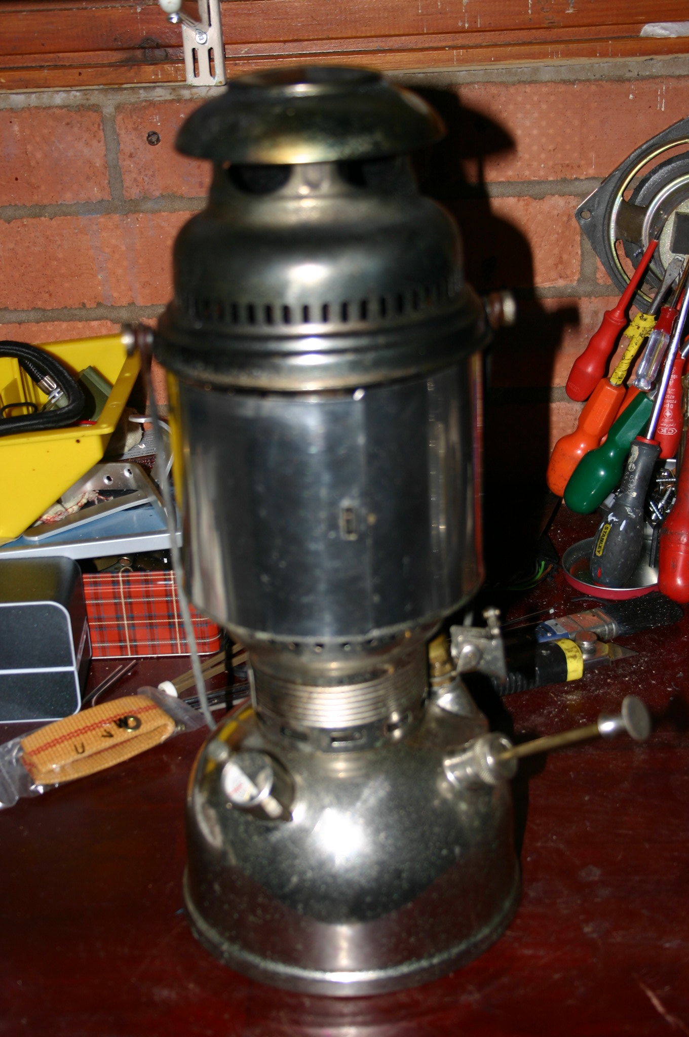

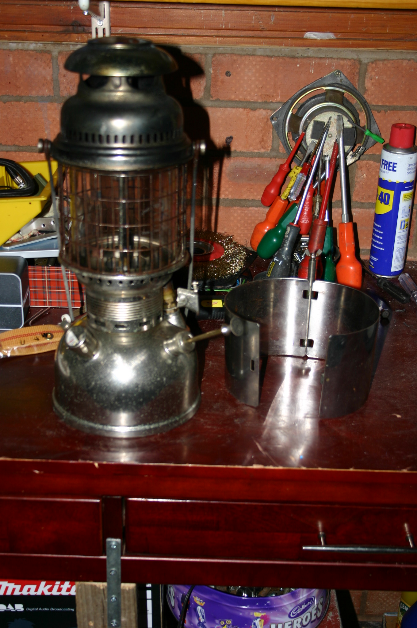

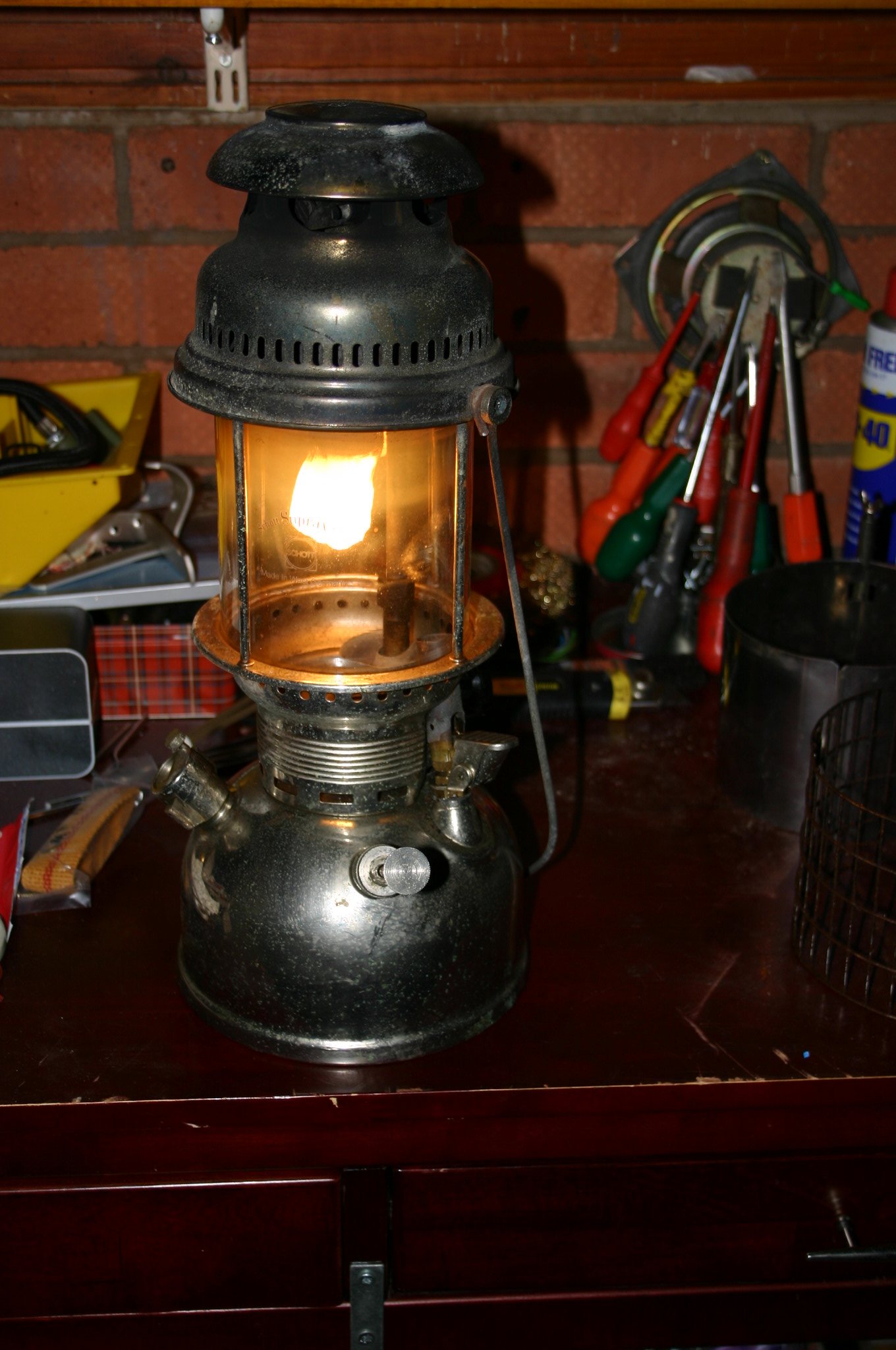

    I went and bought the lantern the weekend, got it back and fired it up had a little bit of flame at the top while it was warming but once I closed off the prehaeter and turned on the lantern it stopped. It came with a mesh metal guard and what looks like a stainless steel reflector but haven't worked out yet how to fit the reflector :oops:

    Thanks for that Neil at least I now know. Can you tell me anything about the stainless steel shield on the lantern ? ;)
  19. Mackburner
    Well sort of. It appears to be a stainless steel reflector. Probably not standard equipment I guess. I think you know as much as I do here. ::Neil::

  21. kerophile
    Feb 22, 2012
    17
    Hi, I like your Hipolito lantern.
    Could the "reflector" be an on/off switch? You could then turn the light off without extinguishing the lamp, and turn it on again quickly.

  22. netsniper
    Jun 24, 2011
    111
    Sounds like a nice idea if you have fingers made of asbestos :lol:
  23. JEFF JOHNSON
    16,886
    The link below shows an advert for that reflector/glass protector, Jeff.
    http://0flo.com/index.php?threads/1523
