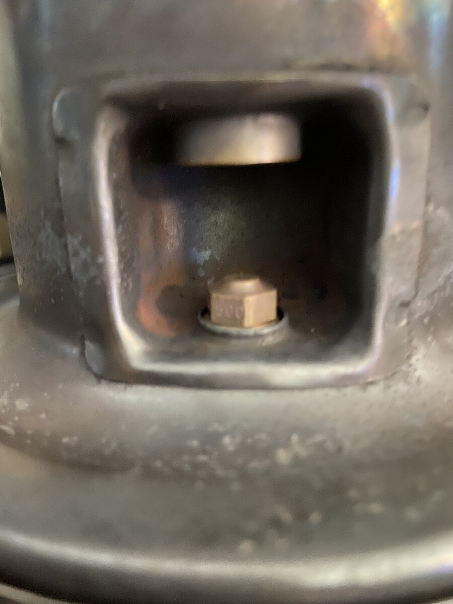

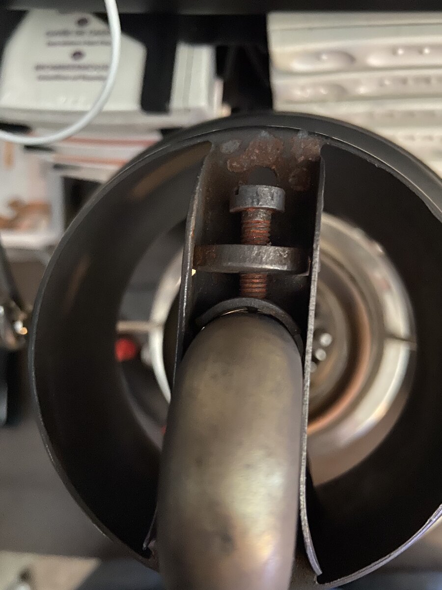

  10. Willyh Canada
    Jul 24, 2021
    29
    Canada
    Thank you again for the replies.
    I have tried tightening everything up and everything seems tight. The only other place I’m thinking there might be an issue is the top of the lantern.
    Please see the attached photos and let me know if anything seems out of spec.
  11. WimVe
    3,542
    I think it works better when you measure the distance between the jet top and J-tube yourself in mm.
    From the picture it is hard the measure correctly.
    As for the screw: remove the sharp point, it will "ruin" the J-tube, by making a dent in the tube.
