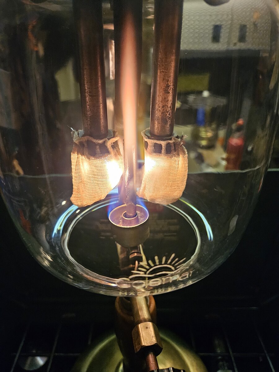

    The *new* mantles are terrible. I have had holes or unclosed seams that develop holes. I have had them disintegrate and the only thing I am doing is lighting the lantern, looking at it run...shut it down and hang the lantern on a nail in the garage. Matter of fact the 220H has hung on the same nail for years...never an issue.
    Same on the 159x pressure lamp. Fell apart as there was a hole in the mantle. I tossed 2 packs on the 159x just trying to get a mantle to not have a hole in it (most were unclosed seams)
    So I went to order something else to see if they are the problem or if its me (dont think its me) I dont think its me at all actually as I went to a sporting goods store to see what brands they had other than coleman. They had other mantles pretty cheap and were according to the girl working there "as good as the coleman 21 mantles"
    So I brought those home and tried them, and that was a relief that I was not crazy. They have held up just fine and didnt start with any holes. I have lit the 220E with those mantles like 5-6 times over the weekend, no holes develop or were there from the beginning and since I tied them, they haven't moved at all.
    They didnt have these other mantles but had another brand so I am going to try those out too.

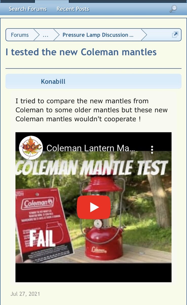

    I can only point to two threads from a while ago.. one has a video but they are both worth reading.. if you type in the titles in the search bar you can find them

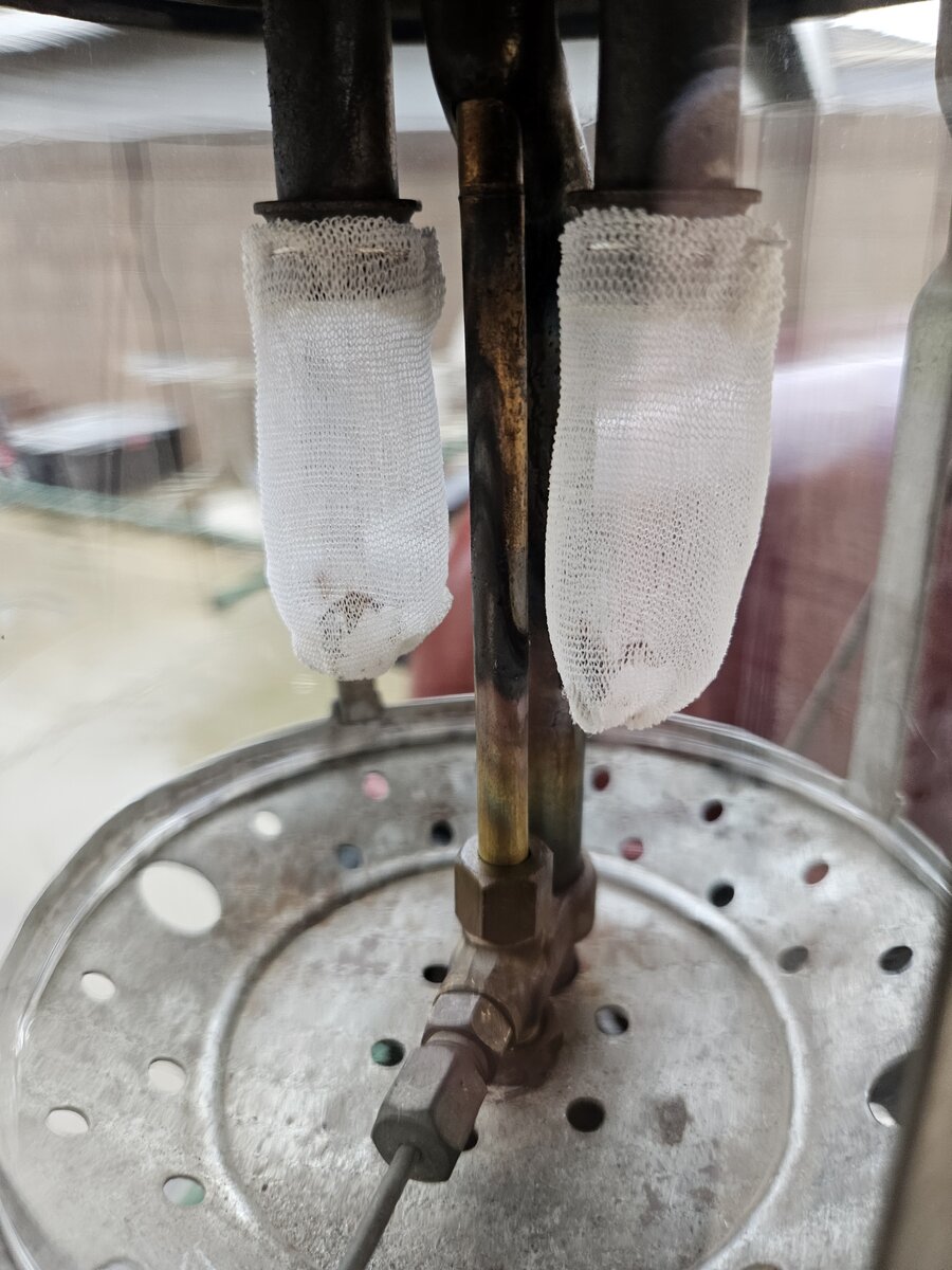

    Here is what I have. From left to right:
    Red bag (had two of these with holes already right when I installed them)
    White smaller bag (later replacements from Amazon and made sure not to get the red labels but these had a seam hole and a regular hole as well)
    Larger white bag (older bag from the 2000's that I've had forever and hadn't used... But now looking at them it's a bigger more rubbery bag than the new really crinkling bag on the new product)
    Last bag on the right (stansport from sporting shop... They're holding up normally with no holes or seam rips)

    @podbros the exact same that was on the video. I literally light the mantle and watch holes develop. Thanks...thought I was crazy.
    @Fireexit1 Yep thats the brand I bought. In my old gear I had some baggies from Joshua Tree National Park store that were made by "Century" but I dont think they make those now, but do remember seeing Peerless before a long time ago and dont remember anything special that was bad (bought them...lit them...used them...worked) so I got those.
    It was pissing me off actually because I just bought them and figured it was fine.
    If you look at this photo you can see that there are two different mantle sizes going on here because when I lit these one developed holes and I was out,so I used a sock tied mantle (not the clip one) and it was a completely different size.

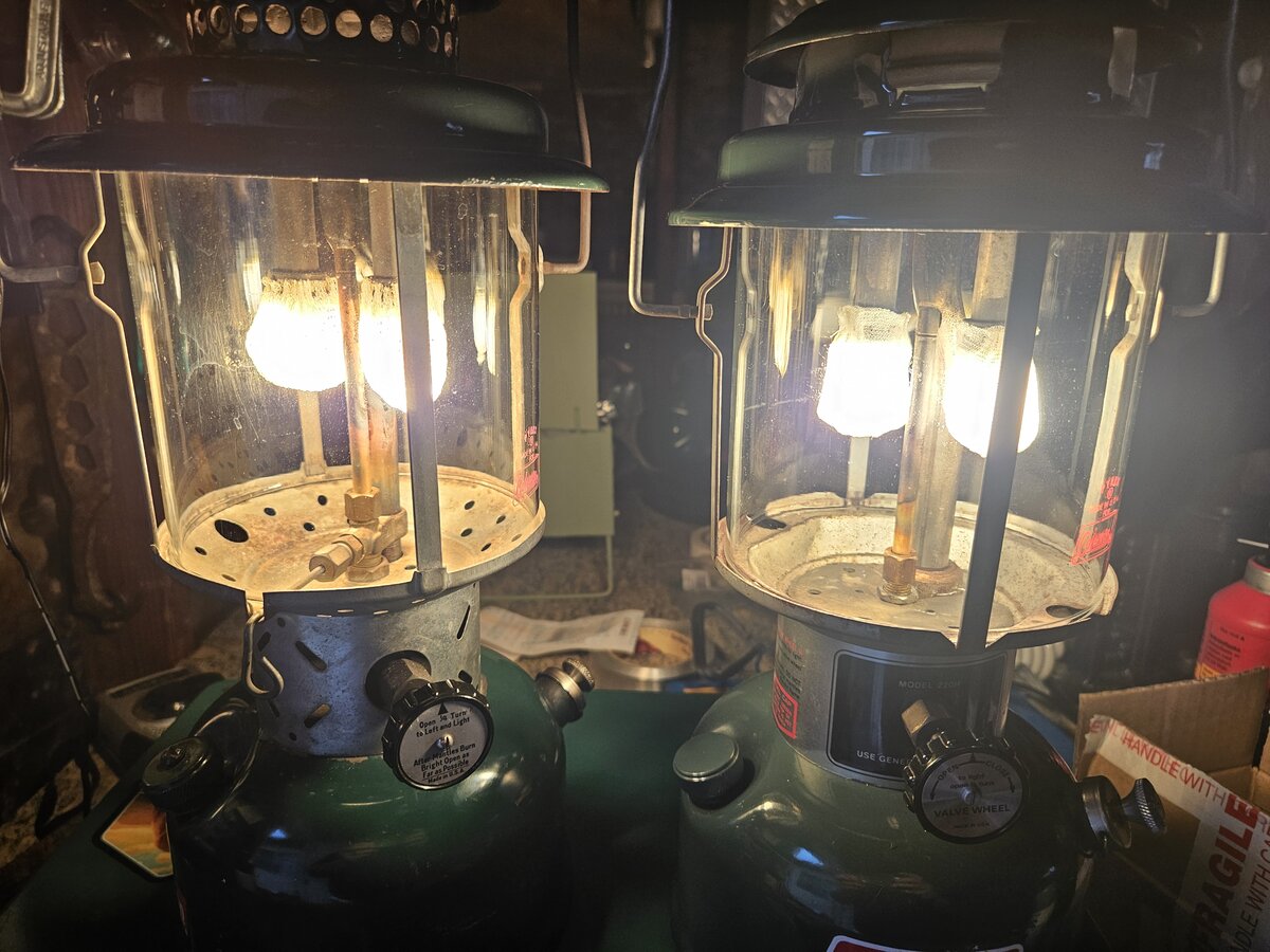

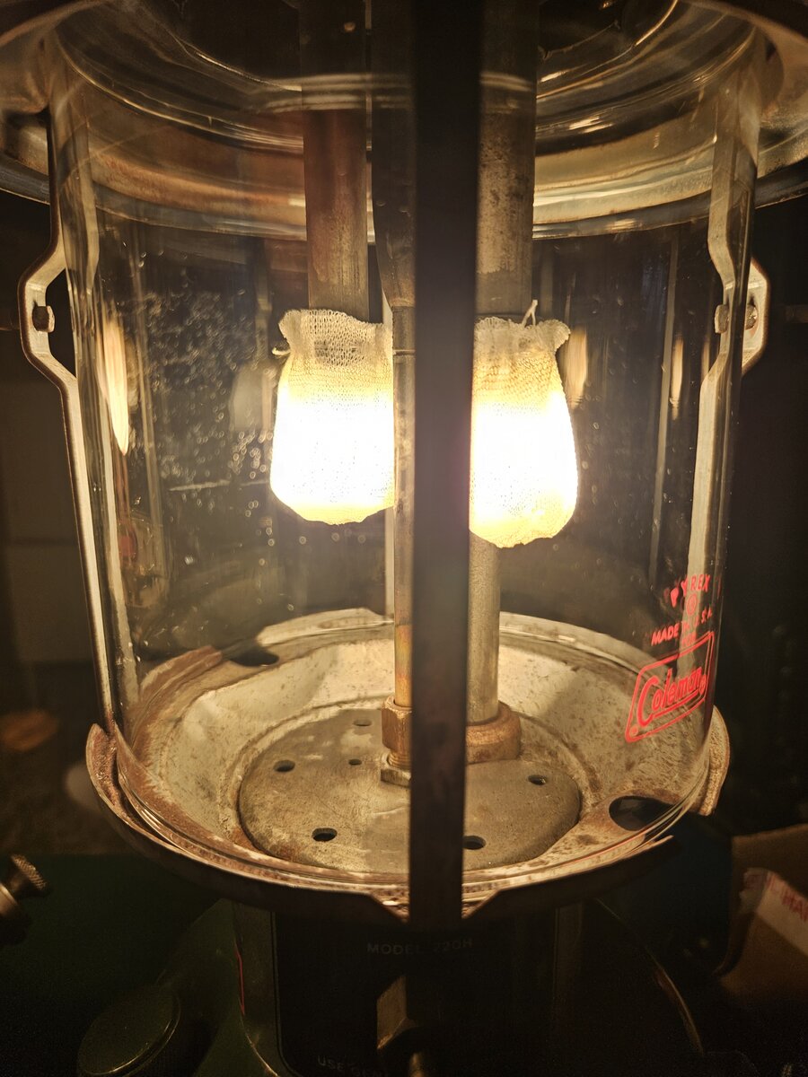

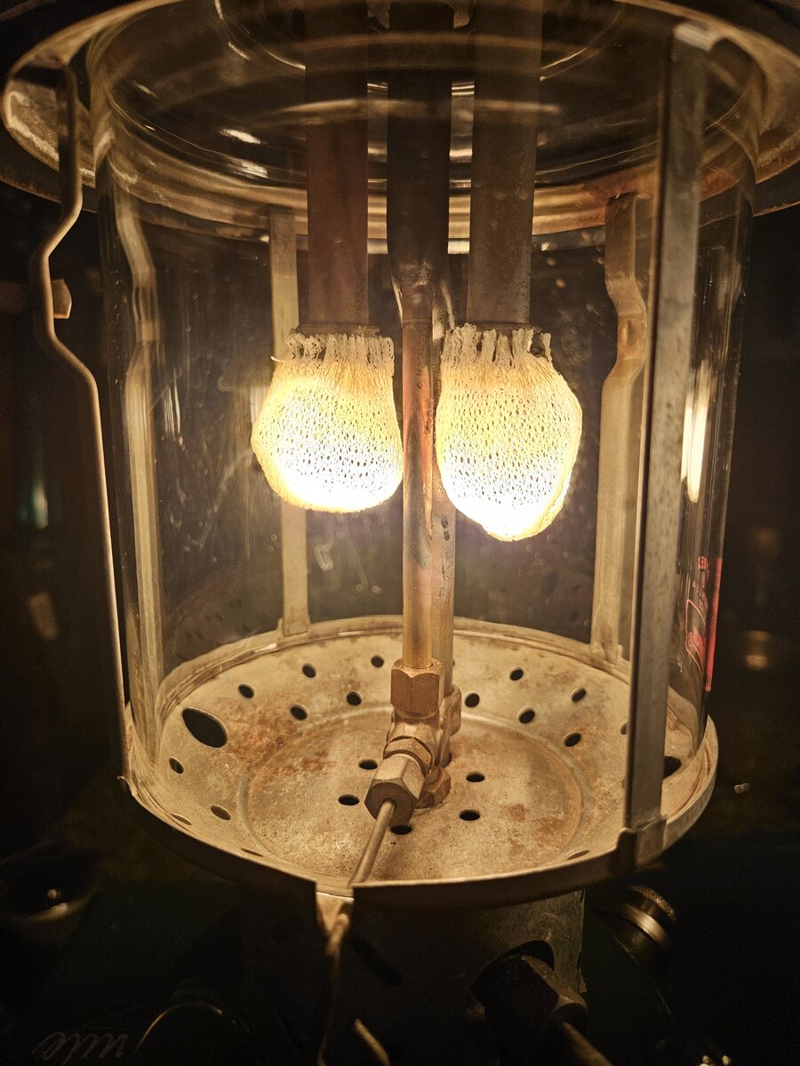

    Ok so...
    @MYN I went out to get the American mantles. They're a dollar cheaper than the Coleman 21a tie type...and they're plenty here.
    Interesting... They're like silk lites in the sense that they're big net weave (if that makes sense) and seemed to be tough.

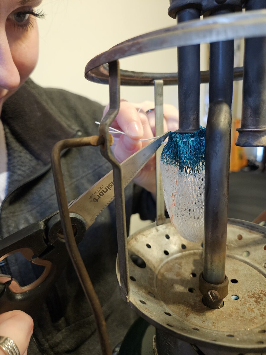

    Took the stansport mantles off the 220e lantern and had the wife tie on the new ones to test. The stansport took 29 starts (pumped the lantern cold...used a lighter with the globe off to light...and ran for 5 minutes on a timer)
    They're great mantles... They're a little yellow but I think it will get brighter after time.
    Now waiting on peerless tomorrow haha
    Old stansport mantles
    Wife tying the knots (I hate doing it haha)
    American mantles on left, old Coleman 21 (American made) on the right
    American mantles

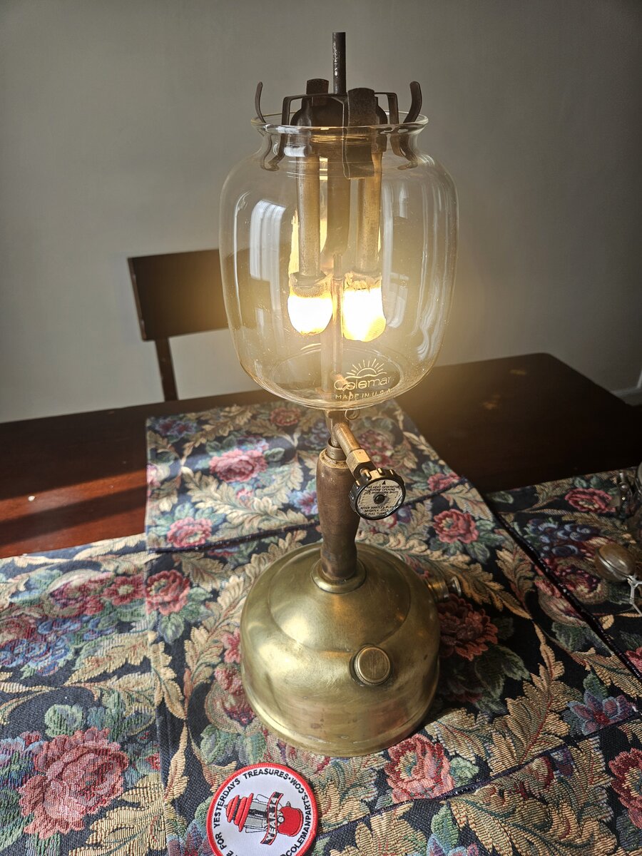

    Later today I will get the peerless mantles...and will install them on my 159x coleman lamp to try out. I will put some photos up later.

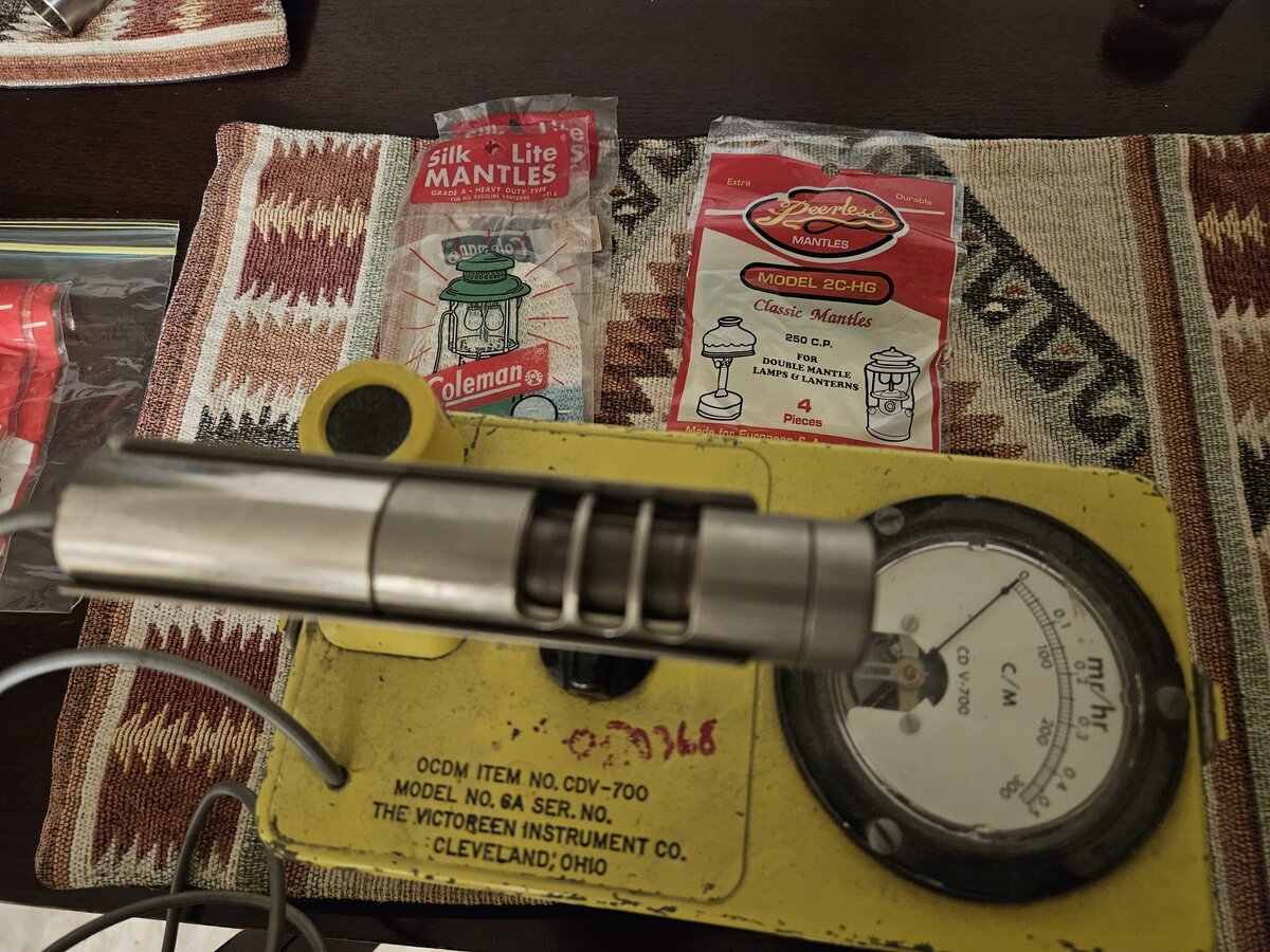

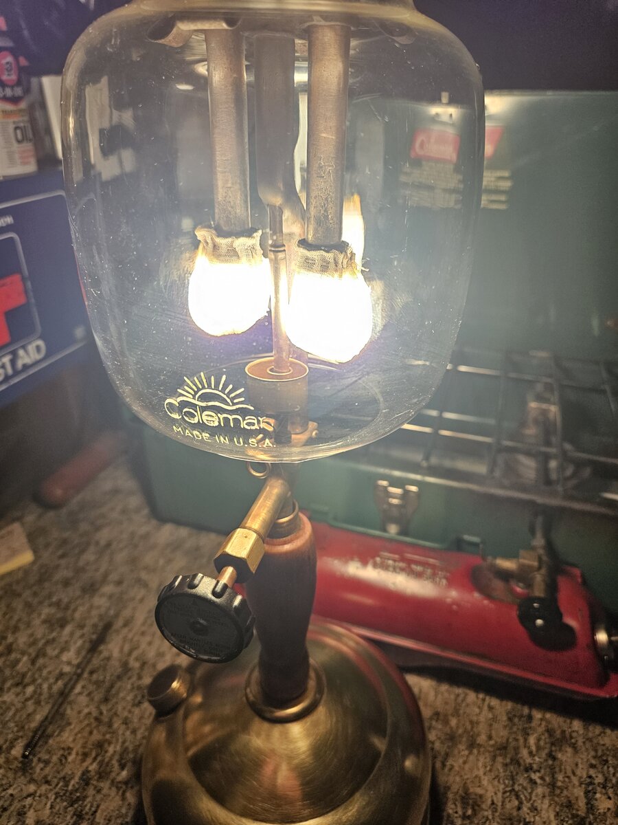

    The peerless mantles came in late but I had time to test.
    The surprise to me was that they're made with Thorium and I can't understand why when it was not listed in the description. I managed to dig up my very small supply of silk lites and those will send my meter through the roof but I'm comparison the thorium in the peerless were not as strong but strong enough I would not want to make tea with them haha.
    The only negative is the quality...and it's not too bad but the socks were more open on the top and so when you tie them there's more material to adjust around. Also how they threaded the strings through them was crooked but worked. The thread itself was different than the others and seemed to want to break up in your fingers in fibers but they didn't break and tied on ok.
    They're bright and seem to be really sturdy but as I said it was late when Amazon delivered them so I got about 2 lights on them before going to bed. I tapped a wrench on the side of the handle to see if they would break but they didn't and looking at them this morning they look good to go to me at least...
    Peerless thorium mantles compared to silk lites (radioactive)
    Label on the peerless
    Warming up (used a preheat cup to light the mantles and preheat generator)
    Chernobyl (hahahaha)

    @Fireexit1 yeah but how can you tell unless you have a radiation meter? The listing on amazon just states they are mantles haha

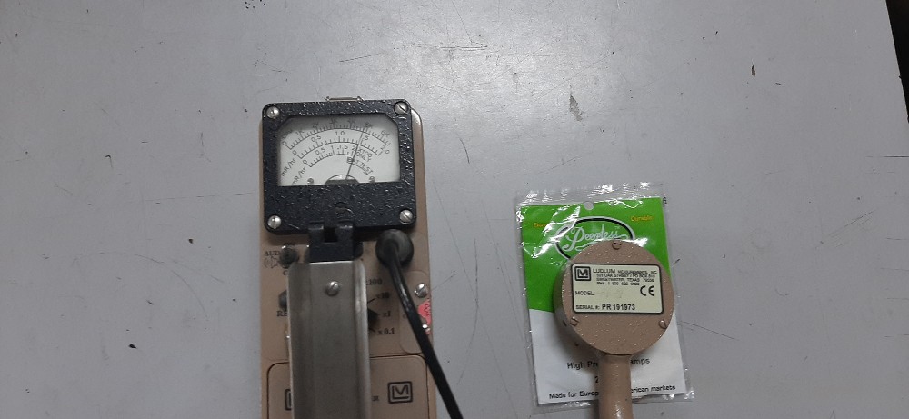

  27. MYN
    Nice setups.:thumbup:
    Great to have a counter meter to measure and verify that it is radioactive.
    What were the readings of the Coleman Silk Lites and the Peerless 2C-HG?

    @MYN I have a house full of weird stuff...haha

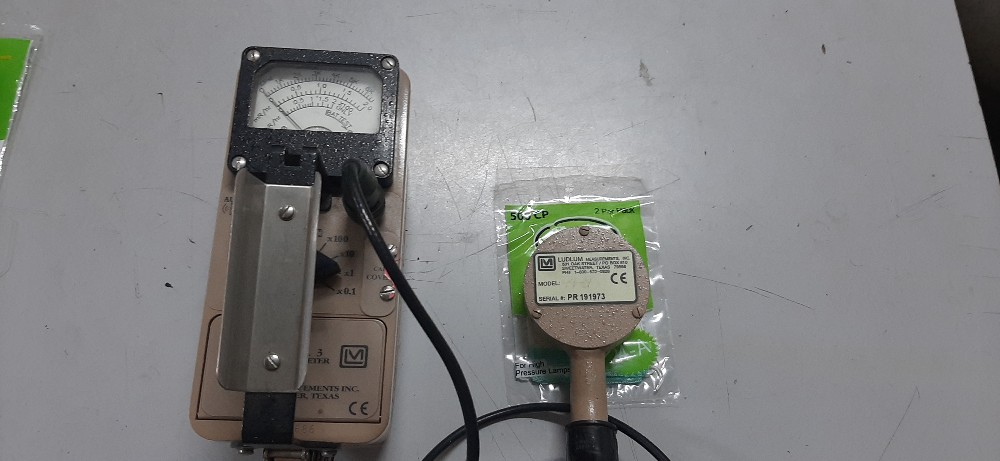

    Silk Lites - 0.5 MR/HR
    Peerless - 0.3-0.34 MR/HR
    Adjusting the 10th scale my meter has a check source for 3.3 for calibration (cal date 2019) and its dead on.
